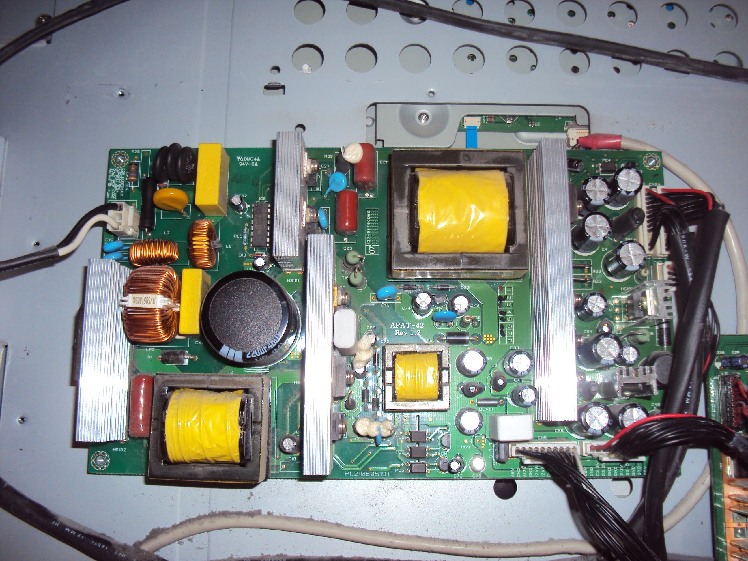

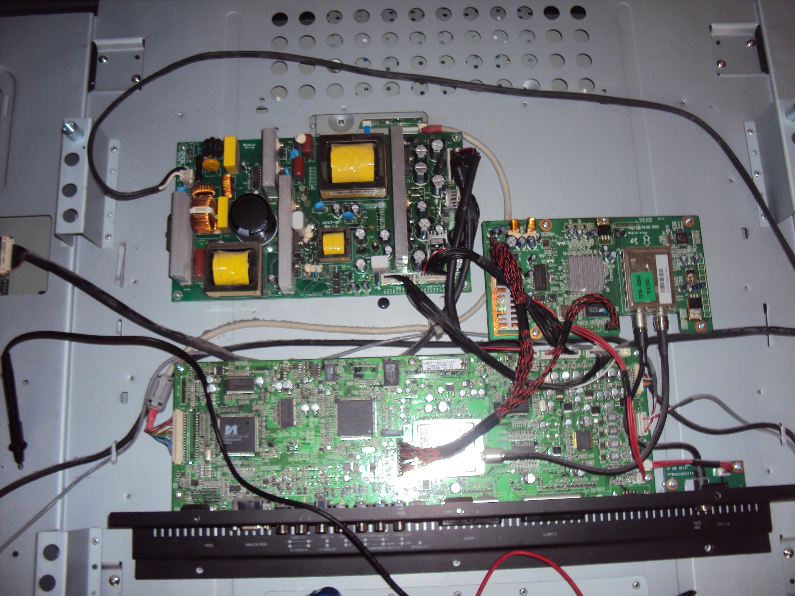

    Picked this up yesterday for £30 fault was described as "won't turn on it used to turn on after 20 minutes but now theres no standby light"
    So i took the psu out and removed the old fuse near the 250v input and replaced it with another I had off a faulty board.
    It now gets a standby light for all of 5 seconds then konks out, no sign of any other damage anywhere
    top of caps get low voltages and gradually drop as the standby light dissappears
    samxon caps too

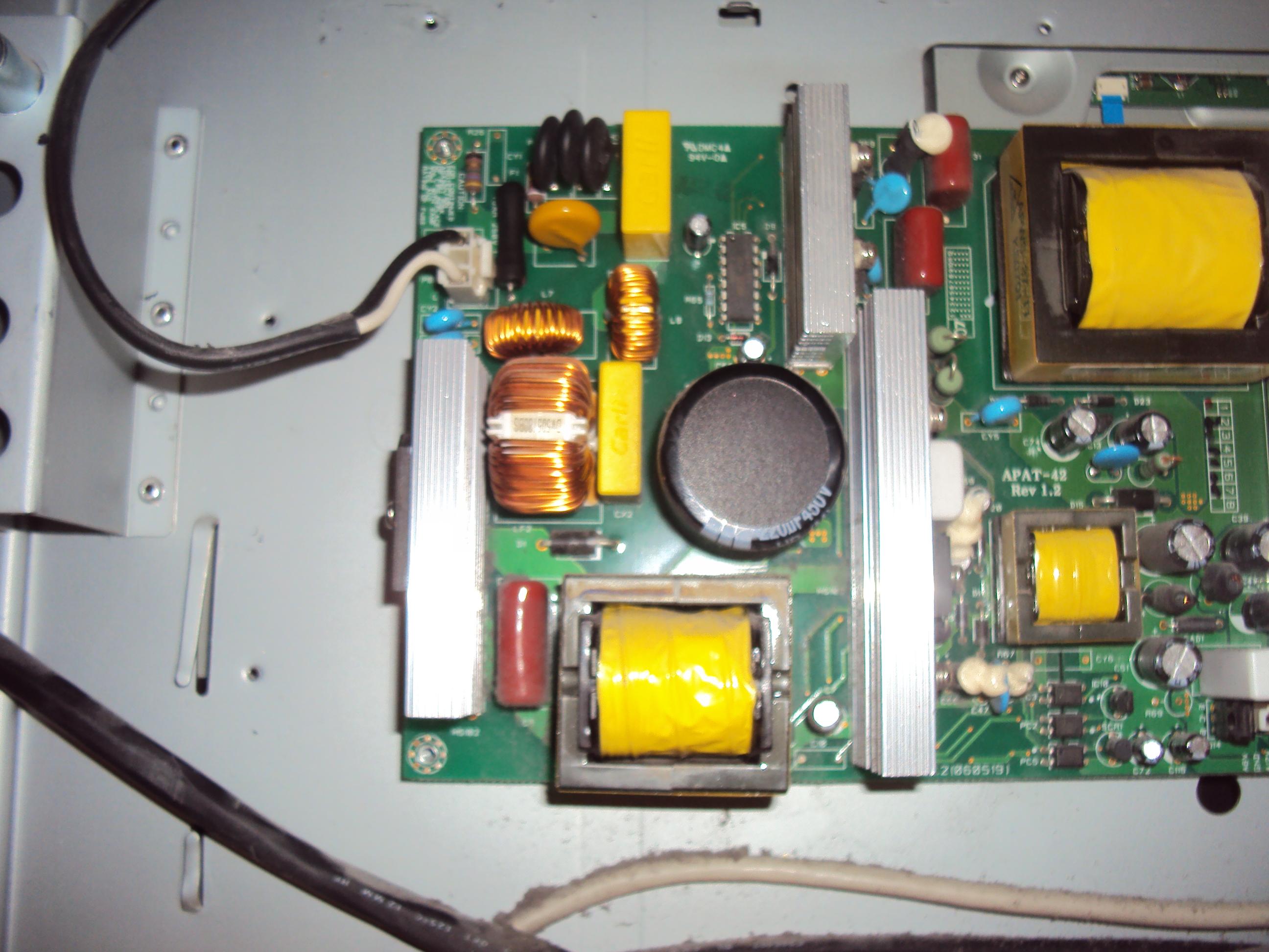

            sorry tom i appreciate your help but i can't seem to see anything labelled with PSON
            better image of the board

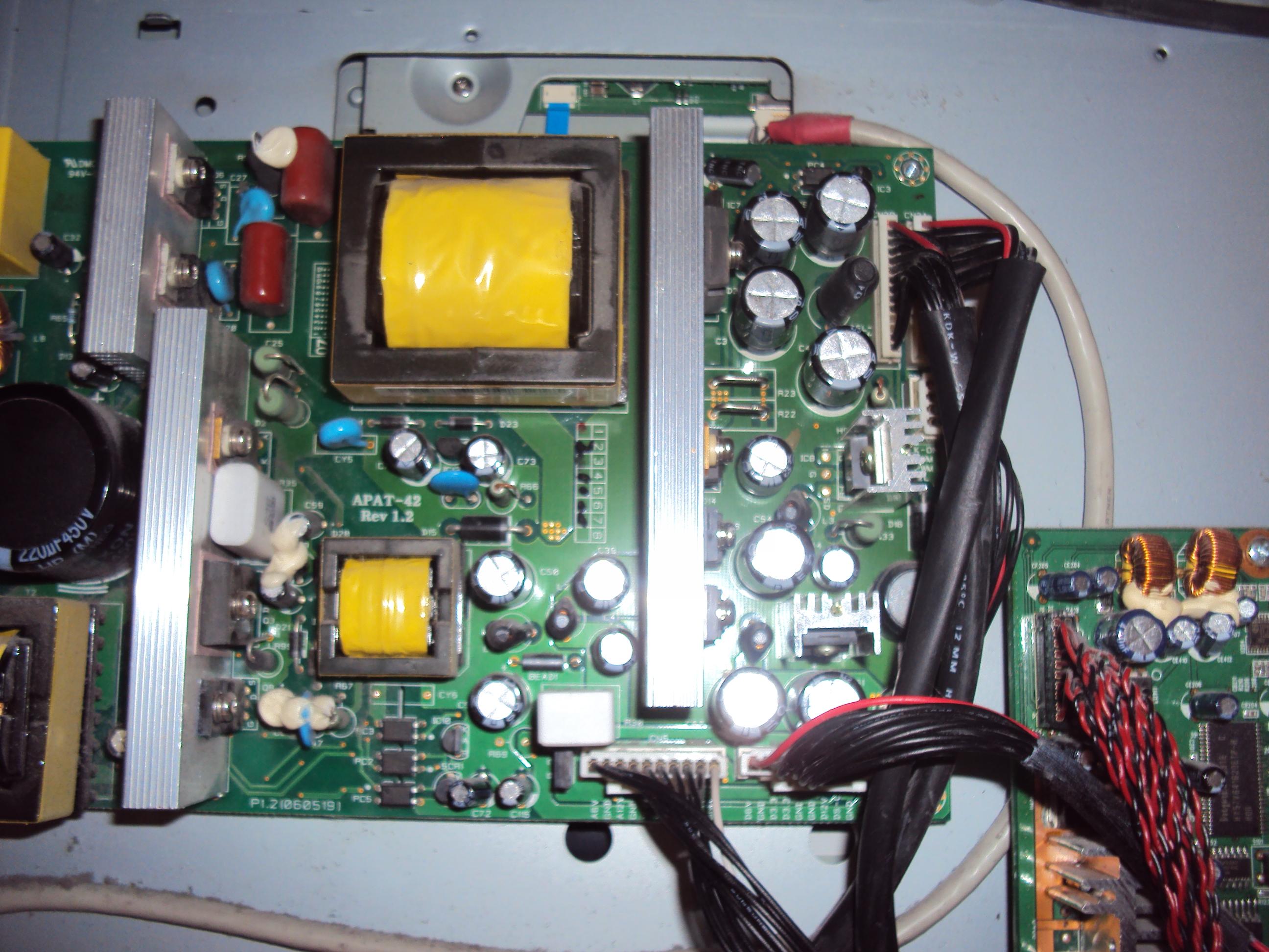

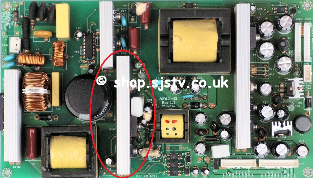

                                      ok tom i've narrowed it down to this
                                        Re: Atec AV420D No Standby
                                        I would replace all the small caps in that area. In fact I'd also replace the two near IC6, too.
