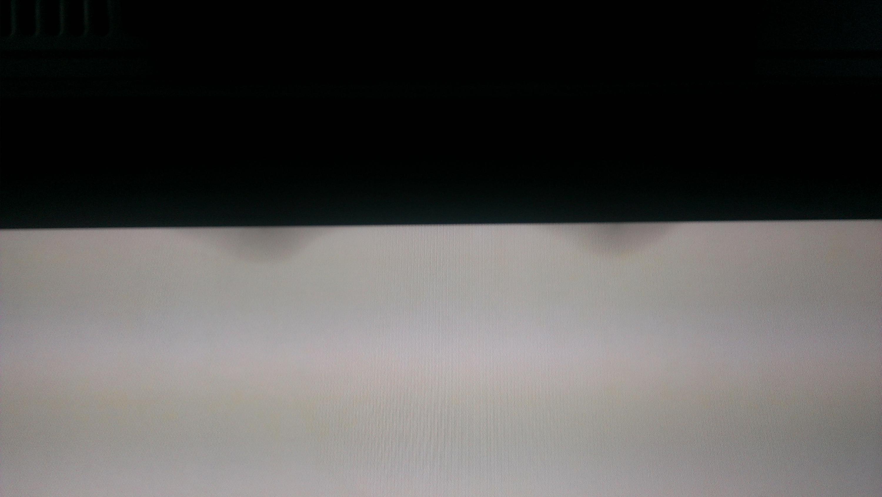

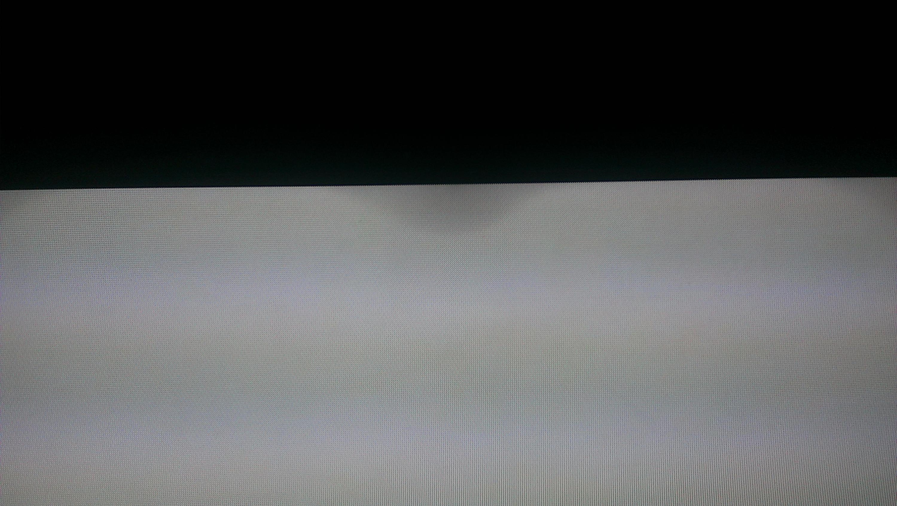

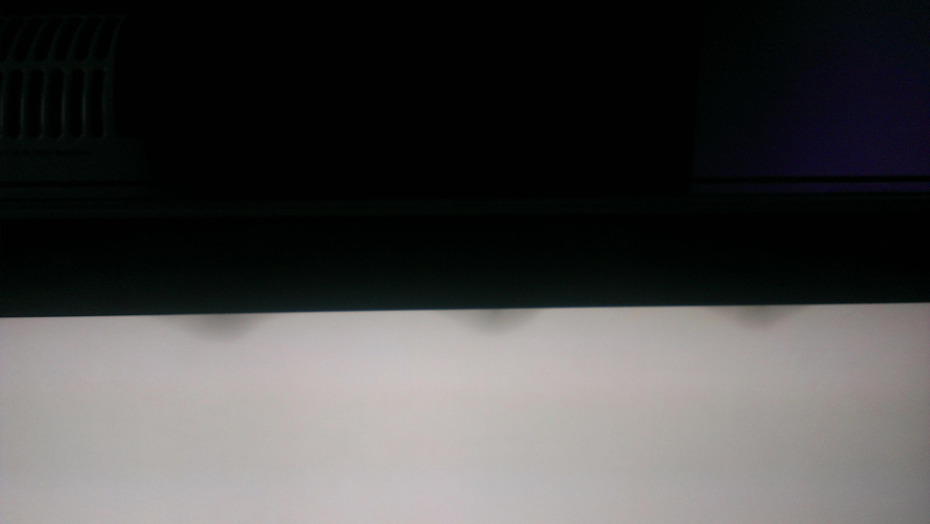

    i have a philips ambilight with an lg panel, there are dark bumps at the top of the screen. I've seen the same on lg panels, i think they are where the ribbon cables are. does anyone know what causes this, could it be cleaned off? i don't really want to dismantle the panel for fear of damaging something, but its quite noticeable. could i put a cotton bud between the layers and clean it without dismantling the panel fully?

    Wow same issue I had with a Magnavox 42 inch lcd. Whats the spots look like on a dark screen? Are they visible. Like white?
    are they more prominent when the tv is first turned on and then dissappear slowly?

      they are visible on a white or light background, you cant see them when its dark, and stay the same however long its been on. i assume its a darkening of one of the layers, from airflow or something, but could be a permanent problem with the lcd? its a 47inch, my other one with this was a 47inch also.
      i wondered if i could go into the service menu and shift the picture down 5mm, that would hide most of it.

        How long has the set been off? On some of these, it goes away once used for a couple of hours, if it is turned off for some time.

          got my eye on a sanyo with the same issue, though these disappear after time

              All these doing this see if the panel is loose in the frame. That was the issue with mine. Over time the aging of the materials used to house the panel in the frame degradate causing the ribbons to not effectively get cooled by the metal frame and heat up faster than normal causing an influx of heat to the panel temporarily warping the surface causing this.

                On the Sanyo the rings also turn white at the edges when on a black background

                  Yes this was my symptom as well
