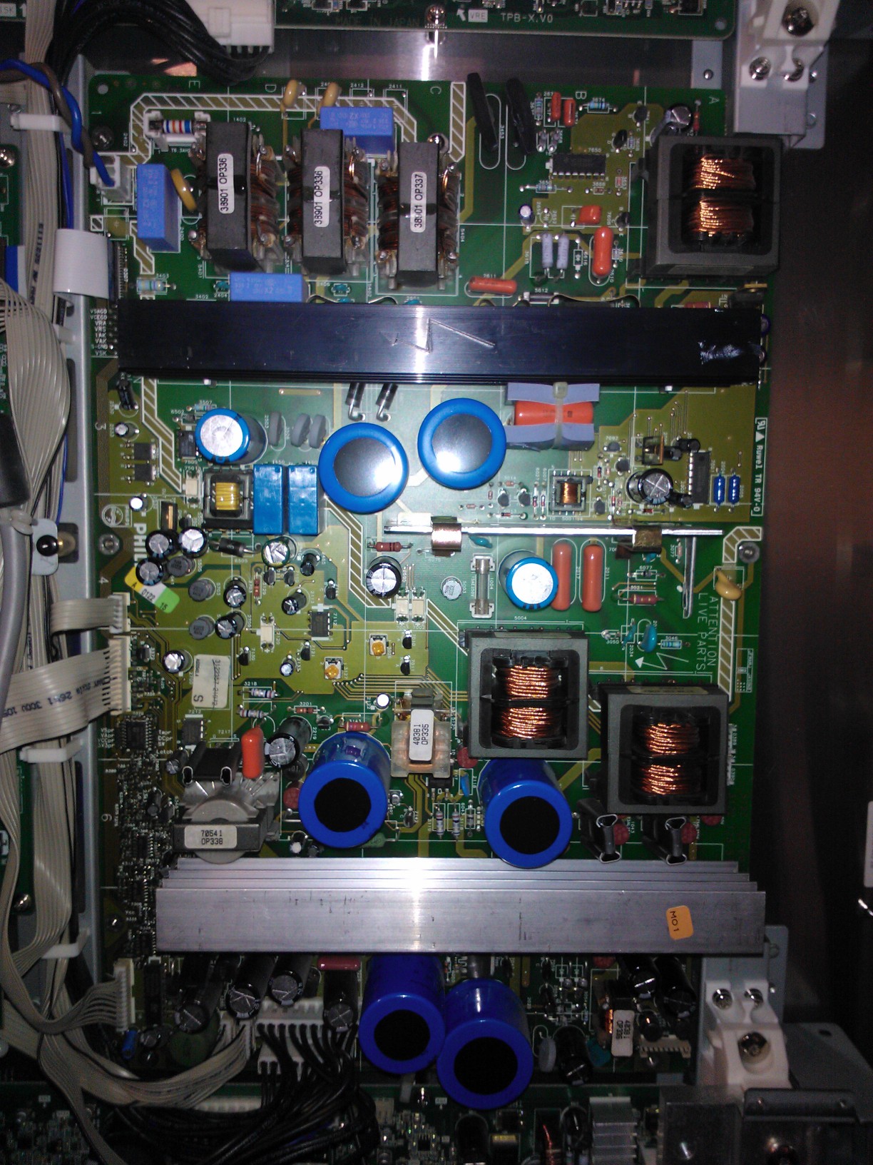

    Got a struggling older Philips plasma, model 42FD9944.
    During poweron it crackles and pops from the SMPS, I can read a somewhat unstable PFC voltage of around 390VDC, jumps a few volts up and down.
    VA and VS does not start anymore, recently tried to start up those, but not reach their correct magnitudes.
    Suspect a bad caps SOMEWHERE, there are hundreds in this set.
    Please check the attached pic and let me know if you know what to check.

    Have to go through the pcb with freeze spray. Hairdryer didn't reveal anything.
      Re: Philips 42FD9944 powersupply failure
      Crackle and popping is not a good sign, where in the SMPS is that coming from? Primary or secondary side?
        It's hard to determine which side crackles. I suspect the crackles are, simply, the PFC trying to regulate but the DC/DC is jumpy and won't present a smooth load.
