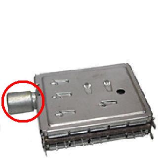

thank you in advance
where i can find the part in red circle?

You would have to buy the whole tuner module not just that part in most cases, unfortunately.Please do not PM me with questions! Questions via PM will not be answered. Post on the forums instead!

Tuner Can or Tuner Module.Please do not PM me with questions! Questions via PM will not be answered. Post on the forums instead!

If you mean just the red circled part - I would call it an RF input socket
or Aerial Socket. Sometimes they are threaded.Please upload pictures using attachment function when ask for help on the repair

Yeah, sometimes I see them as an RCA-like jack, sometimes they are threaded.
Usually they are soldered to the can, so removing is a PITA :SMuh-soggy-kneeComment
