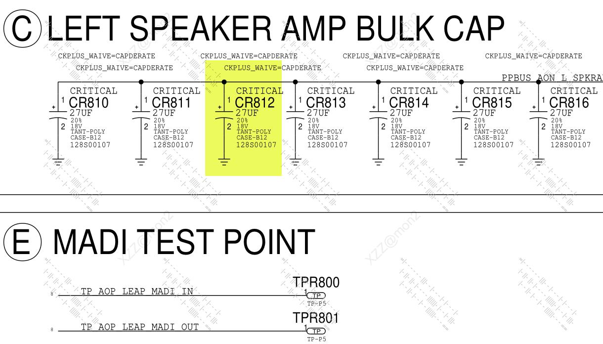

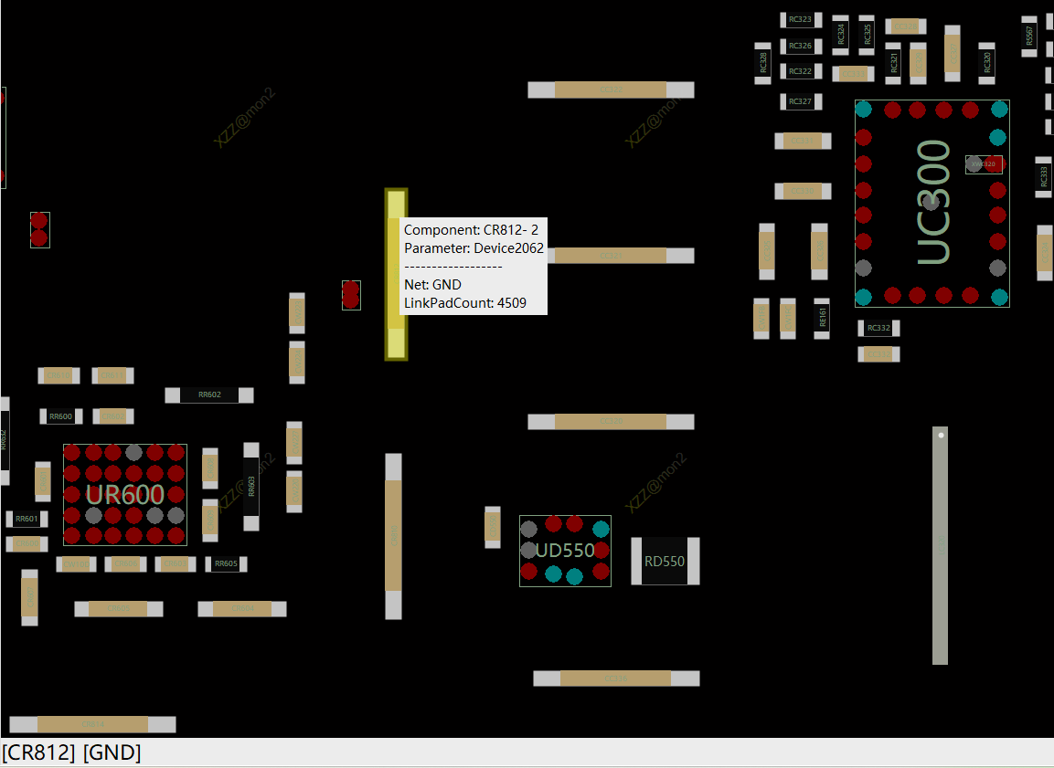

    Macbook Air A2681 logic board, find this part
    I am trying to find this part on the logic board. See pictures below. It might be CR812, not sure. Any help would be appreciated. And where could I find the part?
  • mon2
    • Dec 2019
    • 14258
    Agree. Looks to me to be CR812. A part that will not be missed if it is not replaced but you should be able to find a replacement on Digikey / Mouser / Arrow.

    • PizzaMan
      • May 2025
      • 5
      Cap was shorted. I just removed it for now. Laptop fired right up. Thanks
