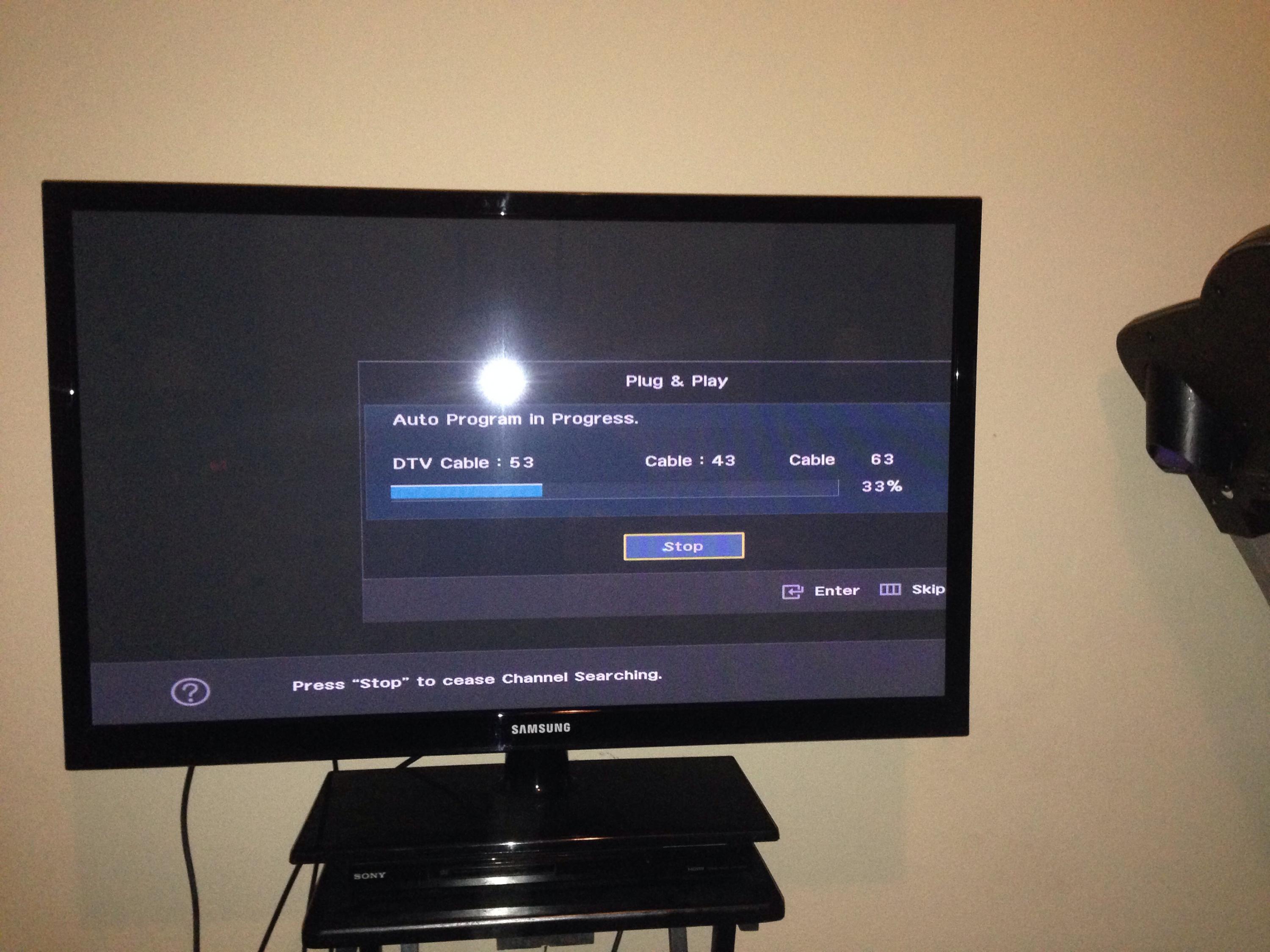

            Re: Samsung plasma screen not centered
            Here is a picture.
              Oh, did you happen to use main board from 51" in your 43"? The 51" is 1366x768 pixels or thereabouts. The 43" is 1024x768. The main boards are different and not compatible.

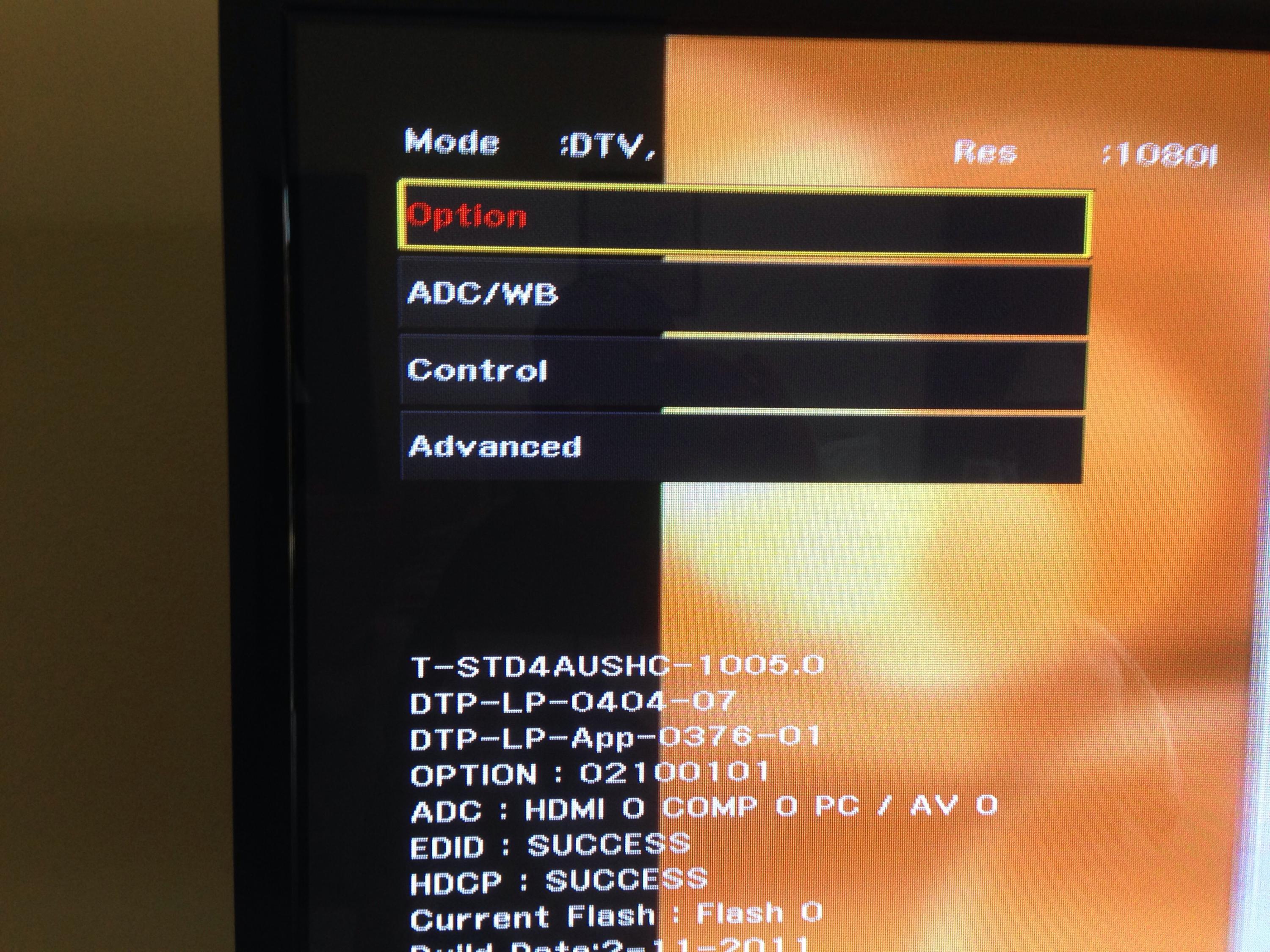

                      Can you post a picture of the options available on the service menu?
                      • Dirtbikeguy2003
                        • Dec 2013
                        • 20
                        • Usa
                        Here is the main screen.

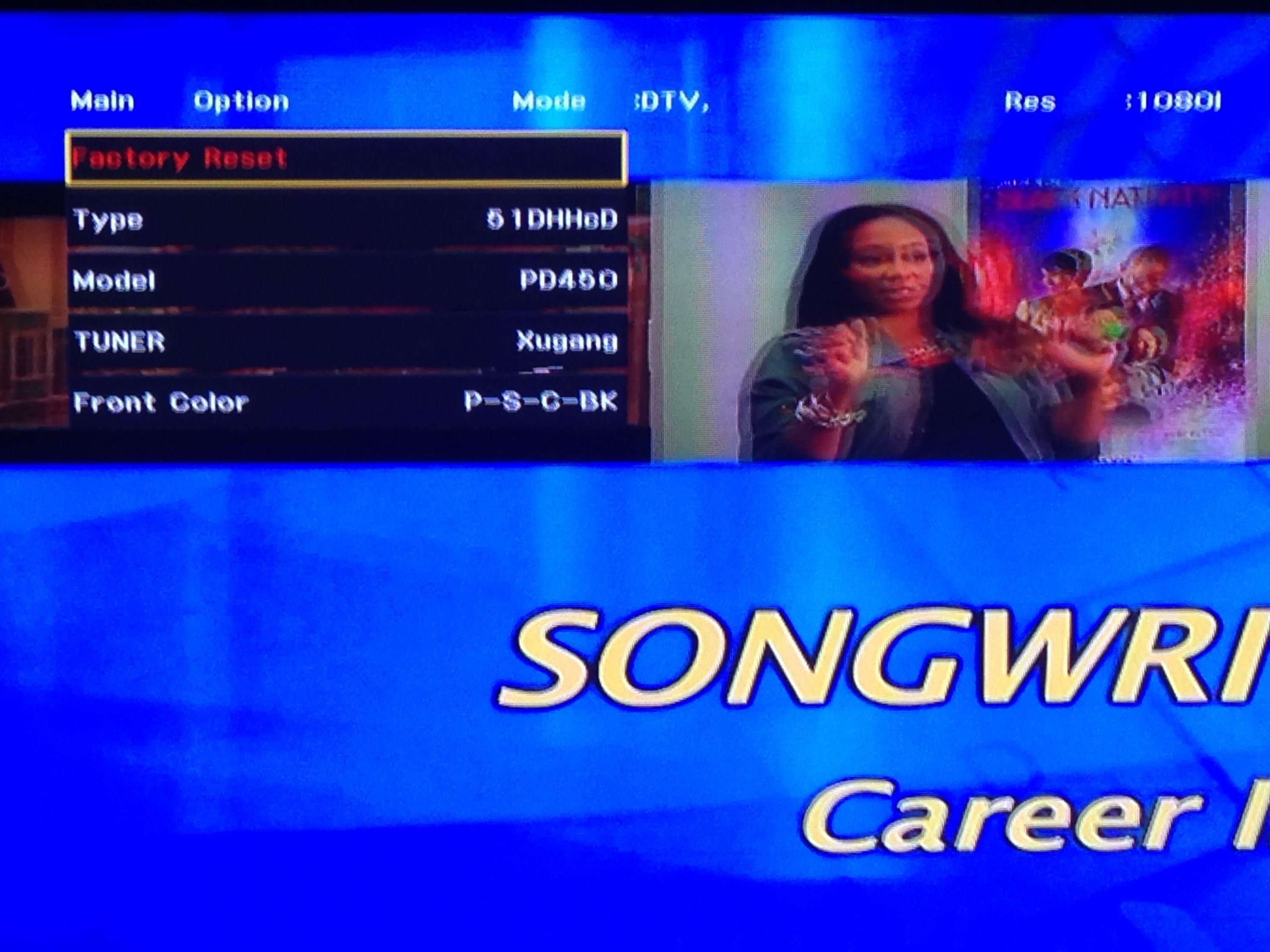

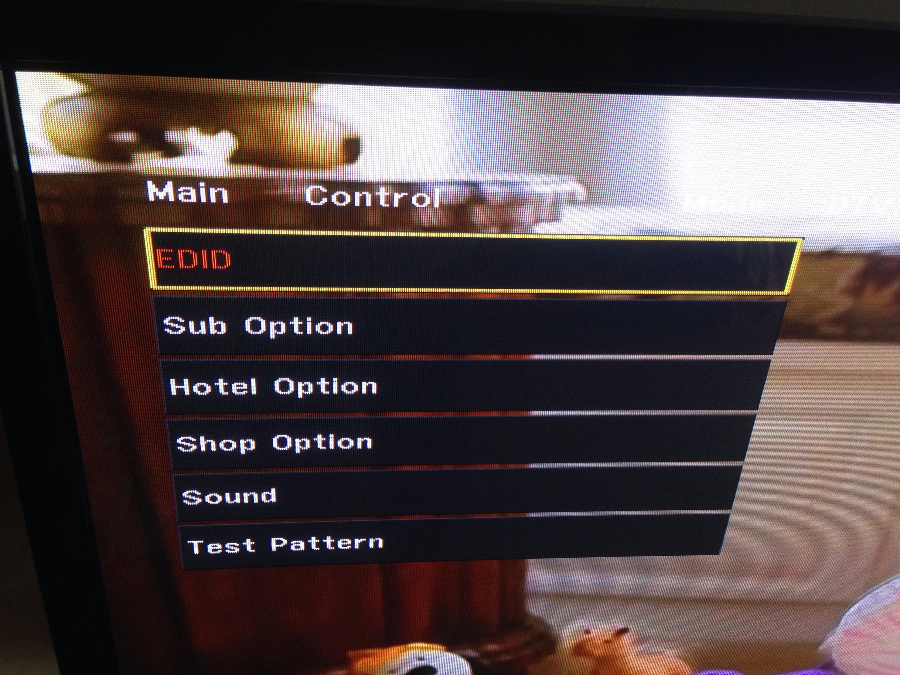

                            OK, show us what's available under OPTION and CONTROL.
                            There won't be a simple adjust, you just have to find where to set panel from 51" to 43", may not always be available though.
                              Here is the options picture.
                                  Here is control window
                                    I see under OPTION there is a TYPE option and it's 51dhhcd
                                    • Dirtbikeguy2003
                                      • Dec 2013
                                      • 20
                                      • Usa
                                      If I select it there is no other options for that type
                                      • mmartell
                                        • Oct 2013
                                        • 3189
                                        Sounds like it may be as tom suspected. Snap a pic of that screen it may be useful when returning the board should you have to.
