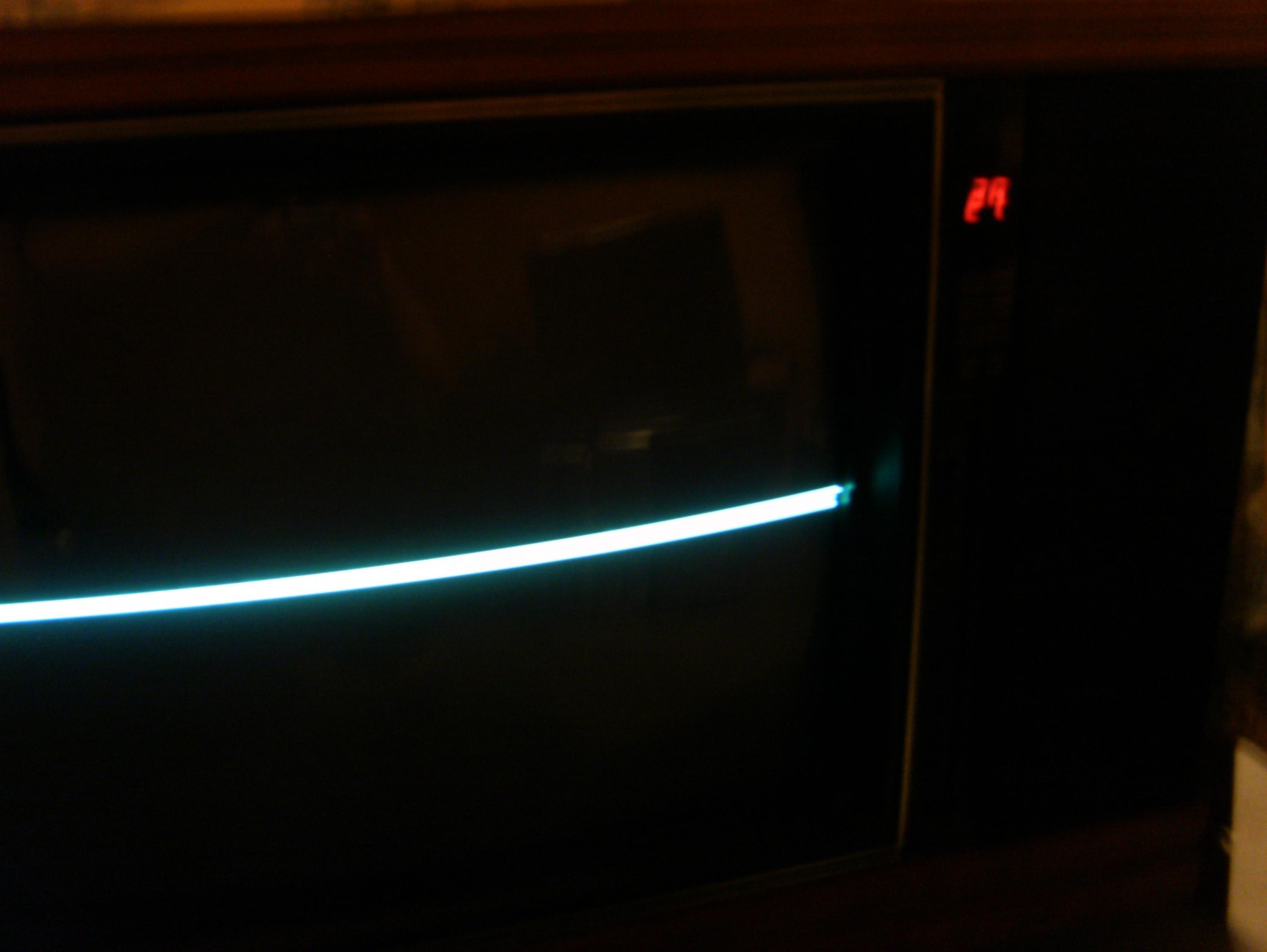

    as described tv works now channel box and buttons work now to adjust the screen i have a line as u can see from the pics and my channels are working again and need to know how to tune it really happy i fixed it myself the flyback had pop a copper wire took apart soldered and put back together just need some help adjusting it this tv is also a sanyo lxi from 1987 same thing but yeah very happy i fixed the problem..heres the story behind it this tv sat 13 years till now and i just got it working so any help would be great.. its a surprise to show my dad that his tv wasnt trash and its working again...

    ok now i get the whole screen but i get lines through the screen

      Looks like your verticle oscillator, verticle amp transistor or a bad yoke. check the verticle amp transistor first. be sure to unplug Tv and discharge the CRT. They can hold a charge for days. use a HV probe or a long screwdriver through a 3 to 5 watt resistor to chasis. before putting your hands in there. CRT can hold a 35kv charge with a
      fair amount of current when discharging

        I should have mentioned our family used to have one of these TVs same exact model make sure you don't have cold solder joints on the vertical oscillator or the vertical output transistors also there are some fairly large heat resistors and the solder could be bad underneath the board there. basically go see the mainboard make sure that you don't have any cold solder joints

          ok re soldered the flyback and found the low voltage fuse was the culprit the lines are now gone from letting it wake up it does need a bulb color adjustment bad as i can see the red and blue need to be adjusted the place where i brought it said o its no good and it cant be fixed well i fixed it so i'm gonna call them tomorrow since i paid $75 for service i'm gonna make them adjust for me free of charge . i did what i could to adjust it but yeah nes with battletoads lol..

                doesn't that TV have screen and drive djustments or is it software driven. Service menu? The crt may be weak.

                  I think that's too old to have a service menu. It'll likely be full of trimpots.
