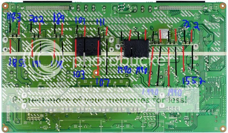

ps50c96hd ysus repair
  • wreksta
    • Aug 2013
    • 508
    • england
    ps50c96hd ysus repair
    hi all im busy repairing this board
    tv clicks when its connected but no green protection light shows
    anyways
    im trying to find out all good values of mosfets under heatsinks
    heres a picture thiese measurements were made in diode mode don't know if that's good or bad
    also the zd5502 I can test this but continuity makes a beep on my meter is it supposed to ?
    please help as much as you can as ive been on this board all day its got me at me wits end
  • wreksta
    • Aug 2013
    • 508
    • england
    Re: ps50c96hd ysus repair
    ok I think I tested thes all wrong I used 20k in ohms mode on my multi meter and all except 4 mosftes show 9.96 the four remaining show 0.14 these I suspect to be bad
    • wreksta
      • Aug 2013
      • 508
      • england
      Re: ps50c96hd ysus repair
      anyone lol and wil using a ba1 buffer set be ok or not
      • chth96
        Is it possible to test small ceramic disc capacitor with analogue meter?
        by chth96
        I read EBOOK of Testing Electronic Component and found that
        "In order to test the small blue resin coated ceramic disk capacitor which has 104 50v specification,it is possible to test this small ceramic capacitor by making use of analogue meter.
        Set to times 10Kohm that has 12v output from the probe to check disorder of ceramic capacitor.
        It is not uncommon that testing result of digital capacitance meter is okay,But It show shorted reading when you check it with analogue meter."
        Is it really possible to test small ceramic disc capacitor with analogue...
        03-09-2024, 10:03 PM
        Modification of a Fluke multi meter that uses three AA batteries to use a 14500 lithium ion battery
        by sam_sam_sam
        I have had with regular AA batteries that leak this meter is expensive new I already replaced the battery battery clips once and the same thing happened again and I am tried of so it is getting modified to accommodate lithium ion batteries that are the same size excluding the positive terminal and removing the battery clips I will have enough room for the BMS protection board
        I going to put 3 lithium ion battery in parallel with the BMS protection board and a way to charge the battery externally and heat shrink the battery pack and use a JST connector so I easily remove the battery...
        12-31-2023, 06:04 AM
      • jorpec
        Changing the scale of an analog meter
        by jorpec
        Hi
        I want to change the scale of an analog meter, to monitor the charge of an li-ion single cell, so the needle at the end would point 4.2 volts and the 0 on the meter would point 2.5 volts or so, i tried to add diodes or a zener in series with the meter but the changes of the ambient temperature also changes the voltage value on the meter
        I wonder how i can accomplish this so the meter would be precise at any temperature ?
        Thnaks
        01-23-2023, 10:37 AM
        How an incandescent light and a ESR meter ** friend**have a machine blowing fuses
        by sam_sam_sam
        About a month ago we had a transformer jumper wire that burned in two different places between two transformers caused over $200 thousand dollars worth of damage to VFD drives at least 10 of them and a memory card and quite a few power supply as well
        Now we have most of the equipment that got damaged back up and running except a feeder that has issues and we are waiting for some parts for
        Now we also have another piece of equipment that was blowing fuses on the 110 volt controller switch circuit with the ā€œEā€ stops and one switching power (24 volt) supply and a transformer...
        12-14-2023, 07:45 PM
      • legg
        LG 42PC3 buffer output doesn't follow YSUS
        by legg
        LG42PC3D -UD originally with green lamp but no display or audio.
        Owner says was working, then went 'pop'.
        All 5V caps bulging. replaced.
        All PSU output voltages within spec but -Vy is low on YSUS.
        One of three parallel fets between SUS_OUT and SUS_DN is zenering,
        eventually shorts DG. Replaced all 3 - -Vy now OK.
        Y scan buffer test point does not follow YSUS output below -50V
        Note: This unit seems to expect YSUS output to park at -Vy in between
        drive signal pattern periods. A replacement drive signal board confirms this....
        11-18-2021, 11:49 AM
