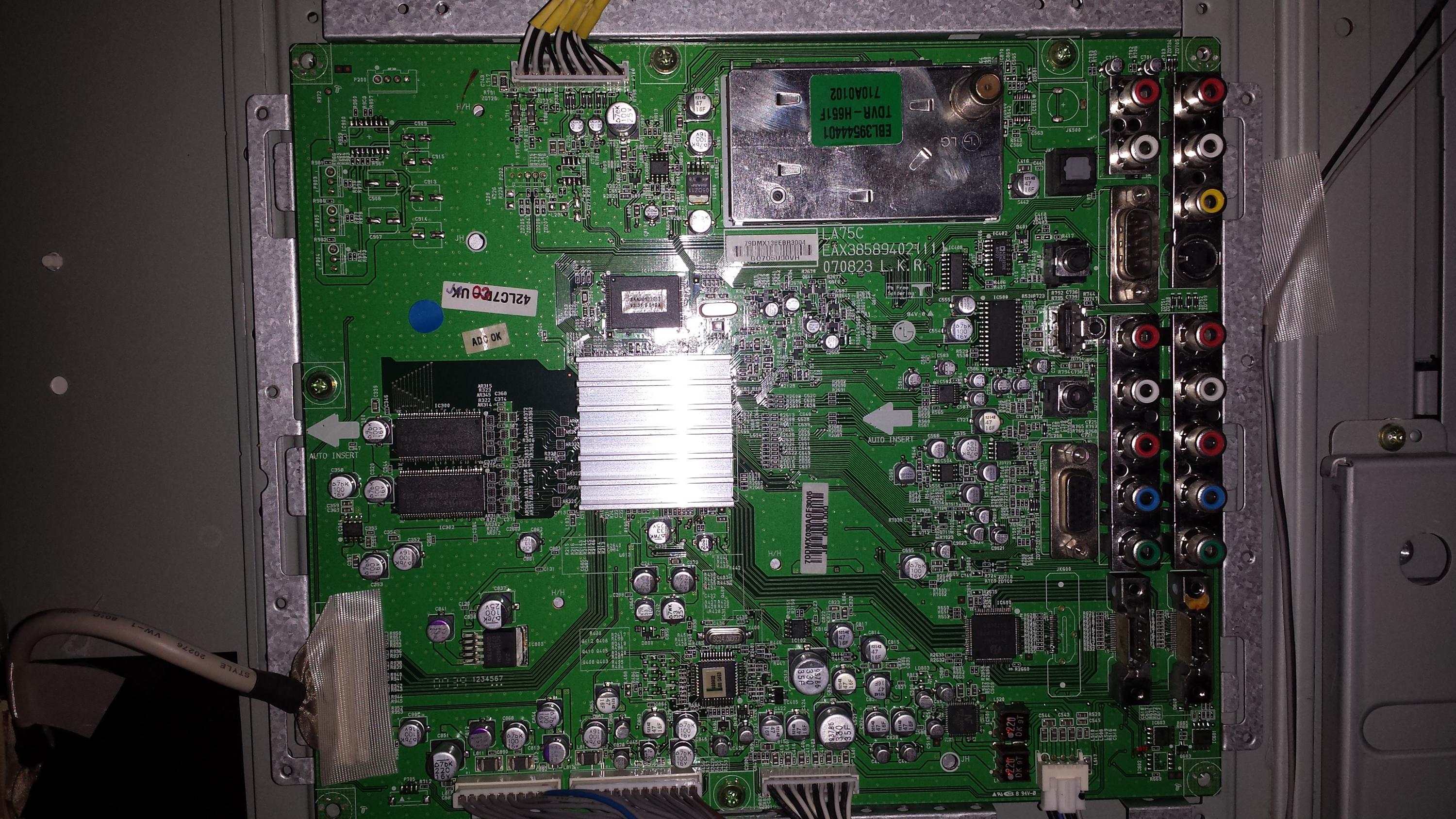

    NOW I realized I have another similar tv that I replaced caps on the PSU and it fixed it right up. an LG 42LC7D. So I opened it up, and the boards seem similar minus one HUGE cap on the PSU. I played some adult lego I tried the main board from faulty 37" in known working 42" and everything works.
    Then I tried the working 42" mainboard in the 37" and no difference.
    I tried the known good 42" PSU with its respective mainboard with the questionable 37" screen and t-con board (I think) and still no picture. I haven't tried switching the t-con boards because I'm not sure thats safe?
    Sound works, I can blindly switch inputs, just NO backlight and NO picture with 2 different PSU boards and Main boards.

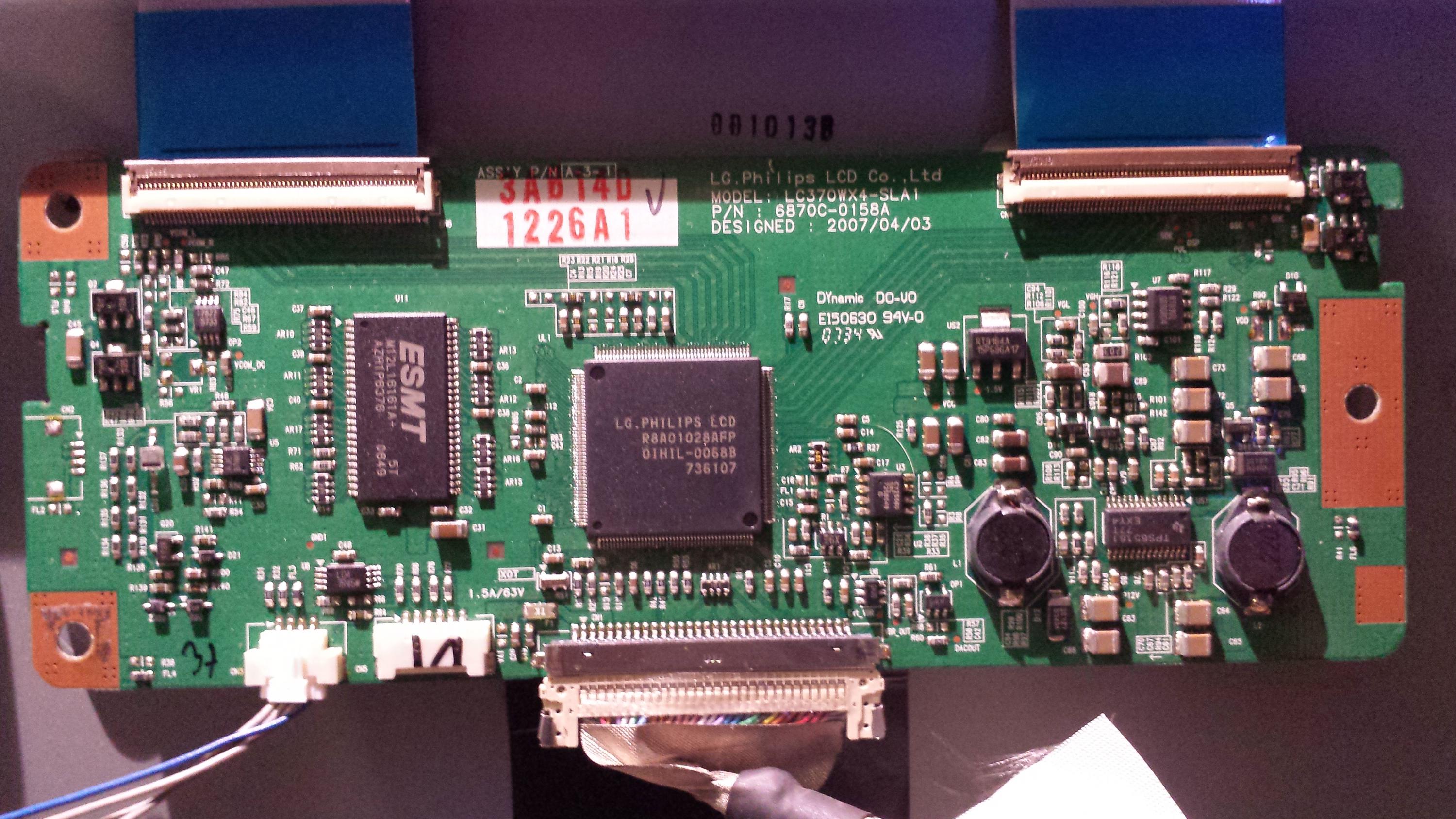

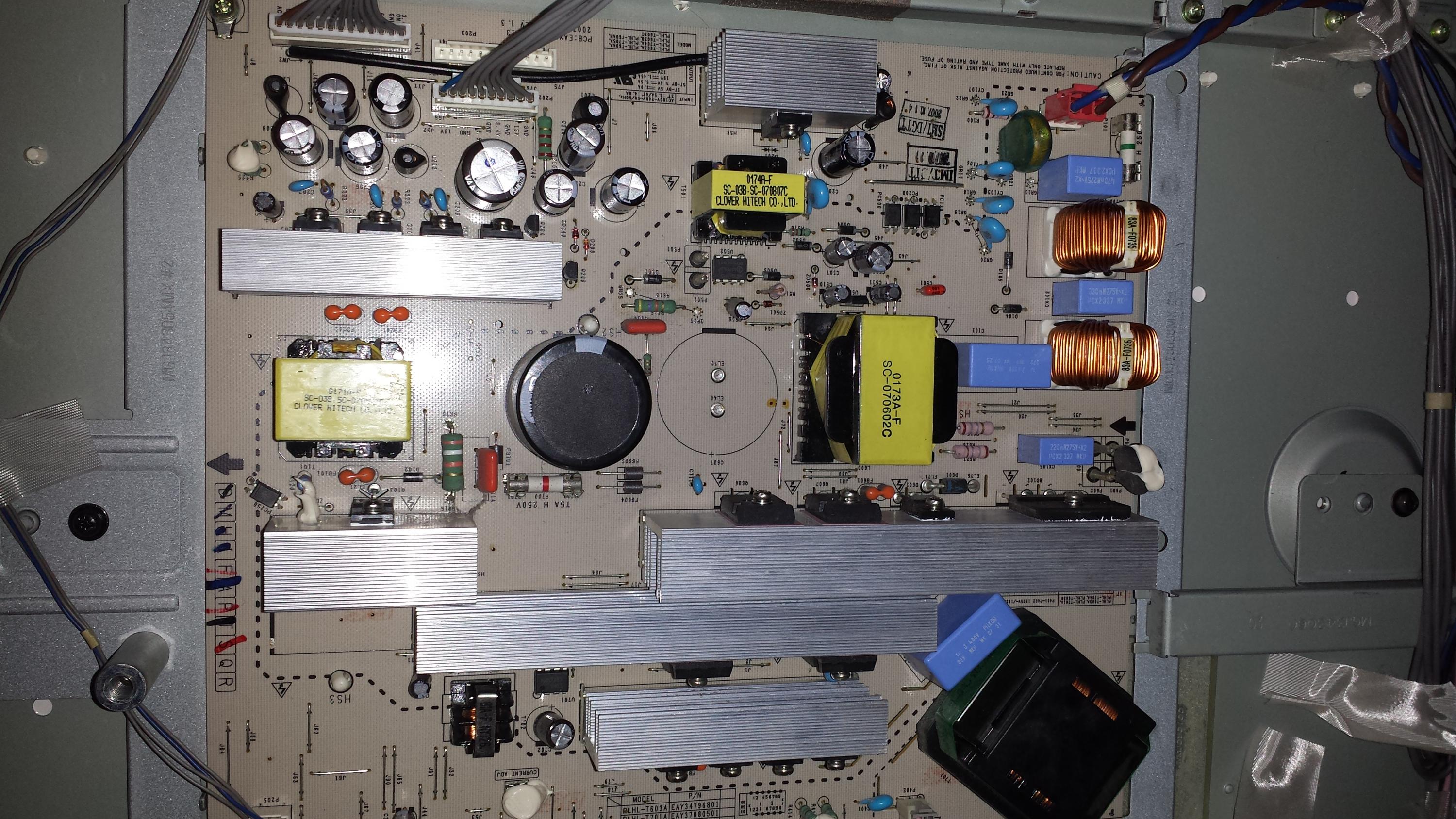

      Here are pics of the 37" LC7D.
      Fluke 87 III by my side.

        From the PSU
        P203 (all grounds read -.006)
        12v=12.43
        6.5=6.28
        3.4=3.462
        p201
        ACD =4.89
        ON/OFF=2.882
        ST5V=5.00
        INV-CNTRL=3.087
        ERR=.229
        BURST-DIM=.033
        ST5V=5.00
        A-DIM=.025
        6.5V=6.28
        3.4V=2.377 :/
        P202
        12v=12.42
        3.4v=3.449
        6.5=6.28
        19v=19.50

                So there are only 2 more components correct? The screen and the T-con board? how can I t-shoot the t-con board?
                How Likely is it that the screen(and backlight I suppose) are just dead?
                  Re: 37" LG 37LC7d No picture, No Backlight.
                  I would try getting the backlights to come on first with your good boards. T-CON can be replaced or may be repaired, but bad lamps will get real expensive.
