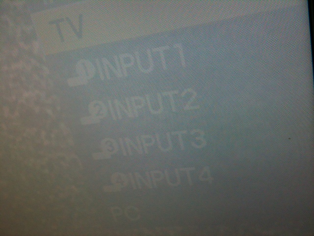

    Hi guys,
    Been a while since I've been in, life getting in the way etc.
    Recently was given a Sharp LC-37HV4E to repair, a strange one this - comes with an AVC unit which separately controls the video. It is linked to the TV (monitor really) by what looks like a DVI cable, and some other strange one I've never seen before (perhaps a proprietary one)
    The story is that this TV was working, and after a house move is now not.
    Long story short, the picture is very washed out looking, looks almost like the brightness is turned up too high. Only a tiny hint of colour in it. Anyway, pic attached. Took it close up so the camera could actually see what was on the screen.
    Any tips before I dig deep into this one? (Already tried reseating the ribbon cables to LCD and looked over the boards for suspect caps, gave the video chips a poke on the main board in case of poor joints etc)
    Cheers and its good to be back

    It looks like something went out in the Gamma voltage ref, circiut in the T-CON board.
    Similar to this:
    https://www.badcaps.net/forum/showth...mma#post304275

      Re: Sharp LC-37HV4E washed out pic
      Cheers Bud, I came across that post last night while searching the forum. Unfortunately the main board (for what there is of it) and tcon are all one.
      I will check voltages etc and get some pics for the weekend.
