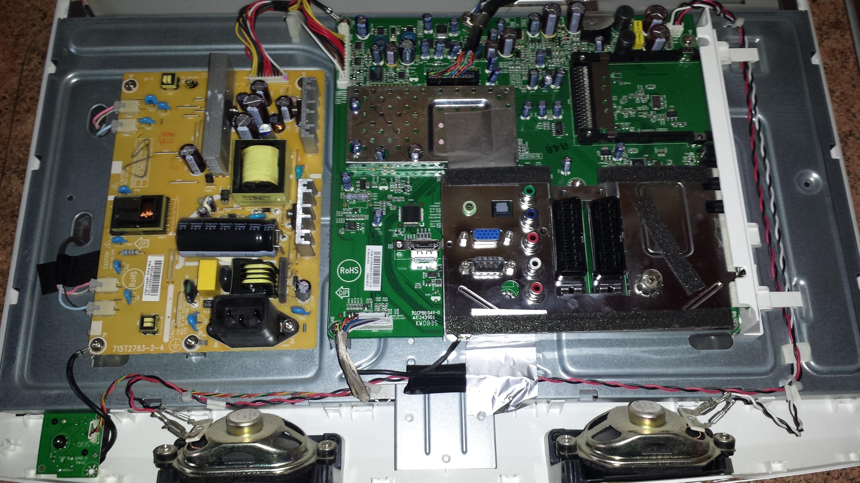

    22lg3010
    Any idea on this tv has a mind of its own when you go into the menu and try to change things it skips all over the place
    possible sensor or main board ?
    thanks
    Re: 22lg3010
    Is this an LG brand TV? Not an LG inside. Didn't know LG were rebadging in the UK too.
    Isolate any button board.
    Try MENU on remote, MENU on TV for service menu; or, Input 3690 or Input 2580.

      Re: 22lg3010
      cheers tom managed to get into the menu seems ok for now
      http://www.superfi.co.uk/p-7685-disc...elevision.aspx
      thats the LG tv
        Re: 22lg3010
        Yeah just a rebadged model, what a shame LG... I almost had respect for them...
