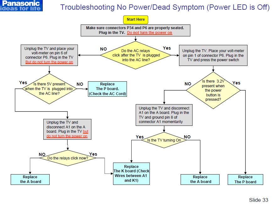

          I have the TC-P55GT30, now there was a pwoer outage a few months ago and now the tv will not turn on at all.
          I've tried everything. I've tried replacing the board twice, I've tried replacing teh part of the socket, even tried replacing the power button.
          Nothing. Same problem as always.
          What's going on?>

            Need to give us better info, like what has been replaced twice? The power board?
            Is there any power indication like the standby LED?
            Any clicks from a relay on plugin?
            These later models i believe if the PSU is shorted on startup will not produce a blink code or maybe the A board is dead if you had a power surge.
            SC board failure is also very common and can short the PSU.
            Describe in full what happens from when it's plugged in to when you turn it on and if there are any blinks of the front LED.

              Replaced the power board. Also tried a different power switch and power filter. And a new power cord.
              No clicks. No sign of life at all.
              So you're saying it coudl be the "A" or the "SC" board?

                First try different wall socket or check this one where you plugged tv in
                Download manual from elektrotanya.com
                If there isn't power indication by power led there are 2 possibilities (acoording to manual):
                P board or A board
                Check fuses on P board: F101, F102, F103, F301, F451, F501
                Than you can measure resistances on P board connectors (when tv is of)
                I know you probably did all of this but we have to know everything you did, it would be easier to troubleshout this problem if you give as much as possible info

                  I'm leaning towards the A-board.
                  Here's a flow chart for this condition out of the ST30 series training guide but I expect should also work for the GT.
