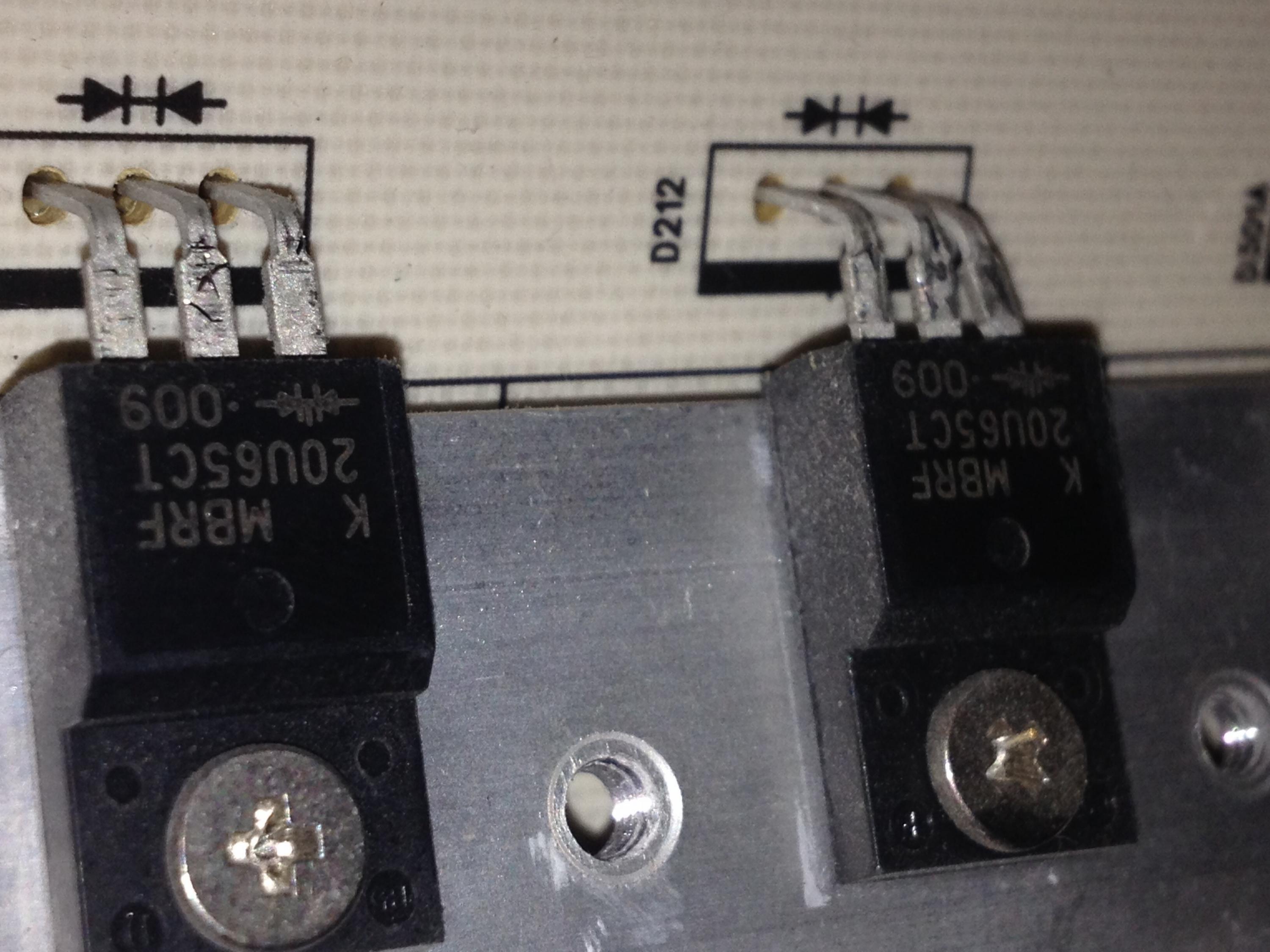

    Need data sheet
    I been looking online and can't find this data sheet for a 20u65ct.

    Re: Need data sheet
    Here is a picture of what I need a data sheet for

      Re: Need data sheet
      You can tell the specs from those numbers on the chip.
      schottky barrier rectifier (or two schottky diodes in a package with the cathode common)
      20 is maximum 20 Amps
      65 is 65v reverse voltage.
      Replace with anything that has 20a minimum, around 65v or more, in a package that's insulated (no metal tabs etc) or get even something with metal on the backside but then make sure you insulate the part with some mica sheet and use plastic spacer for screw etc etc

        Re: Need data sheet
        Perfect thanks. Cause one of these I showing 18v and the other 12 v

          Re: Need data sheet
          That could be OK, the voltage rating on those parts just has to be ABOVE the voltage going through them, and usually it's a good practice to go 2-3 times the operating voltage. They probably went with 65v rated parts because those were the cheapest they could get.
          It could be perfectly fine for one to have 18v and the other one to have 12v, it depends on the design.
          Just use your multimeter in diode mode and test the two diodes for shorts, if they're not shorted it's a good part.

            Re: Need data sheet
            O. I figured it would put out the same voltage. Yea I did the diode test on my mm and they read fine.
