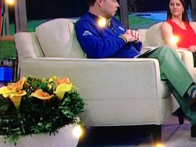

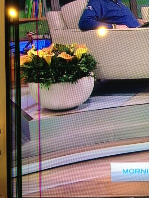

    Great forum guys.
    Sony Bravia 52" LCD
    I used the info here at badcaps to fix a large dark area of my screen caused by bad tab bonds.
    Now i have several multicolored thin vertical lines on the left side of the screen (see photos).
    There are also a couple of horizontal lines (one can be seen running through the sofa on one of the pictures.
    i assume a bad panel but wanted to get confirmation before it goes to the landfill.
    Thanks in advance

    Scrap Panel
      Re: Sony LCD Vertical lines and two horizontal
      Agreed. Panel has died. That makes 8 this week I have counted. Dead plasma panels: 0 this week.
