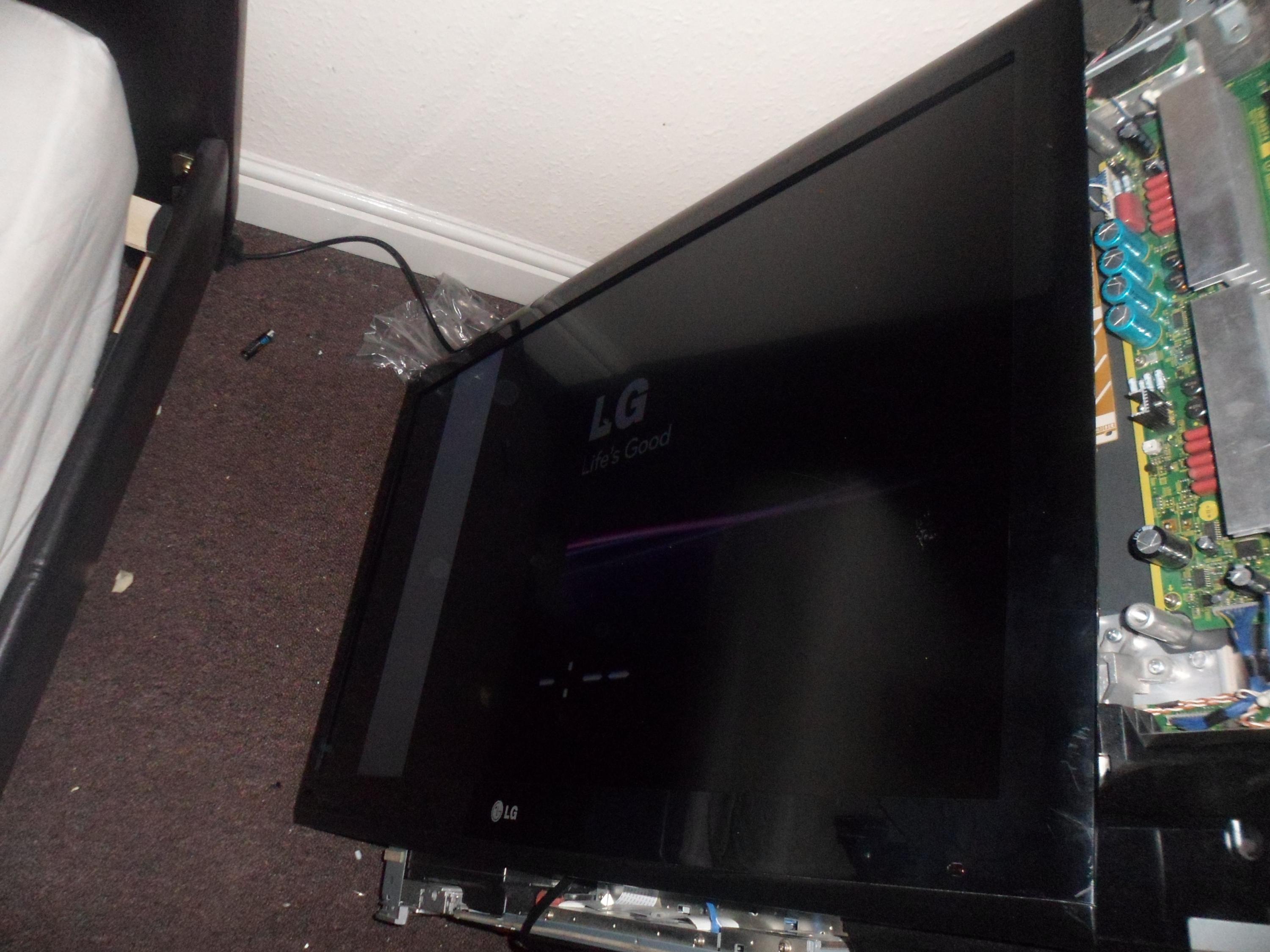

    Got this one in with backlight no picture. My first large screen LED TV.
    Proceeded to find L701 ferrite bead on main board to be open circuit, it feeds T-con power. (There was no voltage at t-con.)
    Fixed that but am presented with this. Half panel works. White bar on part of panel.
    Found evidence of water damage on the 2nd tab from left, so I think this panel is toast.
    Can't win them all .

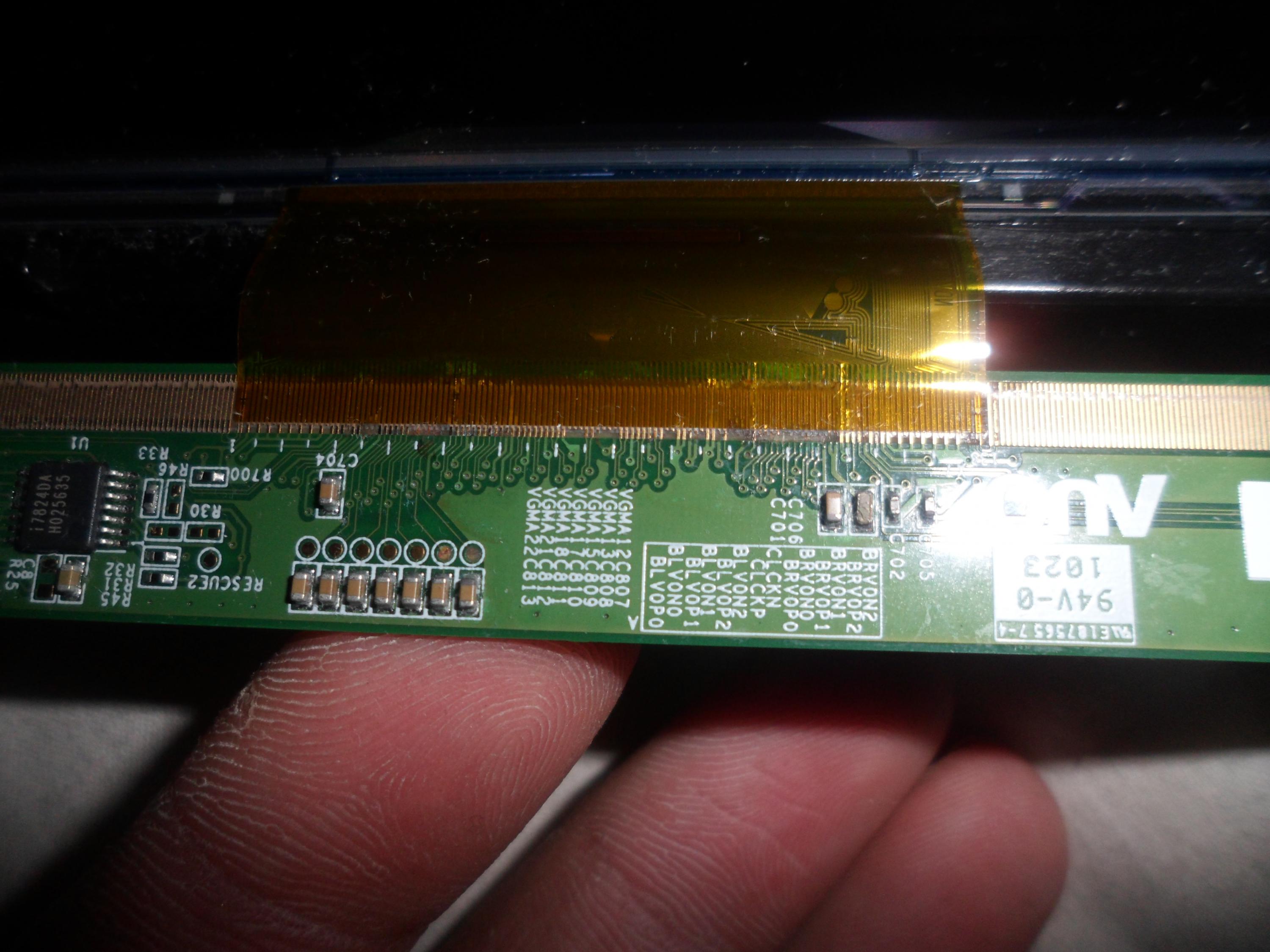

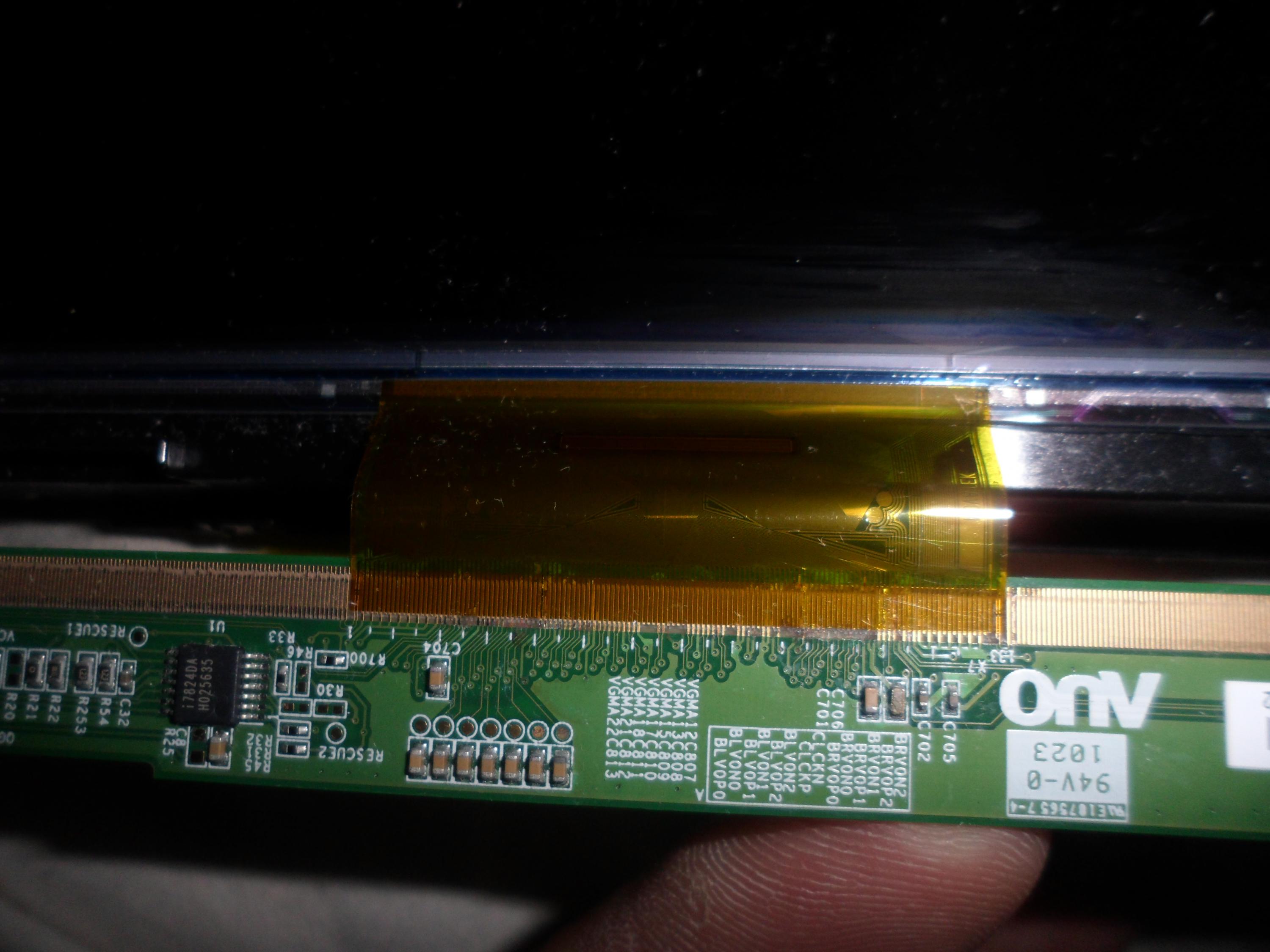

    Here's a closer look at the damage.
    Damage to the ribbon bond point and the tab itself is visible; I was not able to fix this (not surprising.)
