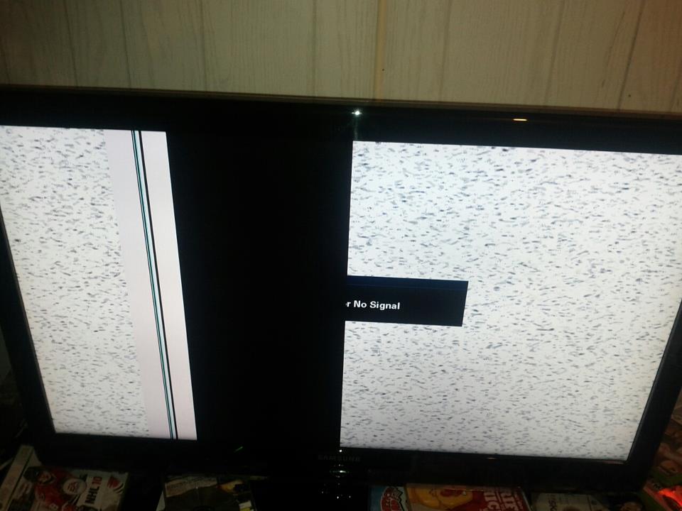

    I have read that this could be multiple problems. I came home from university and saw my TV like this.
    I've heard it may be the panel, but from what I've read and hope is that is the TCON Board. I've done a bunch of searches, but I just want to make sure before I dump any more money into it.
    What I've tried so far
    1. On and Off
    2. Updating the Firmware (Which was a pain when I couldn't see half the screen)
    I once let it sit for awhile just to see if it would fix it self, and then colours spread across the screen. Like vertical colours almost like a rainbow. I had a picture on my old phone, but I'm not sure if I lost the pictures. I will have to check when I get home.

    The vertical bar indicates the tab bond IC burnt and is not fixable.

        I had a similar problem but my bar defaulted to grey it was most definitely repairable. Tab bond - mine was getting too hot and blowing air across it alleviated the symptoms.
        Worth a shot I would say. I will try to find the thread by budm that I used as a guide.
