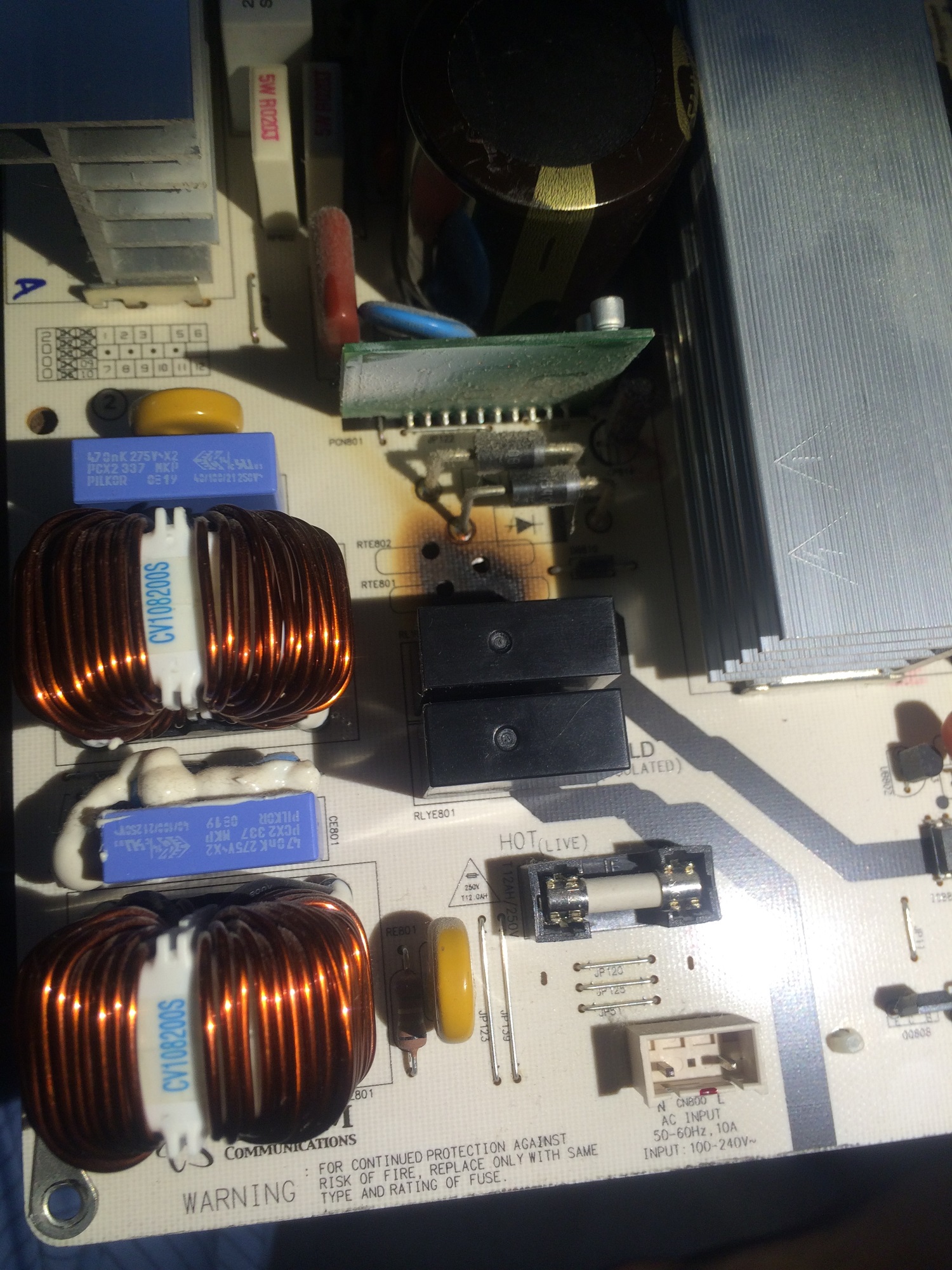

    I have a Thermistor im looking to replace labeled SCK 0512 - looking up it says 5 ohm 12 A in a PSU.
    Is it possible to replace it with a different value? If so what's the general rule to do it?
    Re: Thermistor Replacement Substitute
    5 Ohms will limit the maximum inrush current to 24A (if line voltage is 120V and load is 0 Ohms at start up). Is it used for feeding the bridge?

      This is from a bn44-00222a PSU. There are two thermistors next to the failed relay. I don't have any replacements for it at the moment, but I do have SCK-206 (20 ohms 6A) but I'm not exactly sure how thermistors work.
        The thermistors should be bypassed as soon as the set begins operating, so the rating is more to prevent their failure rather than for the power supply to operate properly.

          I see, so choosing a higher ohm rated thermistor will further decrease the max current that can come through if there were to be a surge?
            It would have no effect on a power surge.
              So the relays failed to come on or the relays are not being turn on?

                One of the relays failed completely, (It was completely melted and burnt). I already replaced it though
                • Kiriakos GR
                  Banned
                  • May 2012
                  • 940
                  • Greece
                  You may use one 5W 0,22 Ohm for a quick test, if it works then buy the thermistor.
