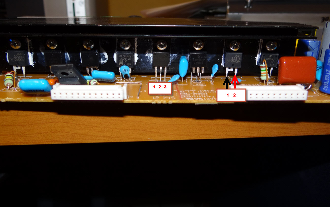

                    Ok, I've attached a pic of a Y-main from a similar TV. There should be a bunch of three-legged transistors and two-legged diodes on the Y-main's and the X-main's silver-colored large metal heat sinks. In diode mode on a multimeter, do the following:
                    Diodes: You're going to want to touch the red probe to one leg and touch the black probe to the other leg. Record the reading. Reverse the probes then record the reading. If any read 0.000, you have a short.
                    Transistors: The test is similar to the diode test, but you'll be alternating between combinations of the three legs. Again, if you see 0.000, you have a short.
                    Edit: If you find shorts, the board and it's buffer board should be replaced. These Y-mains and X-mains are not good candidates for component-level repair - trust me

                              Ok I was able to get a working multimeter.
                              Multimeter being used and set to the appropriate settings per pic I believe.
                              I was able to get the board out without any issues. I started testing each diode from left to right at each screw location. (8 of them)
                              The transistor marked in your image gives me 0.000 when the probes are applied alternating. The diode as pictured in your image above gives me 0.000 with alternating probes applied. The other transistors and diodes give me a reading. Some are OL.
                              • capkid
                                • Oct 2010
                                • 1339
                                Re: Insignia NS-50P650A11 clicks
                                So, it looks like your Y-main is bad. Try the X-main, also.
