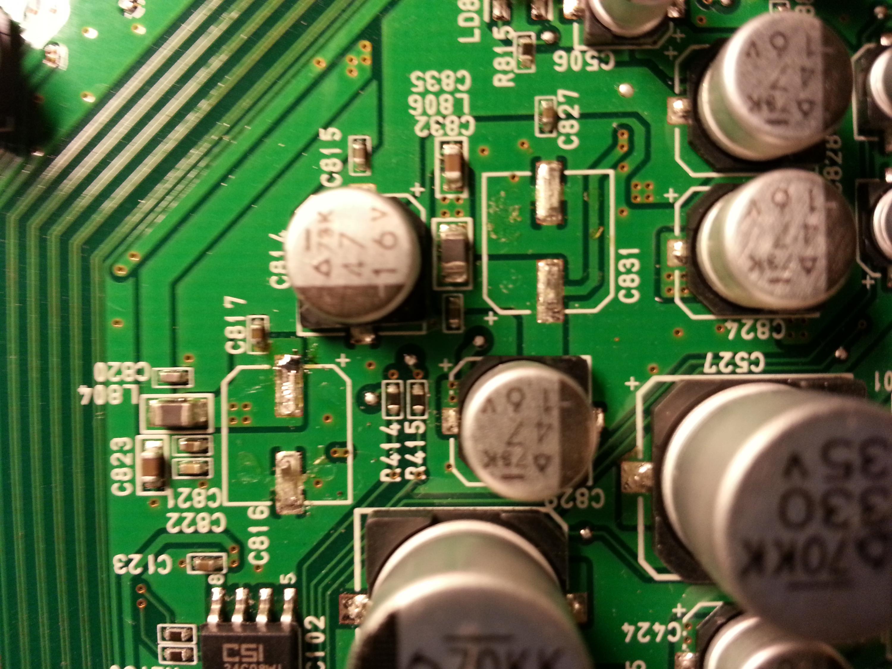

                        @truep, yes I tested for voltage on both sides of the fuse and it was there. I think it was 12v but that was some time ago.
                        I've found a few shorted capacitors on the mainboard and removed them but that circuit is still shorted. Perhaps this could be the root cause ?
                        I will attach a few pics and maybe I could get some input on what to check for.

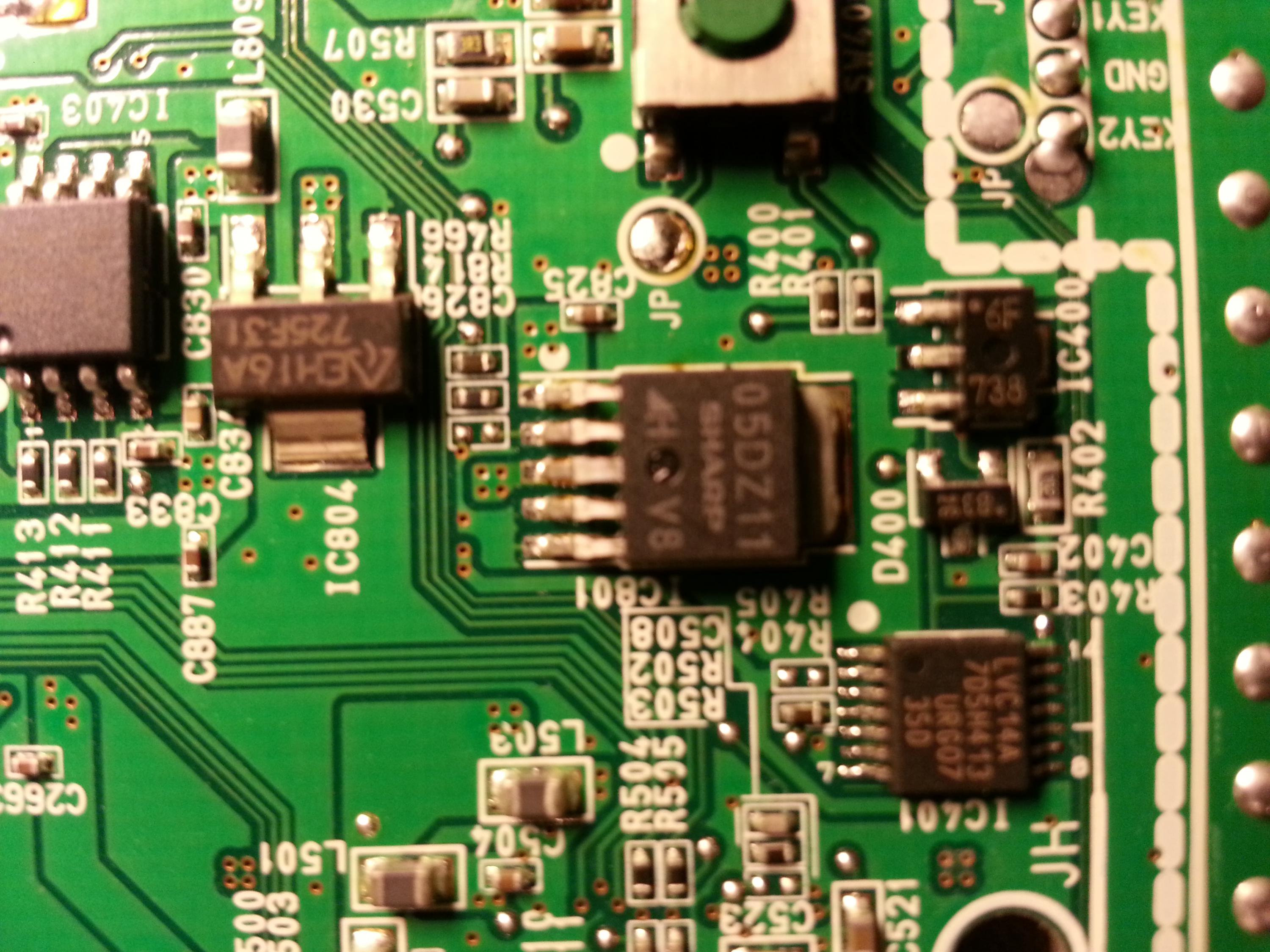

                          Re: How Can I Verify Existence of Video Signal with a Scope ?
                          C816 and C831 were removed from board and tested ok. Many smaller smd caps in that area test for short consition as well.
                          Second pic is the area directly under the first pic.
                            As you can see, there will be small value (<1uF) SMD MLCC in parallel with the electrolytic cap. I.E. C817 is in parallel with C816. MLCC when it failed, it shorted out. You can also have shorted load.

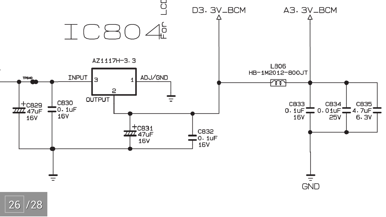

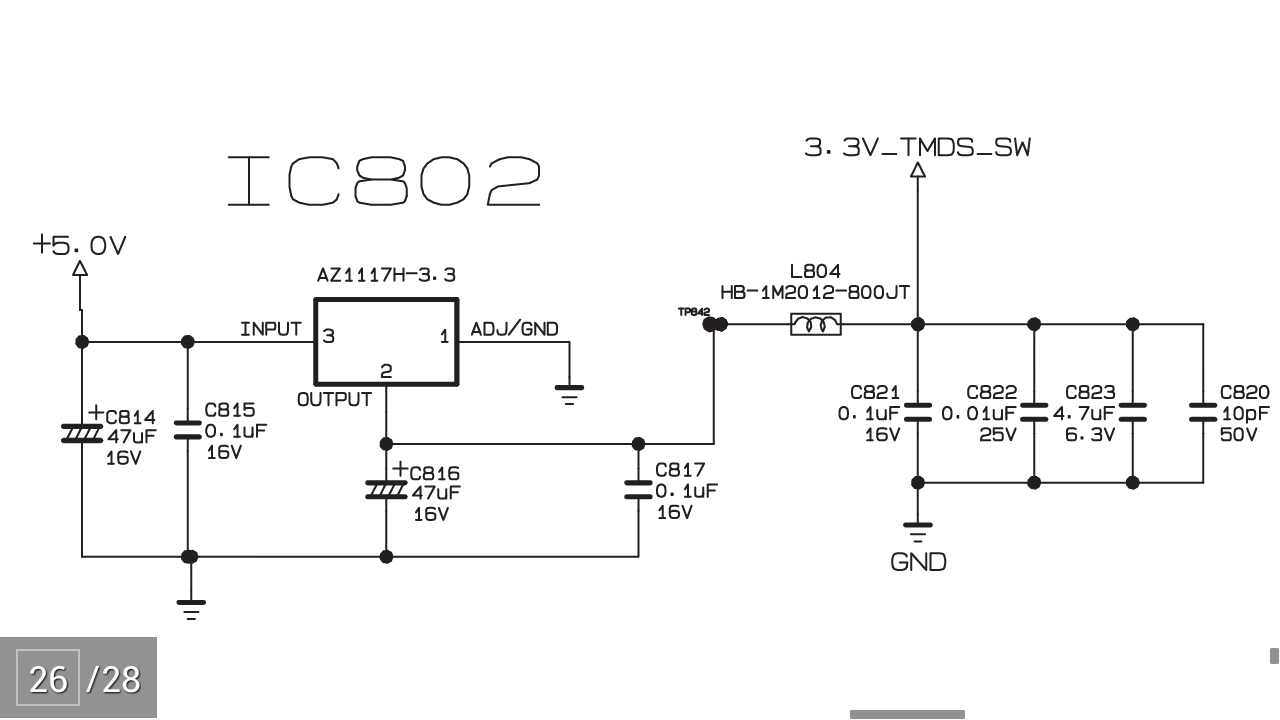

                                Oh happy days I've found a schematic that fits what I'm seeing on board. Both are part of 3.3v regulator circuits - one for BCM and the other for TMDS_SW for whatever that's worth. When regulators fail do they often short out ? These are listed as AZ1117H.
                                • mmartell
                                  • Oct 2013
                                  • 3189
                                  Here are the relevant circuits.

                                    MLCC: Multi Layer Ceramic Capacitor.
                                    Regulator can have failed Output shorted to Ground, input shorted to ground, Input to Output shorted. You can remove it to find out.

                                      Well I was busy patting myself on the back after removing the two regulators and the short still exists.
                                      After removal one shows the center pad grounded and on the other the tab pad is grounded.
                                      I have now officially managed to confuse myself further haha.
                                      At this point I would *guess* the short lies further up where the 3.3v sources are attatched.
                                      What do the trained eyes here see ?
