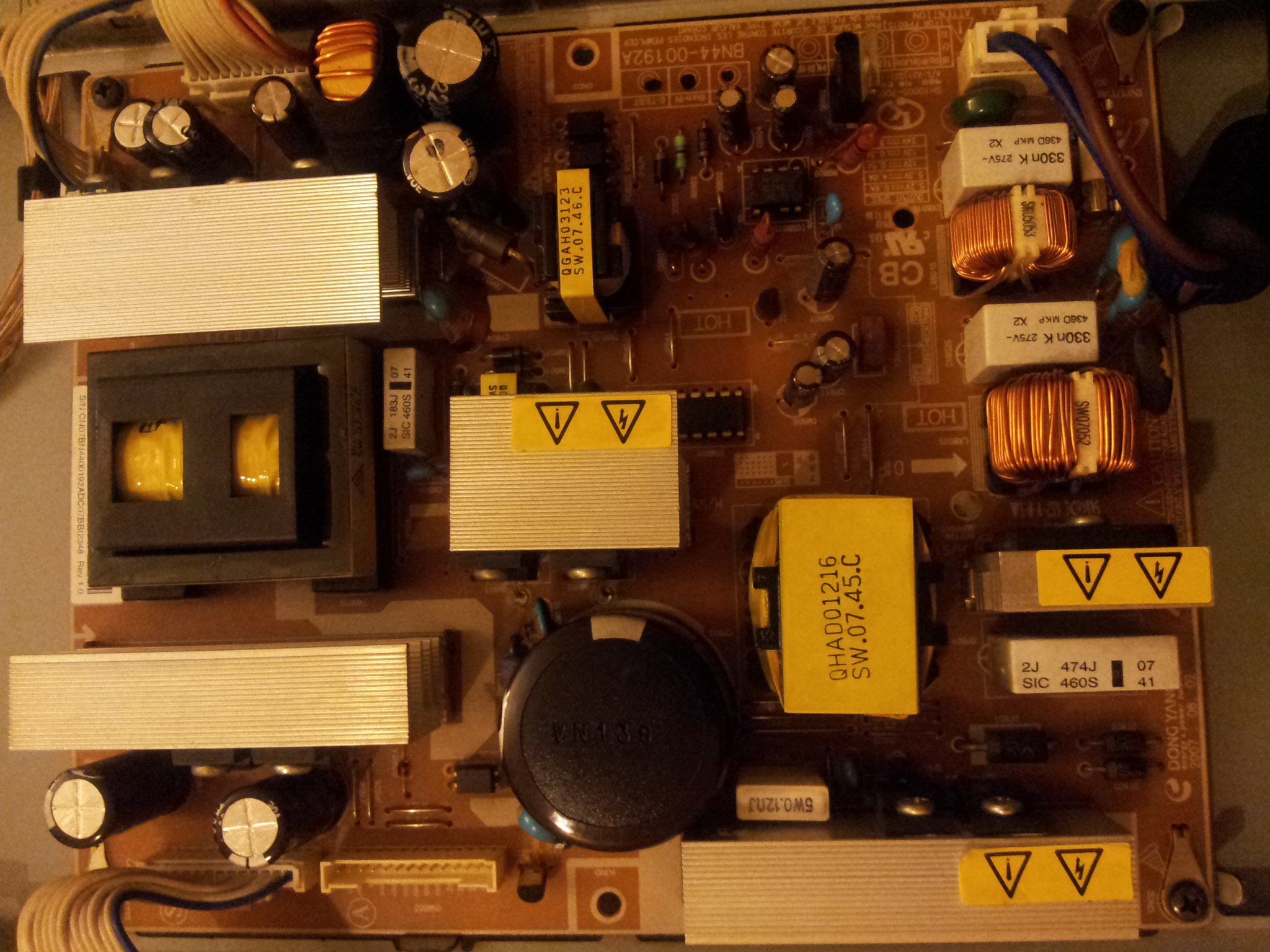

    My Samsung TV Model LA26R71BA has intermittent audio turn off for 5 seconds and then on again. This happens for about 10 minutes and then the audio is ok.
    May I know which components should I check? I have already changed the caps.
    I attach the power board.

    Usually on these sets there is a separate 12V supply for audio and a 13V supply for other stuff. 12V supply uses a simple linear regulator and regulates the 13V supply. Check the 12V output. If it's bad, try new thermal paste on the regulator; if that fails, replace the regulator.
    This is a close schematic for the 192B variant (you have 192A):
    You can see 12V regulator ICM853.

      The voltage output from ICM853 is 12.33vdc, same as the input voltage.
      When there is no audio, the output voltage is still 12.33vdc.
      Must I apply new thermal paste to ICM853? Or is there other components to check? Or should I replace ICM853?

        Ah, I had hoped that was your issue, but it is not. We would need to look at the main board next if the 12V is good. Part# on main board (BN96...?)

            Re: Samsung TV Model LA26R71BA
            That's the power board; the main board is the board which takes the video inputs.
