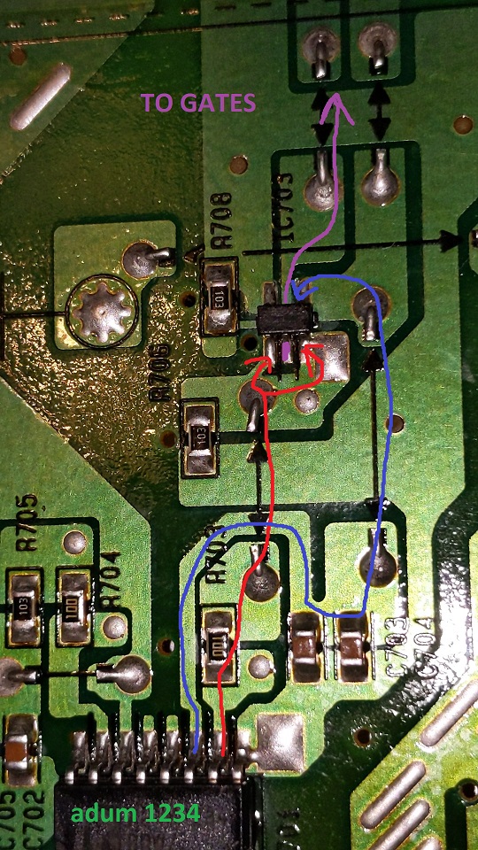

                              Re: LG 50PJ350 dead, relay clicking
                              Bad IGBTs were Q22, Q24 and on of the Q02, Q03
                              R709/10 and R711/12 and R730/31 and R372/33 - all good
                              IRS21850S is connected to the gates of the Q02/Q03
                              ADUM1234BRWZ is connected to the gates of Q22/Q24 via the small IC703
                              here is the photo:
                              • R_J
                                • Jun 2012
                                • 9535
                                #35

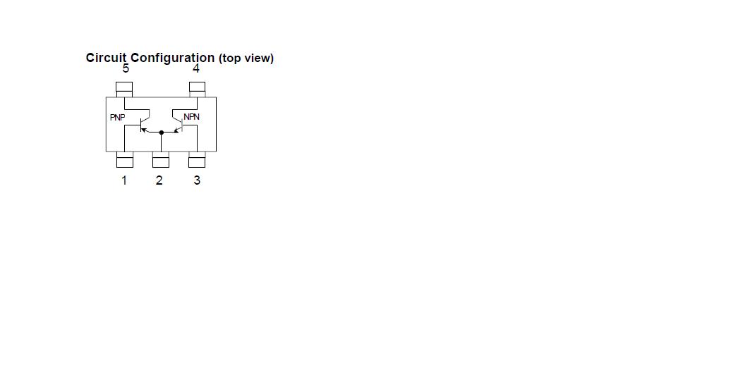

                                You should be able to check ic703, it has 1 PNP and 1 NPN transistor. You might be able to check the IRS21850S, check that there are no shorts between VS~HO and VB~HO

                                  #36
                                  Verified. all looks good.
