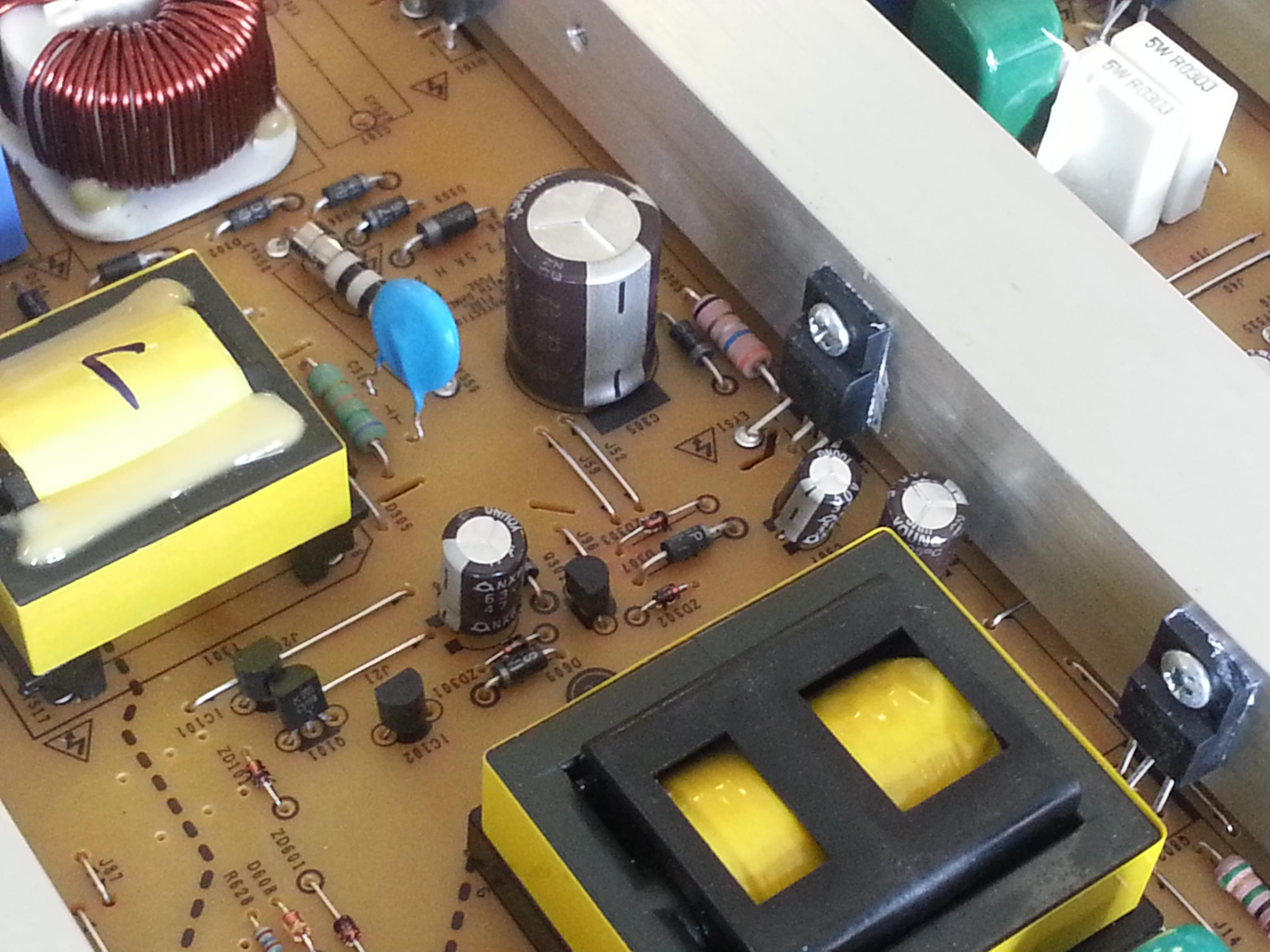

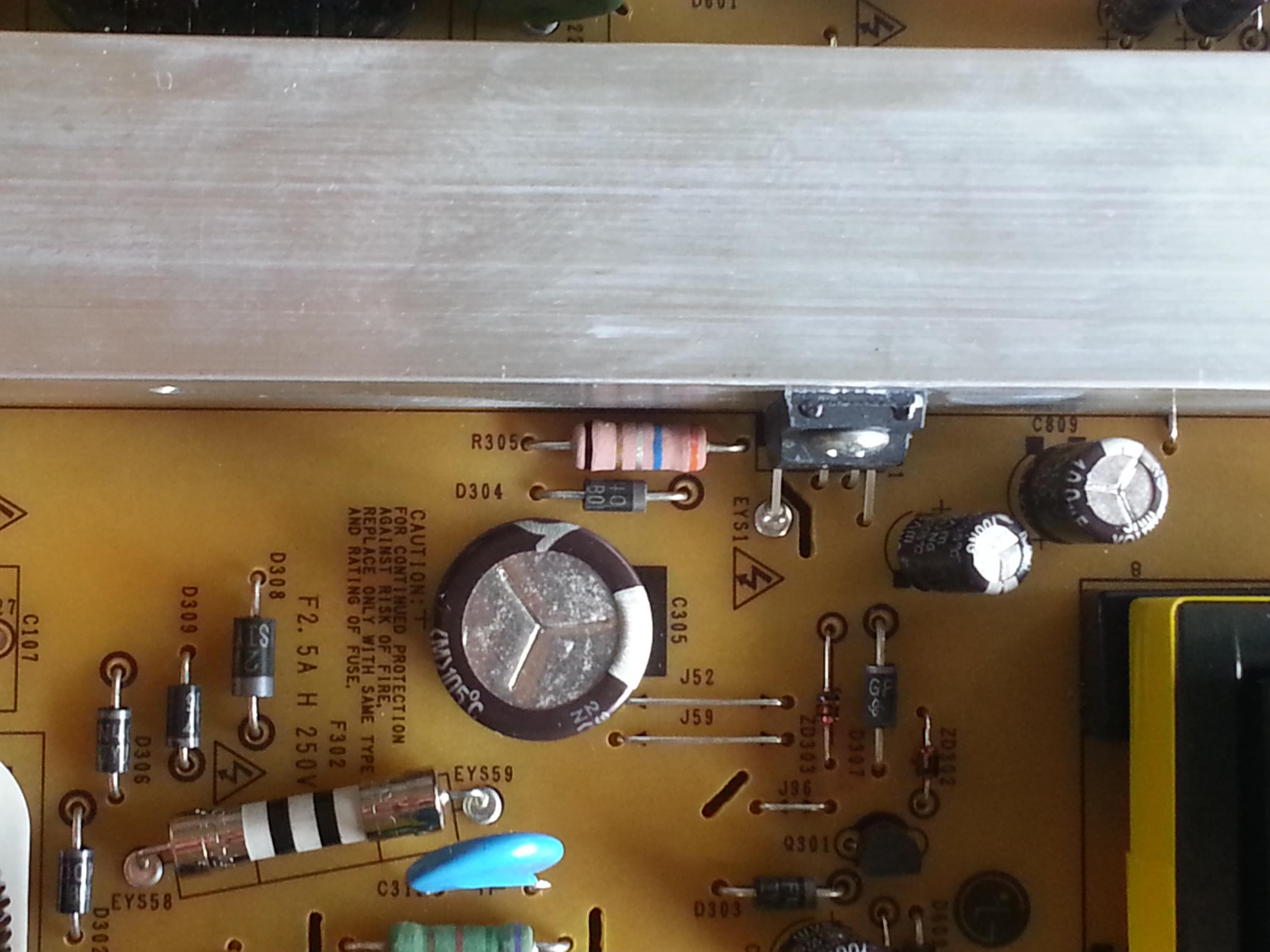

    What should that diode read?

      Re: Z50PJ240 Powers on then back off clicks but no picture
      Originally posted by soog35
      visually it looks fine but I get 00.7 on that resistor.
      Then it should be the same across the diode then D304, they're in parallel to each other. Where did 266 come from then.
      • tw2005
        • Oct 2011
        • 6458
        #83
        In diode mode could be o.5-0.7 . Which one are you probing and I'll tell you mine.
        • soog35
          • Oct 2013
          • 55
          • usa
          #84
          Checked the diode in diode mode and the resistor in ohms

                                          #100
                                          TW and TOM
                                          I got the new PSU but haven't installed yet. The D304 diode seems to be open, so this could be defective. I have a pic of the diode and a video link of me testing it. Do you guys think this would give me trouble if I install this as is. I don't want to mess up anything else. I still have a good diode I could replace it, or maybe I need to send it back. Does it look bad to you guys?
                                          http://www.youtube.com/watch?v=q-U5mcdy2kA
