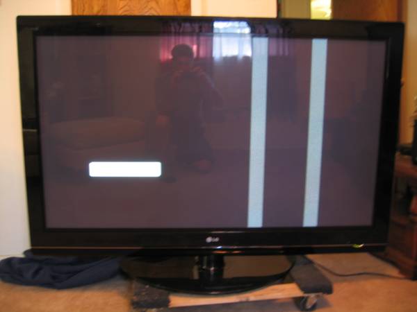

    Hello Fellas.
    I have a Lg 60ps11 with 2 vertical lines crossing the screen. (top-bottom)
    Does these lines caused for a buffer boards (called x-board right on lg) ?
    or Sustain boards.
    Re: 60ps11 Vertical Lines
    Unfortunately they probably mean the plasma display panel is bad, which is not economically repaired. Can we get a picture of the fault?
      Yes of course.
        That could just be a loose connector for that part of the panel or a bad control board.
            I second the control board. Refit.ribbon cables to start.
              Hi.
              Something I did it was disconnect the control board from x-board left (because does lines show to the left looking at from back) and from x-board center and those lines still are on the screen.
                Disconnect the wide white ribbons from control board to bottom of the screen and reconnect
                  and if that doesn't work try taking a wooden dowel or something like the back of a screwdriver and while you're watching the screen push on the main IC on the control board and see if the lines disappear
                    I did it that but still lines are there.
                    both ways (disconnect and push the ic)
                      training manual for this tv (page 97)
                      show
                      if there is a bar defect on the screen it could be a control board problem.
                        Yes. If I were you id order t he control board. If there were only one line I would be more thinking screen defect but two leads me to believe its the control board.
                            Hello Fellas.
                            I already change the control board and still have two vertical lines.
                            Bad panel?
                            Thanks.
                              It is possible for the C boards/X boards to do this too but unlikely.
                                But what is the chance panel is bad???
                                  That is more than possible.
