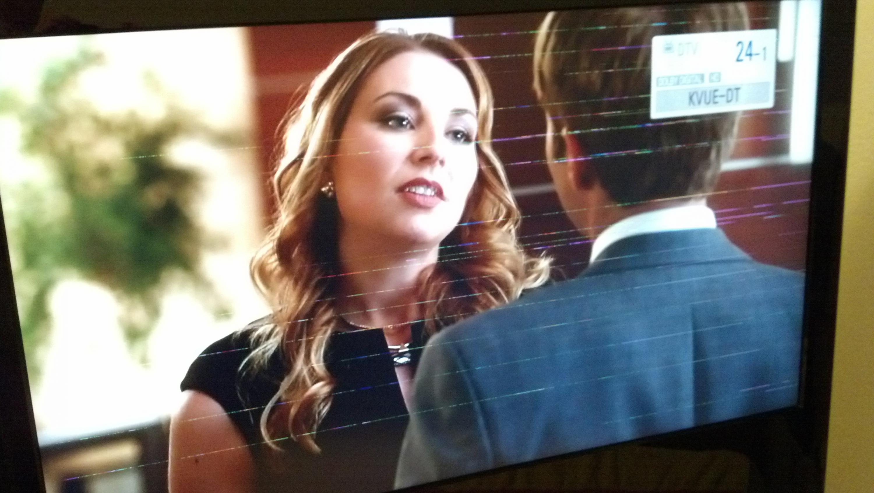

    Greetings all, from a soggy Austin today!
    I picked up an LG 42LGX for a few dollars- If the TV turns on, picture will have static-like horizontal lines for a few moments, then goes to full-screen, multi-colored thin Vertical lines for a shorter time, then to a gray screen- not black, as the backlights are still on. Sometimes it goes straight to this screen when turned on. Sound is fine. And once the vertical lines or gray screen appear, nothing can be seen, including the menu.
    No obviously bad caps on the power supply or main board- tested the ESR (novice that I am with such tools) on the PS, all seems okay. My next thought is to look at the T-Con board, given the problem. But here is where I find myself in murkier water. There is another board between the Main Board and the T-con board! Part number is EAX41602202 and I had to pry off the cover to even see the board- not screwed on like the other covers I have seen- and the bottom of the board is soldered to another cover.
    I have seen this part, after the requisite Google search, referred to as a 'Signal Board' (which I have usually taken as another name for the Main Board with the inputs jacks), or aSub T-Con board.
    Can anyone explain to me what this part is and what it does?
    Oh- and feel free to tell me if I am on the wrong track here in trouble-shooting this TV- I have done computer tech support for years, but no board repairs beyond replacing a few DC Power jacks- but I hope to learn to do more of this type of repair, on computers and other electronics as I learn- and thank you for this site- I have read posts here off and on for a while now.

                          I have a LG model 42LG60 with small horizontal lines exactly like the attached images [ 1-Horizontal Static.jpg]
                          Have someone found the cure to this problem yet.?
                          The mystery board is called the Digital board.
                          Please let me know if a solution was found..

                            Well an update- sorry it took so long- I was sick for a few months and had to put aside my new hobby;-)
                            A summary thus far-
                            TV is: LG 42LG61
                            It has three different symptoms that rotate.
                            Symptom 1: Powers on, picture comes up- but there are flashing white/silver, horizontal lines across the screen- the frequency of the lines dissipates over time. This symptom occurs the most of the three, but not by much.
                            Symptom 2 Powers on, but black screen- has sound and backlight is on. Usually turning the TV off and on a couple of times resolves this. This symptom occurs second most
                            Symptom 3: Power on, goes to all fuzzy green screen- you can see ‘shadows’ move in the background from TV program or from opening the TV Settings Menu. Usually turning the TV off and on a few times will fix this- though once, I had to let it sit overnight. This symptom occurs the least of the three
                            Most of the time (80%, maybe) the TV comes on just fine. I have replaced the TCON Board and the two LVDS cables that go into the TCON Board. I have also replaced the Main Board and the Digital Board (it sits between the Main Board and the TCON Board- a setup not used much, I think). And I replaced all the capacitors on the secondary side of the Power Supply (they all looked good, but were those cheap Samwha capacitors). I also took off the top brackets and was able to inspect and touch the tabs- no effect on the set.
                            I was surprised it was not the TCON board from all I have researched and read. Any ideas what these rotating, diverse symptoms point to?

                              Hi everyone I am from Mexico city and I have exactly the same issue in a tv set LG 42LG60 and I fix it very easy, the trouble is located on PCB called SUB-TCON part number EAX41602202 capacitors SMD 100uF 16V, 22uF 16V, 4.7uF 35V and 10uF 25V are culprits they not work, I change it all of them and the problema were solved I hope this can help anyone, and thanks for this great fórum...

                                Hi and welcome! I see it is the same part number as the Signal Board on my TV, and I have recently been re-looking at it, since the issues slightly changed when I swapped out this part- both give the silver horizontal lines and blank screen- but the original one had vertical gray lines all the time, while the new one just occassionally has a fuzzy green screen.
                                Anyway- I could tell nothing from the tops of the capacitors- and I see no way to disengage the board from the bottom metal cover- the top pried off easily enough- but the bottom seems welded on- am I missing something on removing the board from this bottom cover?

                                  Hi that part is a Little bit complicated to dissasembly, i used a station desoldering iron to do it and a Little bit more patience but it is possible to do it the idea in fact is leave only the PCB without any shield for easly retire of components by the other hand when I measured the retired capacitors they give me the "right value" according with my capacitometer but my digital osciloscope shows a ripple noise of 800mVpp and that helps me to determinated bad capacitors I suggest to change those capacitors to solve this problem....Greetings from Mexico and is a pleasure can help...by the way an apollogies for my bad english....

                                      but what were the board numbers on each capacitors, theres various numbers at that range of 100uf 16v theres like 9 of them and same as the other caps
                                      • achavez712001
                                        • Feb 2012
                                        • 3
                                        Re: LG 42LGX Mystery Part- at least to me;-)
                                        you need to change all of them specially 100uf 16v.
