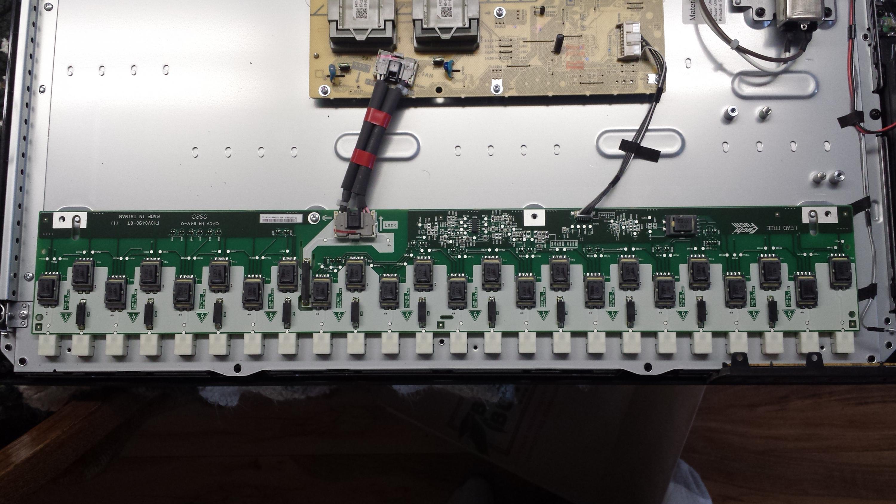

    I just picked up a 46" Sony Bravia KDL-46VL160. It turns on for a few seconds,
    the backlight turns on but there is no actual picture.
    When the set turns itself off the red light blinks 14 times.
    I'm just getting started troubleshooting this one, I've read it could be a backlight tube,
    maybe a bad transformer or a TCON issue.
    What are your thoughts to check first?

      One more thing I should mention. When the power cord is plugged in it automatically turns itself on, the backlight comes on and then it turns itself off.

        I unplugged the LVDS cable going into the T-CON board and then the backlight stays on and the tv doesn't shut itself off.

            Since the backlights stay on, then it is not inverter or lamps problem. The error already indicate the problem with the T-CON board.
