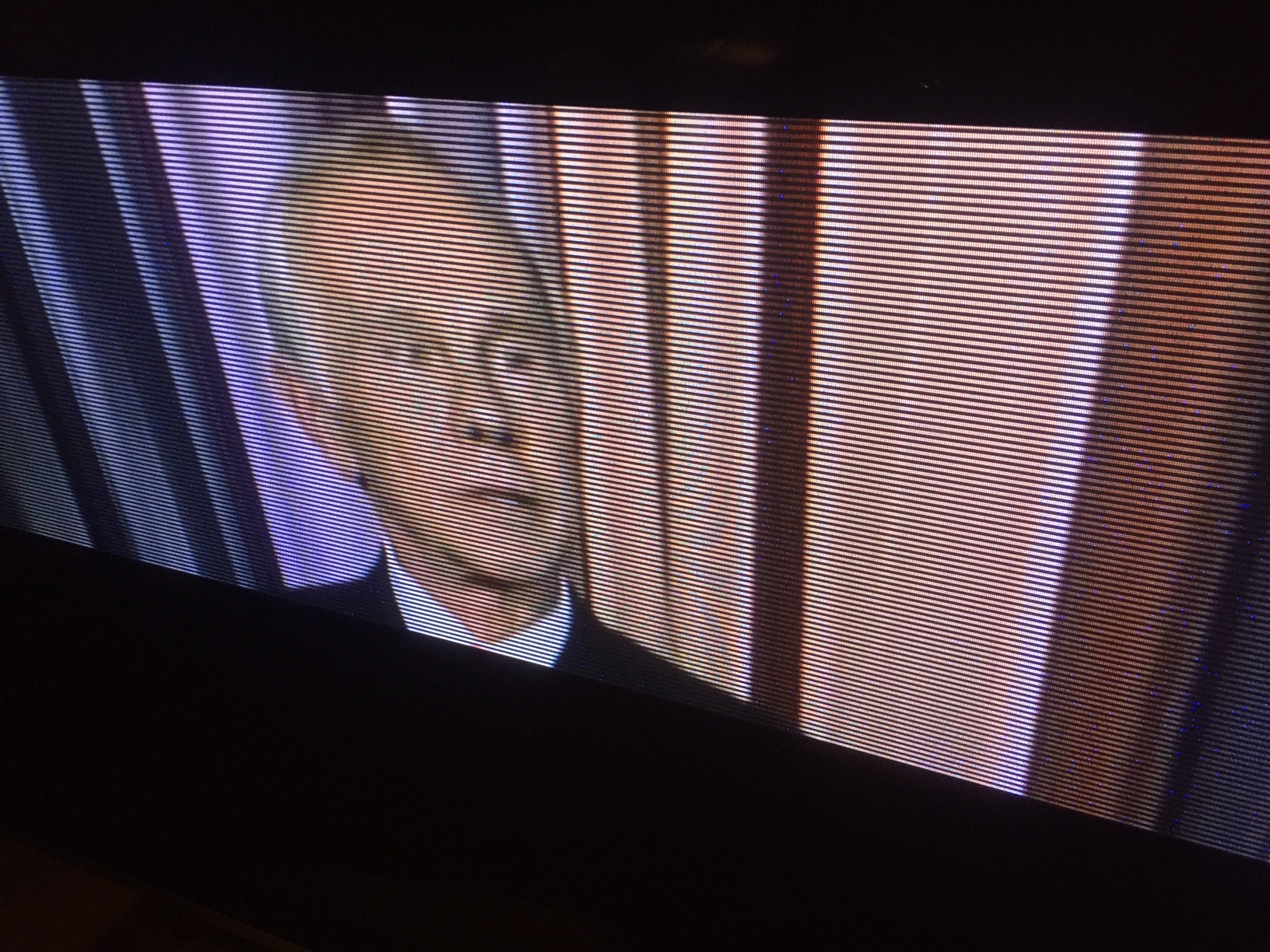

          Thanks. I went ahead and disconnected the SDR boards, one at a time.
          When I disconnected the UPPER SDR (only), there is no picture across the entire screen. It remains all black. Sound is there, but no picture at all.
          When I disconnected the LOWER SDR (only), a picture appeared on the top half of the screen only. Sound remained present. At first, there were black, horizontal lines across this top-half image all the way from left to right. What you called interlaced.
          After about 3 minutes, and a couple of channel changes, these black, horizontal lines disappeared. However, the entire time this top-half picture was (and still is) populated with sparkling blue dots that can be seen throughout this entire top-half image. The picture is watchable, but the blue dots are clearly visible and highly visible whenever the screen goes momentarily black upon a channel change.
          Strange that the horizontal lines cleared up on their own. I've seen those lines many times when working on other sets, but never had that disappearing act happen before.
          Given all of this, is it logical to assume that either the UPPER SDR need be replaced (and then the set will be fixed)? Or, is it possible that the Y-SUS is defective and prohibiting the UPPER SDR from working properly?

            Re: Hitachi 55HDs69 plasma No VS,VA, bad buffer
            Sounds like your on the right track. These Hitachis burn out the lower board before the top goes short for some reason. Same with Fujitsu. The interlaced lines disappearing is most likely the sustain board resetting from a shorted lower.
            Id perform an ohms test on the lower to confirm.
                Yes the blue dots will clear up after the lower SDR is straightened out. The Ysus is compensating for the data driving to upper only. It's supposed to supply dual duty cycles to both so only driving one, the YRR, YFR, (Samsung terminology) is off cycle. Nothing to worry about.

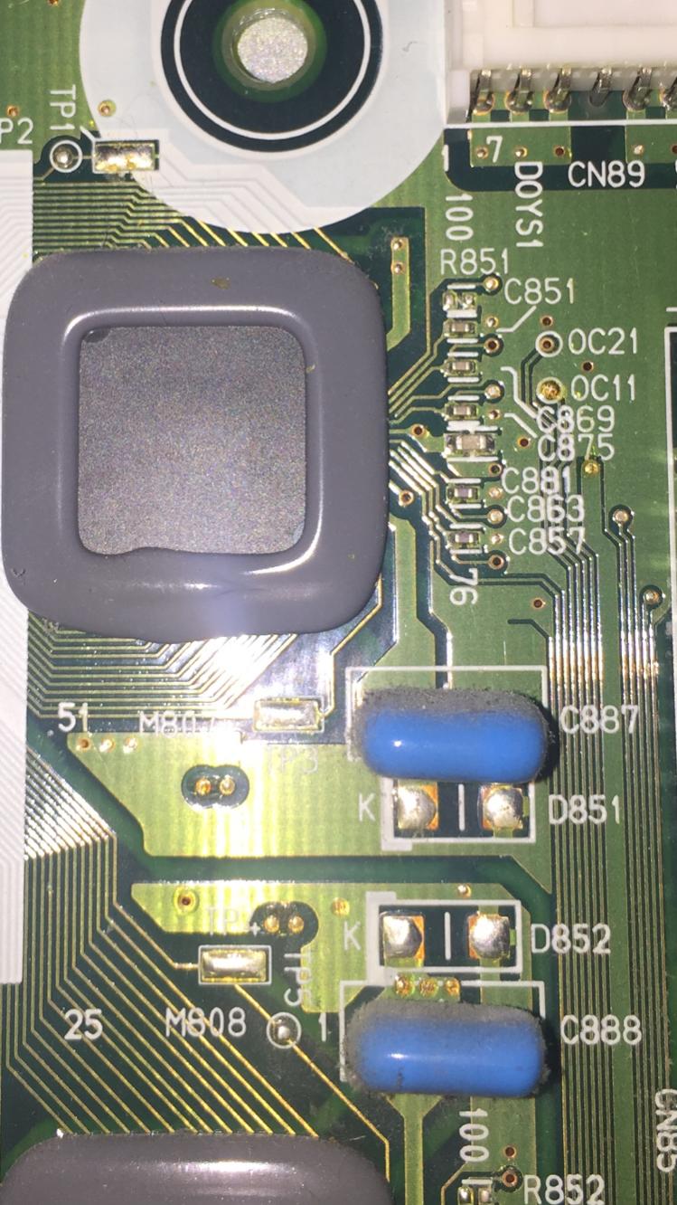

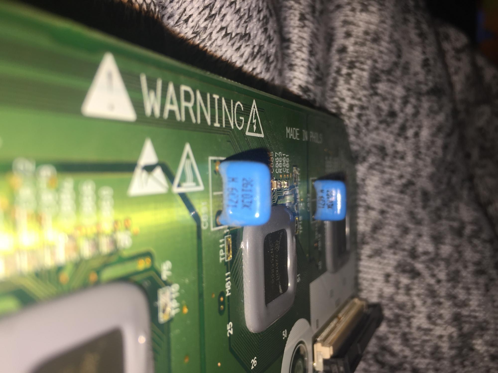

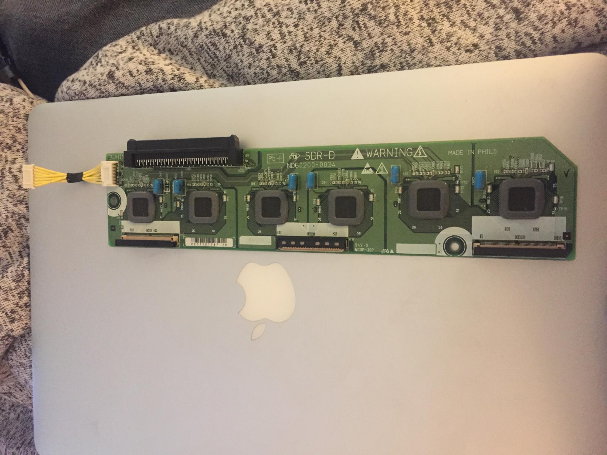

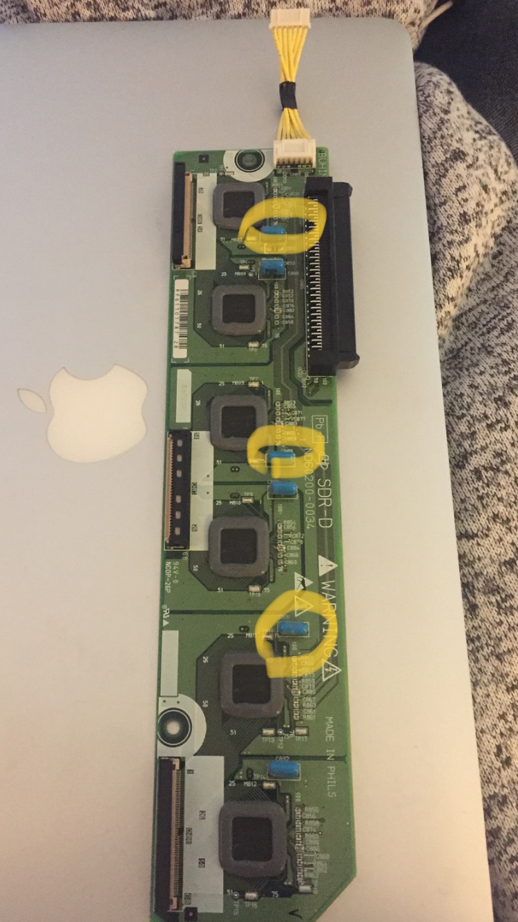

                          So, I pulled the lower SDR from the set and performed the Ohms test. Strange results. All six of the chips tested good. Got readings between 733 and 738 on all of them. Extremely consistent. Did the test up and down the board several times to make sure.
                          None of the IC's seem to be bad, and none of them are visually compromised in any way. Given these two factors, can this SDR board still be bad?
                          More info:
                          Tested all six of the blue parts (see Pic #3) by flipping the SDR board over and putting the DMM in the 200 Ohms range. Got exact readings of 13.2 on three of these, but nothing at all on the other three. Each 13.2 coupled with the no reading existed in the three pairs. So, when close to one another, one produced a reading and one did not. Is that normal / expected?
                            Would that be 13.2 Ω? I would compare this with the blue capacitors on the upper board to verify
                                If in fact you are getting low resistance readings along those caps, that may confirm a shorted VADR to ground. This in fact would cause a board shut down

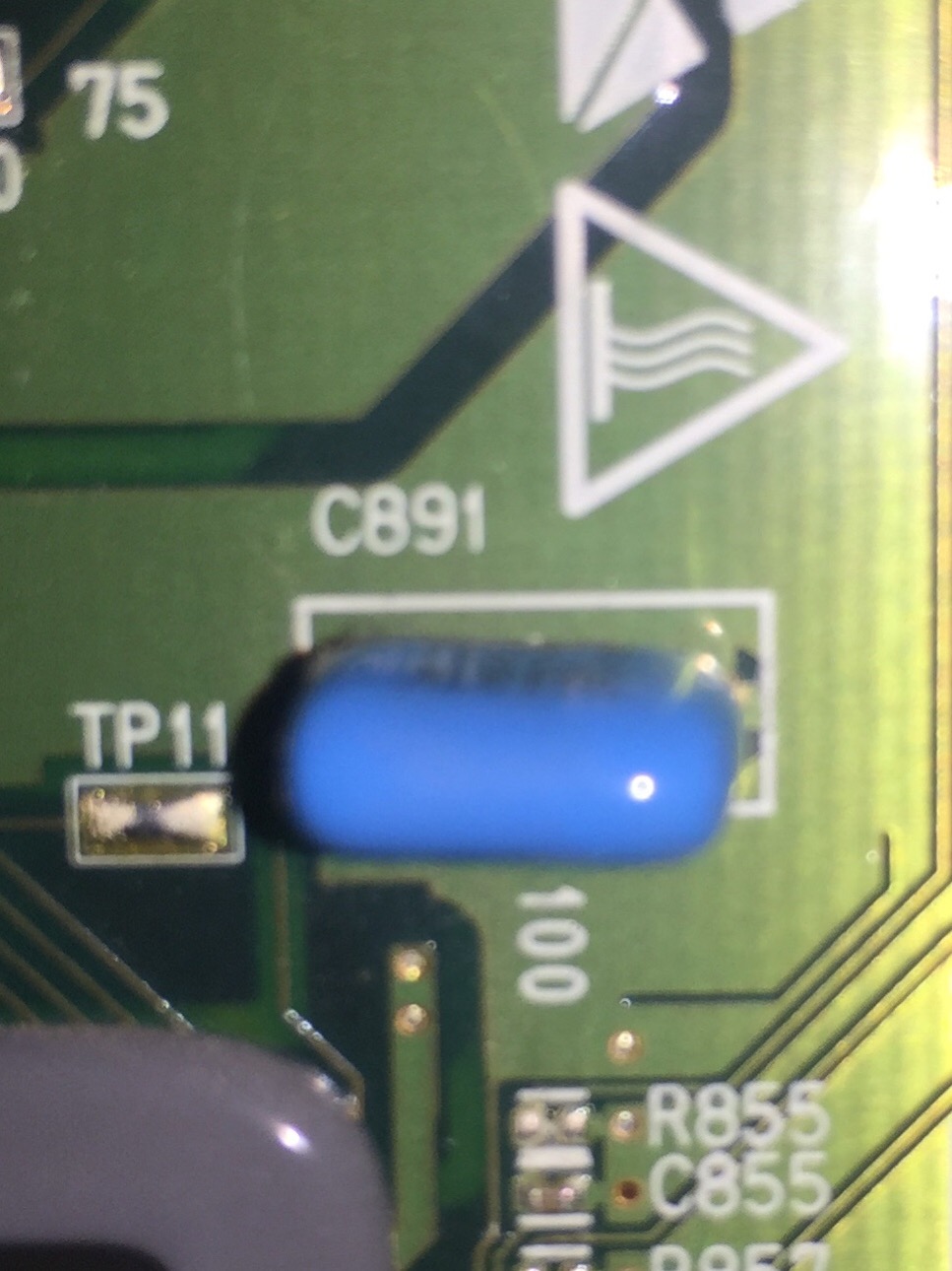

                                  UPDATE;
                                  The upper SDR tests exactly the same on the IC's as the lower one did. Meaning, readings of about 735 on all six chips. So, all is good there.
                                  Tested the six blue caps on the upper SDR as well and there were NO readings on any of the six.
                                  So, the only three caps that gave off those 13.2 ohm readings were the three alternating ones on the LOWER SDR ONLY Please refer to the picture below. I have circled these three in yellow.
                                  Re: your last reply, can you tell me what a VADR is? Never heard that term before. And, is it repairable on this lower SDR? I hope so, because I'm finding that they generally are running about $80 to $100, which is doable but a little steep.
                                    VADR is Vscan for most Japanese made plasmas. Scan voltage. I remove one leg of each of those caps to see if the caps are shorted or if it's something in line with the I c's

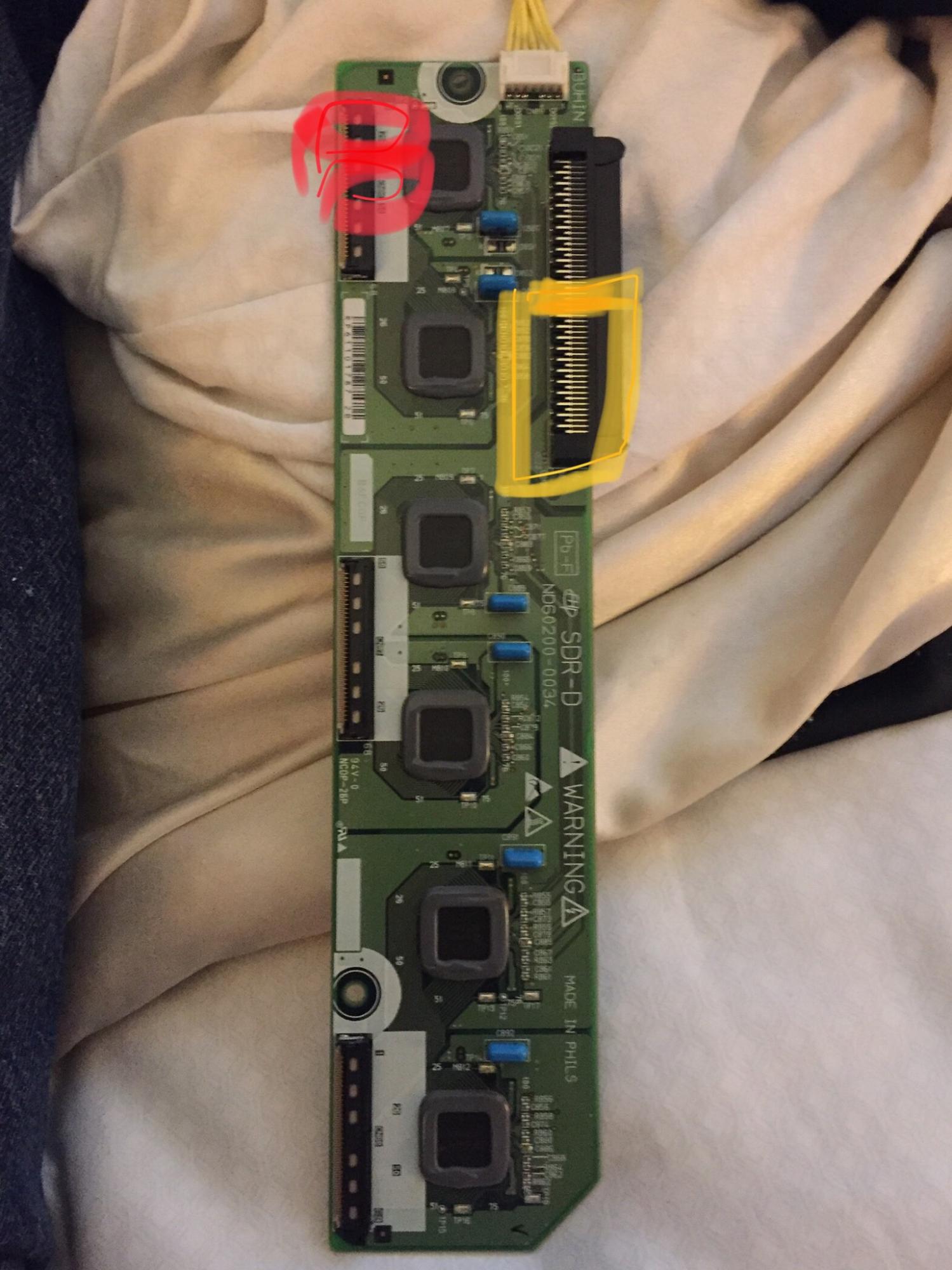

                                      I'm going to remove those cap legs and test, as you suggested. Before I do, I used the DMM to look for shorts in the pins. Found a couple.
                                      #1 — On the main connector that comes in from the Y-SUS, I put the Black DMM probe on the last / bottom pin and ran the red probe down the length. The top half of the pins were fine, but ran into shorts (continuity / beeping) on all of the final 9 pins. Please see the photo below. Every pin that is inside the yellow rectangle registered the beeping.
                                      #2 — Also found two, singular pins on the uppermost connector that holds the ribbon. Again, please see the photo below and look for the two red circles. These were the only two on this connector, and the other two connectors below it showed no signs of shorts.
                                      Tested quite thoroughly. I'm convinced the shorts noted above are the only ones in play.
                                      Do you think this means that the uppermost chip is damaged? Or, could the three blue caps that are demonstrating resistance be responsible for all of this trouble noted above?
                                      I've never had a whole block of pins (in the yellow rectangle) register bad before on any of the SDR's I've worked on. Seems telltale in some manner.
                                        What you're probably seeing is the IC damaged in some way which is registering against the blue cap. I like to do is remove the IC with heat ,.clean the pins and then power up and see if the rest of the IC's are OK if so you'll have a black spot in the screen at that point you can decide if you want to replace the IC or replace the board completely
