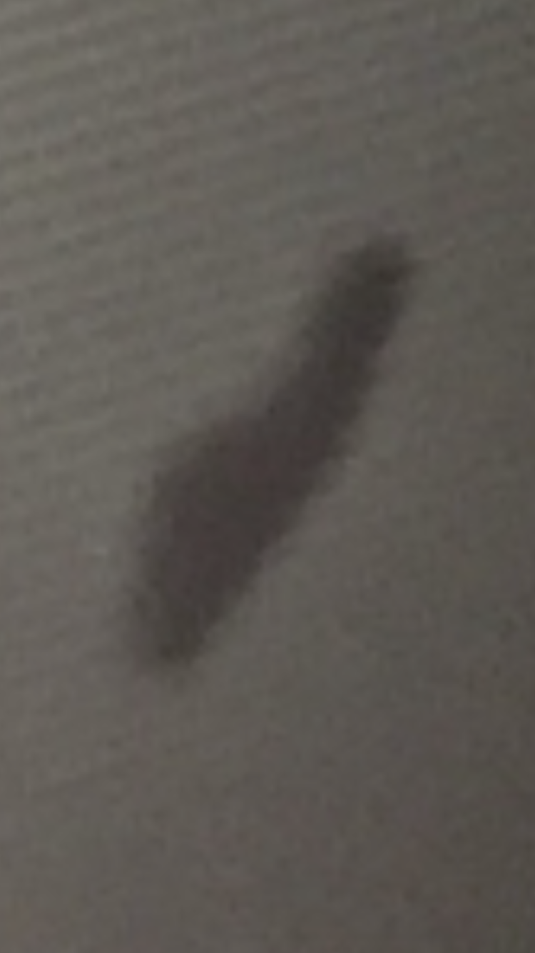

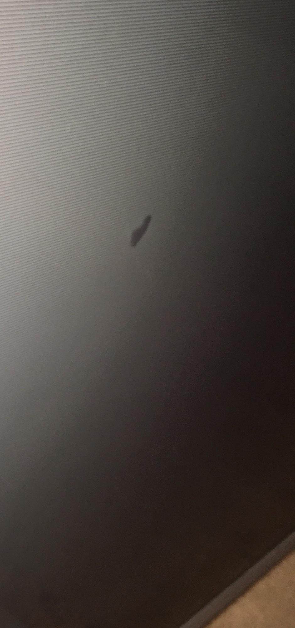

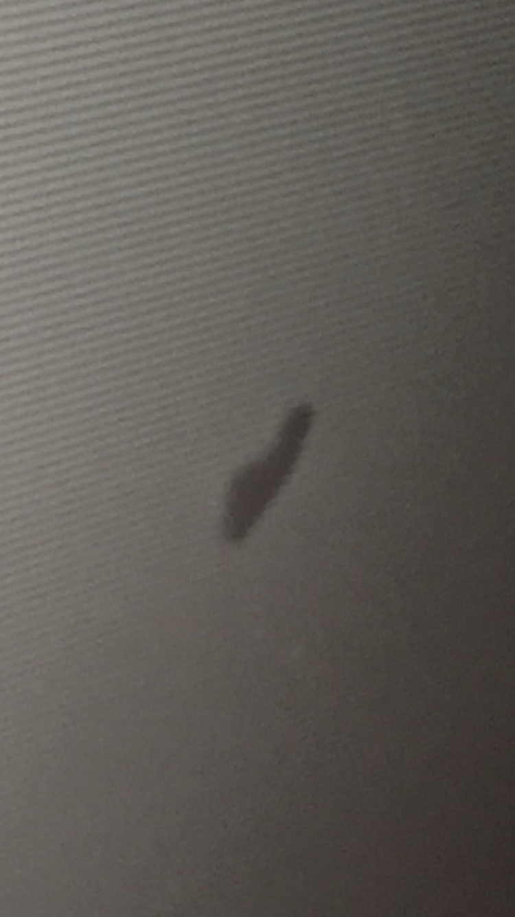

            I’m getting a new SDR-D board mailed in from a shop in Indiana. Should arrive this afternoon. I’ll post and let you know if it works. I have a related question. This Hitachi 55HDS69 set has a strange blemish (see attached images) on the screen. It’s on the bottom half. The guy I got it from said it did not affect the overall viewing of the picture back when the set was working last year. I trust him, so I don’t think there’s a great danger of this new SDR-D from Indiana blowing out because of it. But, I’ve tried to rub it out somewhat vigorously with a microfiber cloth to no avail. Haven’t tried any liquid solutions of any kind. Just wondering if you’ve seen this type of thing before and if you’ve had any luck eliminating it from the screen. Can’t tell for absolute sure if it’s on the outer surface glass (it appears to be), or if it really resides on the inner glass panel and it really just reflecting a “shadow image” onto the outer glass.

              Re: Hitachi 55HDs69 plasma No VS,VA, bad buffer
              That is a very odd blemish for sure. Sense this TV is built with a dual pane glass I would only hope that it's something that is laying on the inside and has nothing to do with the panel itself. Which IC blew out on your old buffer board does it appear to be the one that's in line with that blemish?

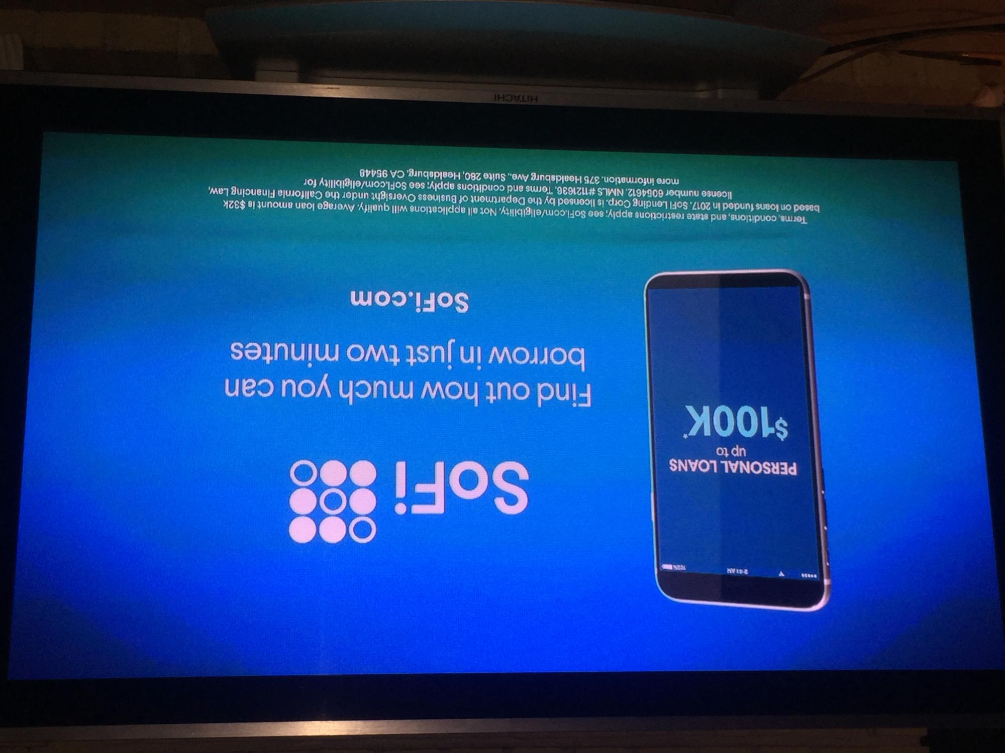

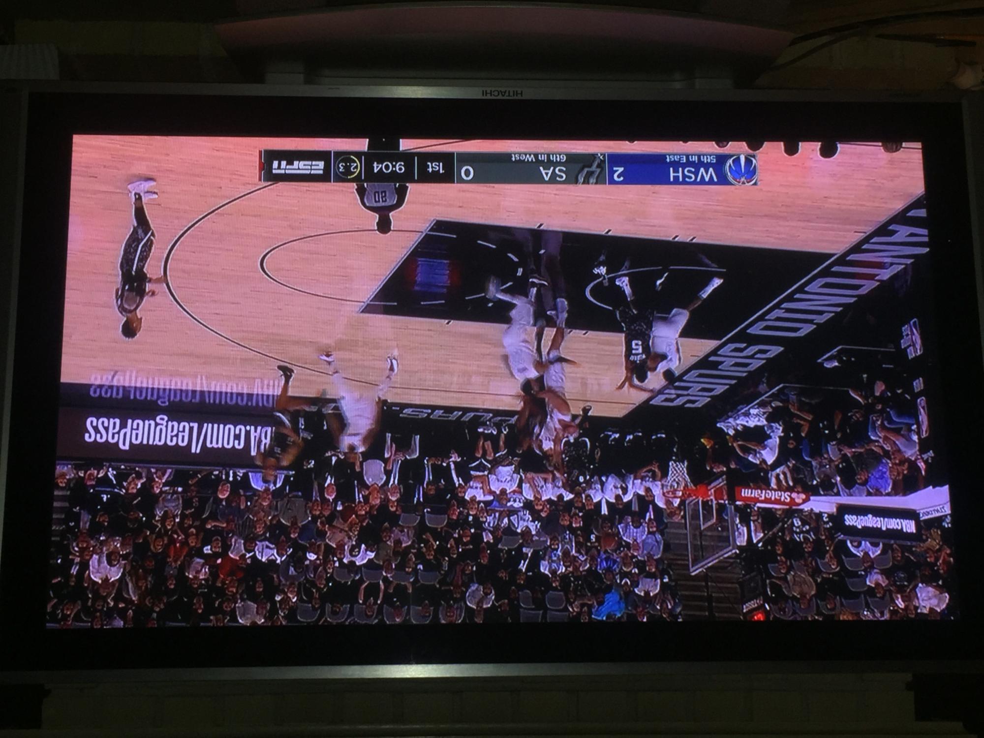

                Got the new board, tested it thoroughly before use, put it in and it fired up perfectly.
                If I had to guess, the bad IC on both the original buffer board and on the Florida buffer was the uppermost one. I think the blemish corresponded to the 2nd IC down. Maybe even the 3rd. I felt safe enough to give it a try and it’s all been working flawlessly for almost 3 hours now. See pics below.
                As far as the blemish goes, I think someone probably hit the screen with a broom handle or something of the like. Has kind of a “swiped” look to it when you see it in person. Luckily, you really don’t notice it at all when the screen image is populated. And, just like you said a couple weeks ago, those blue, sparking flecks that I was getting with only the SDR-U buffer in are now completely gone. It has 1080i resolution, so the picture is pretty crisp and clear.
                  Ignore the upside-down orientations of the pics above.
