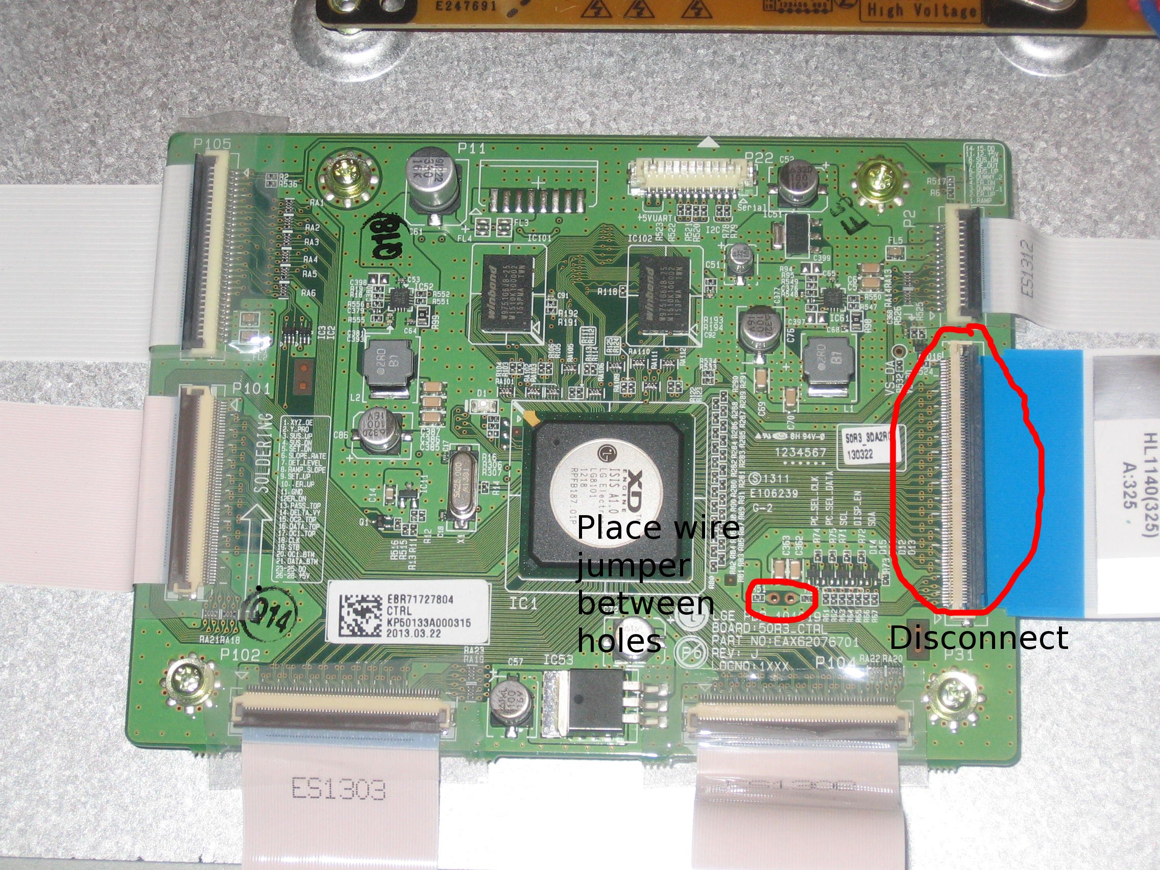

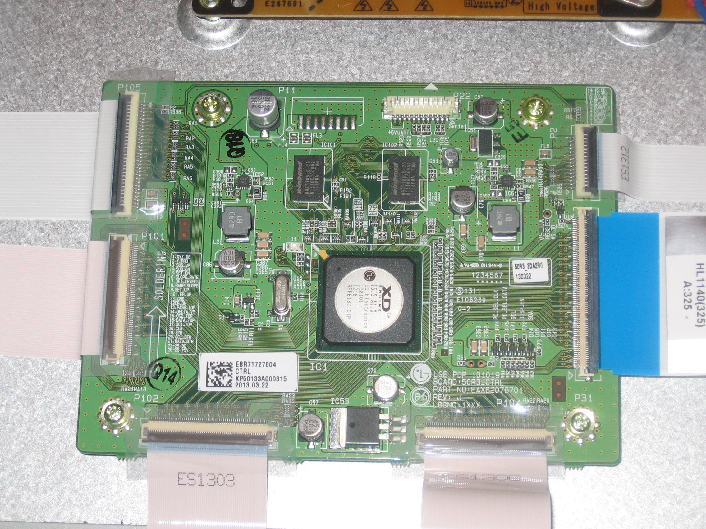

    Can you supply a picture of the control board (sometimes called logic)? There is a test jumper on most of them which can be activated to see if the new main board is bad, which will cause dark slightly glowing screen with no visible image. In a very dark room do you see any glow from the plasma screen?

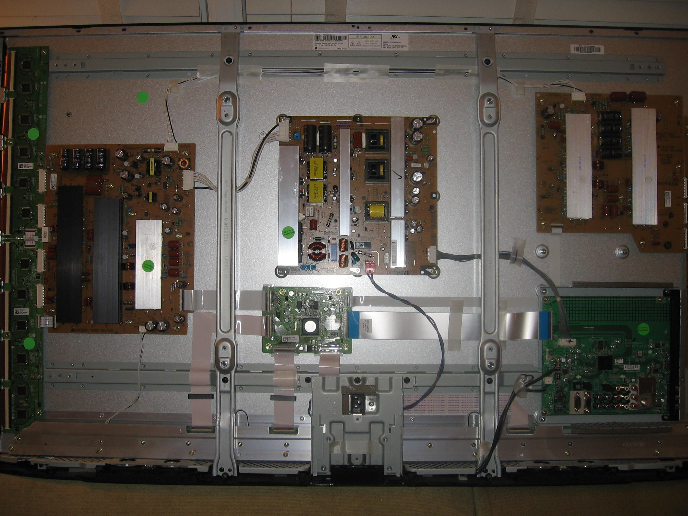

      Q: "Can you supply a picture of the control board (sometimes called logic)?"
      A: I will work to get that image posted this evening. --EDIT: I am not certain off the top of my head where this would be located. I know the YSUS (upper left), Power Supply (center), ZSUS (upper right) and Main (lower right).

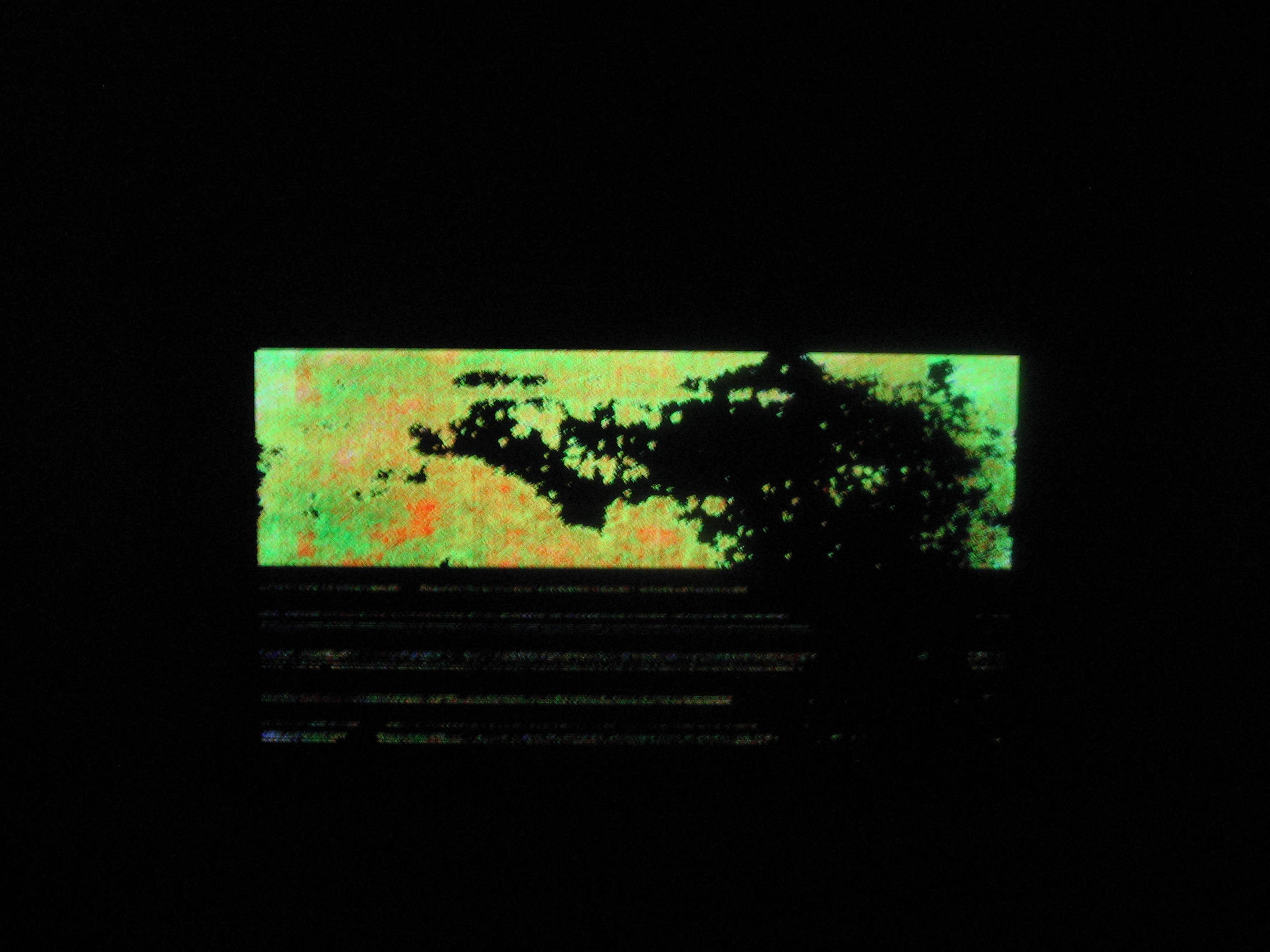

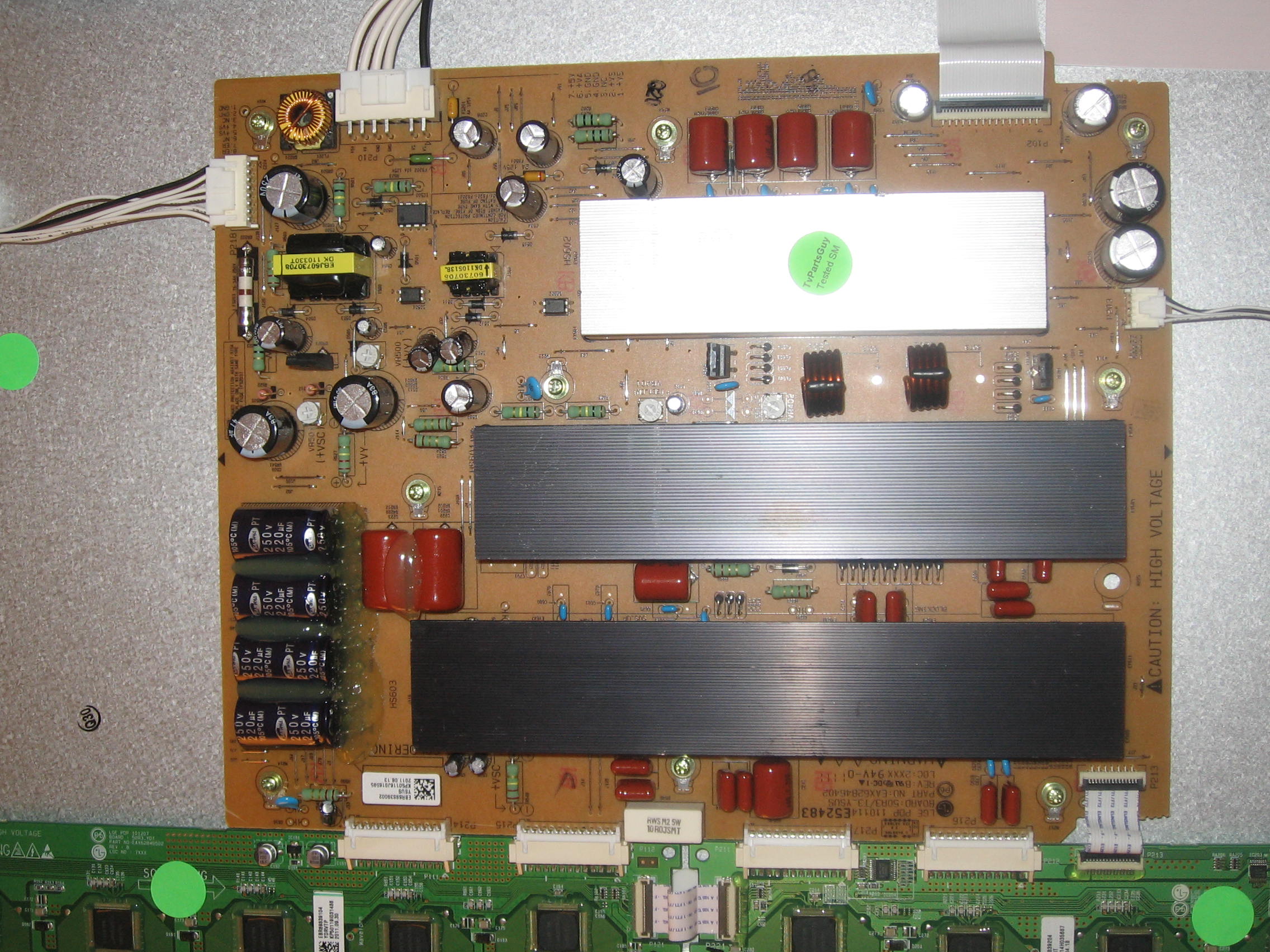

        Re: Lg 50pv450

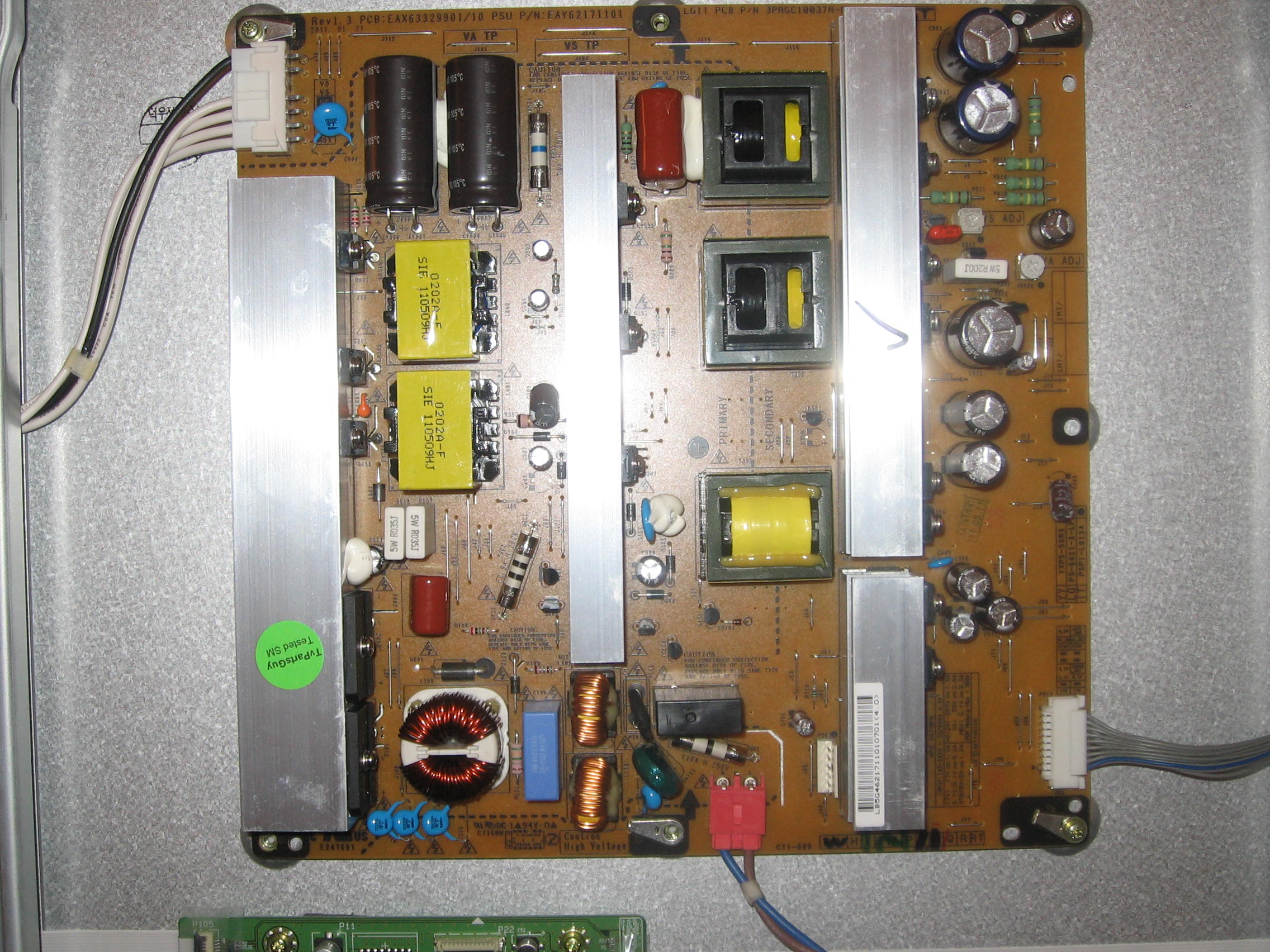

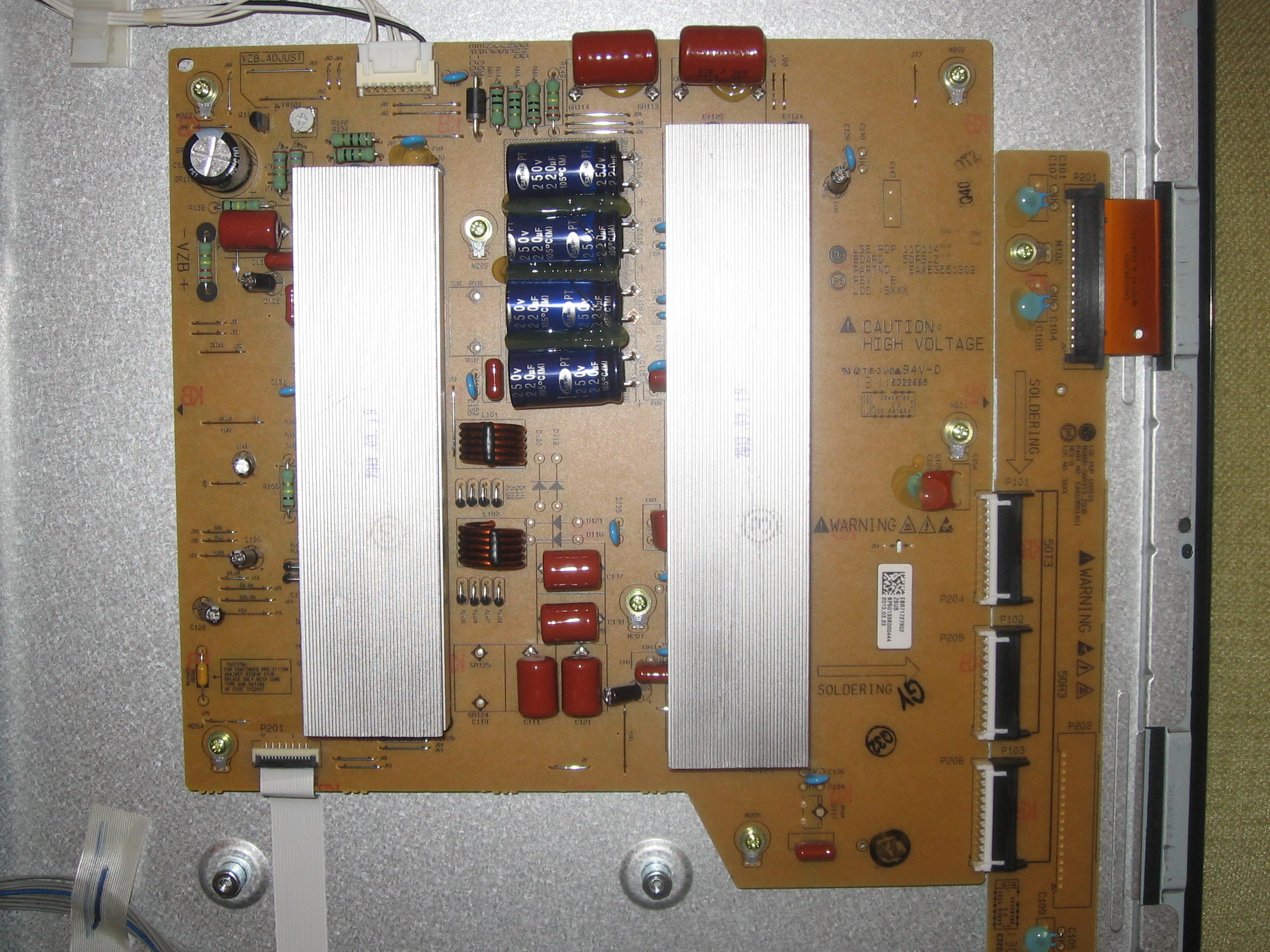

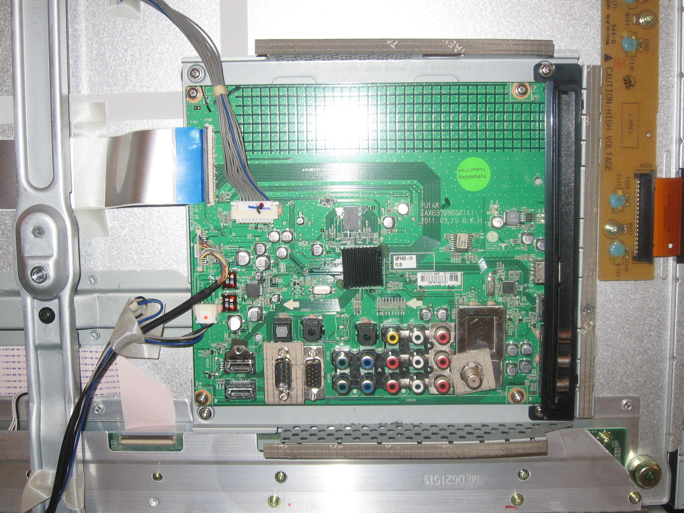

        Hi Tom,
        Attached are the images. I tried to capture the full "boot-up" screen but wasn't fast enough with my camera.
        When it first starts up, the entire screen is "sparkled".
        Then it is only half the screen. Then it goes dark.
        I can tell there is some "light" going on in there. Perhaps a back light. But, even in a dark room, the "glow" you mentioned I wasn't able to see. If there was a plasma glow, then it did not appear. But I could tell there was some sort of light going on there. It looked like a black image vs a turned off set.
        Included are also the pictures of the boards and the entire back of the panel.
        Tennessee Paul
          Re: Lg 50pv450
          To me, it looks like a bad Y-buffer or Y-sus, possibly both.
          You can try this test to see what you get. Perform the changes with power off, then plug it in. You should see a sequence of test patterns if it's working, but I suspect you will see nothing more than you currently see. This board is the control board.

              Re: Lg 50pv450
              No, I'm talking about powering it off when following the instructions in the image attached.

                    Re: Lg 50pv450
                    Hi Tom,
                    I did as instructed. The screen didn't do all that much. It showed some pixels as before but even less briefly. The color was largely red. Then it went dark.
                    Tennessee Paul
                      Re: Lg 50pv450
                      Can you check your old Y-sustain to see if the picture is any different?
                      • TennesseePaul
                        • Oct 2013
                        • 29
                        Re: Lg 50pv450
                        The old board hissed high pitch and clicked. With it in the TV will not power on. It cycles attempts, but never succeeds.

                            Re: Lg 50pv450
                            The jumper enables the internal test pattern generator. (The LVDS cable must also be removed to enable it.)

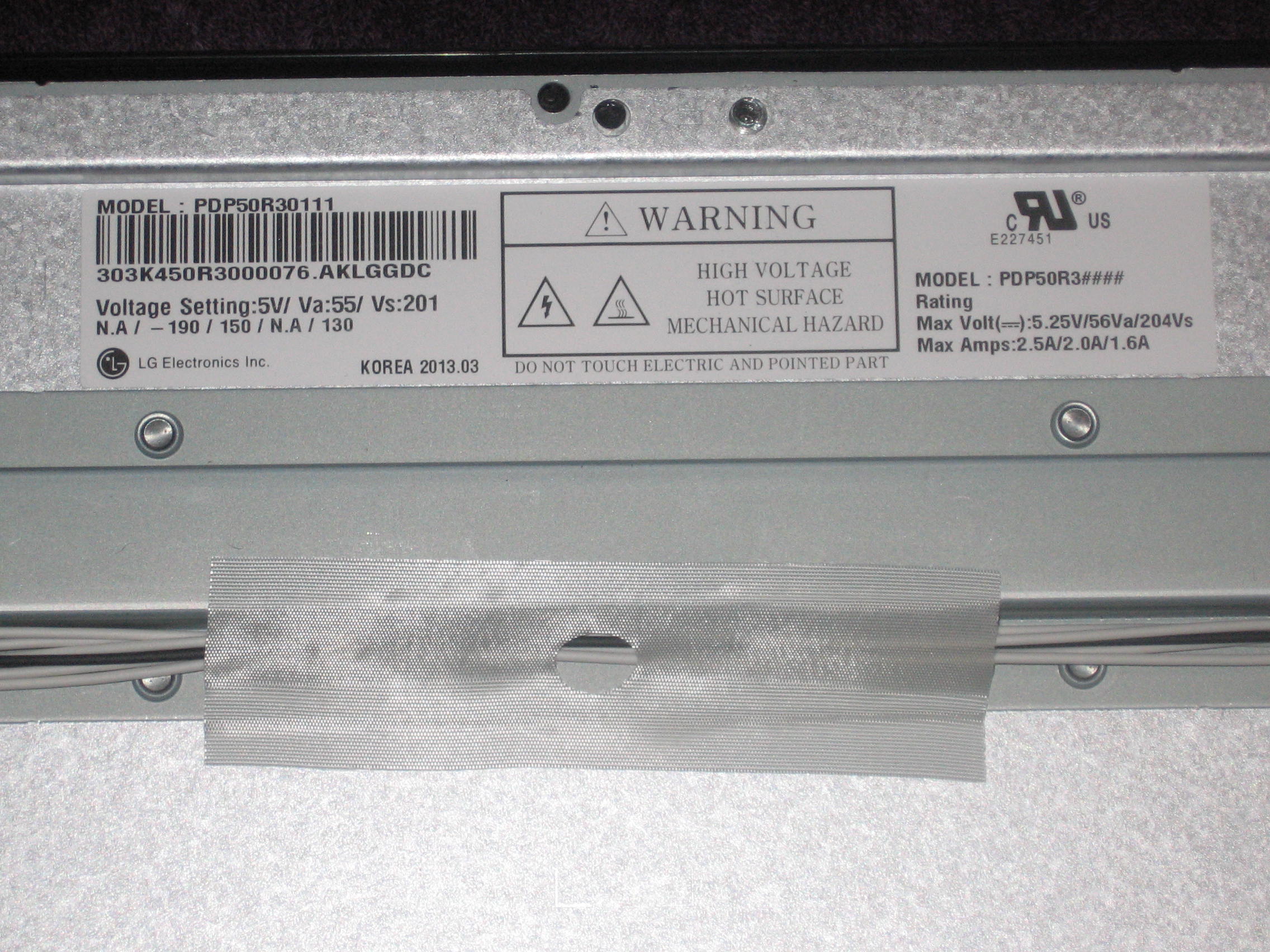

                                      Re: Lg 50pv450
                                      OK on the back of the metal backing of the plasma panel (inside the unit) you have a sticker marked e.g. LG Electronics PDP50xxxxxxxxx with voltages like VS: 206V, VA: 58V marked on it. Can you take a picture of this sticker?

                                        Re: Lg 50pv450
                                        Hi Tom,
                                        Attached is the picture.
