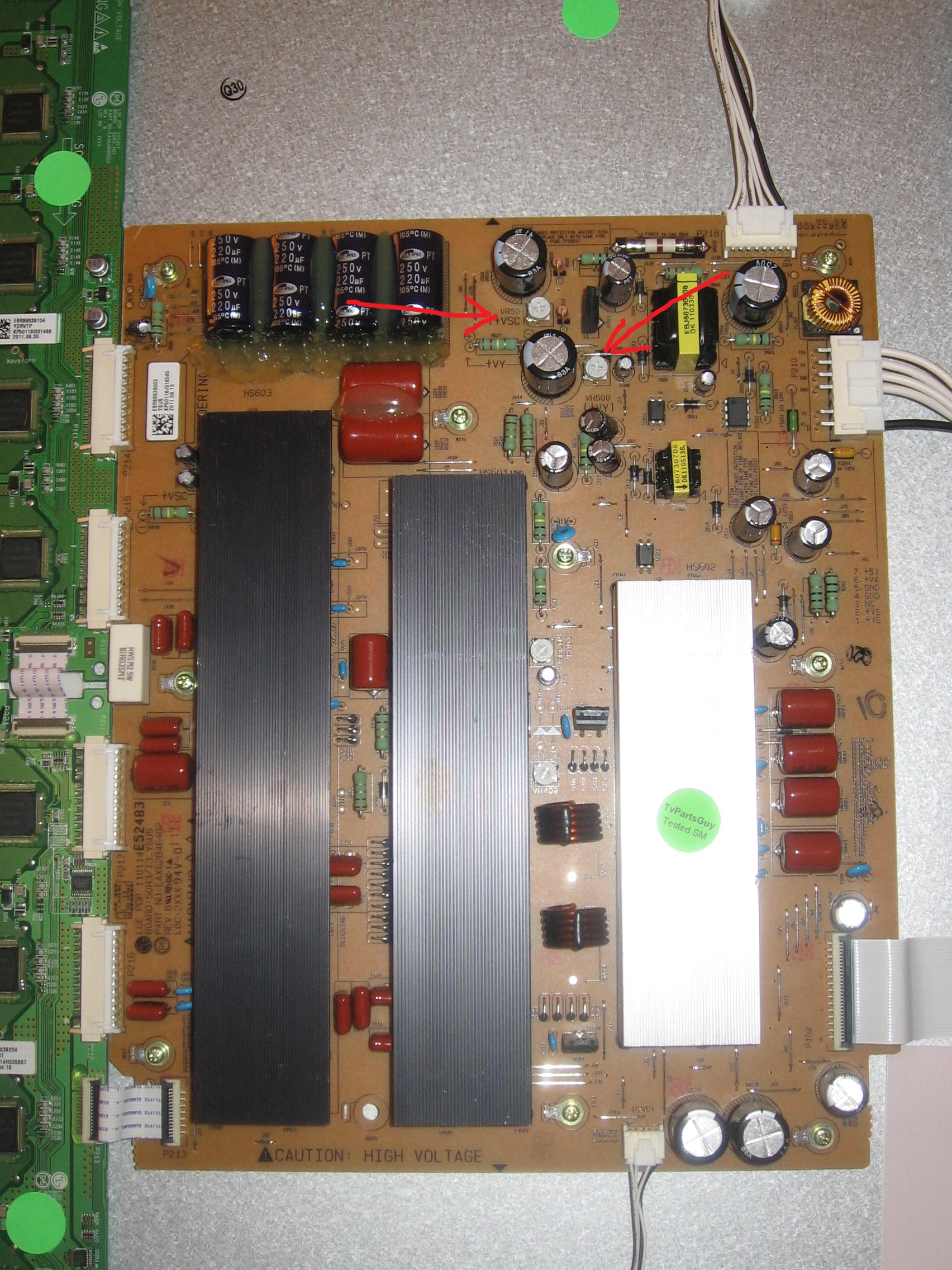

    OK, well both your Vsc (rated 150V) and -Vy (rated -190V) are high. For now, adjust Vsc so that when the set fires up, it reads around 150V (±3V.) Then tackle -Vy to ±3V. Adjustments are made by adjusting the "pots" (potentiometers), small little screw turns marked with the applicable voltage on the board.

            Re: Lg 50pv450
            Hi Tom,
            Do you know which direction goes up/down? The voltage doesn't ever hold making it difficult to tell if I'm changing any thing. I see 4 pots on the ysus. I believe I have the correct 2, they are the only two with these labels near them. But when I adjust them there isn't a noticeable change.
              Re: Lg 50pv450
              The direction usually isn't indicated, you need to just try and see.
              As for which pot, can you take a picture of them? You might be adjusting Vsetup or Vsetdn.

                Re: Lg 50pv450
                Hi Tom,
                Attached is the image.

                  Re: Lg 50pv450
                  I'm able to measure the change in resistance on the pots. Turning counter clockwise reduces the resistance on the +VY pot.
                  • TennesseePaul
                    • Oct 2013
                    • 29
                    #29
                    Re: Lg 50pv450
                    Correction clockwise reduces resistance.
                      #30
                      Re: Lg 50pv450
                      You should at least see some change in voltage, but try with both Y-buffers removed just in case.
                      • TennesseePaul
                        • Oct 2013
                        • 29
                        #31
                        Re: Lg 50pv450
                        Hi Tom,
                        I have attempted adjusting the volt. I believe I am close but it is difficult to tell as the voltage drops over time. Still no improvement in image.
                        Tennessee Paul
                          #32
                          Re: Lg 50pv450
                          So you are able to get a reasonable voltage on -Vy and Vsc? If so, and the picture still looks poor, the Y-buffer must be at fault. Do you have the original buffers? Those look like replacements.

                              Re: Lg 50pv450
                              This is a newer LG panel which will detect a fault in the sustain/buffer boards and shut off if such a problem is detected.
                              I've not yet heard of LG panels going bad in a way that they kill the buffer boards.

                                  Re: Lg 50pv450
                                  Usually the LED on the control board blinks once or twice a second if it's working. Don't know if these LG panels have a different code for failure mode.
                                  The Y-sus is probably OK, actually, given the measurements.
                                  • TennesseePaul
                                    • Oct 2013
                                    • 29
                                    #37
                                    Re: Lg 50pv450
                                    Interesting. So if the board is OK, then it is normal to drop voltage over time for the two points?
                                      #38
                                      Re: Lg 50pv450
                                      No, that is due to the control board disabling the Y-sus. Brief output for several seconds is fine, indicating the Y-sus is working.

                                        Re: Lg 50pv450
                                        I disconnected the Ysus side connections from the two adjacent (left) boards, which I believe are the buffer boards, correct? I also disconnected the power from the Ysus to the Zsus board. I left all the ribbon connections intact.
                                        I then powered up and attempted the measurements again. They did not drop off, but they also where much higher than I have previously read. They fluctuated still, bouncing between 500 and 400. I adjusted the pots with no real change in measurement. Now I am questioning my measurements. If I simply probed the board I read a very high voltage. Perhaps my voltmeter could be upgraded. Also I must double check, I am supposed to measure across the resisters with the Vsc and Vy labels, correct?
