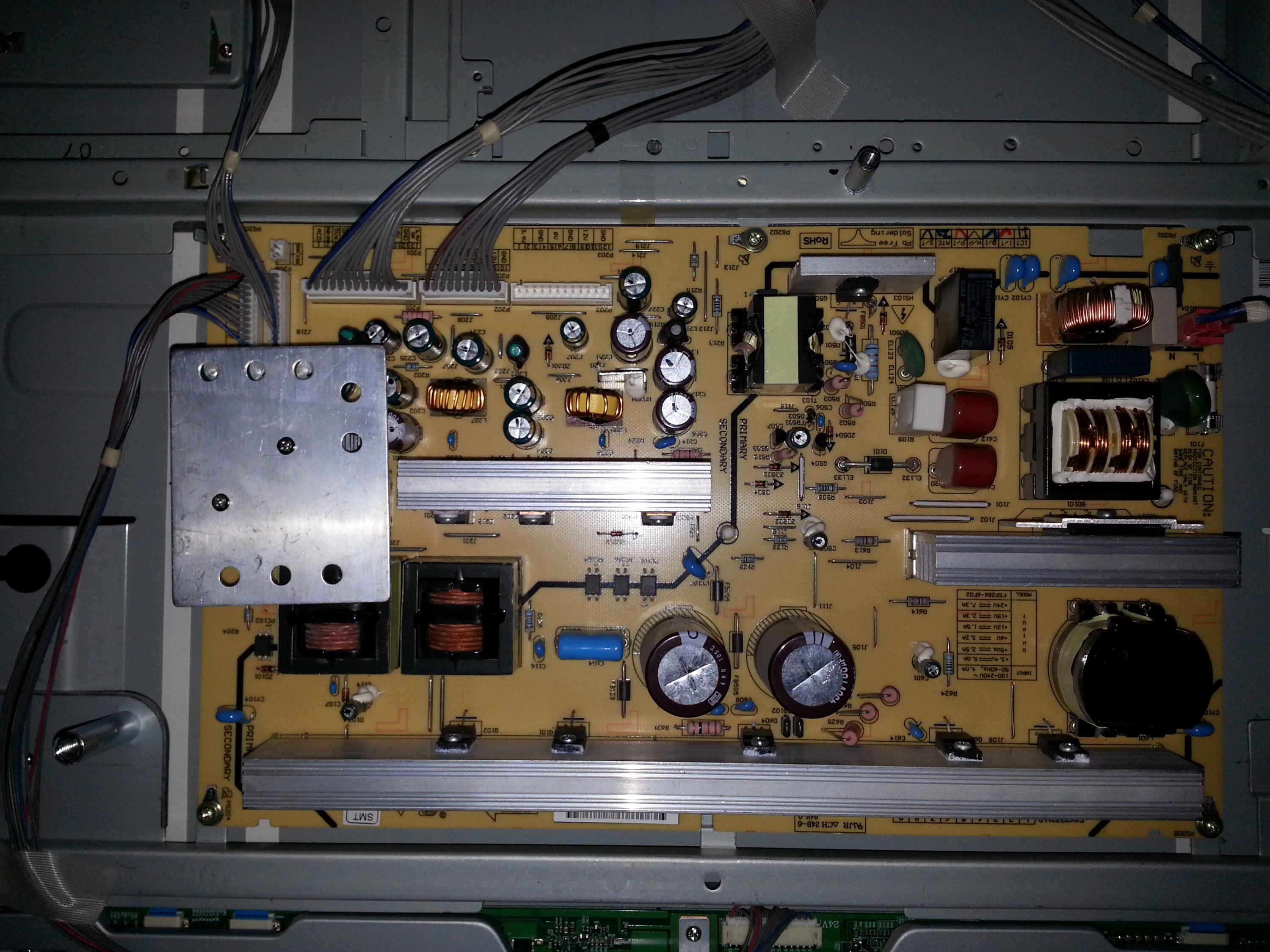

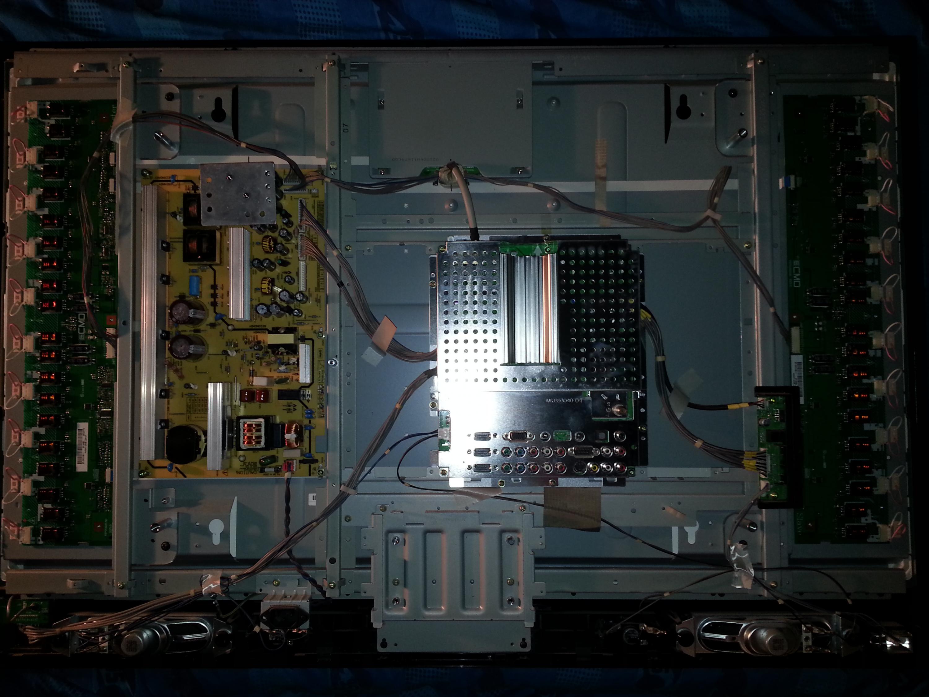

              Here's a pic of the topside power supply board. I don't see any bulging capacitors or anything else amiss.
                Re: LG 42LB5DF No Pic No Sound

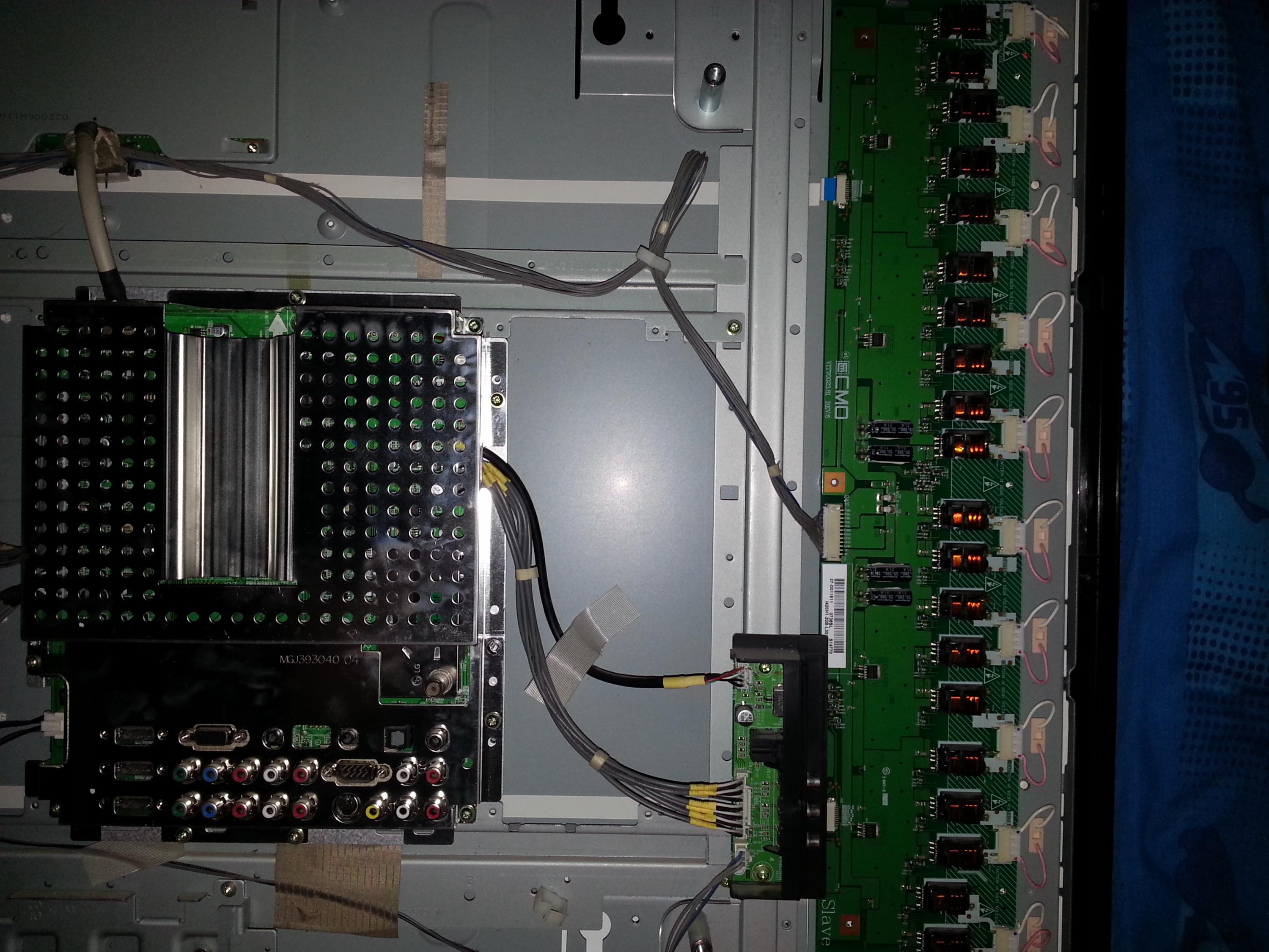

                OK, pictures of the inverter board? The whole back side of the TV so we can see what we are dealing with. Any labels on the connectors of the Inverter board will help also.
                  Ok cool, I had the main board out but had since put it back in with the shield on hence no pic of that.
                  Umm... the inverter board is (are) the boards to the far left and right ?
                    I cannot tell until I can see the whole back side of the TV, it may have one or may be two inverter boards.
                      Ok will get pics up soon.

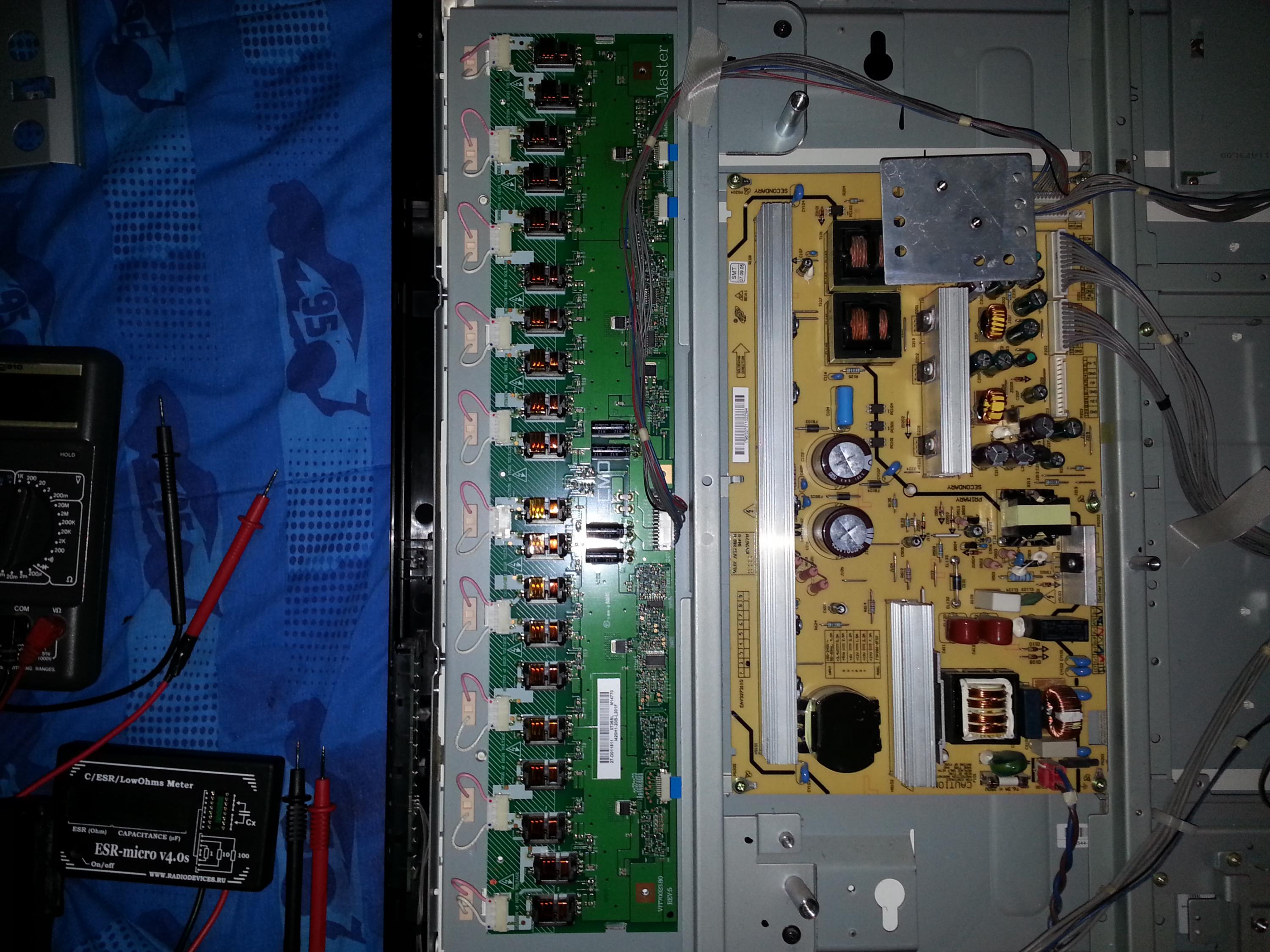

                        The four caps each on Master and on Slave pass a visual inspection. They read in the range of 6000uf (in parallel ?) But their esr is extremely low.

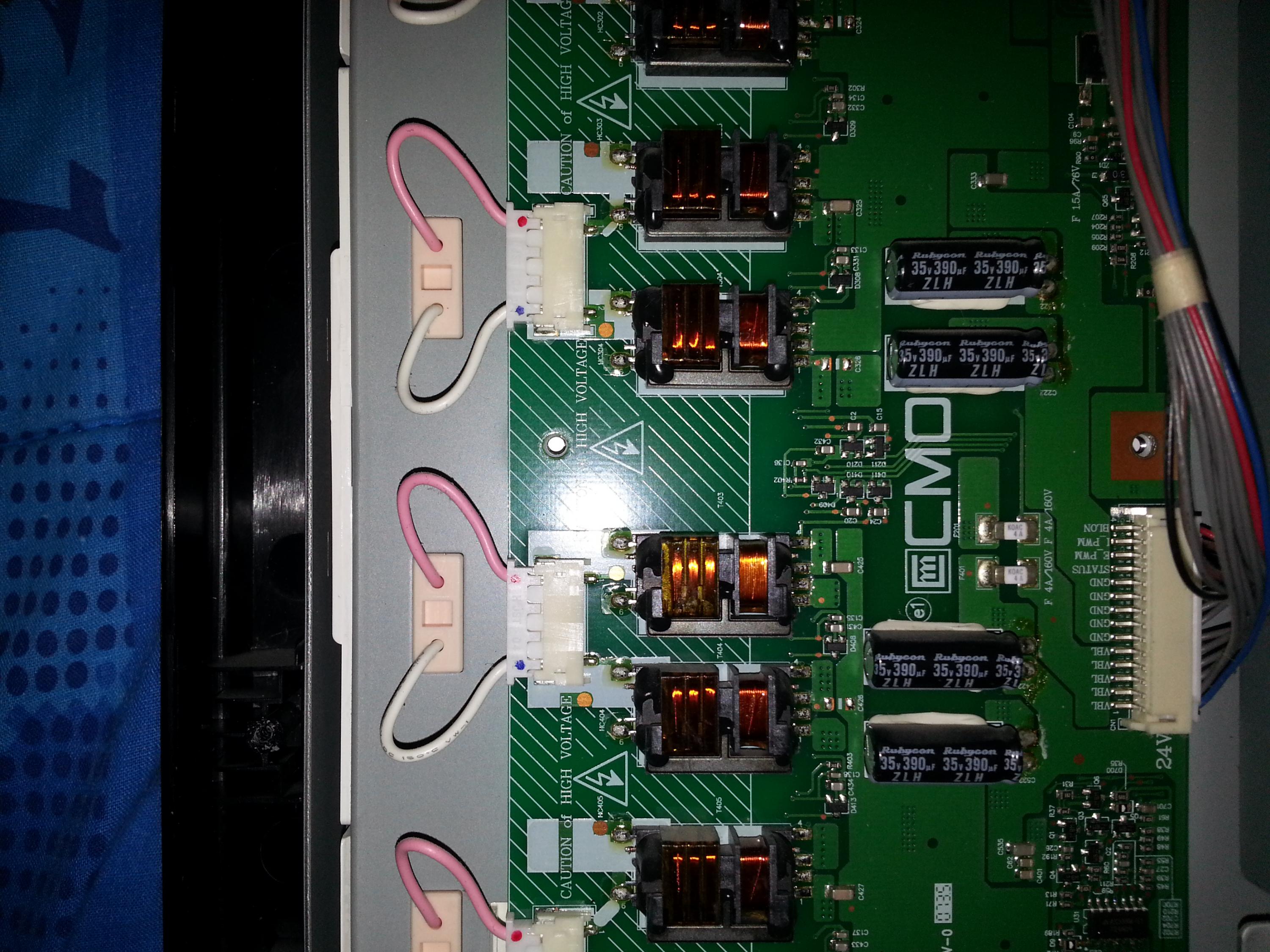

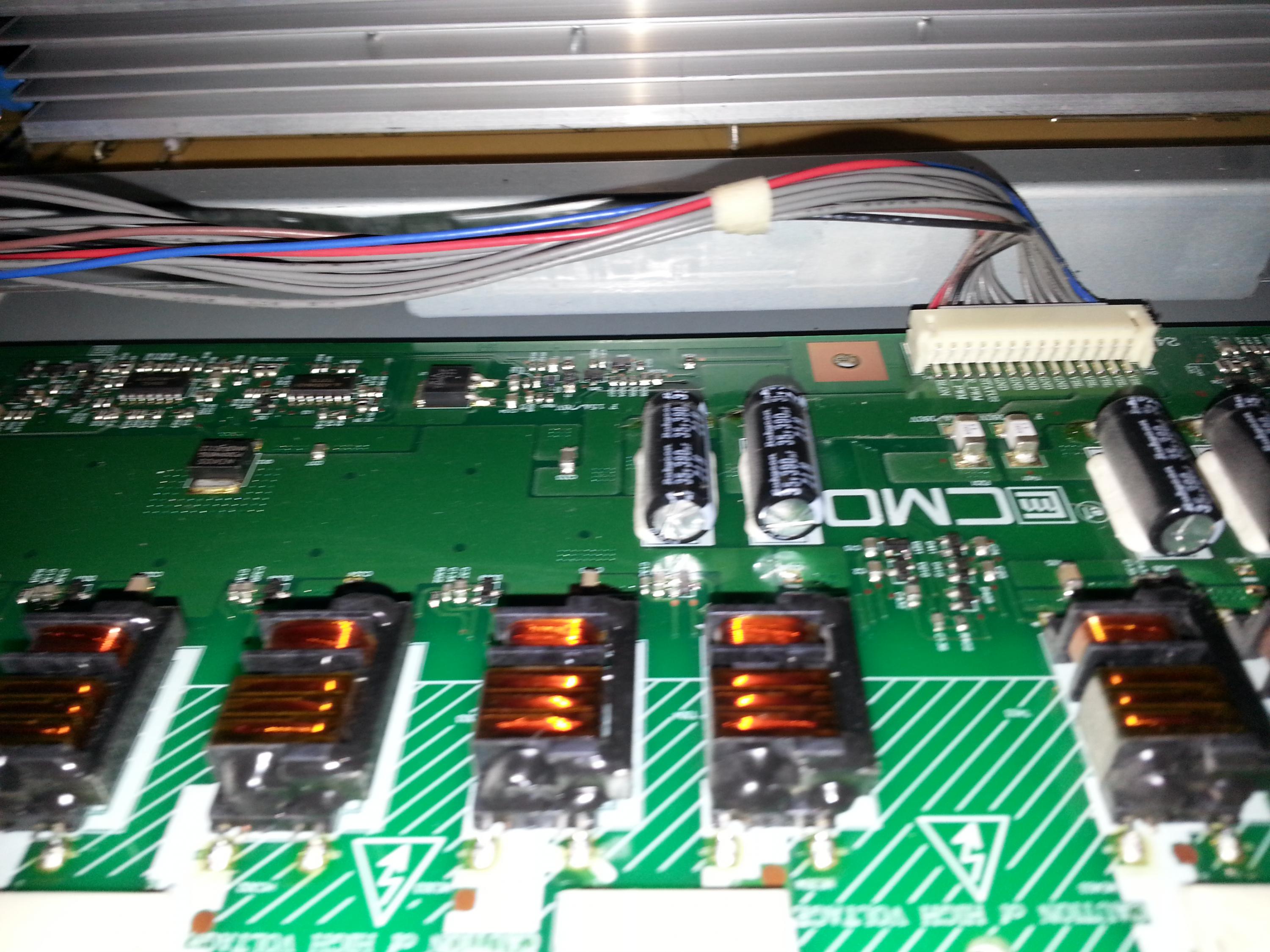

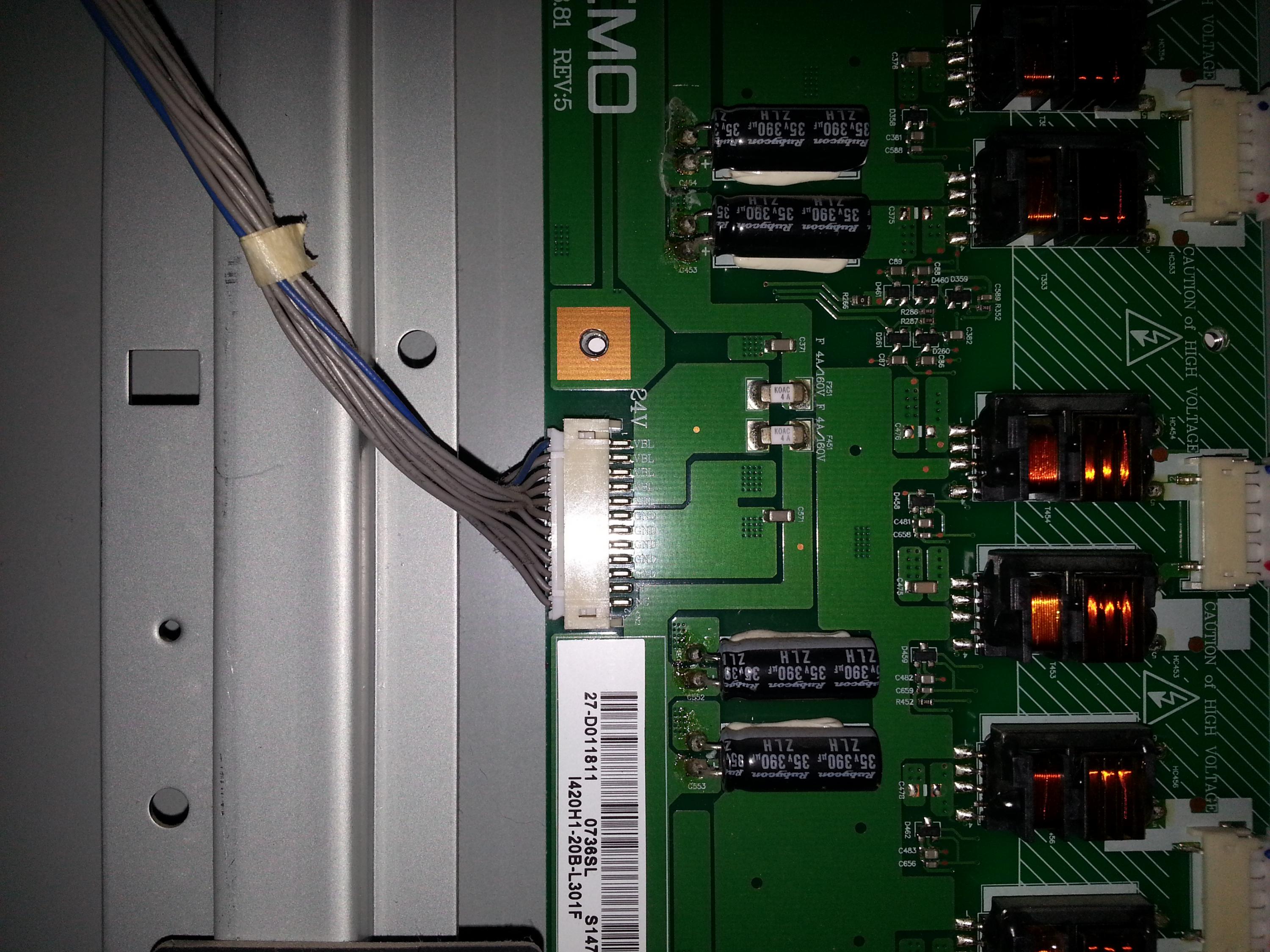

                          Forgot to attach pics...

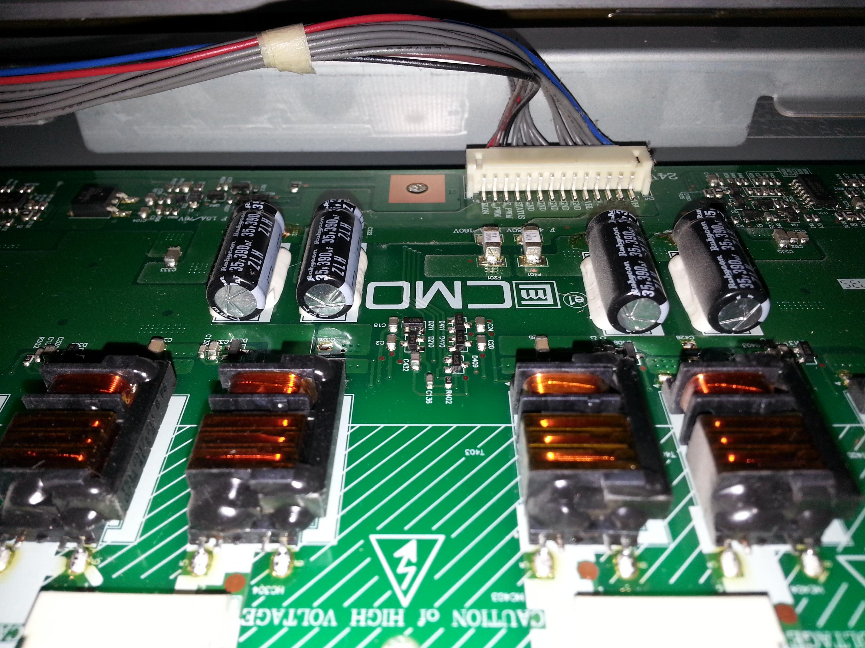

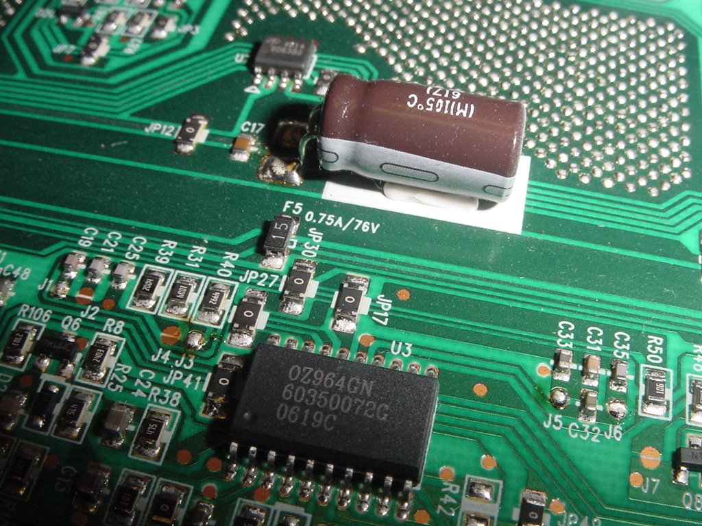

                            OK, CMO inverter boards, check ALL the fuse, including this tiny F5 one that looks like resistor in this example.
                              I tested the four fuses as shown between the capacitors on both boards and they tested for continuity. Should I test for voltage on both sides of the fuse instead ?
                                Yes. By the way, you said 4 fuses, two on each board? The board also has the small black fuses as shown on post14

                                  I'm going to remove one of these boards then to have a closer look under my magnifier to locate that fuse then reinstall and test for voltages at the fuses.
                                    Located the smaller fuse on the Master inverter - did not find a similar one on the Slave.
                                    Tested the Master Inverter and found 24.2v before AND after all three fuses. I notice there is a TCON connector to the Master inverter, any way to test that ?
                                      Tested the Slave Inverter and found 24.2v before AND after the two fuses.
                                      What kind of voltage is running to the panel through the edge connectors on the Inverters ? If the panel itself was broken would that shut down the power supply or not ?
