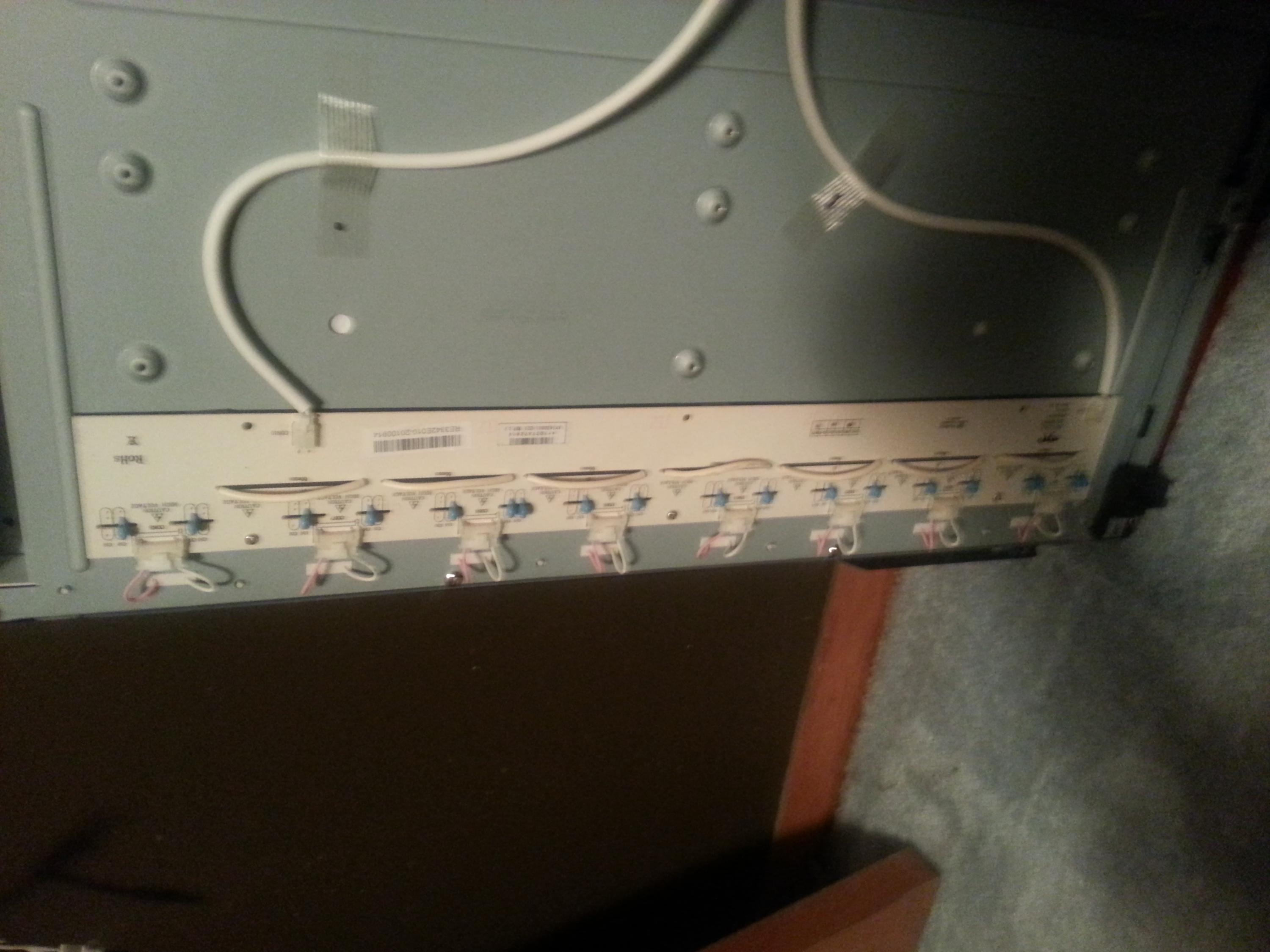

    Do the backlights stay on? or are they out when the screen goes black? Some sets go black very shortly after they detect no signal. Can we get a picture of the whole back of the tv open?

      they go out after the little no signal icon shows up, if Im correct this tv was hooked up to a source and the same thing happen, later today I'll hook up hdmi(directv) to see what happens, its 7am my time so too damm early lol

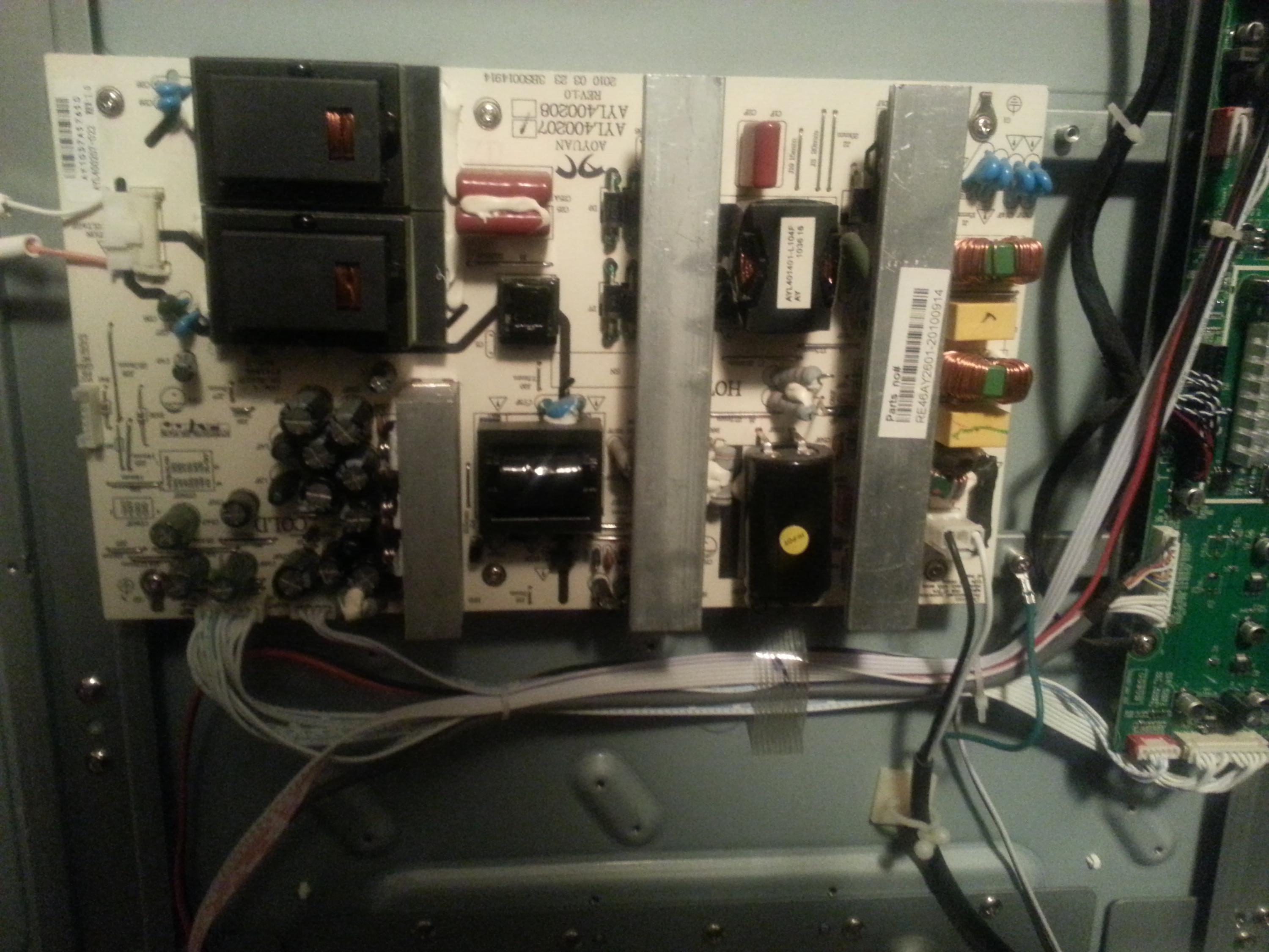

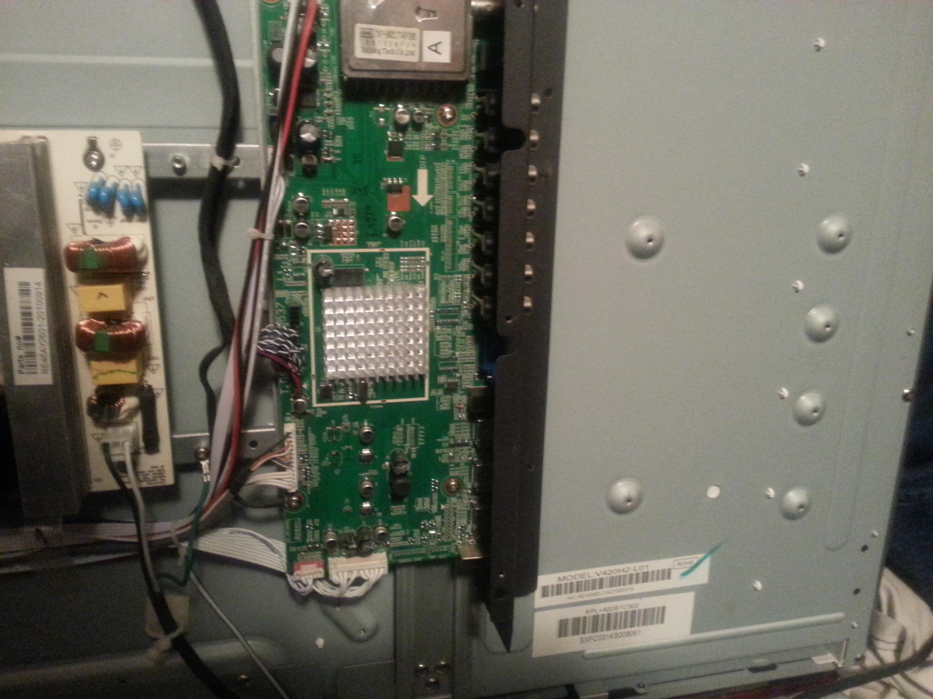

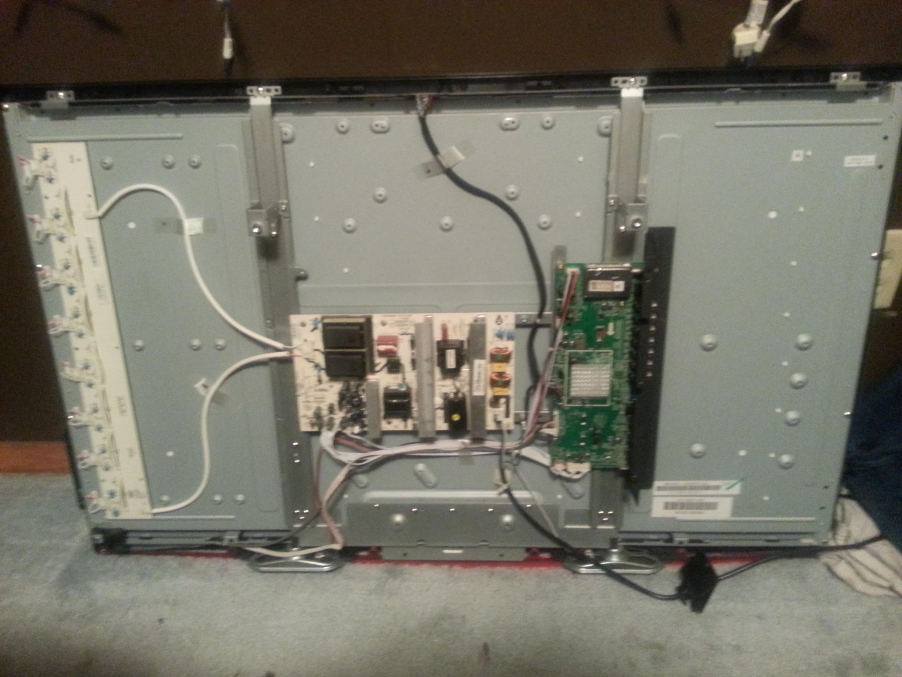

        here are the photos
        if you look at the first one you can see the discolored cap next to transformer. Being I can select inputs and control volume and menu, I don't think it's the main board.

          i would change out those ceramic caps to start with and check your backlight transformers while your there!
          WHY CAN'T PHILIPS USE PHILLIPS HEAD SCREWS?
            Re: RCA black screen
            I agree, that cap could be causing the problem. It might only be that cap but a good idea to replace all of the blue disc ones on the power board and balancer board (the white board with the other blue disc caps on it.)

                how do I check that out. I do have a digital multimeter but what I don't have is a soldering iron etc. Also looking at the inverter its seems fine and all the backlights are working.

                  The backlight typically has a 2~4 second timer, during which time it will ignore any problems. If it detects a fault it will shut down atrfter this timer expires. So you should be seeing the backlights lit for only a few seconds, or are they staying on indefinitely?

                        its seems this is a commom problem per this website
                        http://www.coppelltvrepair.com/p/469...ng-off-problem
                        which if it is the discolored or blown cap on board I can get one a digikey since I live where the warehouse and its only 46 cents USD and I can borrow a soldering iron etc
                        All the other blue caps look fine even on the balance board etc
                          Well, it is handy to be that close to DigiKey, do they have a trade counter?
                          While you can probably get away with replacing just that cap it would be good to replace -at least- the four on the power board if not all the others on the balancer board.

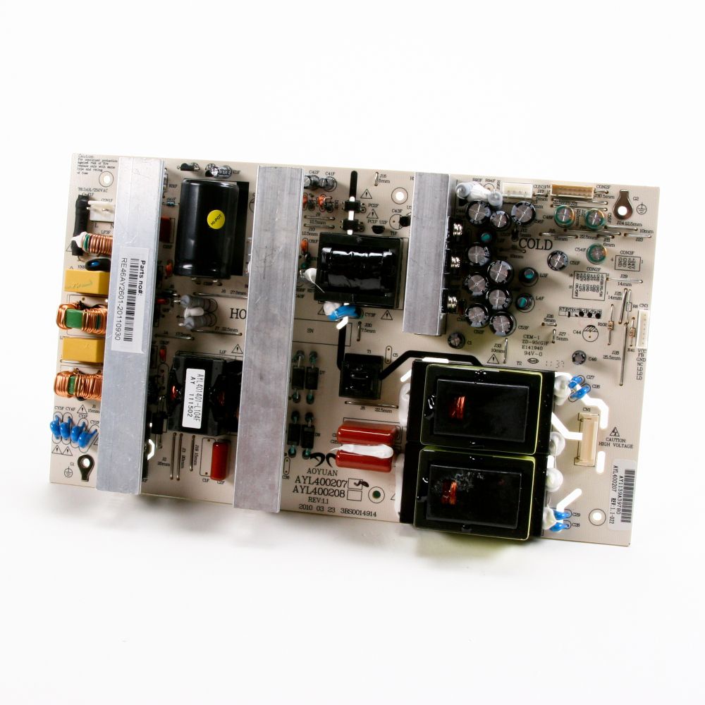

                                      well I just order a new power supply for 42 bucks a week ago, got it in and all is well, have picture and sound and no problems so far.......
