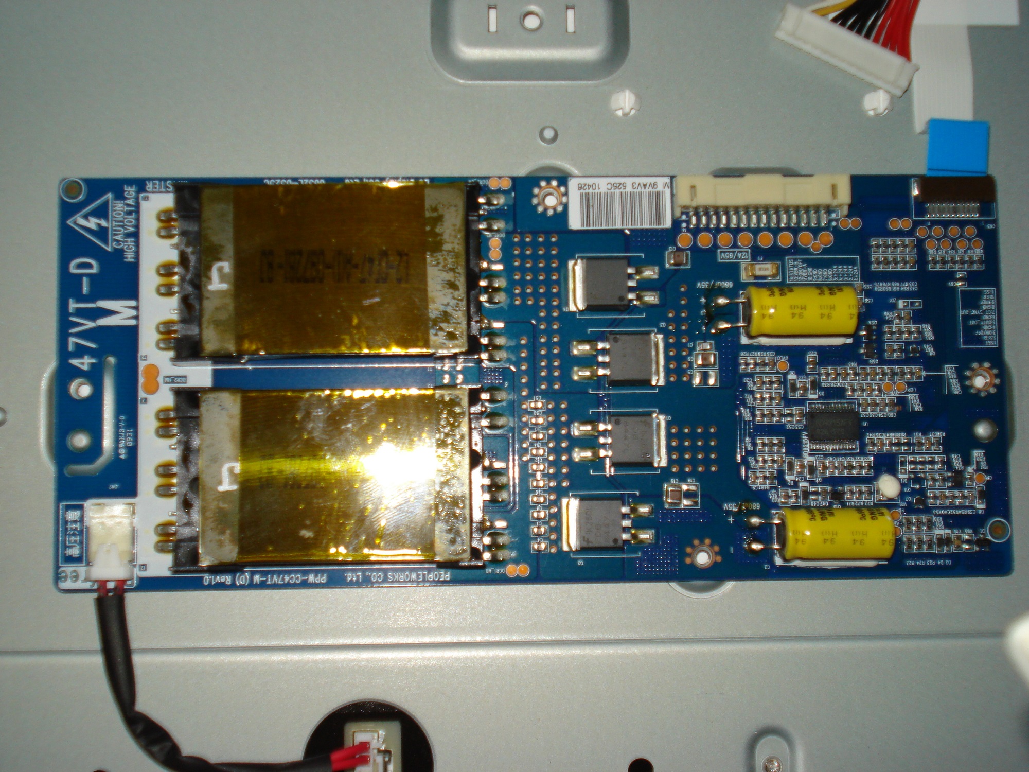

    So I got this vizio vt470m. The standby light changes to on however there is no picture. Tried the flashlight test but doesn't seem to be any picture at all. So losing some hope and guessing this might be a bad main board problem here...
    Standby voltage is at a steady 5.25V
    Once I power it on:
    PS_ON goes straight to 4.88V when powered on.
    ON_OFF will increase to 0.11 then goes to 4.8V but it would drop to 0.11 one time but go back to a steady 4.8V and stay there.
    12V pin measures 1.4V
    24V pin measures 0V.
    Checking the Big caps I get 165V on standby and 396V when on.
    Any ideas what the problem will be?

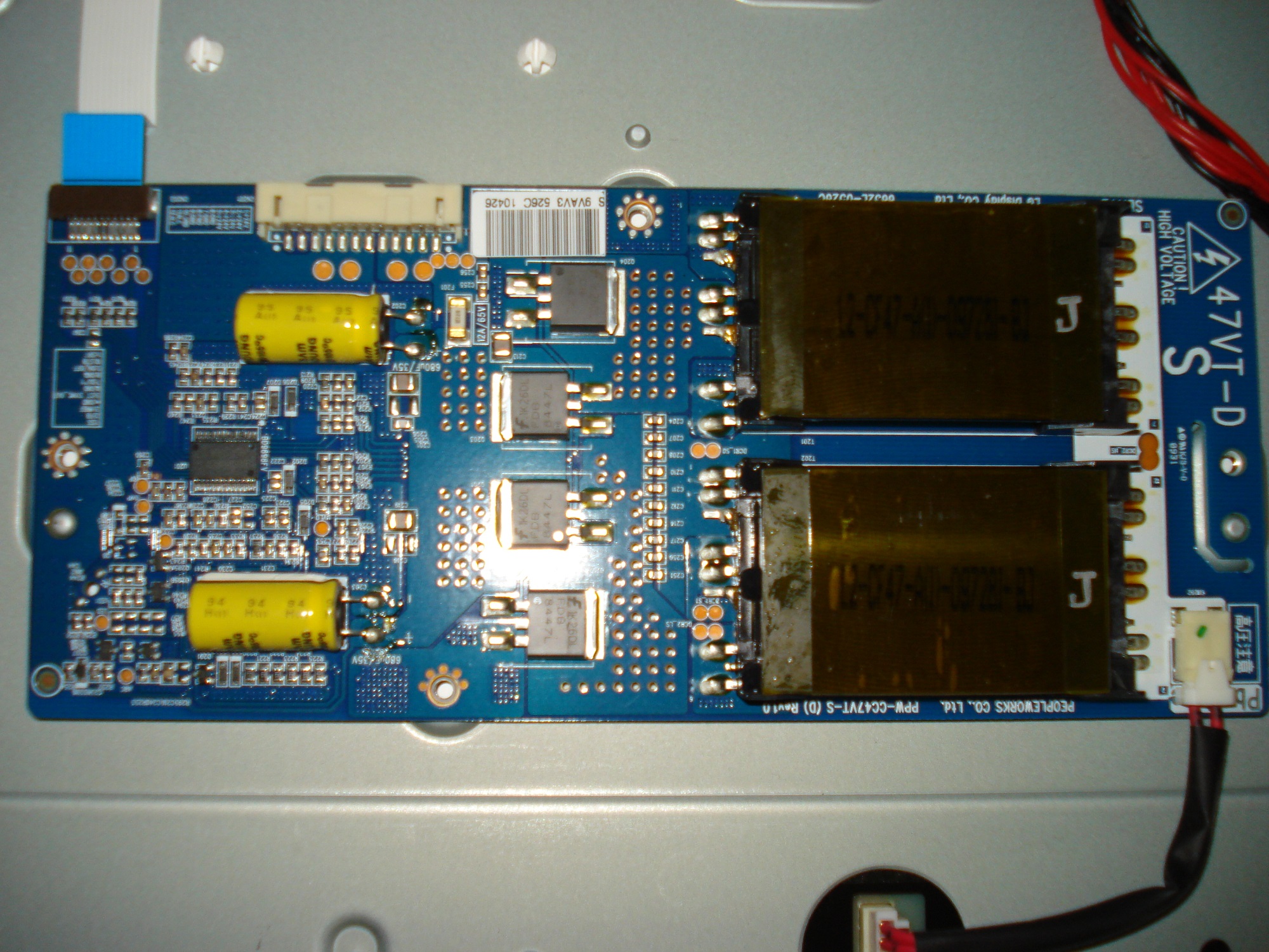

    You may have a shorted diode on the 24V line (PSU) or shorted inverter which has not blown the fuse. First try with inverter disconnected to see if 24V line rises.
      Re: 47" Vizio VT470M No picture no sound.
      The fuses on the inverter tested good. but Hmm youre right! with the inverters disconnected the 24V line measures 24.7 and ON_OFF now measures 5.23V

        OK, can you post some pictures of the inverter(s)?

            Just tested the mosfets on the both inverters. I removed the two pins off of the pcb and measured them. I found two mosfets on one board to be shorted in all three pins.

              MOSFETs are labeled:
              FDB
              8447L
              Looks like I found some on digikey!
              http://www.digikey.com/product-detai...LCT-ND/1626924

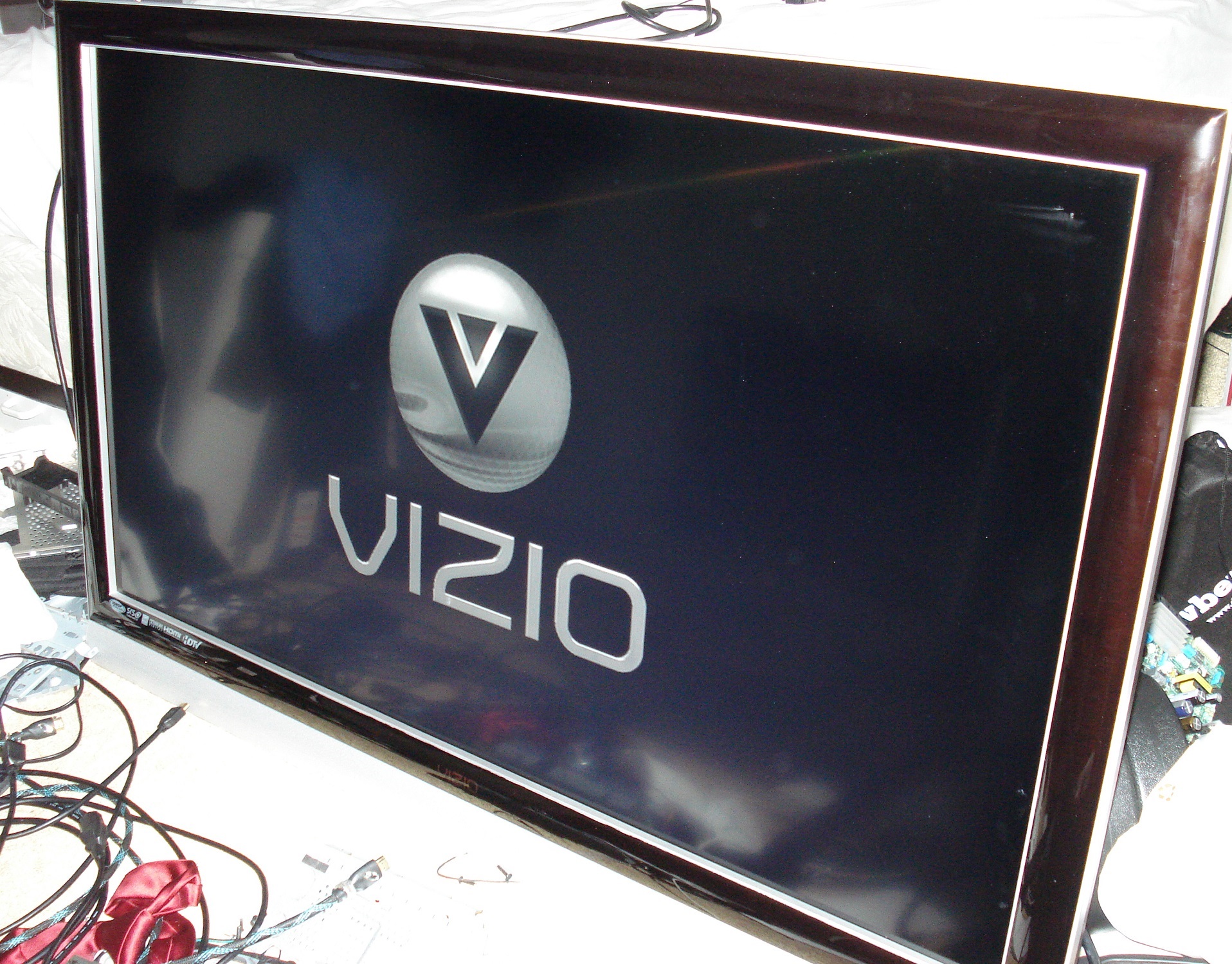

              But meanwhile I found some salvaged mosfets on an old inverter board I had with the same labels. Replaced them to see what'll happen and success! the TV is back to life!
              Thanks for the help! This TV actually has a really nice picture. I really thought it was going end up as a main board swap.
