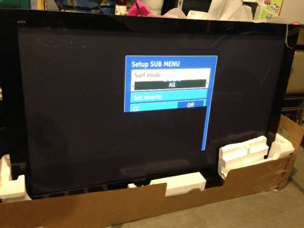

    Anyone encounter this problem before? When first turned on there is a black box in lower left corner, occasionally after 15-20 min the box goes away and the picture returns. The TV works perfect after that, until it is turned off for a while. Then the black box returns. You think its a bad panel or A board causing this? I know the A-board on the Panasonic Plasma TV has a high failure rate. Any thoughts?

    I'm not at all familiar with this issue, but it sounds like a dying panel - perhaps, similar in a way to older LGs with dying panels that have sparkles when they're cold.
    LG Plasma Mal-Discharge Correction Service
      Re: Panasonic TH65PZ850U
      Since this is such a large panel, it could be that the bottom 1/3rd left and middle drivers are failing. These large panels are typically dual scanned, they have COF on top and bottom of the panel. Unlikely to be panel - more likely to be a loose connector to that portion of the COF array - on C boards.

        My first thought is that it could not be a bad panel, since it will go away once the tv is on for 15-20 mins, perhaps warming up. So, can the bad panel be rule out and just some loose connection or bad main board causing this?
          Yes, bad panels are very rarely temperature dependent. Probably a loose connector.
