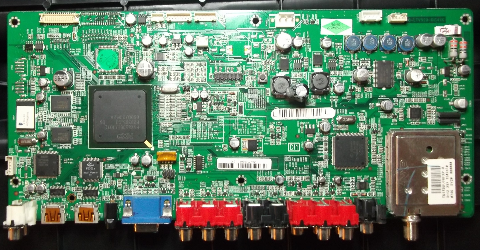

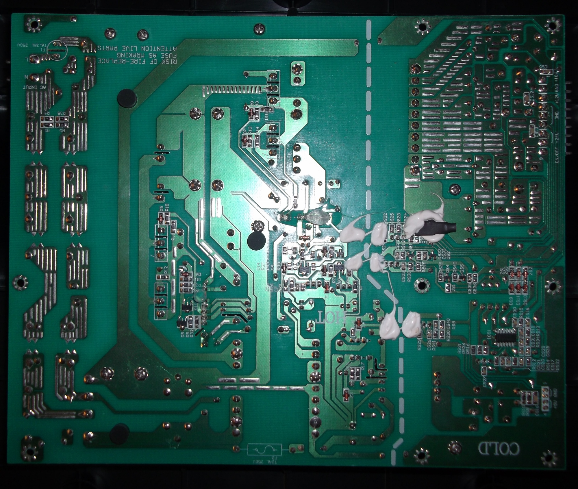

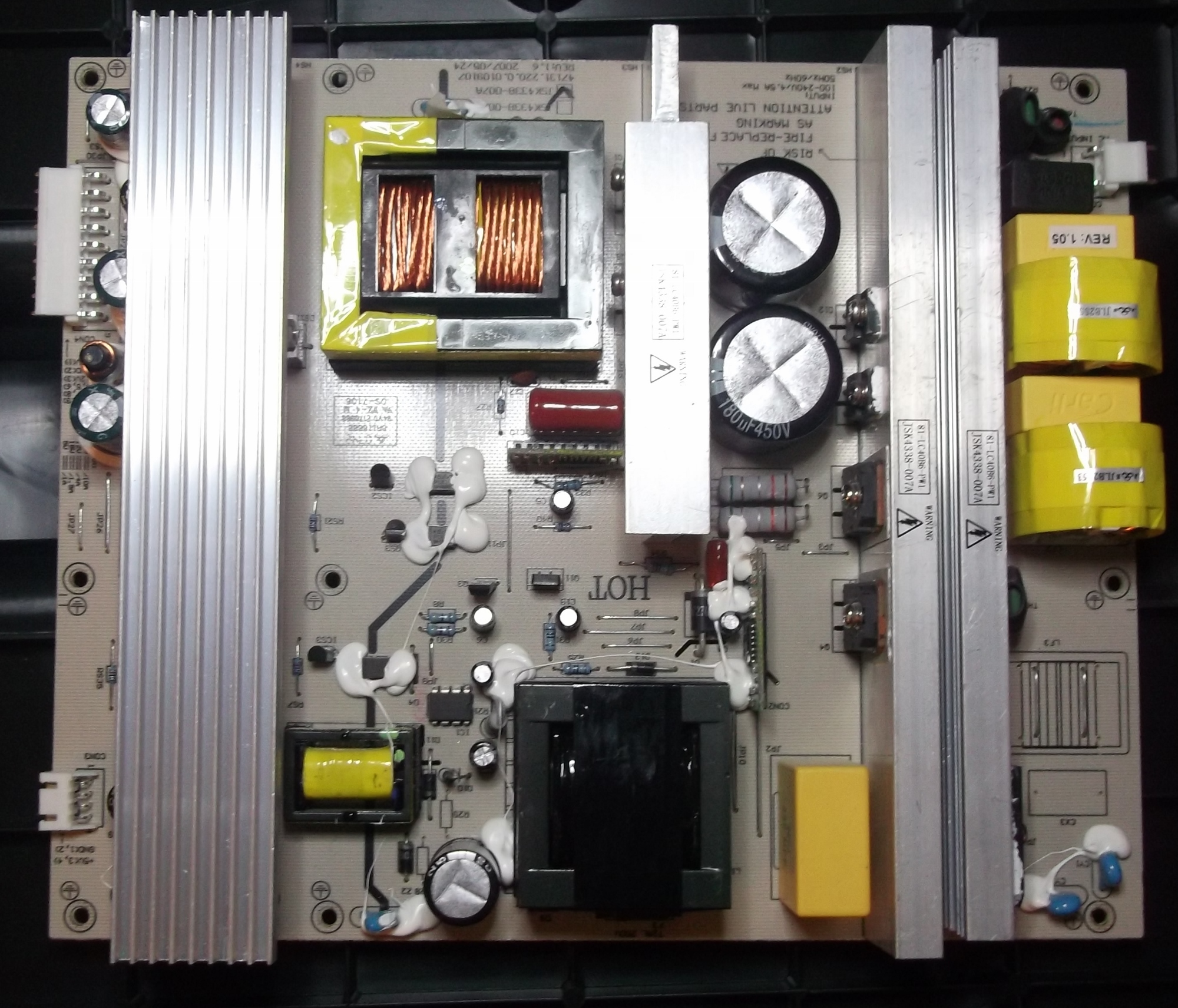

    Hi, new to the forums. Got this TV from a friend who was going to throw it away so I was going to give it a shot at fixing it.
    What the TV does is when you first plug it in you get a green LED on the front for about 2 seconds then nothing. Checked the power supply and I had found one bad capacitor that had vented. It was a 450v, 22uF capacitor which I replaced and no change. I get 5v standby and no other voltages.
    When you first plug the TV in and the green LED is lit up I get 4v to the on/off port on the power supply with no other voltages. It would seem to me like the power supply is not turning on or is it supposed to turn on when you first plug the TV in? The power button on the TV does nothing.

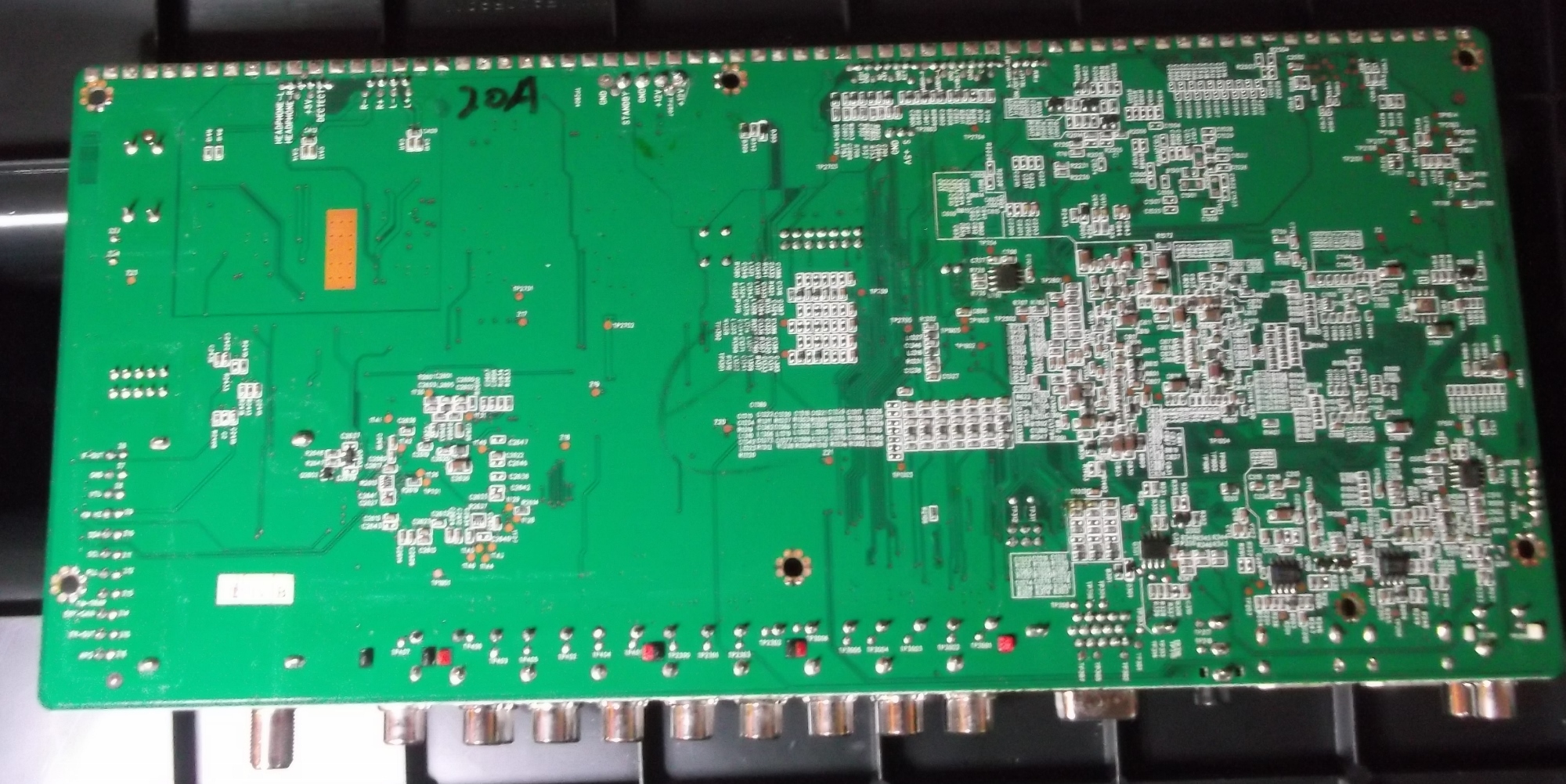

    Any help would be appreciated. I'm a beginner with electronics but trying my best. I included pictures of the main board and power supply.

            I've tried disconnecting the inverter boards already with no change. Shouldn't the power supply turn on with the 4 volt signal from the main board when the TV is plugged in? I get no power on the 12, 18 and 24 volt coming off the power supply.
              Re: RCA L42WD22YX6 no power (sort of)
              That indicates a problem with the power board then.
              • 94shadow
                • Sep 2013
                • 10
                Is there anything on the power board that I could check to indicate/troubleshoot why it's not starting?
