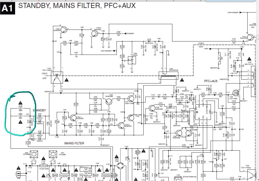

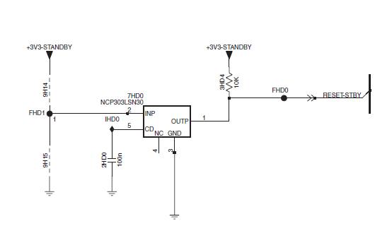

      I finally solved the problem which was due to a lack of power on the 3.3 v stdby supply. When hitting the Power switch, the 3.3v stby supply was droping down to 3.15v (3.4v during normal operation). This was detected by the 7HD0 IC (NCP303LSN30) thus generating an undue Reset-stdby signal which is supposed to happen only at mains plugging. The resest-stdby signal was forcing the controler to remain at the Off state instead of going to Standby status when pushing the power on button.
      The 3.3vstandby power line is generated separately than the other supplies in the PSU. It's circuit is powered by the main line through two caps in parallel (100 + 22nF) labeled 2165 and 2179. Their values were 67 and 17 nFarad respectively. Replaced by a new MKP 0.12uF has solved the problem.
      The tricky thing is that the 3.3vstdby supply was OK when set was either working or in standby and only droping when pushing the Power button.
      Hope this ca help someone as I spent hours of intensive search for this problem.

              Re: Philips 42PFL9603H chassis Q529.1E LA wont power on
              There is similar bulletin on these caps.

                  Well this thread did the trick! Thanks guys! I followed the instructions in the .pdf above. The components cost me just around 5 DKK = ÂŁ0.50 = $0.75. Postage was 12 times this amount! Removed the existing caps and replaced with the new ones. TV worked first time! Certainly cheaper than buying a new one. Thanks again everyone.

                          Thank you very much! As discribed in the posted PDF I replaced the capacitor 2165 from 22nF (it had only 18nF) to a 47nF and the capacitor 2179 (it had only 56nF) to a new 100nF.
                          Now the TV works perfectly again!
