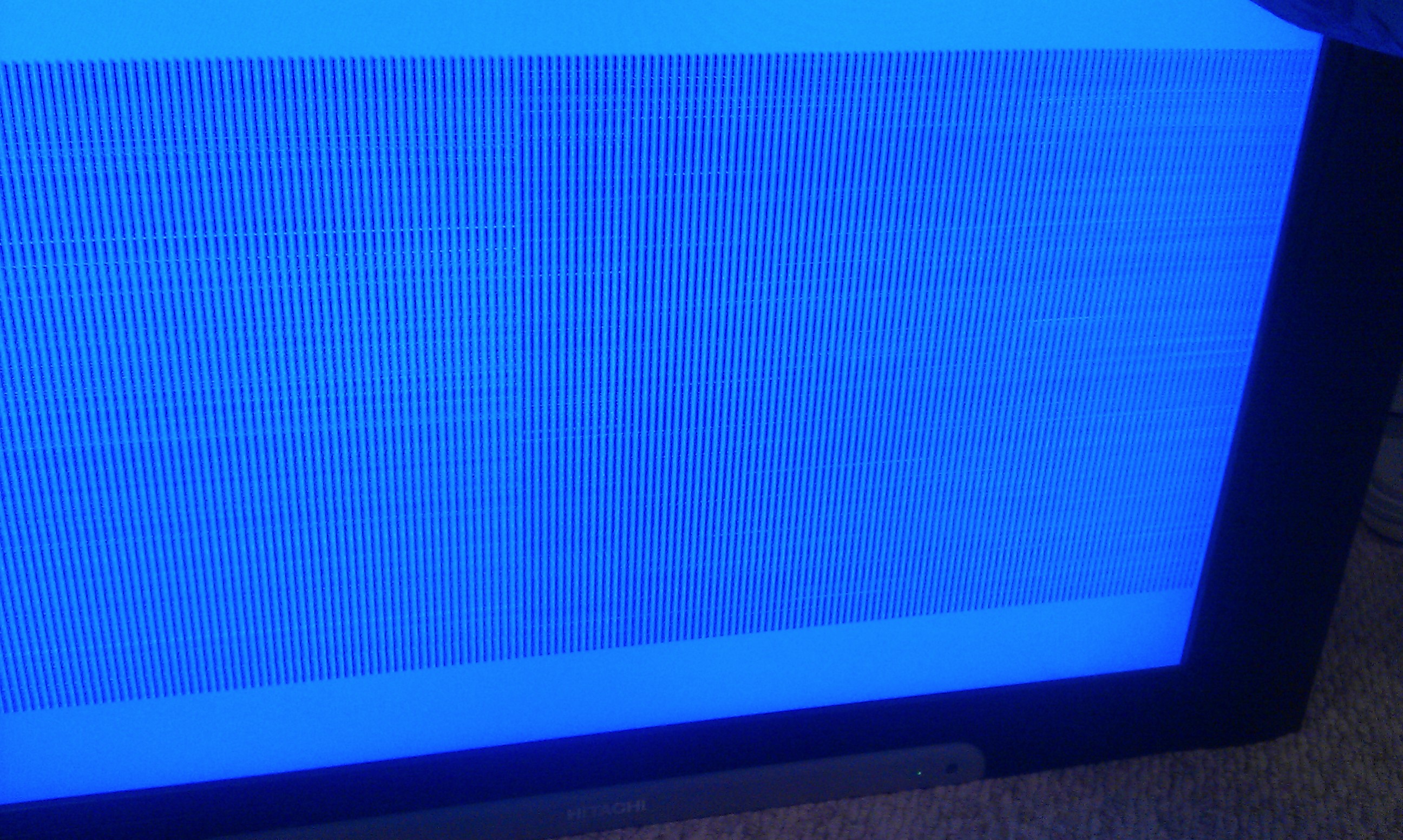

    Hi all, i have the above TV with a strange picture problem. The sound is working but thats all. I cant see any menu at all. I have unplugged the LVDS cable & cleaned it but no difference. Could it be the main board?? I have noticed what i think is a bulging cap on the psu board not sure if this would cause it??
    Any help would be appreciated.

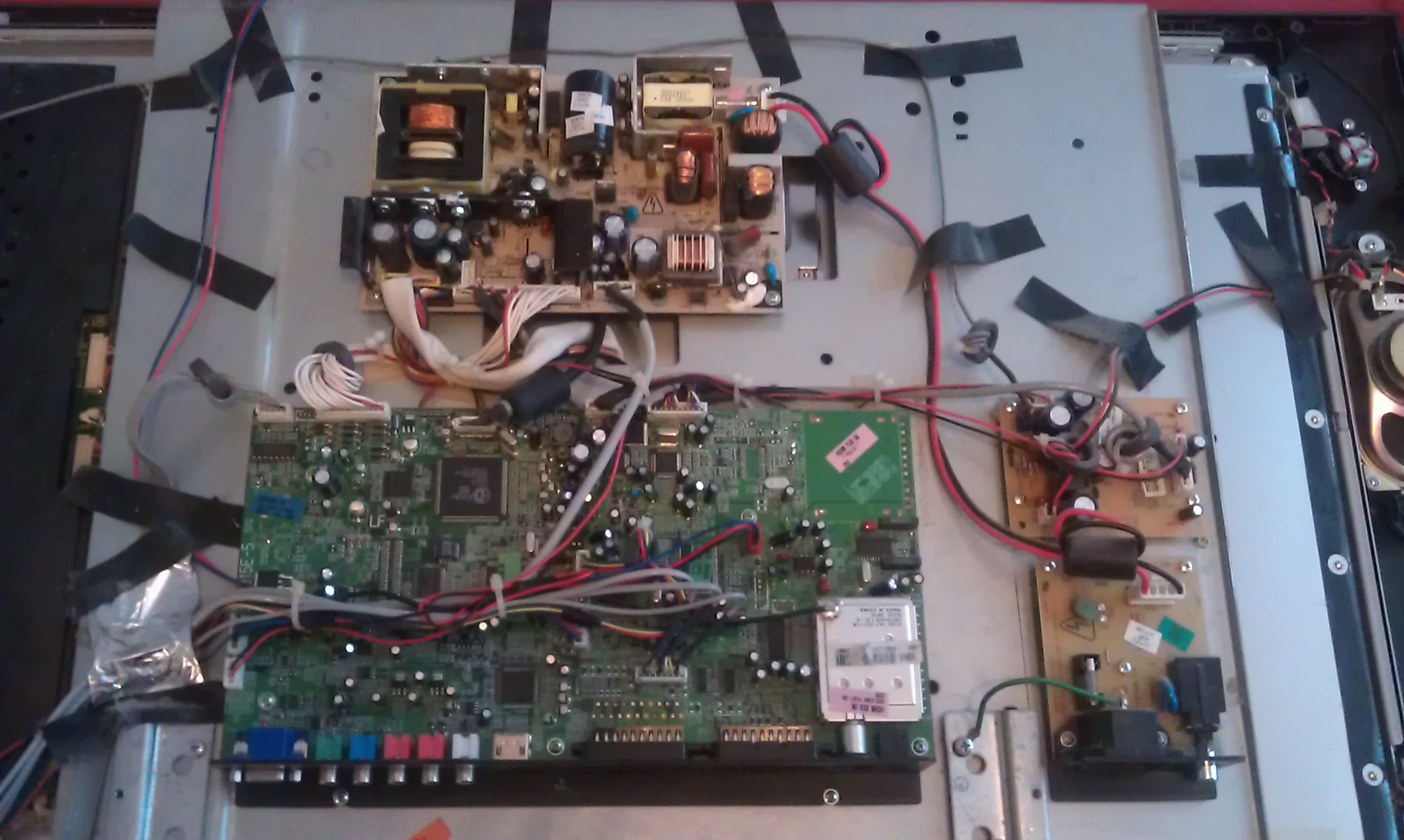

    the first thing someone is gonna ask is for you to take good pics of the whole tv with the back off and then pics of each of the boards so they can see what you see to help you diagnose the problem.

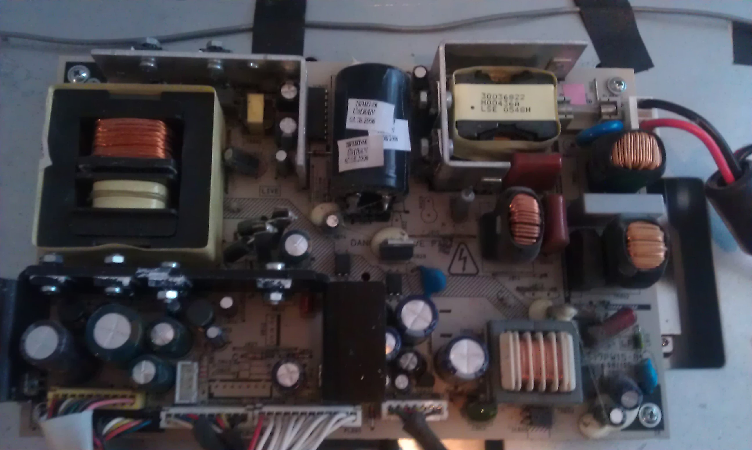

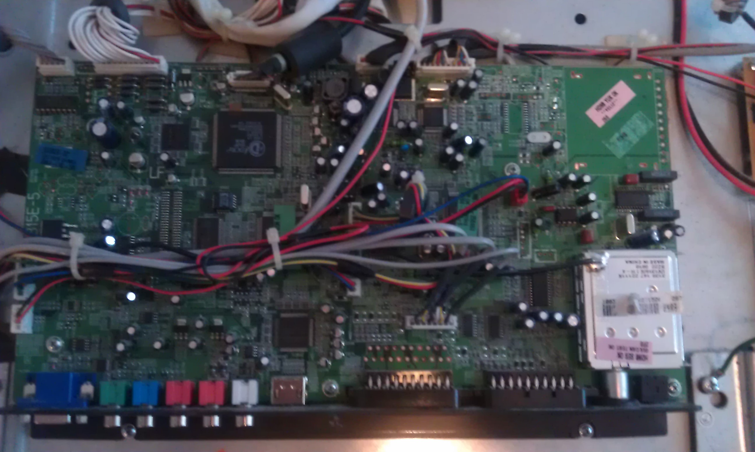

        Re: Hitachi 32LD6600B strange picture (with pics)
        Hello, i have now attached pictures of the TV with the back off.
        Any assistance would be appreciated
        Thanks,
        Tony.

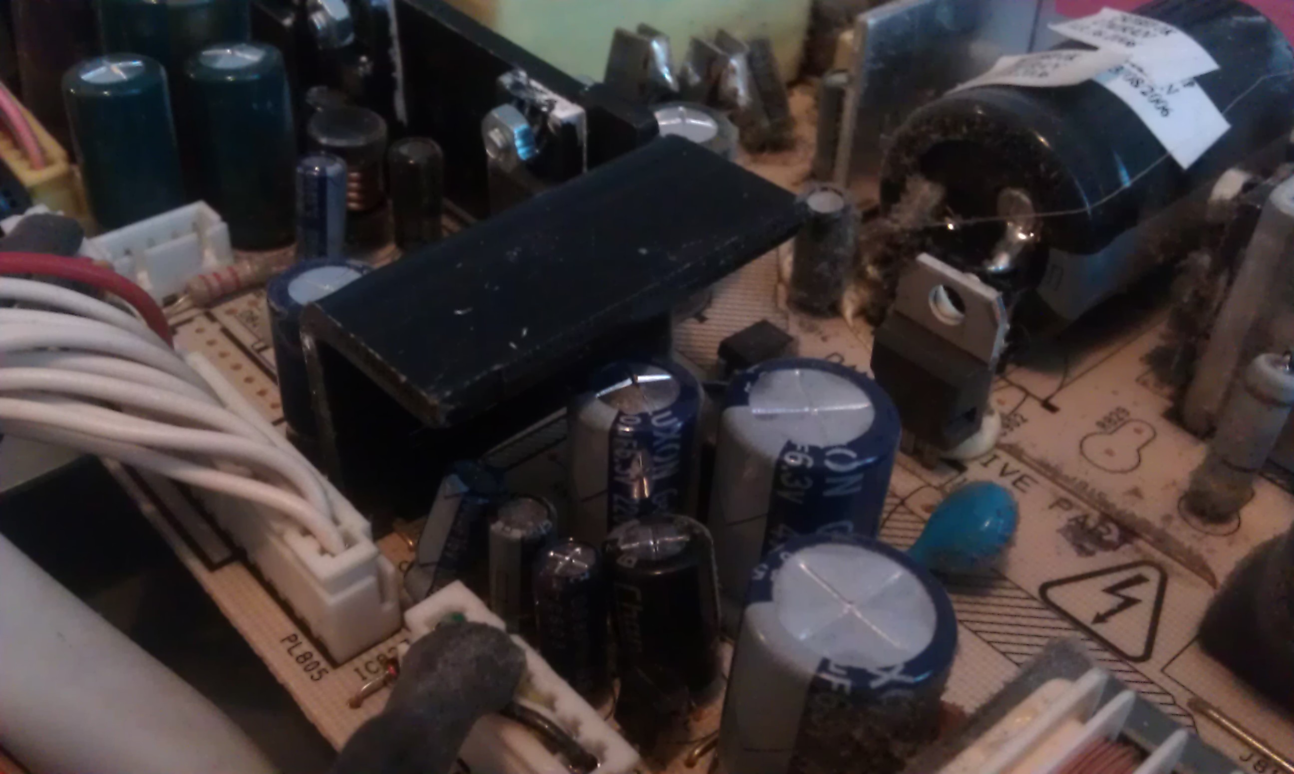

          Oh god! It's a Vestel. Kill it with FIRE.
          Yes, that cap can easily cause a fault like that, these Vestels are well known for blowing their caps on the power supply.
          You can check the output voltages on the power supply to see if they are low, there are 33V, 24V, 12V, 5V and 3.3V.

                Right ok, i have got the back off powered it up with the black probe on the chassis. When you say red probe on the connections from the PSU i assume you mean the connector blocks??? There are five as i have circled red in the pic. Do i probe each red wire on the connector blocks as there are more than one on some of the blocks?
                Excuse my lack of knowledge.
                  Yep just probe each - the probe needs to touch the metal sheath around the pin to get a reading.

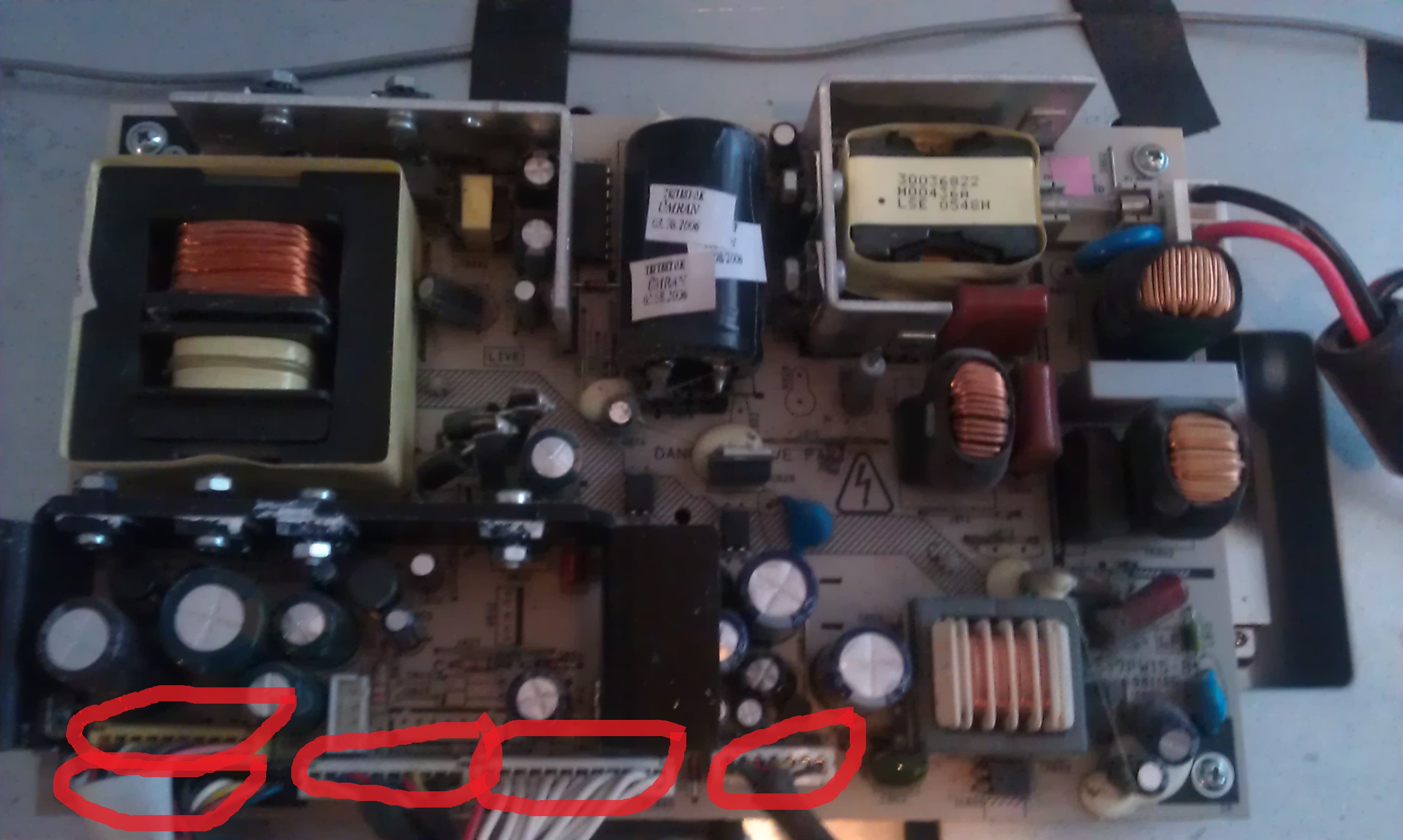

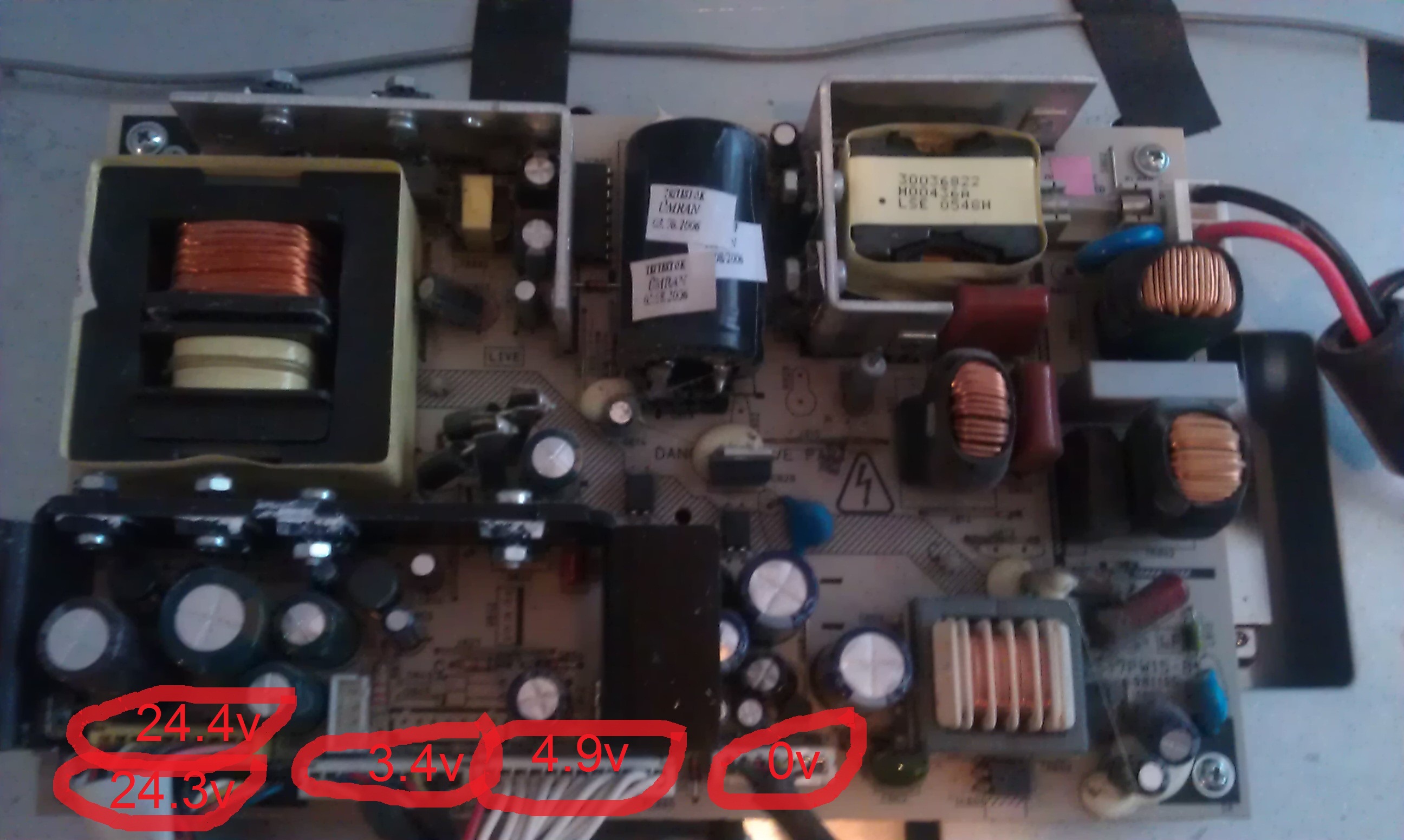

                      Right i have noted them down on the attached pic. One i am not getting a reading from at all!!!!
                        Sorry, misunderstanding, what I intended was a voltage from each of the pins. For example that left connector might be 24.0, 24.0, 24.0, 24.0, 0.0, 0.0, 0.0, 0.0, 3.0, 2.5, 0.0.
                            Bottom left - 24.4,24.4,24.4,24.4,24.4,0,0.0,0,3.4,1.1,3.3
                            Top left - 24.4,24.4,24.4,24.4,24.4,0,0,0,0,0
                            Second from left - 3,1.1,4,0,3.3,0,34.9,11.9,0,0
                            Third from left - 4.9,4.9,3.3,3.3,3.3,3.3,3.3,0,0,0,0,0
                            Far Right - 0,0,0,3.5,3.5,5,5

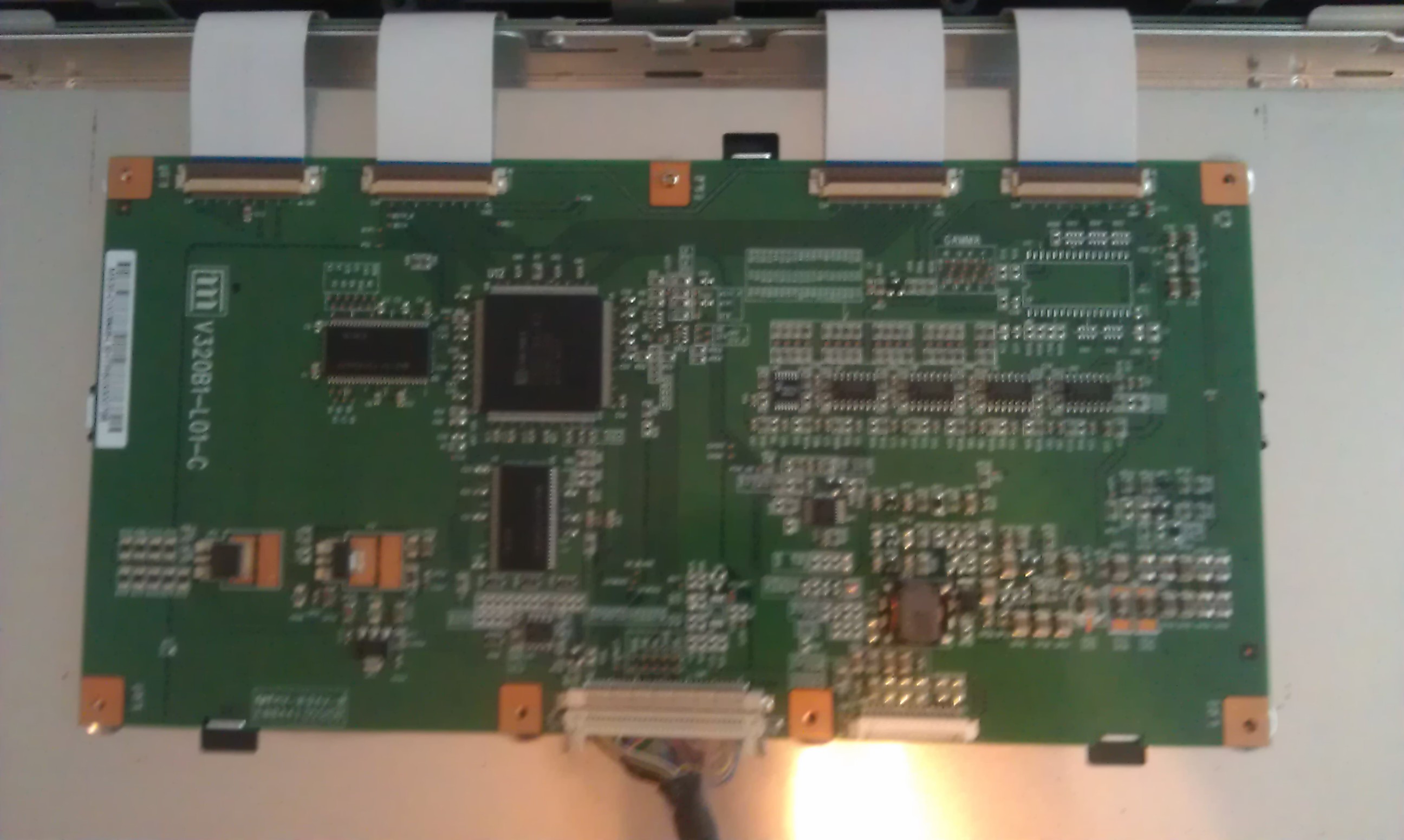

                              Looks like your voltages are good. I'd replace the capacitor, but I think the fault is with the main board.
                                  I would change all the caps below the //////// line, cold side. I see at least 2 that appear bad. Replace with panasonic FM or FC series caps. High ripple can cause this problem.

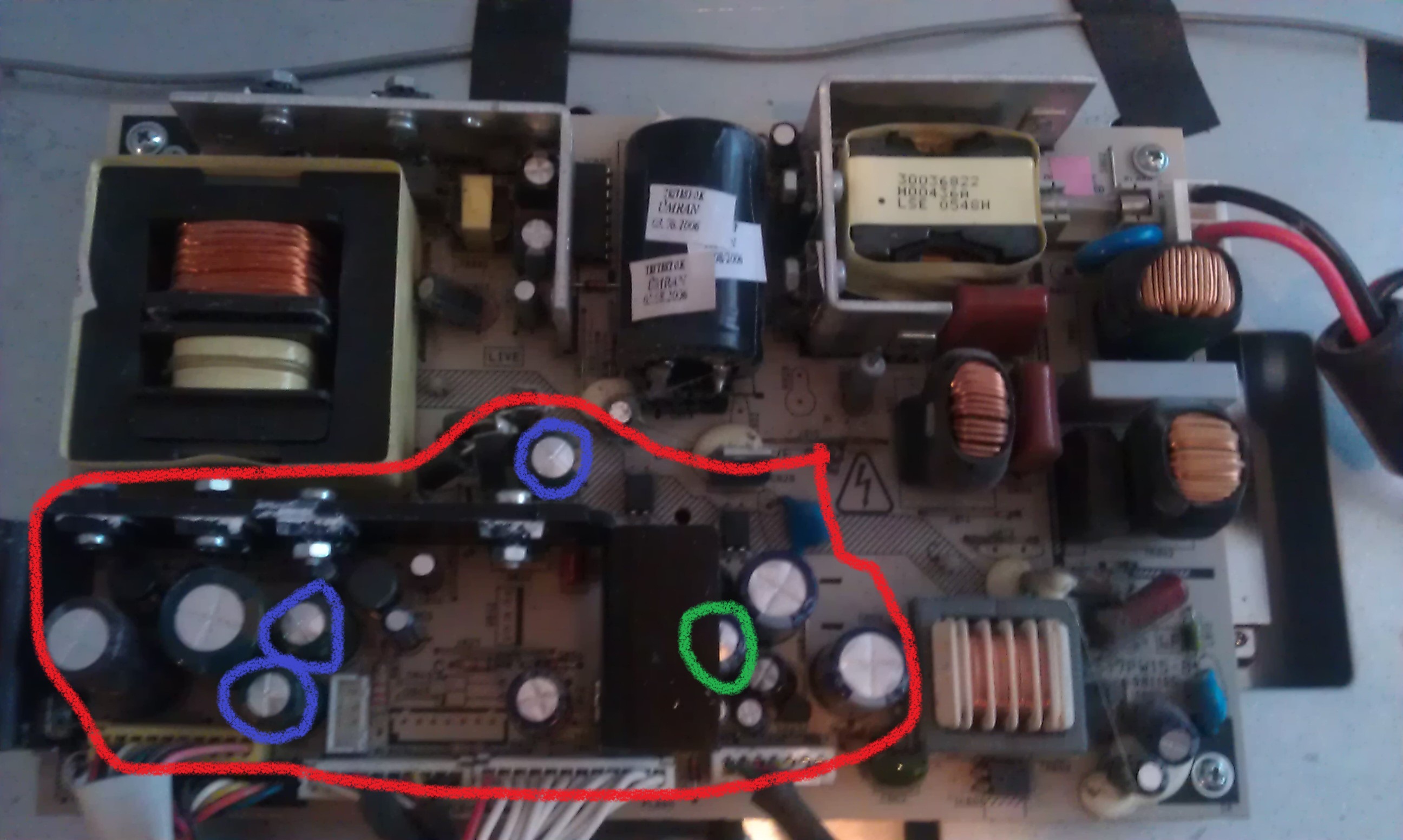

                                    Sorry but what does cold side mean??? Do mean all the caps in the area i have marked with red attached??
                                    I have circled a cap in green that i was planning on changing but now i look at the ones circled blue they also look bad.
                                    Do you agree??
                                    Thanks,
                                    Tony.
                                    • attainteddragon
                                      • Apr 2013
                                      • 764
                                      • australia
                                      the ones you have circled are the secondary side (cold side). everything beyond the shaded line is the secondary!

                                      • freakaftr8
                                        • Oct 2012
                                        • 3743
                                        Yes when in doubt change them out. Secondary side (cold) is where the power supply takes one main voltage and converts to many output stage voltages.
