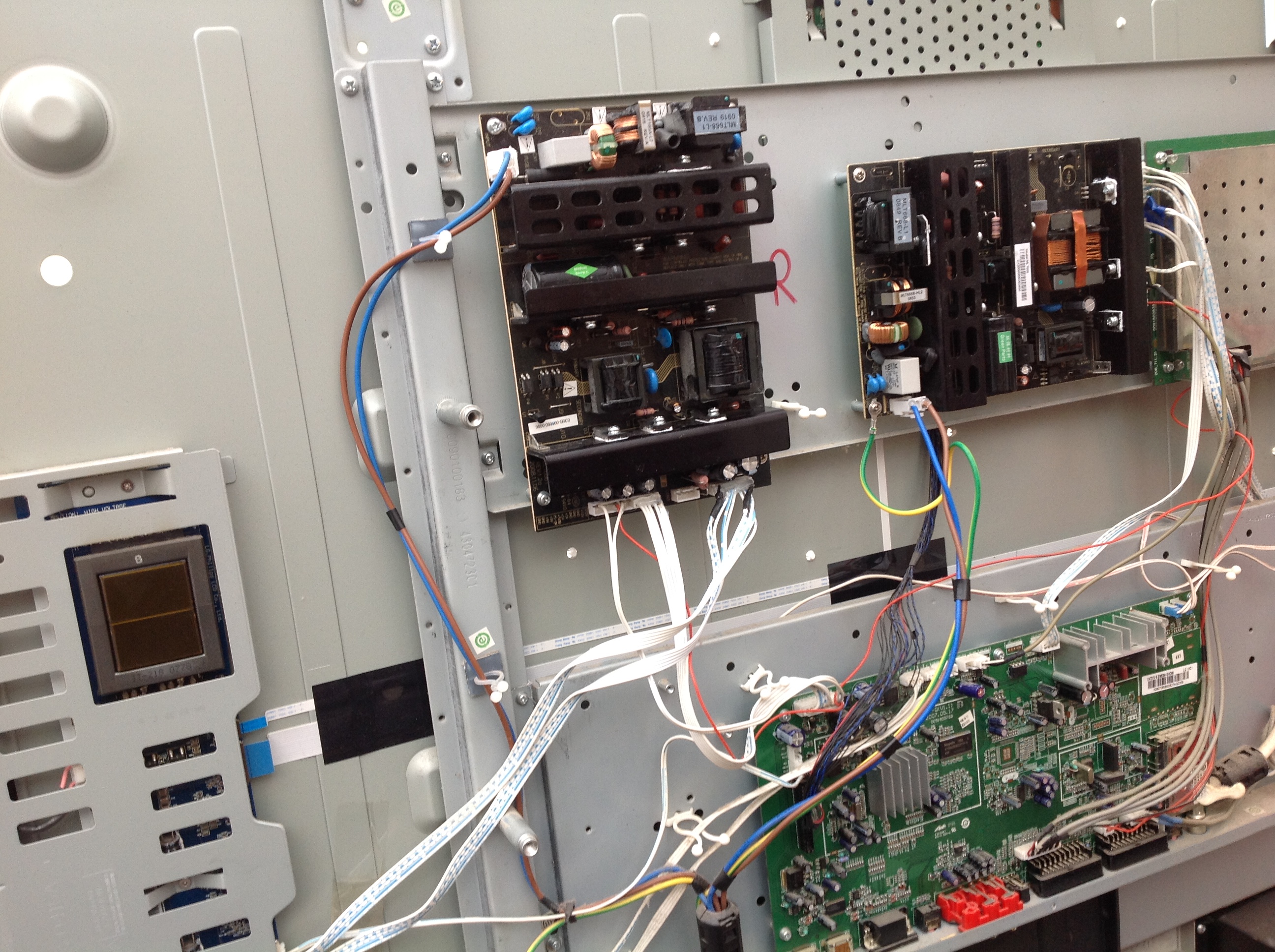

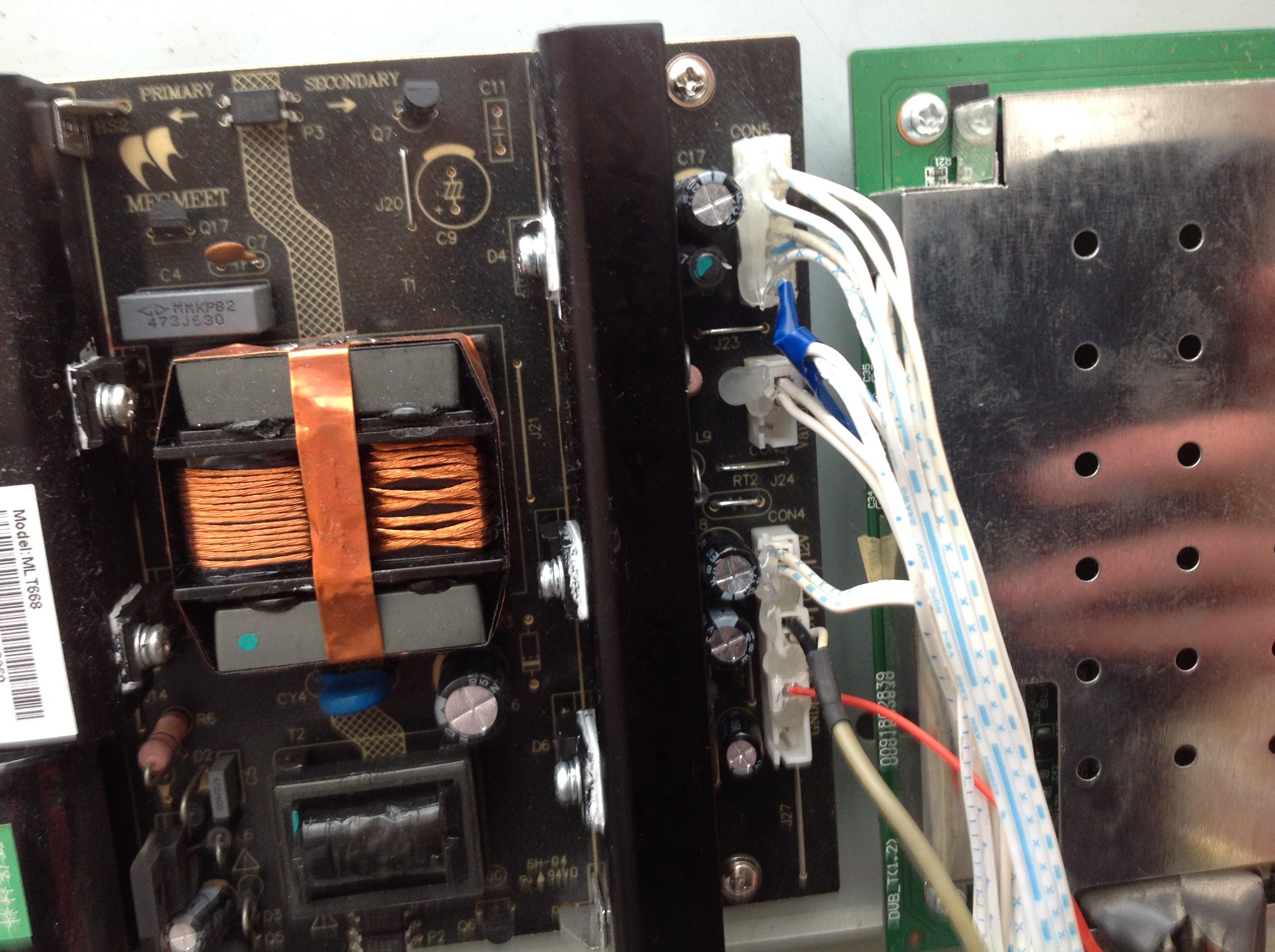

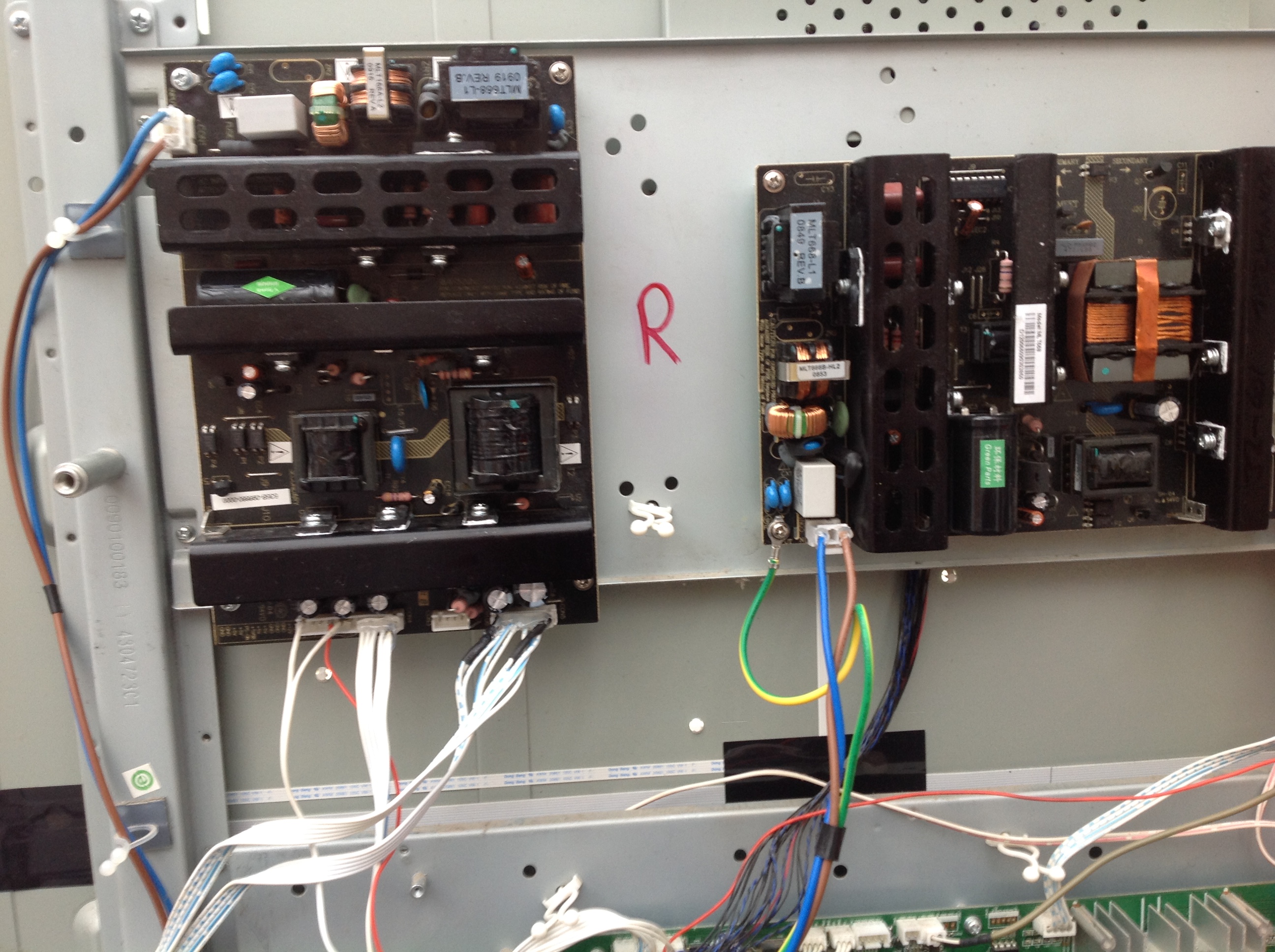

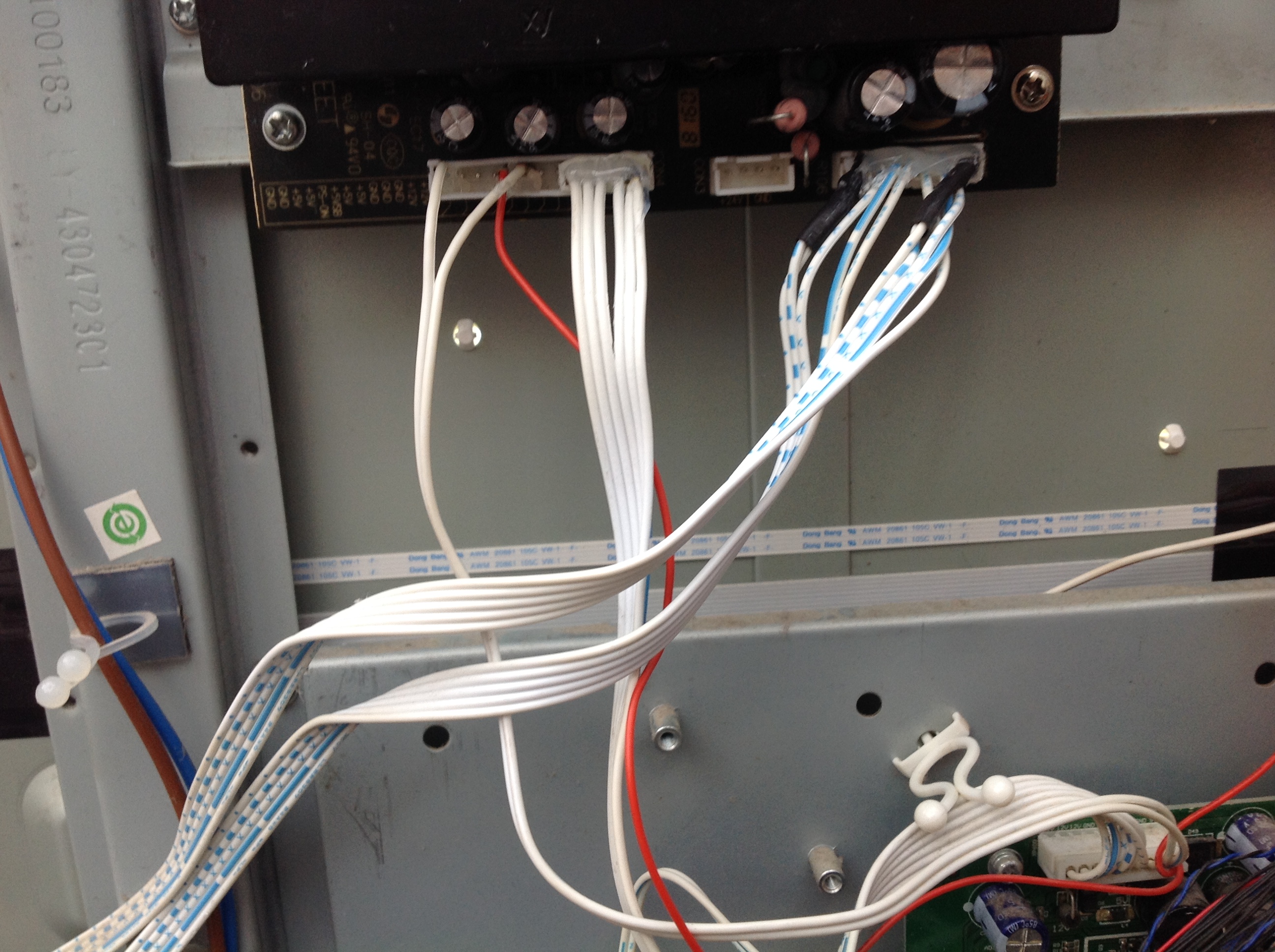

      Re: Baird X47DTV Psu
      I know this is an old thread but I thought I would just update it, you can use the megmeet mlt668t power supply in this model it will power the tv fine and they are in my experience much more reliable as the original pihongs, however you will need to do some rewiring the get the connectors to fit I repaired one with them psus and all works fine.
      Pictures showing the mlt668t's installed and backlights running, yes there is a lot of rewiring to be done but as long as you wire it fine and secure the wires (I used hot glue) these will run the tv fine, the shame is that they get very hot this tv could do with active cooling heat was probably what killed the original pihongs and probably kill these with in a short amount of time. Overall a very poor deign period running two power boards feeding very hungry backlights with little vent holes is a massive issue designed to fail, so be sure to keep these clean and don't block the vent holes, hope this information helps.
