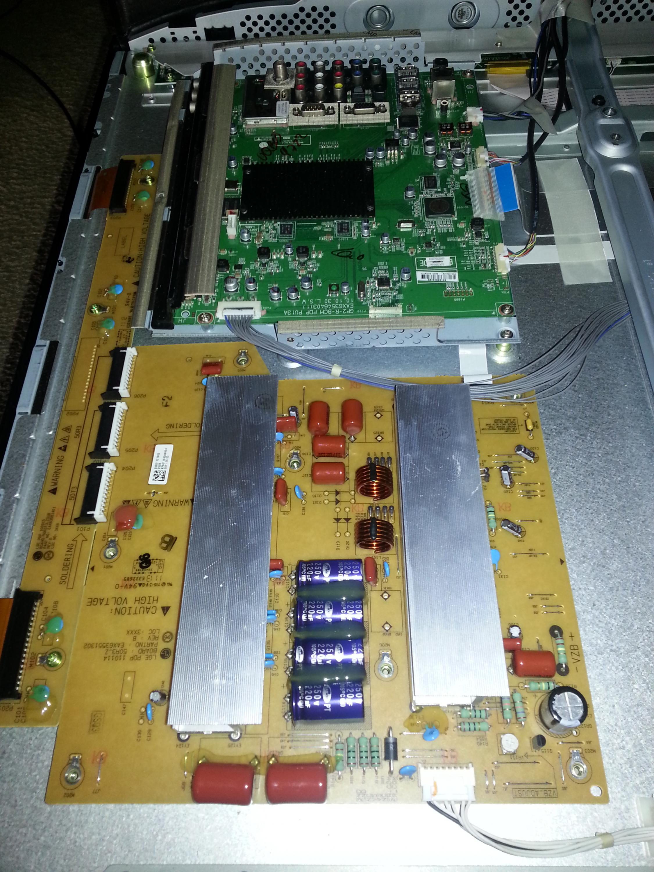

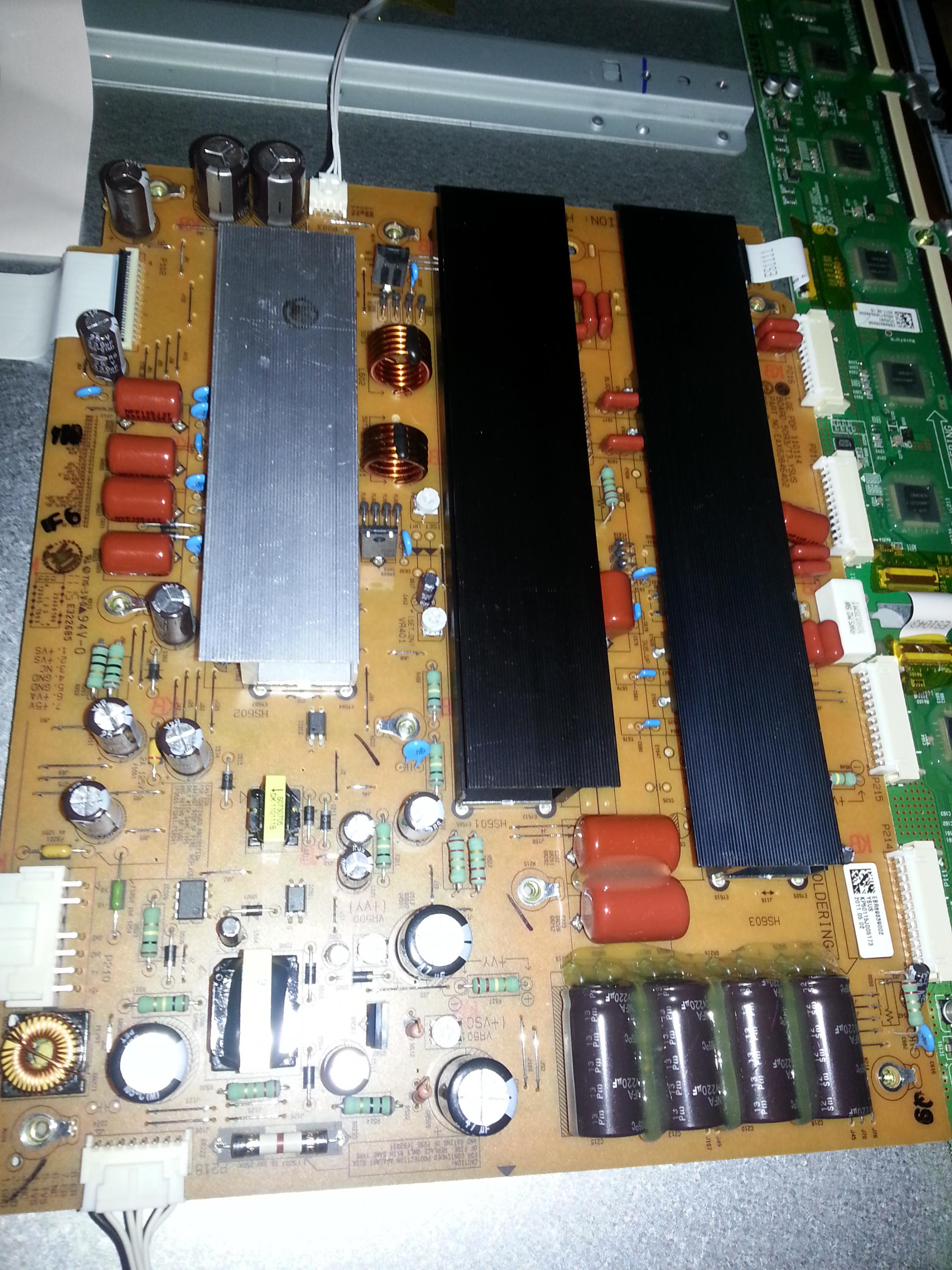

                    Alright I think I've just about had it. Got 2 new y and z sus boards today and it seemed to power on for about a minute but there was no picture or sound so I turned it off. I turned it on again I saw the screen come on with a black thick horizontal line on the top half of the screen then the speakers made a loud growl noise... Then the z sus popped yet again. Took off the back panel unplugged the z board and tempted to turn on the TV again. It turned on for a couple of seconds then the middle black bar thing on the y board sparked at the tip of the black thing. It's getting pricey so what is causing these issues now? Could it be the panel? I'm guessing those are a bit difficult to replace.

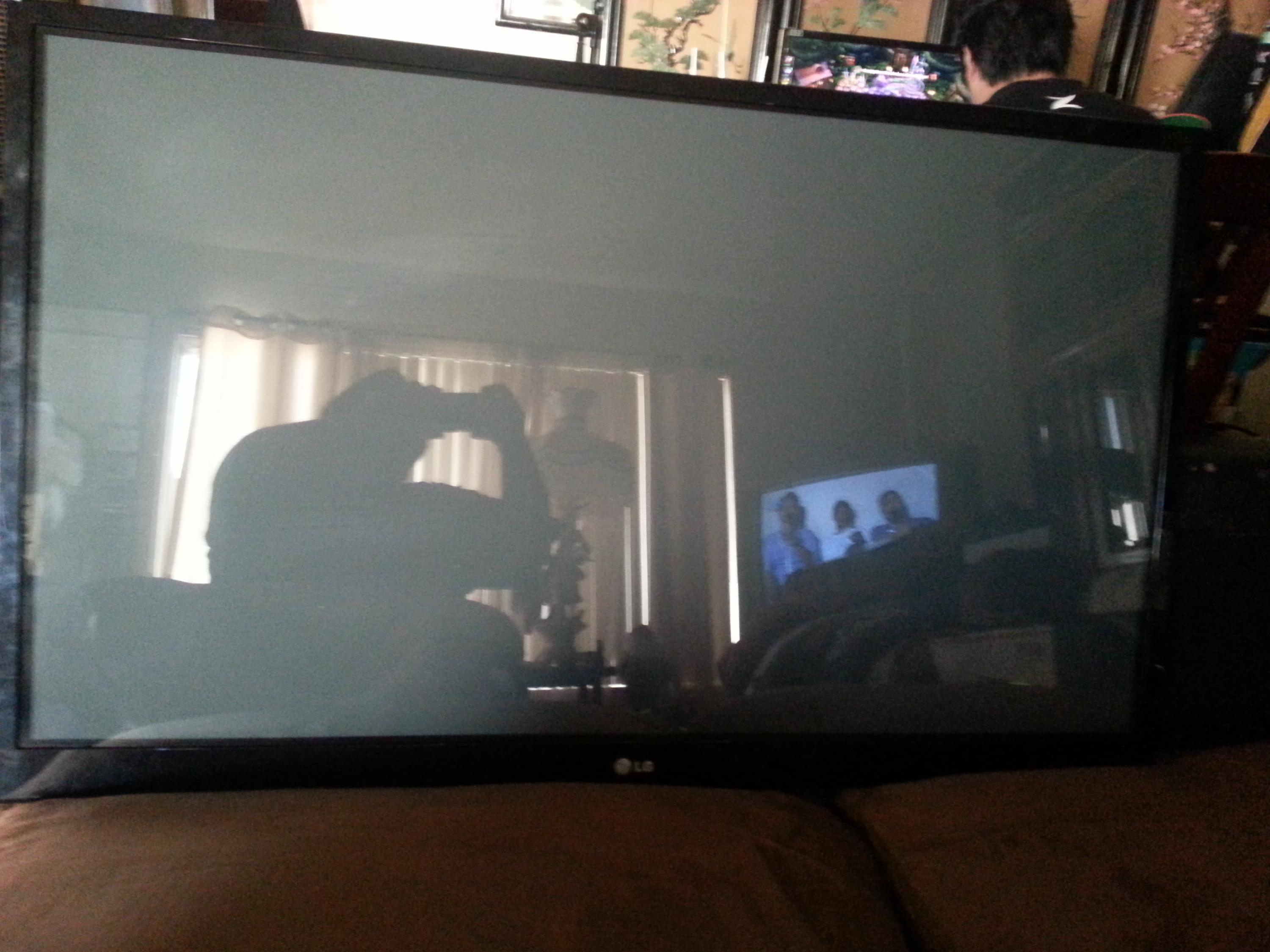

                      Horizontal line from top to bottom? It could be the panel is cracked or damaged, even if just on a corner or in the middle of the screen. Some newer plasma screens will light up when cracked, but can damage the sustain boards when this happens.
                      Could you perhaps get a picture of what it looks like when it turns off?
                      Also, try isolating the speakers by disconnecting them to confirm the sound definitely is coming from those.

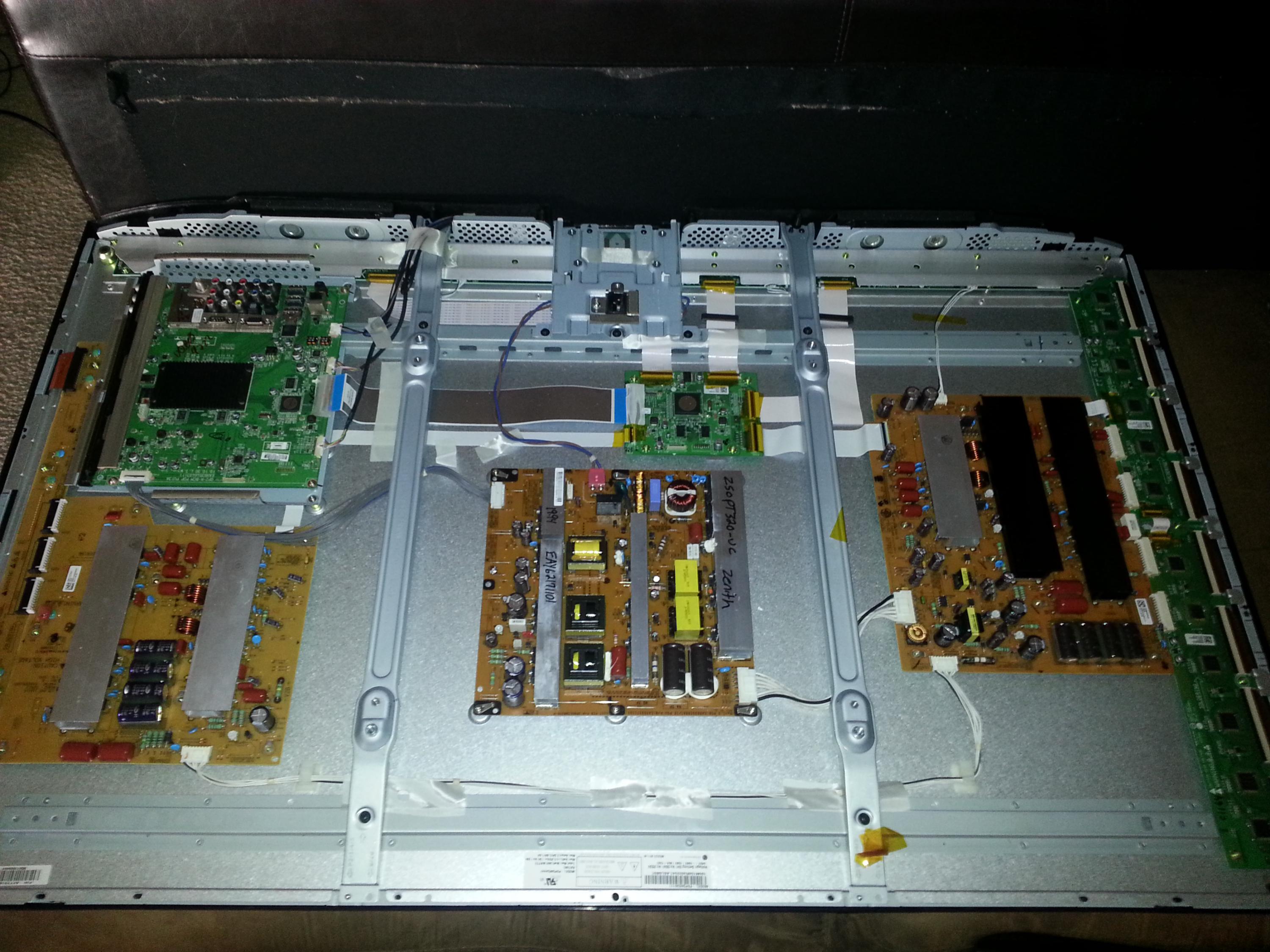

                        Hey Tom let's see if I can upload some pics from my phone. Took pics of the back panel off with close ups on the y and z sus boards. On the screen the line was a bit above on the top half of the screen. It went left to right and the thickness was about 2cm and it was also squiggly. If I recall the 2nd time I turned it on when the loud sound happened seems to be coming from the top right part of the screen, where the y buffers are. Is it possible that the y buffers could be causing an issue? or the main board? I do know that if the main board is not plugged in to the PSU board it would just click on then off. If the y sus board is disconnected with only the main board connected it will just turn on without picture.
                        As for any cracks on the screen I don't think I saw any when the TV turned on briefly since it was backlit when it was on. I only noticed the thick squiggly line.
