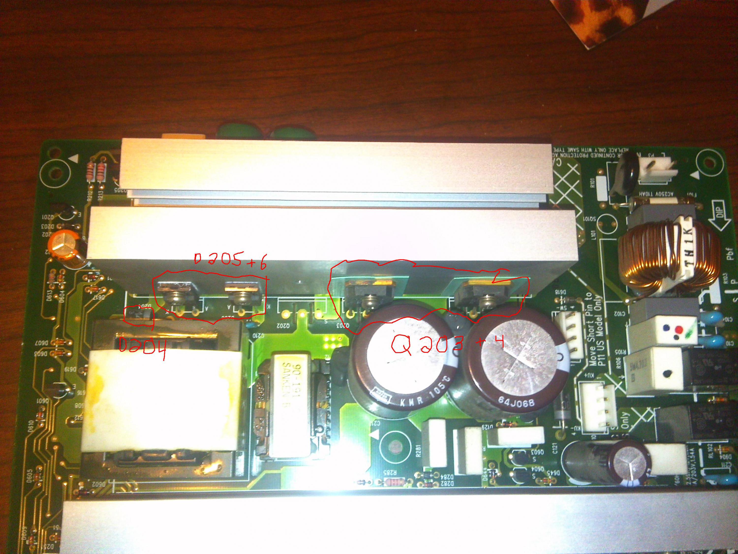

    Can you take a shot so the devices on the heatsink near D201 are visible? Looks like that area has got hot so is a candidate for failed semiconductors.

      d301,307,372 are the ones i got "bad" readings on and d204 and rc101 are the 2 that according to the manual you are suppose to check to get 390v and i was only getting 174 volts between them

          Re: Pioneer Plasma Model# PDP-5070PU main board bad?
          i tried all the numbers on there to find 1 and came up with nothing. and did you mean a pic of the heatsink by 204 not 201?
            #45
            1h349wa sanken and pdc10287h m and axy1150ae are all the numbers i looked for.and if you meant d204 then d205 and d206 are on the heat sink and i checked them and they seemed fine and they are the ones closest to d204 and the other 2 on the other end are q203 and q204 but i didn't see any signs of heat but i will take a pic
              #46
              Yes heatsink by D204 please.
                #47
                here it is. i don't think i have taken so many pics of one thing in my life. i don't have any kids so thats probably why.
                  #48
                  D205, D206 test good?
                    d205 and d206 both read about 435 with neg. ok k pin and pos. on a pin and when reversed they read open. r208 and 209 both read continuity.part # is ICE1PCS02 i think that is it
