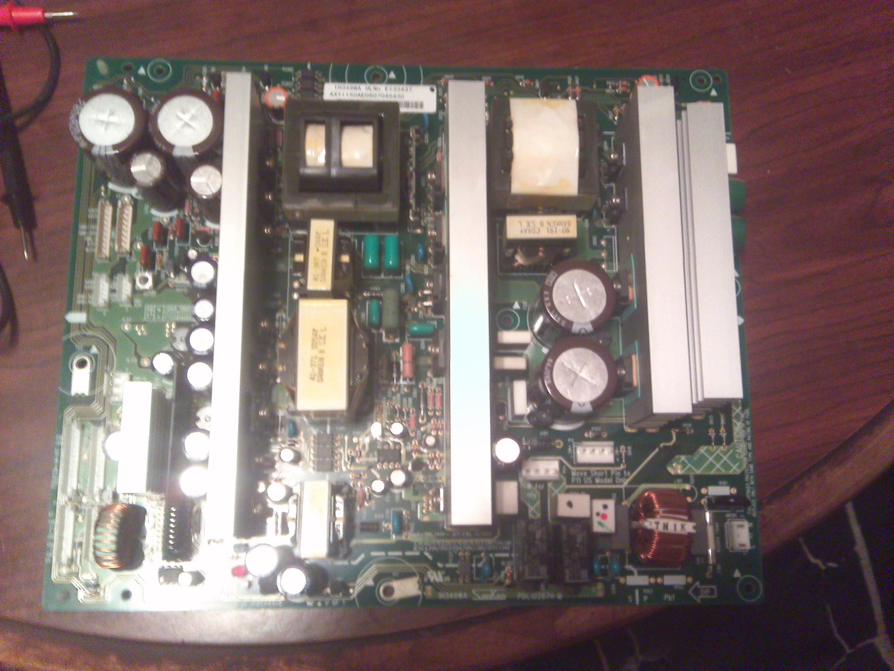

    ok i tried to reset the trap switch by entering service mode but i can't get to the screen to fix it so i checked it after i tried to enter the service mode and it read 60volts until it shut the glow on the screen off and the relay click and put the red light on the main board once it shut down then the voltage dropped drastically

                  Can you show me the general area you are testing? D204 may be shorted, PFC IC may be bad, PFC Vcc cap may be bad. Any schematic for power board?

                            Can you provide the picture I asked for?

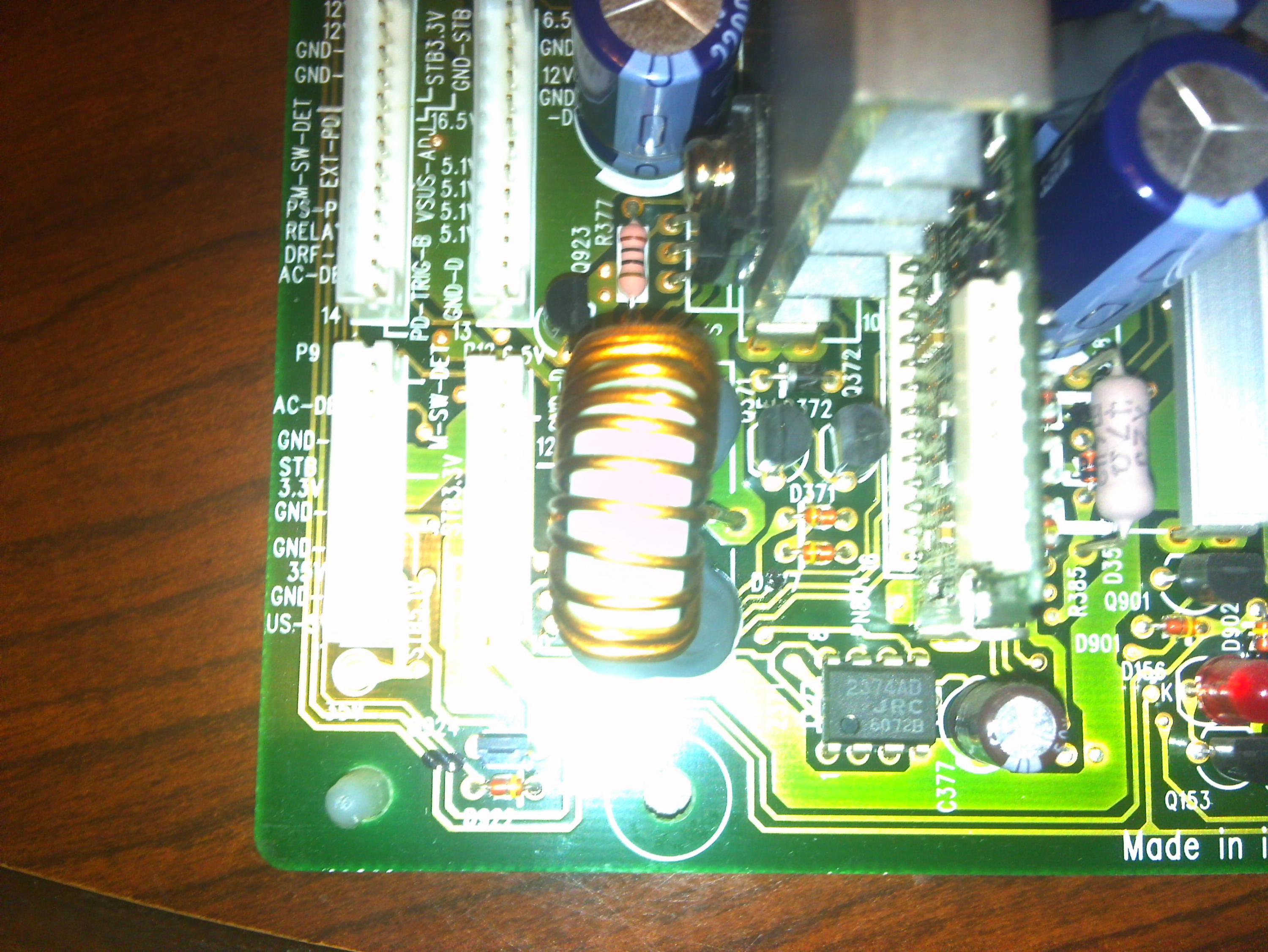

                              Re: Pioneer Plasma Model# PDP-5070PU main board bad?
                              of the area of the board where i checked d204 and rc101? yeah give me a few minutes. i took the board out and check a bunch of diode on the board. all diodes are suppose to read only 1 way correct? if so i found 3 that read both ways and checked them several times. do you think that would be the problem or just part of the problem? or are they ok?
                              d301 read 22 d307 read 167 d372 read 500 cathode to neg. and anode to pos.
                              d301 read 22 d307 read 1769 d372 read 1700 cathode to pos. and anode to neg.
                              in diode mode on dmm
                                  sorry my camera isn't the best thats why i took so many pics because i didn't know how they came out or if you could see everything clearly.

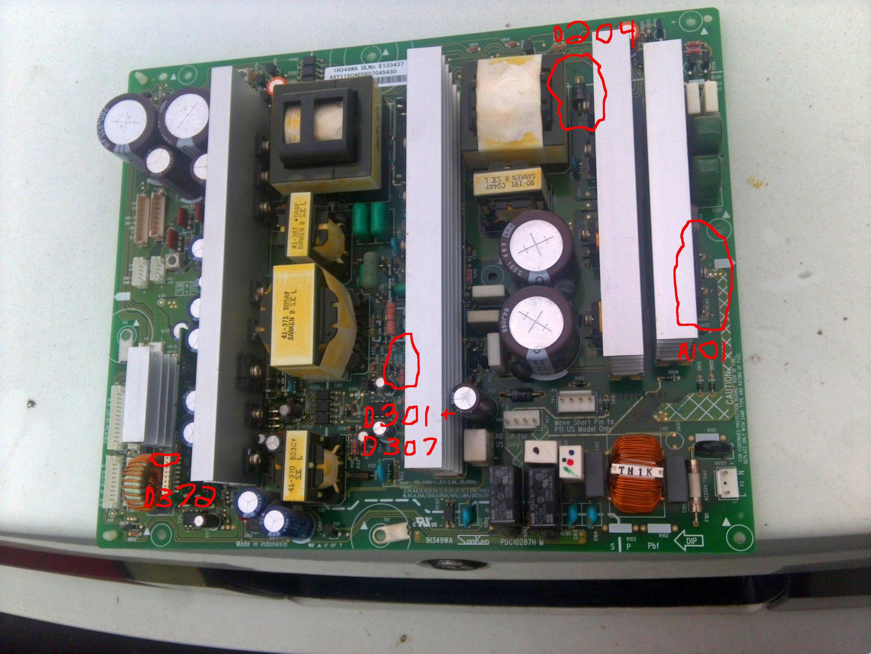

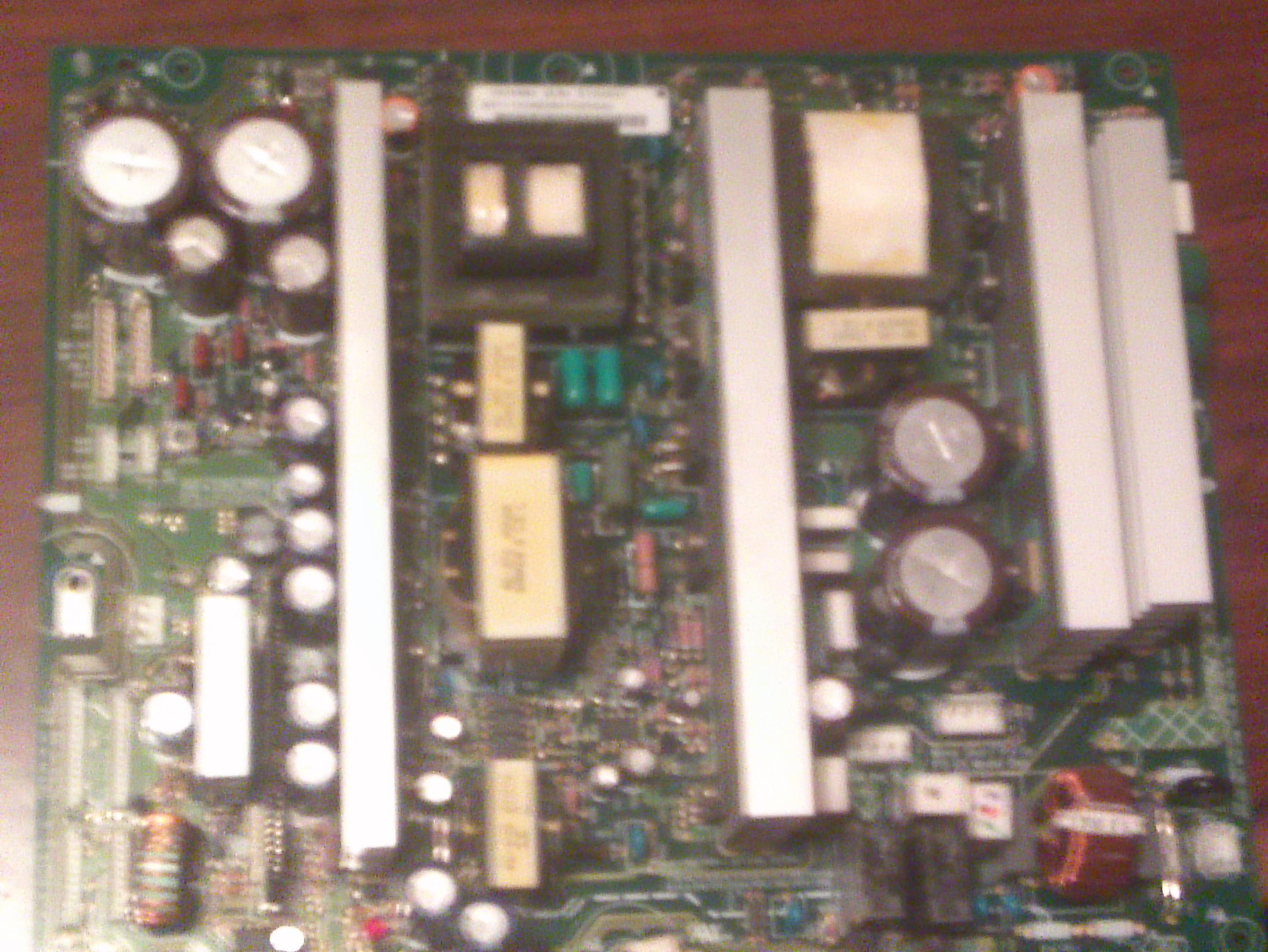

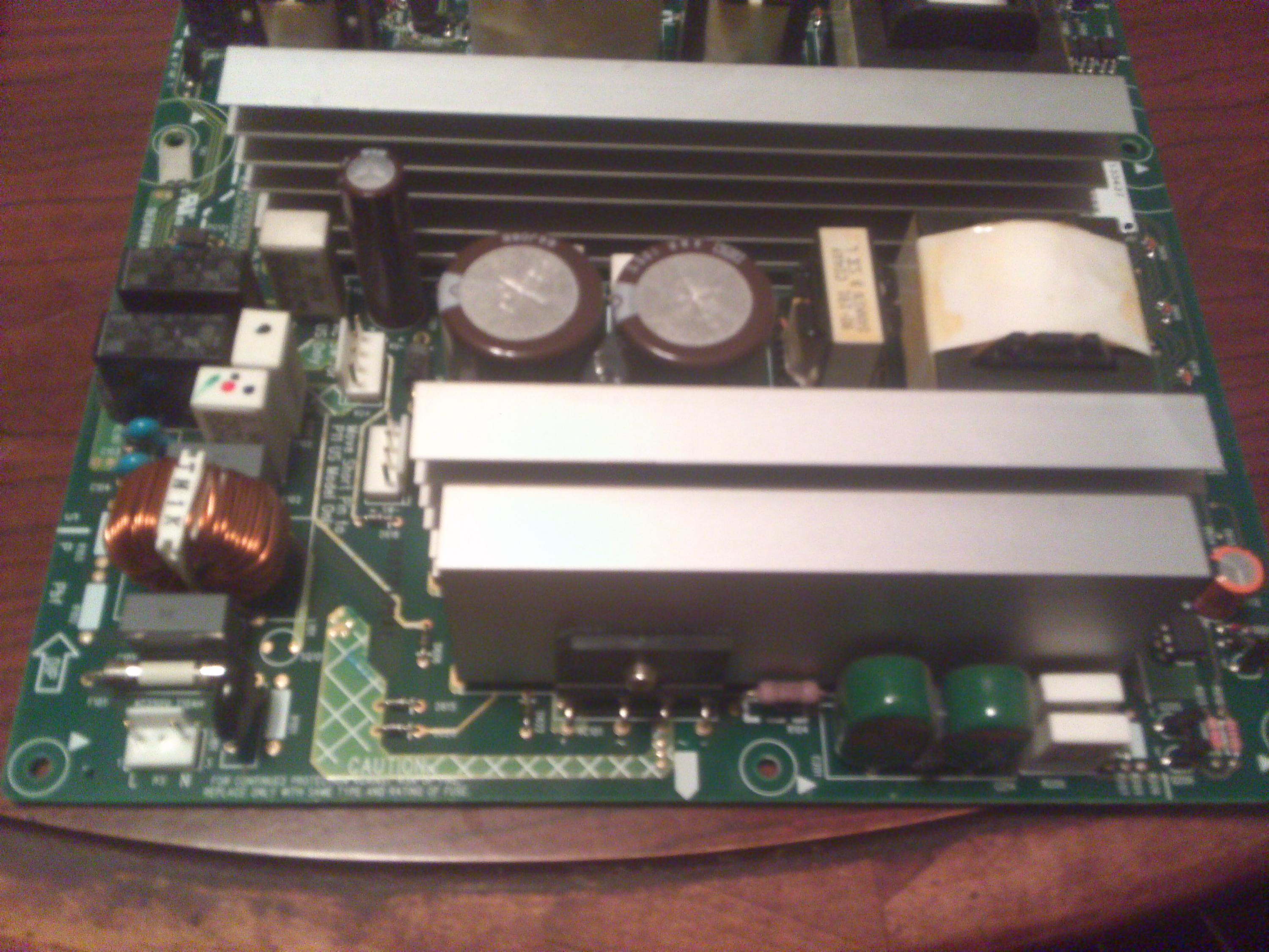

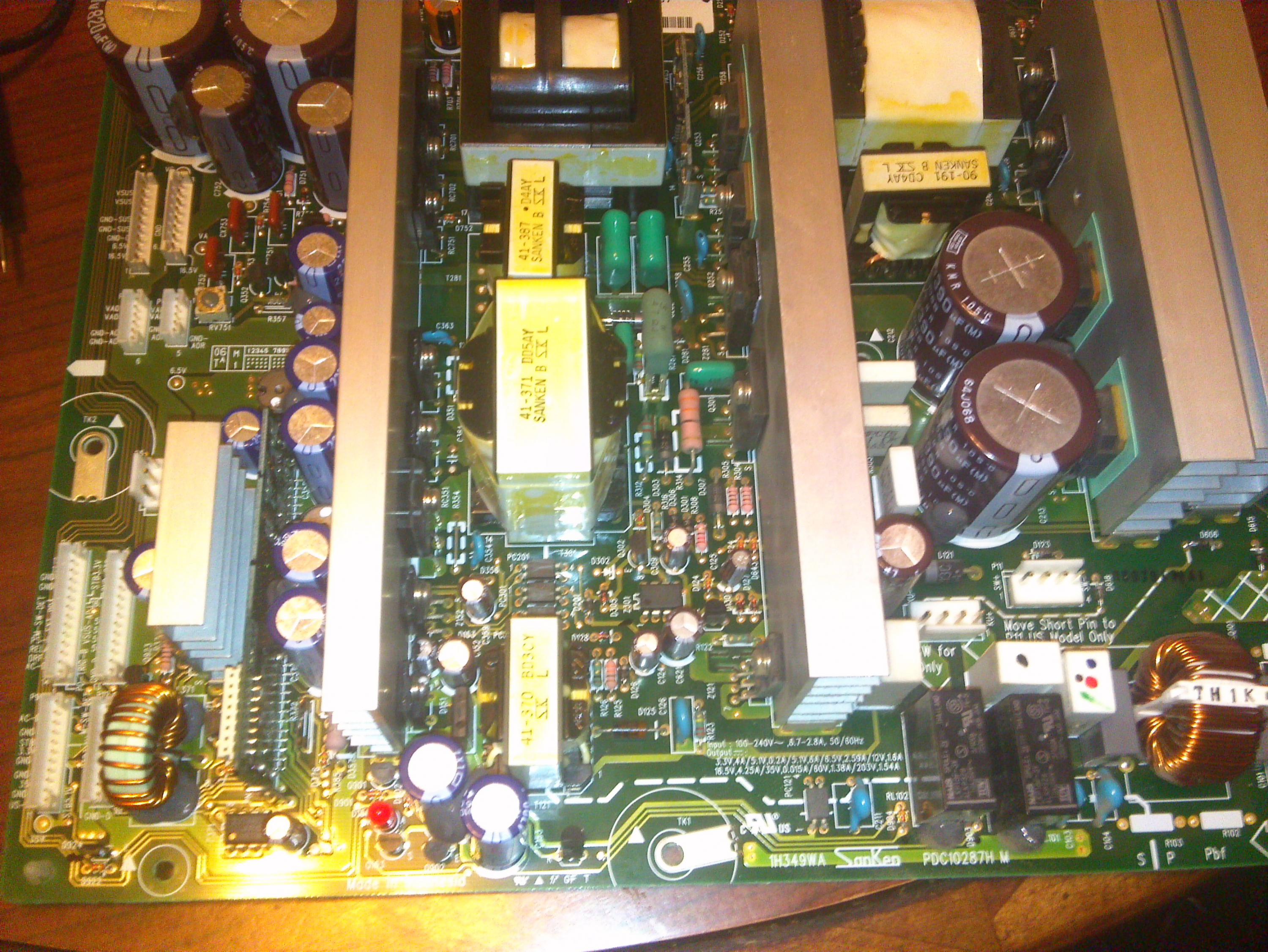

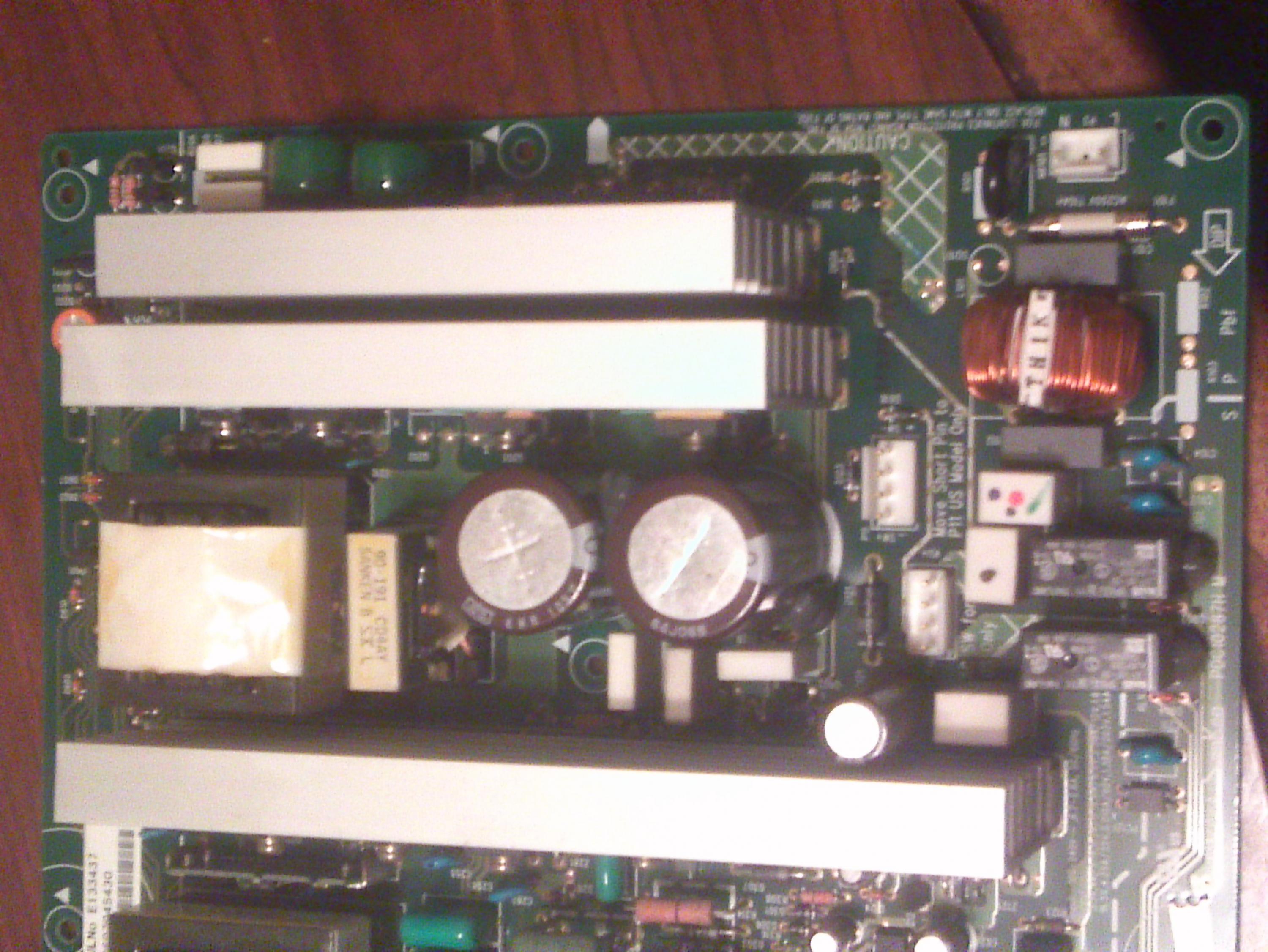

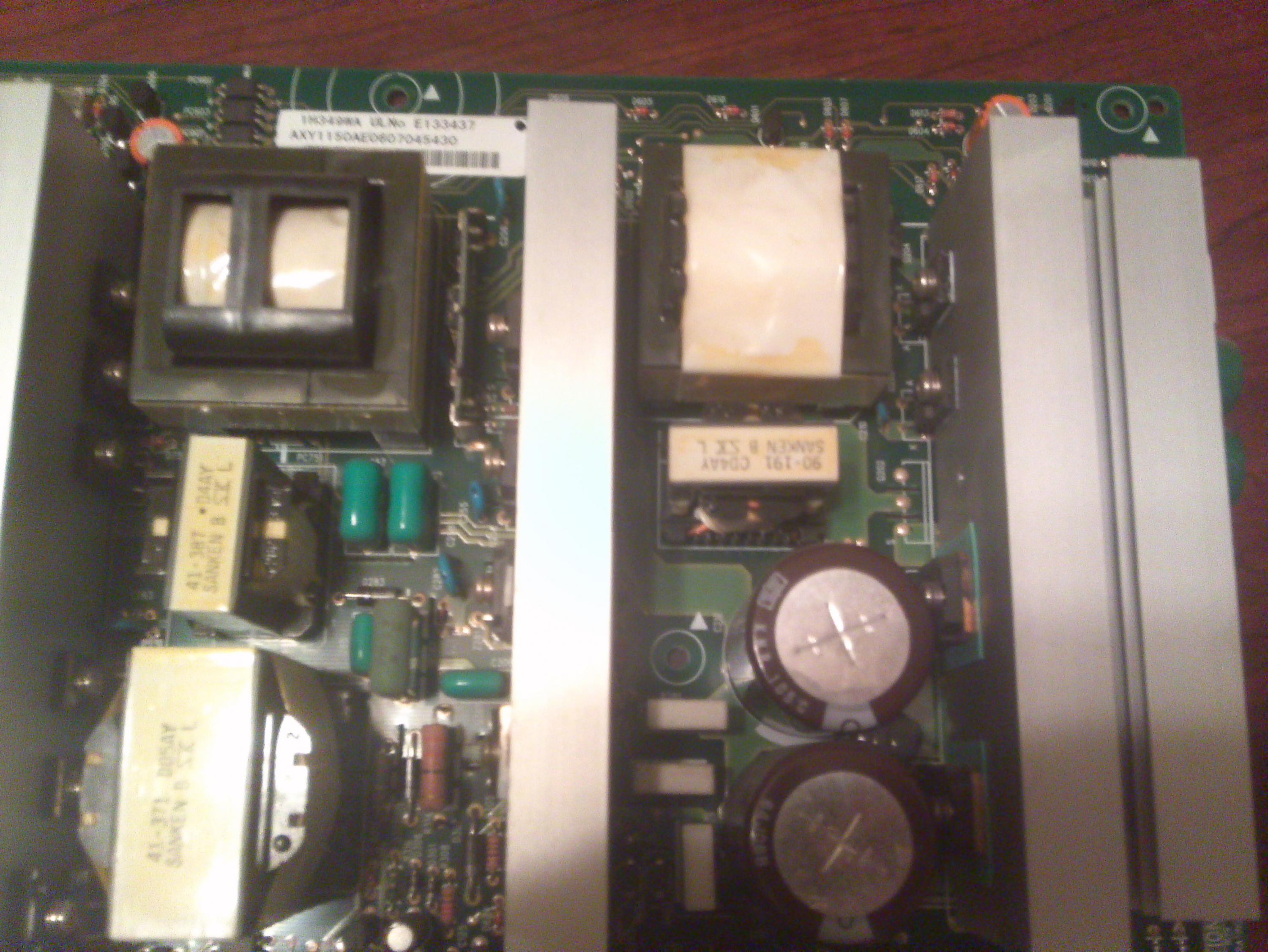

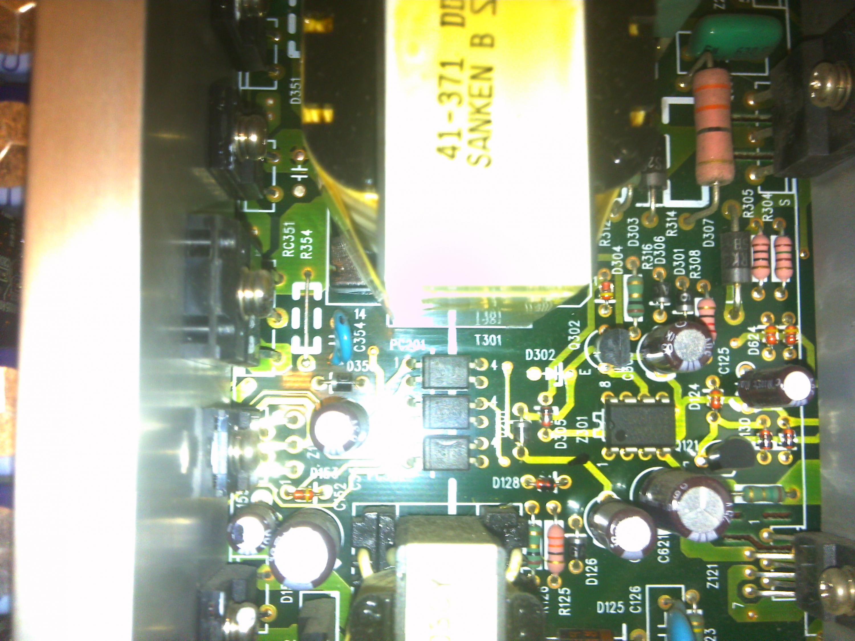

                                    in the 2nd pic rc101 is on the heatsink and in the 3rd pic d204 is to the right of the transformer partially hidden.in the last pic d372 is in front of the smaller heatsink closest to the connectors and d301 and d307 is in between the 2 longer heatsinks to the right of the transformer if that helps any
                                      Try setting camera to macro and taking the power board out in sunlight. Can you highlight the area around which you're testing?

                                          #40
                                          this any better?
