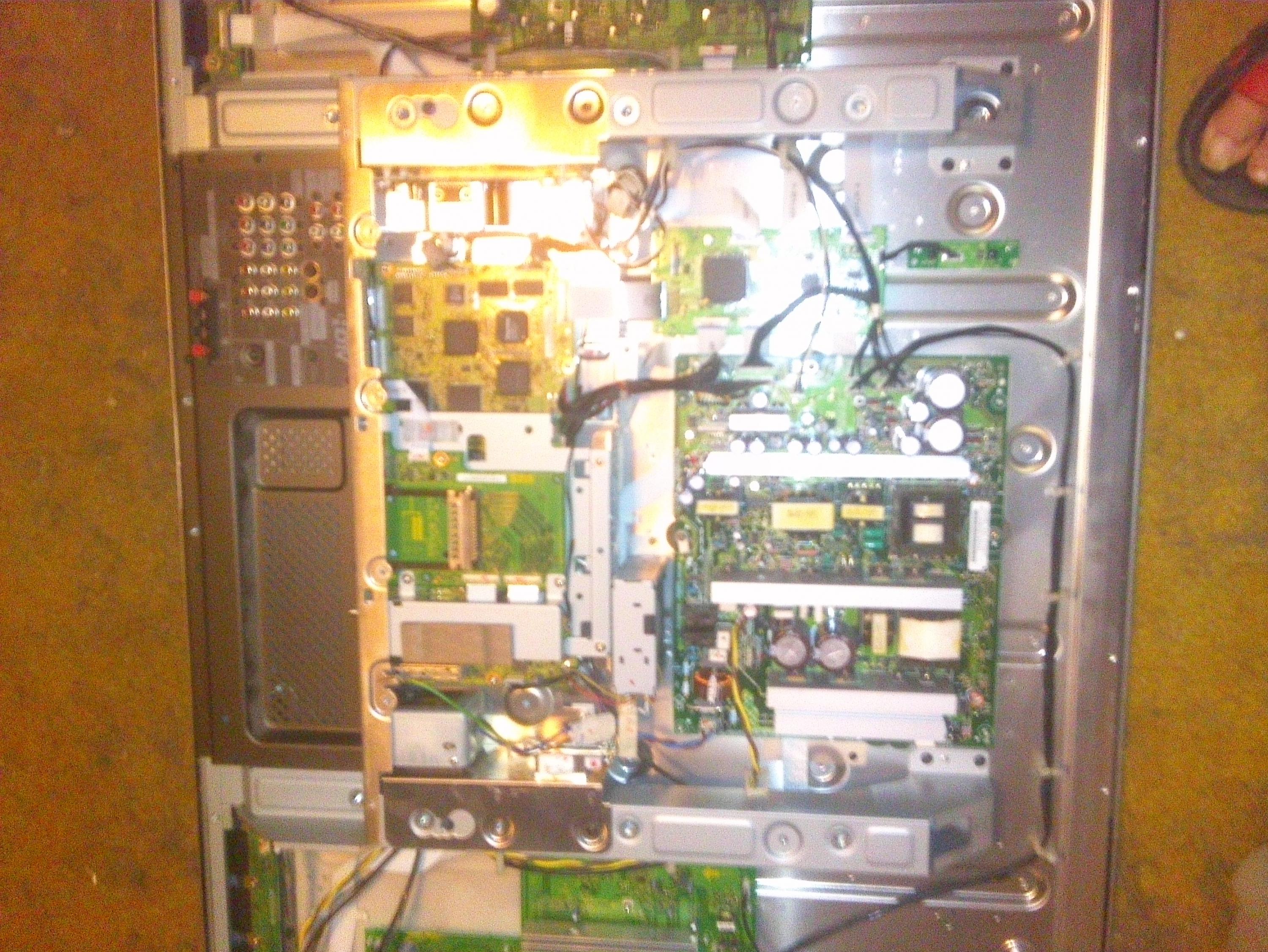

    ok when i got the tv the standby (red light) and power (blue light) were on constantly i haven't dealt with a plasma before so i'm new to them. i read that it goes into "trap mode" when the back panel is off and it is powered on which causes the "trap mode" so the person who had it or someone else had it off with it powered on before disabling the "trap" i also knew they had it off because they didn't replace all the screws and some were installed improperly but anyways. i have the remote and used it to get to "service mode" but it won't show the "initializing page" for me to complete the process. the screen lights up a little then shuts off before i can get to the "initializing page" which is about 10 seconds i tried it several times to no avail. i read that means that the main board is bad. so how can i troubleshoot the main board to find out the problem and to fix it or is it fixable? here are some pics of all the boards i will get better pics if needed. it is an older plasma made in 2006 and the model on the chassis is PDU-PC50X07 it has very little usage on it. thanks in advance for any help given!

    i checked all the voltages going to the y and x drive assembly and to the main video board and the hd digital assembly and they all read the right voltages printed on the board. when i reset the trip mode the red light on the main video board is on but it still won't power the tv on and i don't get any blinking error codes either. any help please?

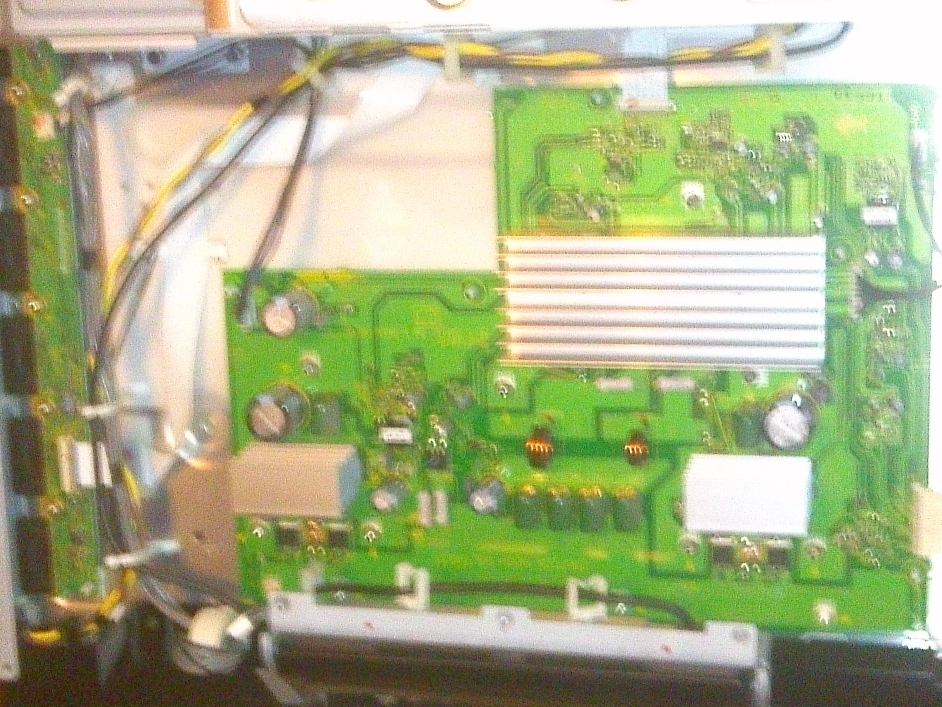

                            if i disconnected the x drive board and tried to enter service mode the blue power button went off and i got 11 blinking red lights then a pause and 11 more continued. and when i only had the y drive board disconnected i got a 3 red blink error without a blue power light.what can i do? and on the x drive board it has a connector for a + 60v and when i measure it i only get .9 volts? at all the other connection i get what the board reads any help?

                              Does power supply produce a Vd of 60V or closer to 70V? Perhaps missing Vd is triggering shut down.

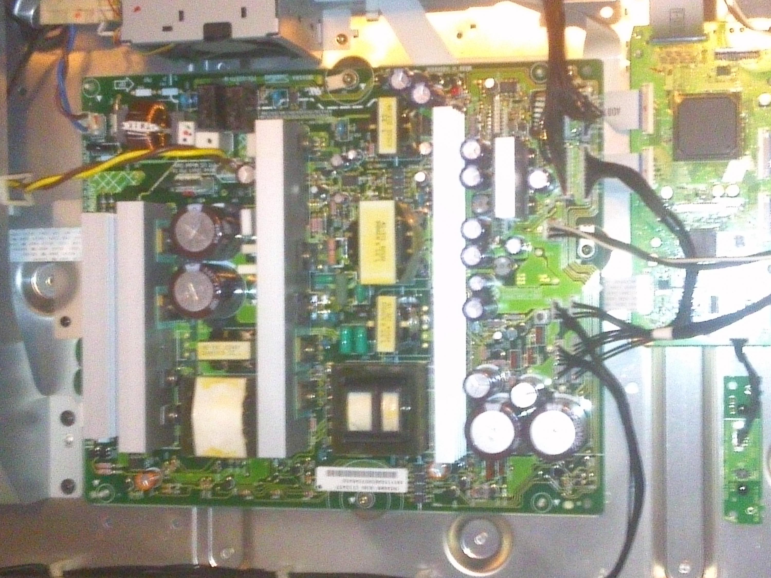

                                vd? and pin 3 from the power supply to the main board is suppose to be a N.C. (relay) that reads 3.5v but i get 0v when i checked it or is it suppose to be normally closed? i am tired been up all night trying to figure it out. i get only .9v at the power supply connector too when i am suppose to get 60v. here is the complete manual i have to figure out why i'm not getting the right voltage.

                                  i just reset it and when it tried to go into service mode i checked the voltage and it got approx. 40volts but then i kept dropping until it is now around .9volts and doesn't seem to go any lower than that.

                                    Vd may be called Vad, Vda or Va on this panel.
                                      Re: Pioneer Plasma Model# PDP-5070PU main board bad?
                                      u mean vadr? which is suppose to be 60v on the power supply? there are 2 pins that are suppose to read 60v going to the x main and 2 pins going to the y drive they all read .9 volts and were higher but were gradually dropping like noted in my previous post that was what i was checking and it was dropping but won't go any lower than around .9 volts
                                        Yes, maybe Vadr. Check Vadr on power supply, is it stable? How long does it stay? Then check Vadr on X-main.
