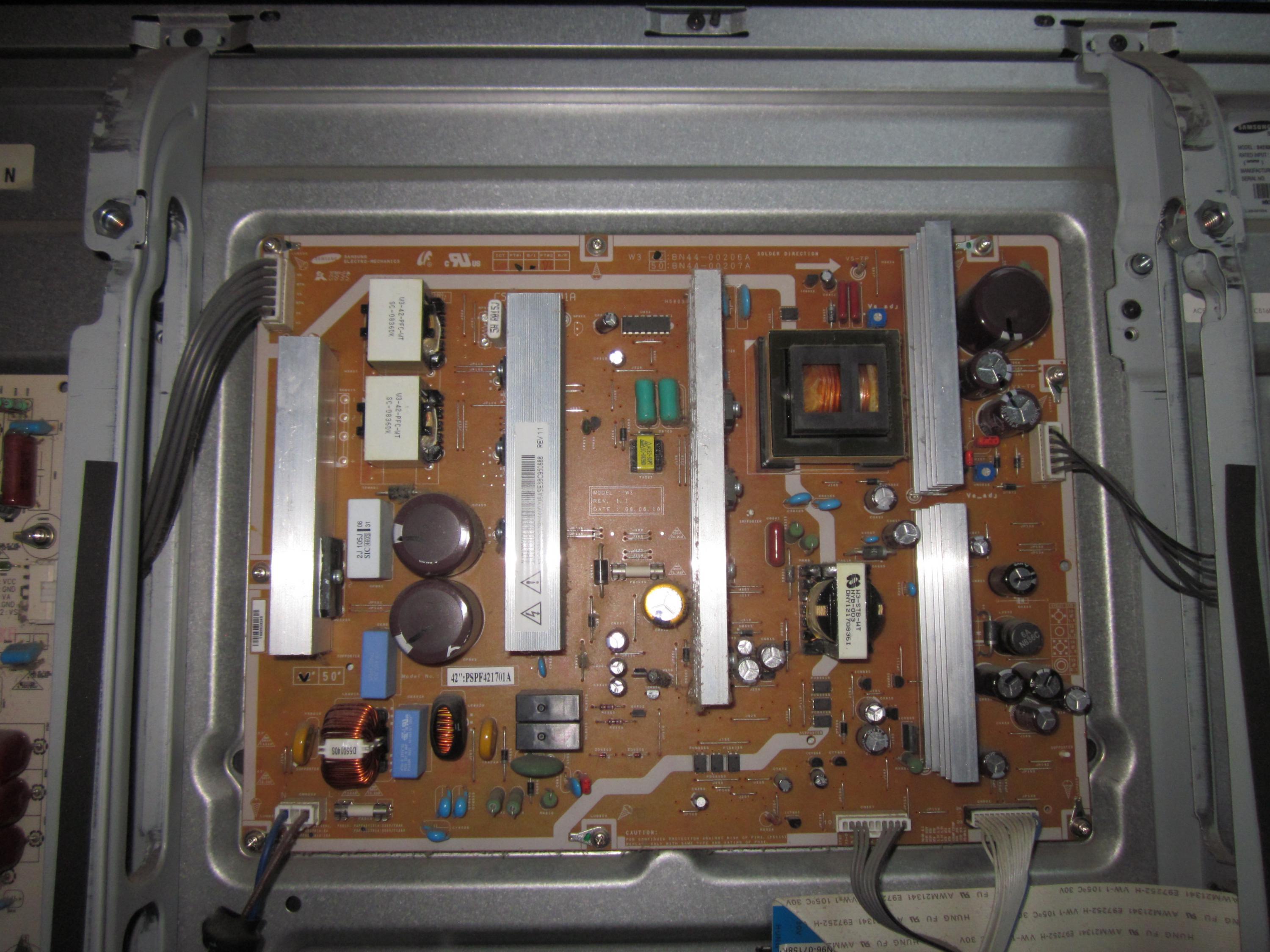

    I have a Samsung PN42A400c2d that was working fine and then one day I turned it on and the blue power indicator light blinks a few times and the stays lit with no picture whatsoever. I have gotten some conflicting advice on whether its a power board issue or a Y-main issue. Help!
  • capkid
    • Oct 2010
    • 1339
    Re: PN42A400C2D issue
    Do you have sound? If you have a multimeter, check your power supply's VS and VA voltages (labeled "VS-TP" and "VA-TP").
      No sound
            What should I test when I get the Multimeter?
              You can check the Vs, Va voltages, as well as the PS-ON and VS-ON signals. If you provide clear pictures we can show you how to do this.

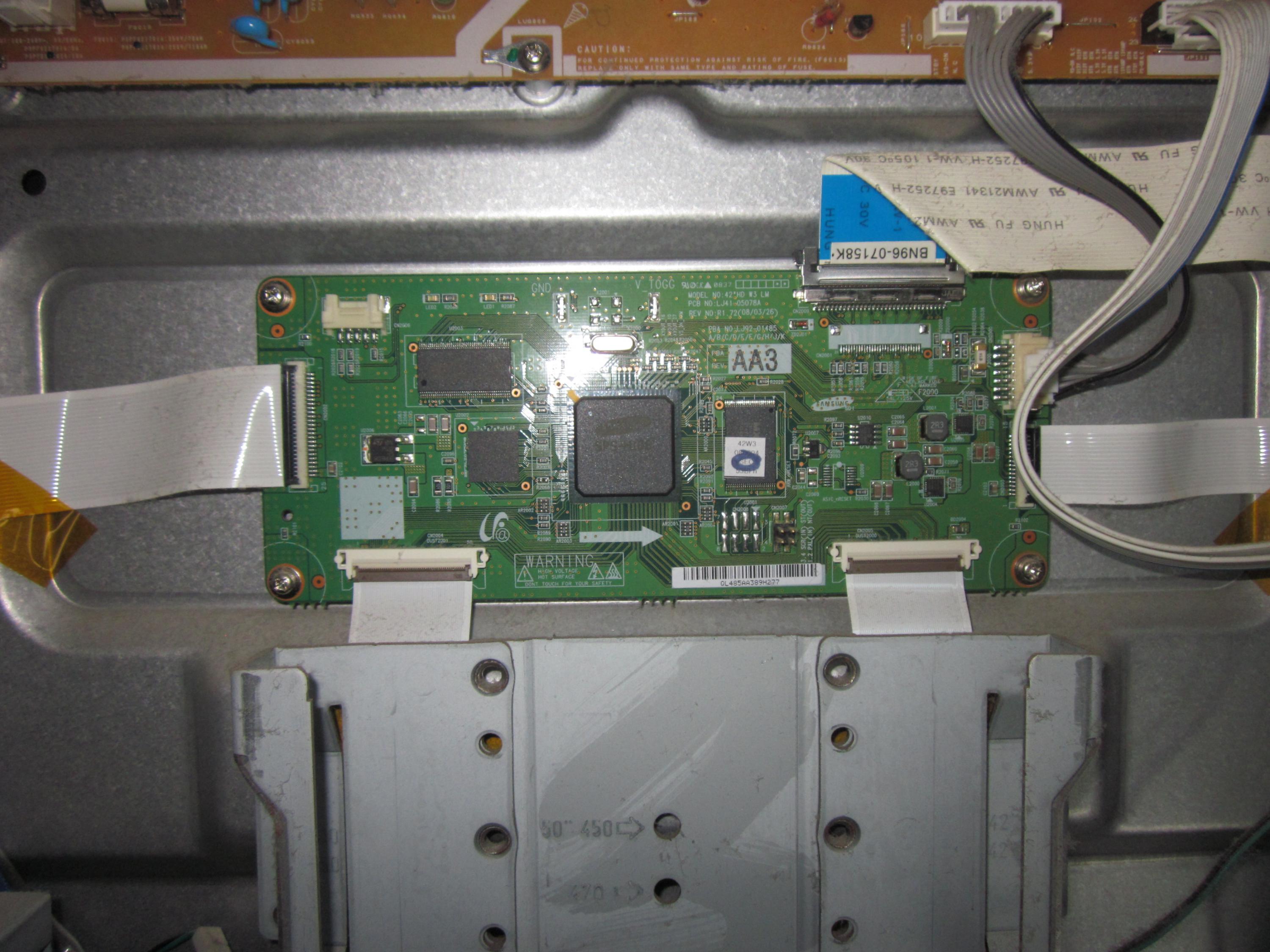

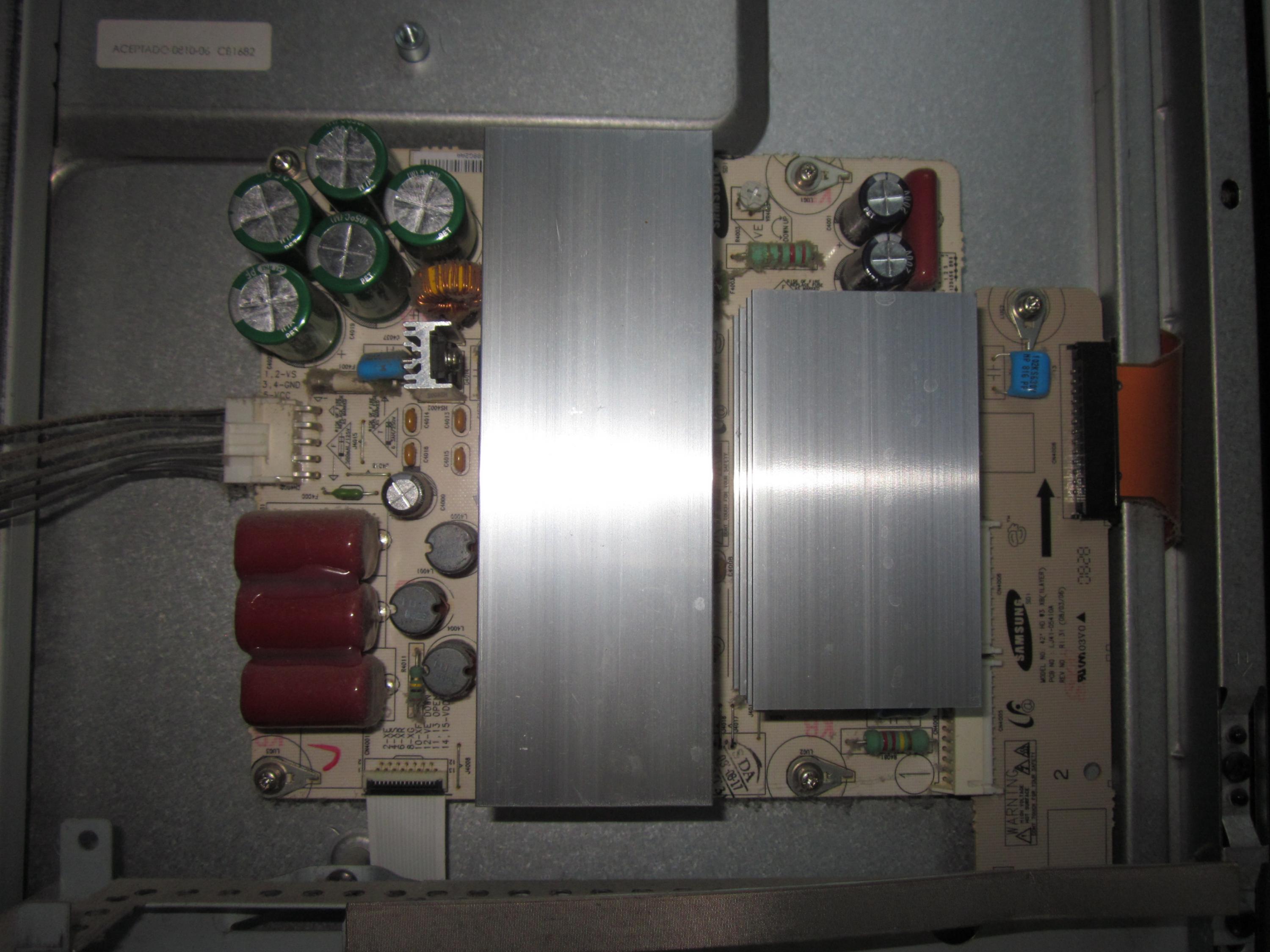

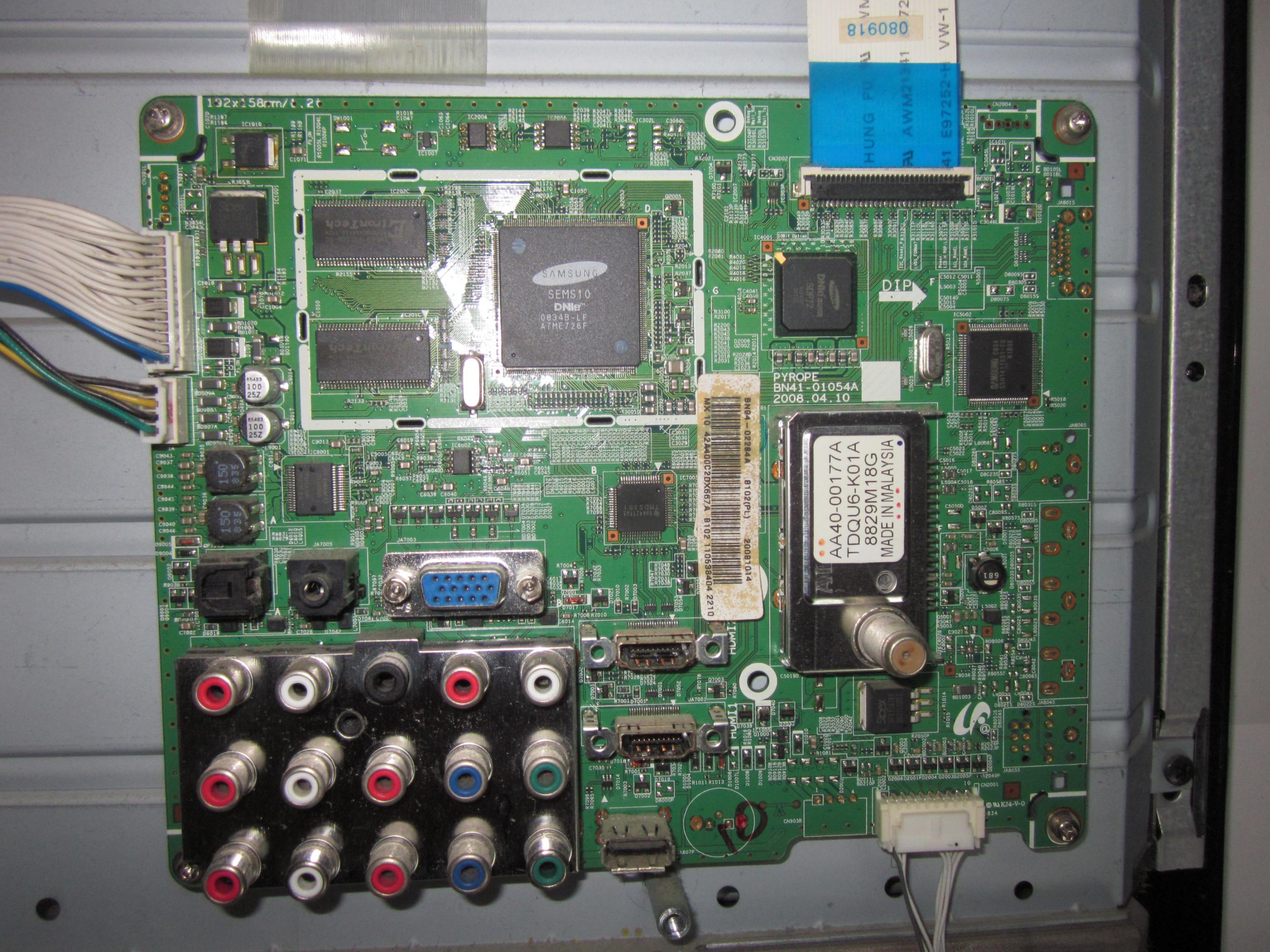

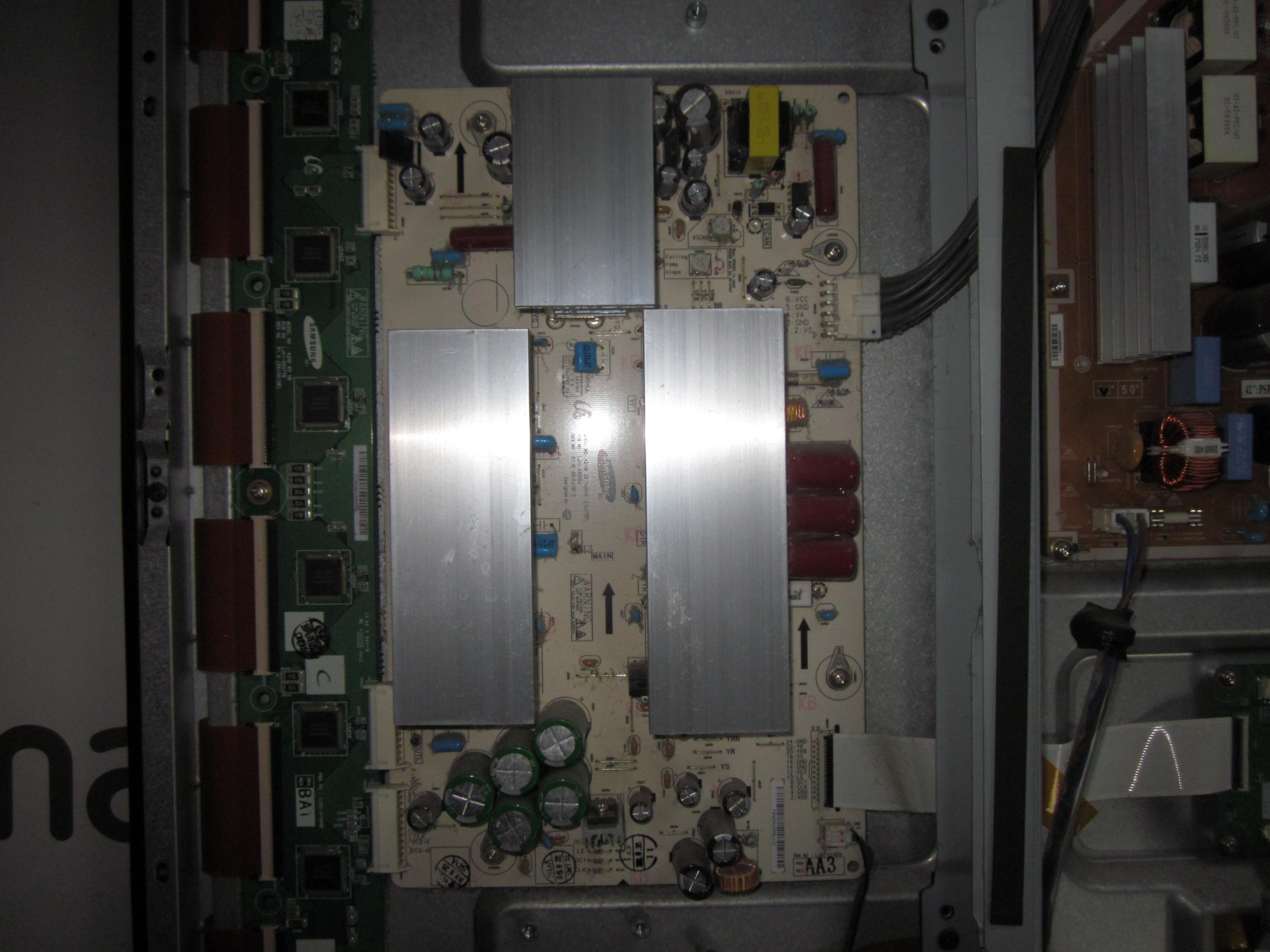

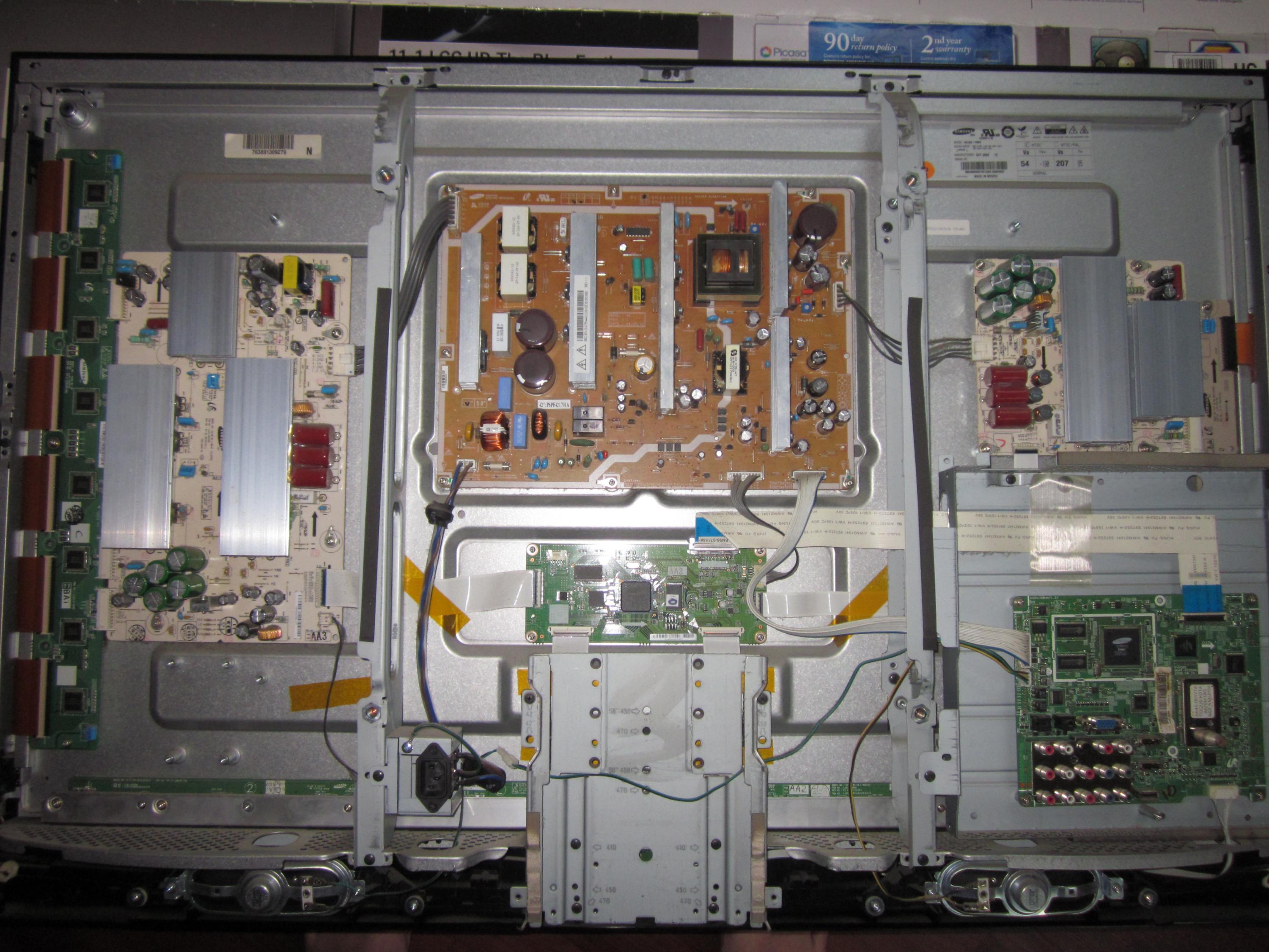

                  Do you have your meter?
                  Set it to the DC 600V or 1000V range. This is marked with "=". It is NOT the one marked "~".
                  At the top of this image
                  https://www.badcaps.net/forum/attach...1&d=1378642444
                  there is a point marked VS_TP. Your red probe goes on there.
                  The black probe touches some part of the metal frame such as the wall mount bracket.
                  Then, the TV is turned on (you can touch Vs TP after turning TV on, but do not touch any other part while it is on.)
                  You should get a Vs of 207V within 2 volts.
                  Then switch to the Va TP. You should get 54V.
                                  Ok I did that, and it still did the same thing, blue power light flashes a couple times and the stays lit with no picture...I did notice on the control board that when I turn it on led 2 flashes continuously and led 1 flashes once and the goes out.
                                  Also I noticed on the plasma troubleshooting thread about disconnecting the z board and then the y board and seeing if the sound returns. Should I try that, or do you have something else?
                                    I have sound with the Z board (the one on the right) disconnected...does that solve the problem or should I investigate more?
                                      Try with "Z" (X-main on this model) connected again. If Vs/Va are present then it shouldn't be shutting down sound too. Wait 5 minutes after power removed before reconnecting due to high voltage.
                                        No sound when it is connected
