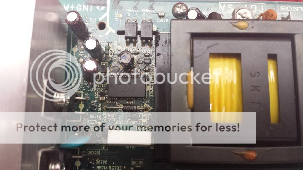

    Hello all,
    Long time, been busy with the kiddos lately,
    Well I picked up this set from a friend that said it just died when he went to turn it on. Alot of people seem to have this particular issue in this model Sony plasma. Panel is made by Pioneer. All other boards in the set are propreitary sony. Anyway, as it turns out all voltages are there upon startup except VD and VS. All I found on the internet is board replacement and the Power supply is vague on any schematics.
    So as I have it now, after much troubleshooting the SMPS, turns out that if I monitor the VS output with a DVM which hovers around 1.5vdc on startup and I heat up the very bottom area around the opto isolator, and I can only assume this IC is AC DETect, the voltage increses sligtly to 3v and then I get full 195vdc and the tv comes up perfect.
    So I replaced the opto, no avail. What can cause this issue? Im thinking on the lines of caps around the opto, or possibly the shunt regulator? Has anyone had this issue before?
    Edit: It appears that the area may not be isolated to around that optoisolator but the other opto's as well. Replaced those too, no change. I get so startup voltages in vs and VD unless I either heat the areas, or short pin 3 and 4 momentarly of the opto's. Heat made dono difference this that that area

    Ok it seems to be directly related to the shunt regulator off the optoisolator on the bottom of the power supply if I heated up the set powers up if I cool it down the set goes into fail mode. Has anyone ever seen a temperature-sensitive regulator IC
      Re: Sony KDE-50XS955 11 flashes
      I have, several times. Looks like you've found the problem...

              Found it ic6701 is a sony proprietary cxd9841m ic that seems like it feeds vs abd vd circuits. When I heat it up its on. When cold its dead.
                Well, at least you can buy it

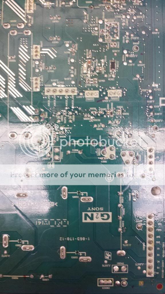

                        Hey guys. Just got done replacing that ic6701 on the power supply. I may have shorted something because I briefly had a pic then alot of mal discharge and then I unpluggedit right away. And then I checked my connections and found nothing wrong. no when turned on im getting 6 blinks red. I don't know what this code means but I can tell you that I have no vs or VD voltage is at all no fans no nothing I did find a burned out ceramic resistor 3ohm 10watt on the vd tract output. I replaced it and did some general testing on the board it did not find any problems. So now I'm trying to figure out in backtrack what I did wrong. So does anybody know what six blinks is all about?
                        by the way all my primary voltages coming off of the sub power supply board for the 380v supply input are.there.
                          r6801 is what went bad afrer ic6701 replaced

                            ic6701 is what I replaced
                              the whole board
