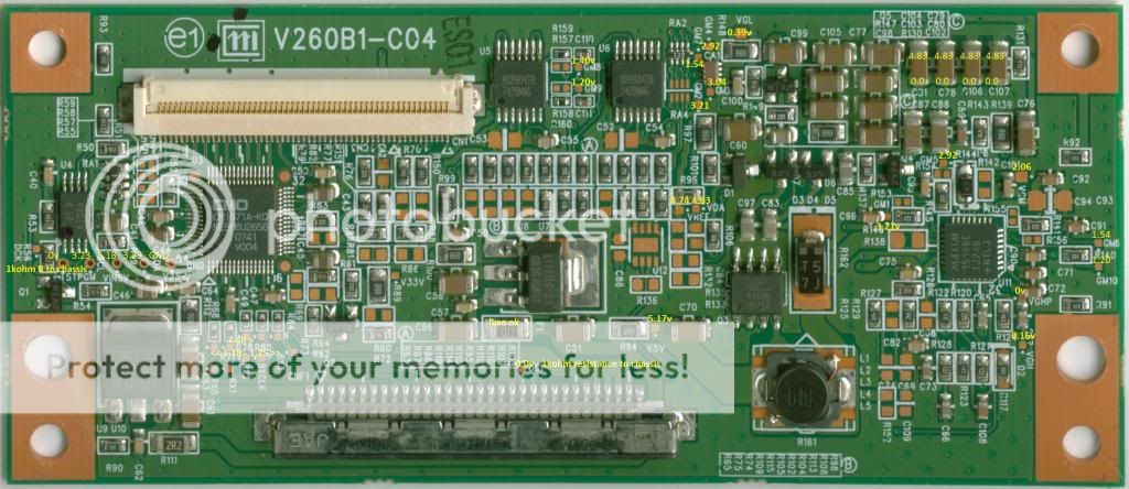

    Greetings!
    I am trying to determine the problem with a Samsung tv i got free as a needs fixing type deal. 26" 720p model LA26R71BD.
    Not usually a tv fixing person but i do have an interest in other areas of electronics so its worth a shot for the price. Here's the basics and info i can give so far on the sick patient tv:
    Tv powers on ok, sound works ok, inverter and backlight appear to be ok (I have it setup next to another tv with the same av signal - can see the backlight adjust intensity correctly to suit light/dark scenes or when changing channel etc). I can hear the source change correctly and everything else seems to be functioning apart from the panel itself on which i havn't noticed even 1 pixel move.
    Unplugging the tcon board from the main board makes no difference to the above, same results when powered on with tcon disconnected from main board.
    Voltages measured on the power supply board seem ok, although the 13v is reading 12.35 which seems a little low but possibly not low enough to be out of tolerance?(10%=1.3, 5%=0.65?)
    Capacitors on the psu appear physically ok, i dont have an lcr meter or even capacitance test on my multi to properly test them though so they are not confirmed ok, just look ok.
    There is a diode and R2K 5w power resistor in parallel (dm804, rm803) on the hot side of the board and the diode reads continuity in both directions using my cheap multimeter. Something that i thought was a bit odd, but i duno if its anything sinister at all. If other options turn up nothing then i might desolder them and test them out of circuit but for now its just a note.
    At this stage I am still unsure if the tcon is the fault at all, only started looking there after reading threads about white/ghosting screens and because it seemed a good place to start for a display related fault. However this screen has no ghosting or double vision or photo negative etc, its just plain and even white across the screen. Menus do not display nor does anything else the only noticable thing is that the backlight slightly changes intensity, so presumably the menus etc are working but not visible. The tv funtions as i would expect apart from the white screen.
    I scanned a decent high res image of the Tcon board and noted some measurements taken. If any gurus can make sense of some of this, that would be great.
    I figure even if this turns out not to be my problem and this Tcon is fine and ok and my problem is with the panel or main board or cables etc, then the image and notes may serve as a useful reference for other people as a working Tcon board and the voltages that should be expected when testing.
    I will put the original high res .PNG of the tcon board up ater too, but right now i am at a different computer.
    So anyway I am still trying to determine/isolate which parts are bad, nothing is completely ruled out and i am open to suggestions.
    Here's a pic of the Tcon board and the measured voltages at various points:

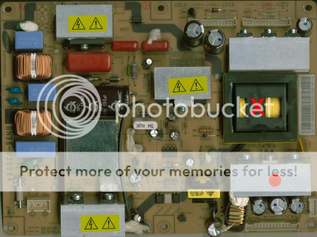

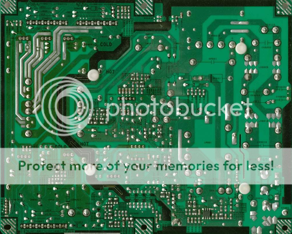

      Update:
      I believe i have found the problem! (*although i am still not certain, if anyone could help and share their thoughts, that would be great)
      A shorted transformer (TM 801s?)
      To my surprise, the rest of the functions including backlight are all seemingly able to power up and operate via the 2 smaller of the 3 transformers on the board. Presumably the smallest 1 would be the standby circuit and I guess the other doing the work for the audio and backlight etc.
      I made the mistake of assuming that because the backlight was working ok that the larger of the transformers right nearby would be driving it and all was ok, but i now think otherwise.
      I took the psu board out and scanned it and you can actually see what i think is some interesting things.
      First off, the heat caused by the transformer has made areas of the board change colour. It's not very visible with the naked eye although u can see some slight browning, but quite clear with the scan and you can see everything around and connected to the transformer cold side has clear discoloration (*note the similarly burned looking rail to IC5801S on the hot side with its legs tied).
      Also, the boards measured voltages were all within tolerance (see below) even though 1 of the transformers wasn't doing anything.
      The suspect transformer measures 0v when powered on the secondary side, when powered off there appears to be continuity across all of the secondary side. I dont like AC, so it took me a while to test but sure enough there is high voltage on the primary side and zipitty bop on the secondary.
      So following the theory that the transformer has shorted the next question has to be why did it short.
      Was it caused by its own heat over time etc? or caused by a shorted component on its output.
      The parallel diode resistor thing still seems odd too, i would expect to see the resistor value with an open diode but not continuity in both directions with no mentionable resistance.
      This is what i am still trying to work out, so that i dont go wasting time trying to replace the transformer only to have the same thing happen again when it gets plugged in.

      Here's the backside and top of the PSU board:
      also the images are currently hosted off site, my bad. I did it thinking that would be preferable but i will move them soon.
        Re: Samsung LA26R71BD - white screen with sound + tcon pic
        At this point, your power supply is working since you are getting backlighst and sound.
        The T-CON is getting the 5VDC to run it, but your pictures does not show the voltage reading at those 3-pin voltage regulators.
        What voltages do you get at those DC output connectors to the MAIN board and the inverter board?
        "A shorted transformer (TM 801s?)" the transformer will have very low DC resistance, you need to read it impedance/inductance, it appear as shorted when you try to read with the Ohm meter.
            a few more notes of other things i took and the same ones from the image in easier to read format:
            Tcon:
            VDA- 4.83 VREF- 4.74 VGL- 0.39 VGM- 2.06 VGH- 0.16 VGHP- 0
            V5V- 5.17 V33V- 3.21 V25V-2.44
            GM1,GM2- 3.21
            GM3- 3.04
            GM4,GM5- 2.92
            GM6,GM7- 1.54
            GM8- 1.40
            GM9,GM10- 1.20
            STPGM- 0.0v - 1kohm to ground
            DET- 0.0v - 1kohm to ground
            SCL- 3.23
            VIN5V- 5.18
            SDA- 3.23
            GND- ok
            DCK- 0v 1kohm to ground
              I hope i have here the measurements you were asking about, if i have made a mistake please feel free to correct me too
              The 2 3pin regs measured:
              U7-U8 (middle one):
              0-3.21-5.16
              U9-U10 (lower left):
              0-2.44-4.95
              I don't doubt you for a second and i ask this only to learn- but why do you think that the transformer measuring 0v on all its secondary side is ok?
              I tried all possible combinations of its output pins as well as chassis ground but it reads to me to be deadasadodo?
              Curious how the circuit was powering up, i poked about and concluded it was somehow being fed via the opto couplers or smaller transformer. I dunno what im talking about or what that means, but thats what i decided I guess what im asking is, where am i going wrong in my thinking with the transformer?
                "measuring 0v" What mode of the meter is set to? AC Volt? DC volt? Is it being measured at the out put windings before the rectifier or after the rectifiers?
                By the way, the Gamma ref voltages looks bad. So it looks like some thing in the switching power supply on the inverter board is not working and or bad GAMMA IC.
                • DoubleDratt88
                  • Aug 2013
                  • 51
                  Oops! thanks. doi. I was going about things all wrong and had the wrong settings/location for what i was trying to measure.
                  The centre pin of the 3 rectifier diodes each reads dc12.5, 23.6, 23.6, so you are completely correct!
                  The transformer is ok - and i thank you for making it clear where i was going wrong.
