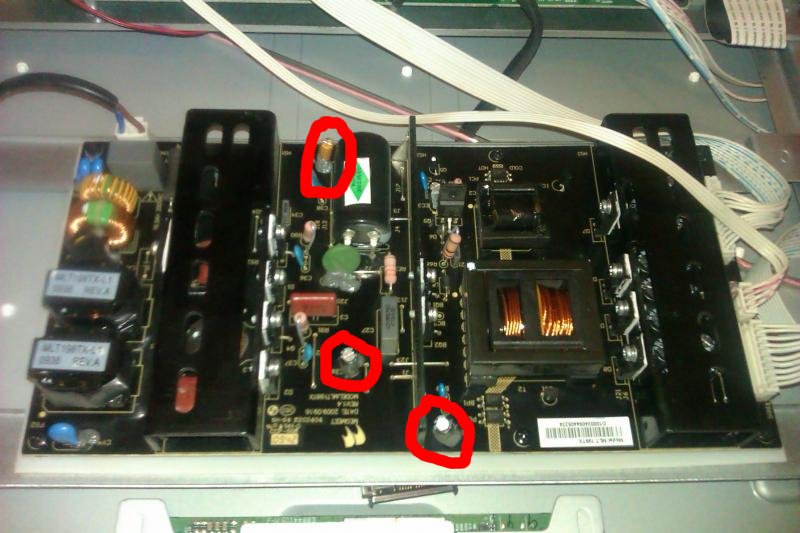

    hi all got this baird in tonight I know its a cheap set
    problem is wont start up it flickers the light like a strobe and makes a clicking on the psu any thoughts wil get pics of psu asap
    included a pic of mains and a video of what its doing
    video here http://s2.photobucket.com/user/wreks...O0002.mp4.html
    pics of psu

    can you check the output voltages of the psu in another thread on a baird 42 inch it was a faulty invertor so if voltages are low maybe try to unplug the 24 volt invertor plug on psu ans see if volages are ok now.

        Re: baird 42 flickering strobing wont start up
        Do you have a DMM?
        Measure voltages on the connector pins and note them here, remembering to number them and note the connector label.
        Looks like the PS board connectors to the right of photo are from top to bottom
        Main board
        Audio (possibly) 4-pin (2 gnd and 2 might be 12,24 or 33v)
        Inverter 10-pin (most likely 5 are gnd and 5 are 24v)
        Refer to this thread for another Baird 42" (as suggested above):
        https://www.badcaps.net/forum/showth...light=baird+42
          Also check voltage across the large 450V cap.

            tom what should that 450 cap be
              Depends, what does it read? Around 380 to 400V steady I'd expect.

                    mae my meter showing nothing can you explain in leymans terms what my my meter should be on please to test
                    this is my meter basic I know
                    http://www.petervis.com/electronics%...%20M-830B.html
                      600V DC; from the off position, one click to the left.
                      Red probe in volt/ohm jack, black probe in COM.
                      Then touch red probe on one end of cap, black on other.
                      BE CAREFUL not to short the probes!!

                        tom I done as you said I get a 329 rising to 350 upon strobing and bk to 329 when not lighting leds if you get what I mean this is with all cables attached and powered
                          Yeah, there's your problem. Low PFC voltage.
                          If you do not know how to repair a PSU I would advise a straight swap.
                          Before you swap it, I would try replacing these caps.

                            Try the same with inverter connector disconnected.
                            Wrecksta, video link not working
                            Tom, could an inverter fault be shutting down the tv before the main cap charges to full voltage?

                              tom not questioning you but can I ask why to replace the four smaller type capicitors rather than the large cap please explain mate
                                Questions are good!
                                Because the smaller caps provide the Vcc supply for the controller chips; when they go bad, this symptom is common though it does not always occur.
                                When the big cap goes bad, it usually causes the voltage to rise to the correct level but the screen still flickers; OR, much more commonly, it causes the PFC circuit to fail & blow the mains fuse in a rather spectacular manner.

                                  inverter in or out made no difference mate
                                  okies tom so replacing them could fix the problem or help determine the true nature of the fault
                                  so replace the
                                  2x 100uf 35v 105c
                                  1x 10uf 50v 105 c this is the orange one nrear the big cap
                                  there is also another 100 uf 35v 105 c to the right of the big cap over the heatsink above the mosfet
                                    I'd replace those three and that smaller one too, then; I couldn't see that other one.
                                      okies will do that now if I have em
                                      only uf's I have are all from a sky box they all right spec though will these do as going to sacrifice the box lol
                                        No, I would never re-use capacitors from an old product. Main issue is voltage forming -- the old capacitor can get used to being used at a certain voltage for a long time and may fail if an increased voltage is applied.
                                        List the values you need and suitable replacements can be sourced. Also do not order crap caps, Panasonic FM/FR/FC are suitable, others may not be suitable.
