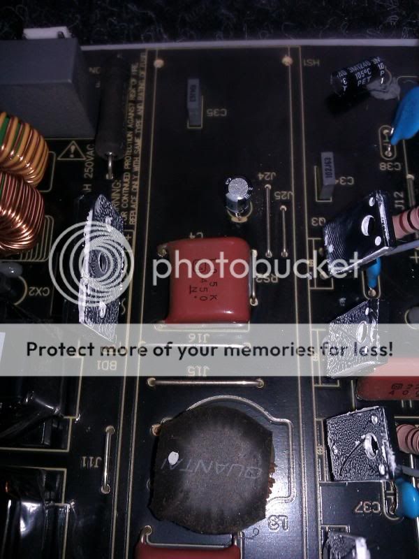

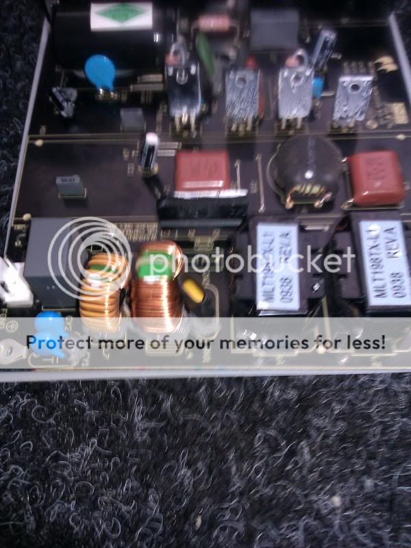

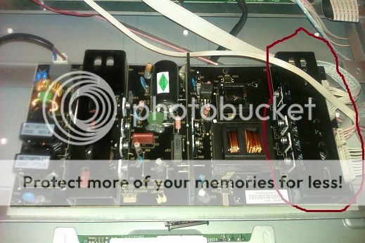

        Re: baird 42 flickering strobing wont start up
        ill post up a picture mate theres a load of caps under one of the heatsinks on the psu
        could it be the ic mate just a thought anything else to check the clicking surging noise has stopped just standbylight flashes fast constantly
          Try putting the original caps back in to see if the first symptoms come back.

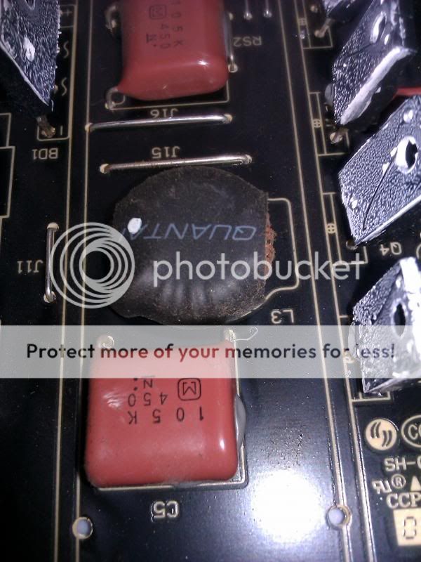

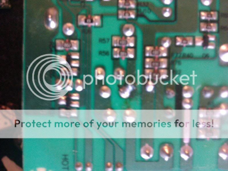

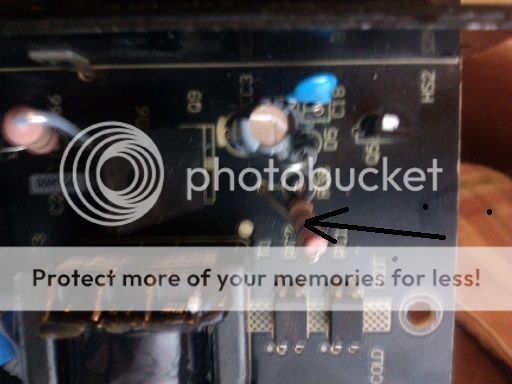

            mate im posting pics up would a knacked resistor cause it I flunked up pics on way
            I broke this bugger
            also my soldering fine can you look at this join for me in centre
            im hoping that resistor is the cause
            also loads of caps under here
              Yeah, that would also cause that problem.
                can you help me with which one it is please
                can get you details of coloured rings
                  What are the colours printed on it? I can't read them
                  Then, use: http://www.csgnetwork.com/resistcolcalc.html 3-band or http://www.electronics2000.co.uk/cal...calculator.php 4/5-band.
                    tom its hard to make out but its only 4 bands red blue sliver and silver or gold n gold
                    what can I use
                    I used calc if silver I can use 0.26 ohms 10%
                    if gold 2.6 ohms 5%
                    what else could I use if ilooked about house as don't think I have those
                      #30
                      You would need to source an exact replacement;
                      I do not know which value you can use if the colour code cannot be read.

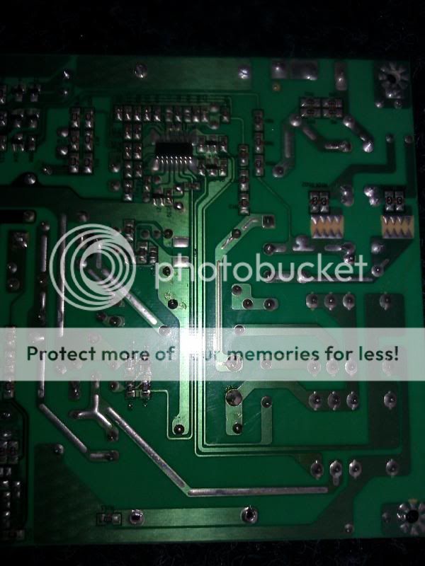

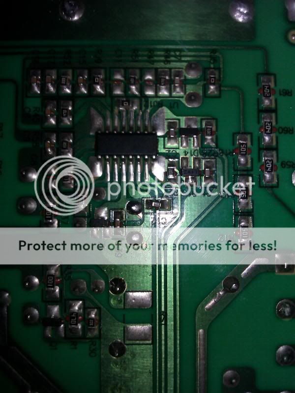

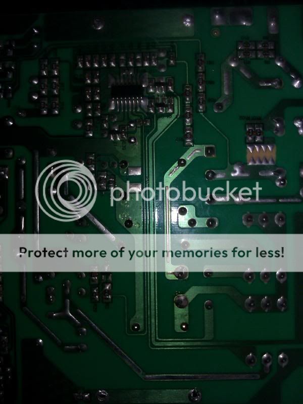

                                  well heres the pics anything else you want me to test
                                  cap has been replaced with new one same value
                                  have not tested yet as don't want to resolder the heatsink on till the other components mosfets etc tested
                                  would it be worth testing the fuse mate
                                    #37
                                    You wouldn't have anything (power light, etc) with blown fuse.
                                    If you post a picture under that cap then a few things can be checked.

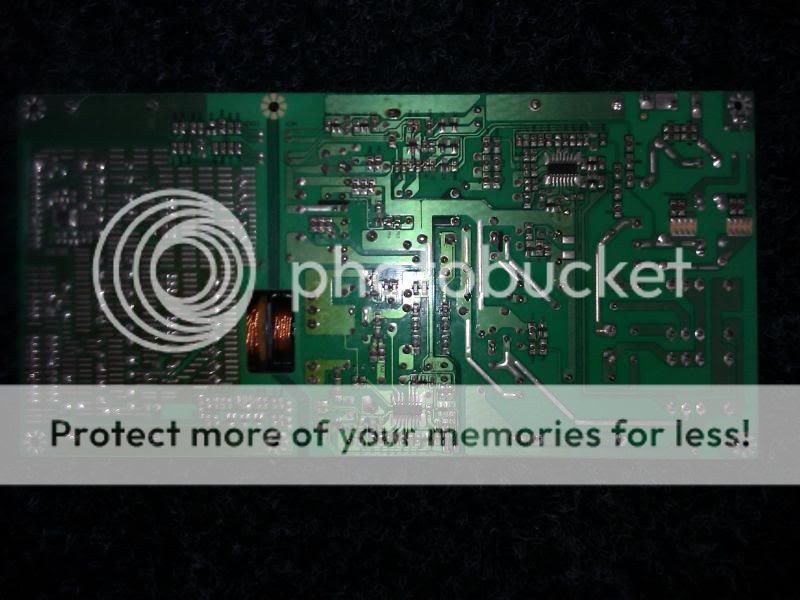

                                      ok thanks mate so the mosfets are fine also ?
                                      pics below as requested
                                        #39
                                        Part number on the 14 pin chip near that cap?
                                        • wreksta
                                          • Aug 2013
                                          • 508
                                          • england
                                          #40
                                          I think its 16 pin mate and its 98axh6m under that ucc28060 g4
