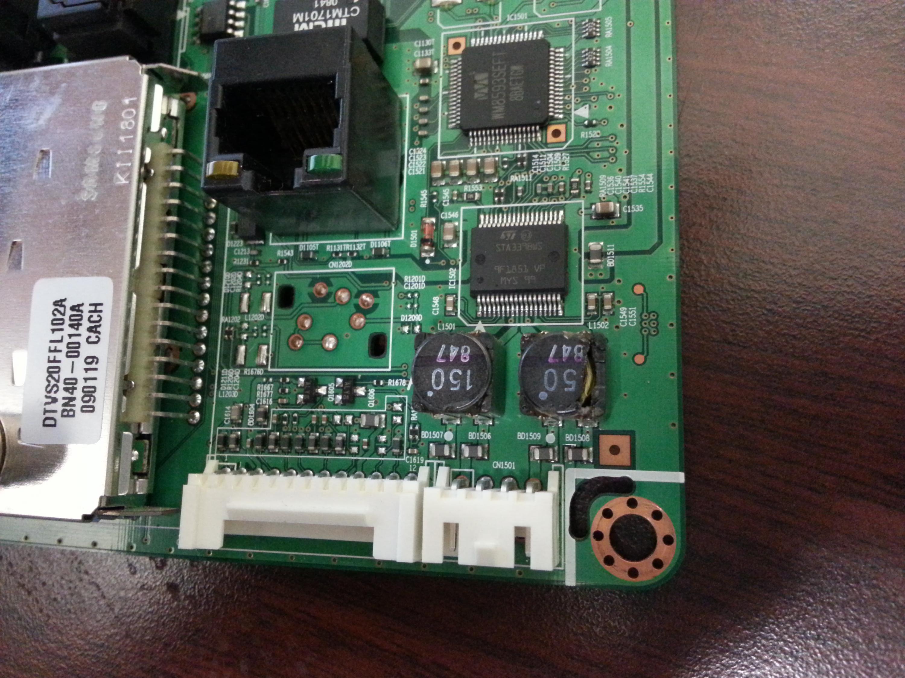

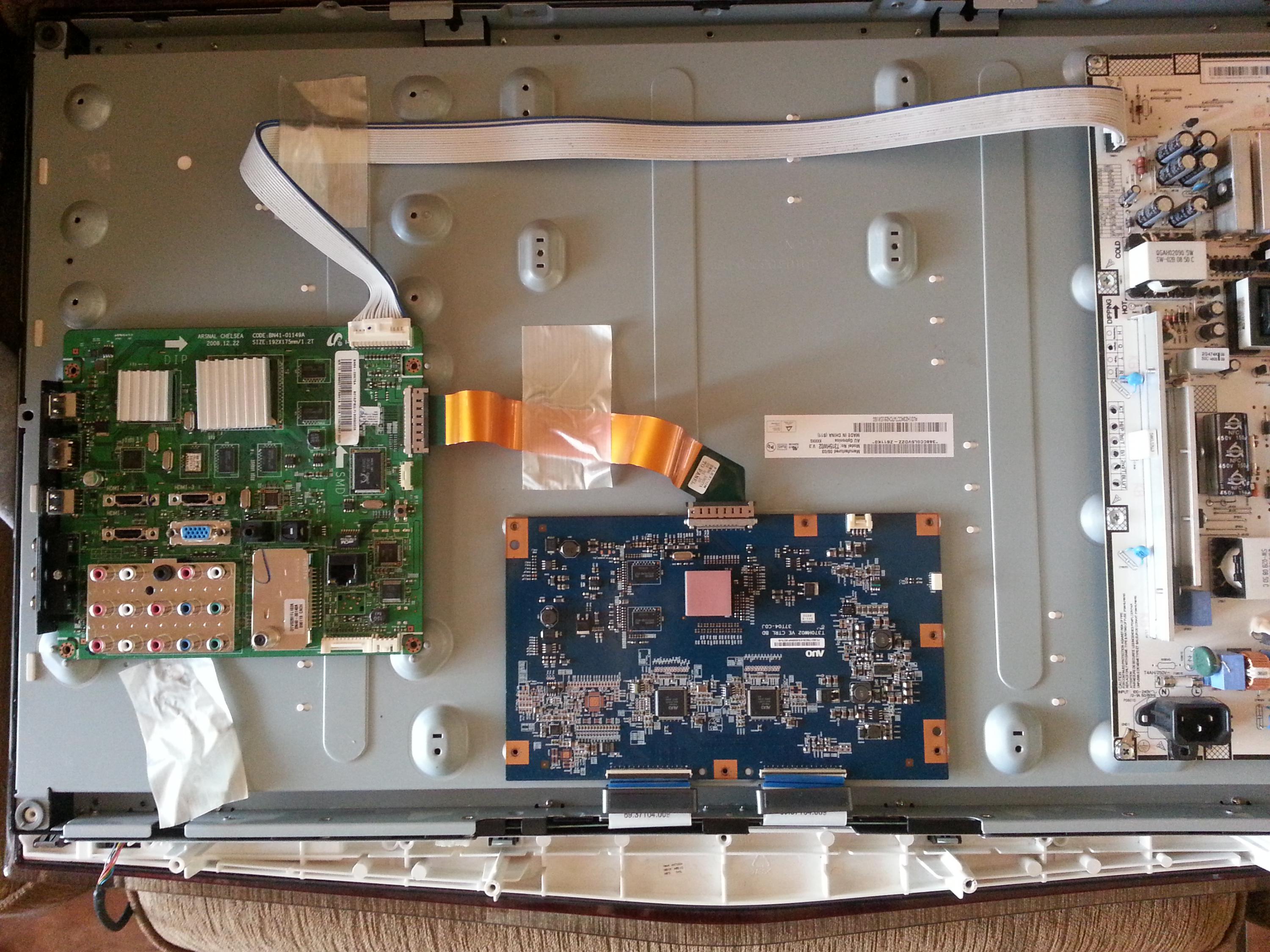

    Hello, have a few questions. I have the follwing tv and it does not power on. the power on led on the front flashes but not in a patern. i did a quick diagnostics I opened up back cover to inspect caps on power module and they all look good. when I disconect white ribbon cable to main board the backlight on the set turns on. I pluged it back in backlight goes off. i went further and and disconected ribbon cable going to the t-con board. backlight goes back on and now I have the sound (Samsung Chime) from power up, still have front power led flashing on and off ramdomly and no picture. question is where do i start trouble shooting or whats the most common isue with this set. I also would like to find a service manual for it.. any one help me out... Thanks..
    quick note. as i was doing a visual inspection i found I had one of the inductors (L1501) casing broken. I followed the trace and it goes to audio out speakers. dont think this could be the cause but i would like to replace it any one familiar it i would like a part number..
    Sal

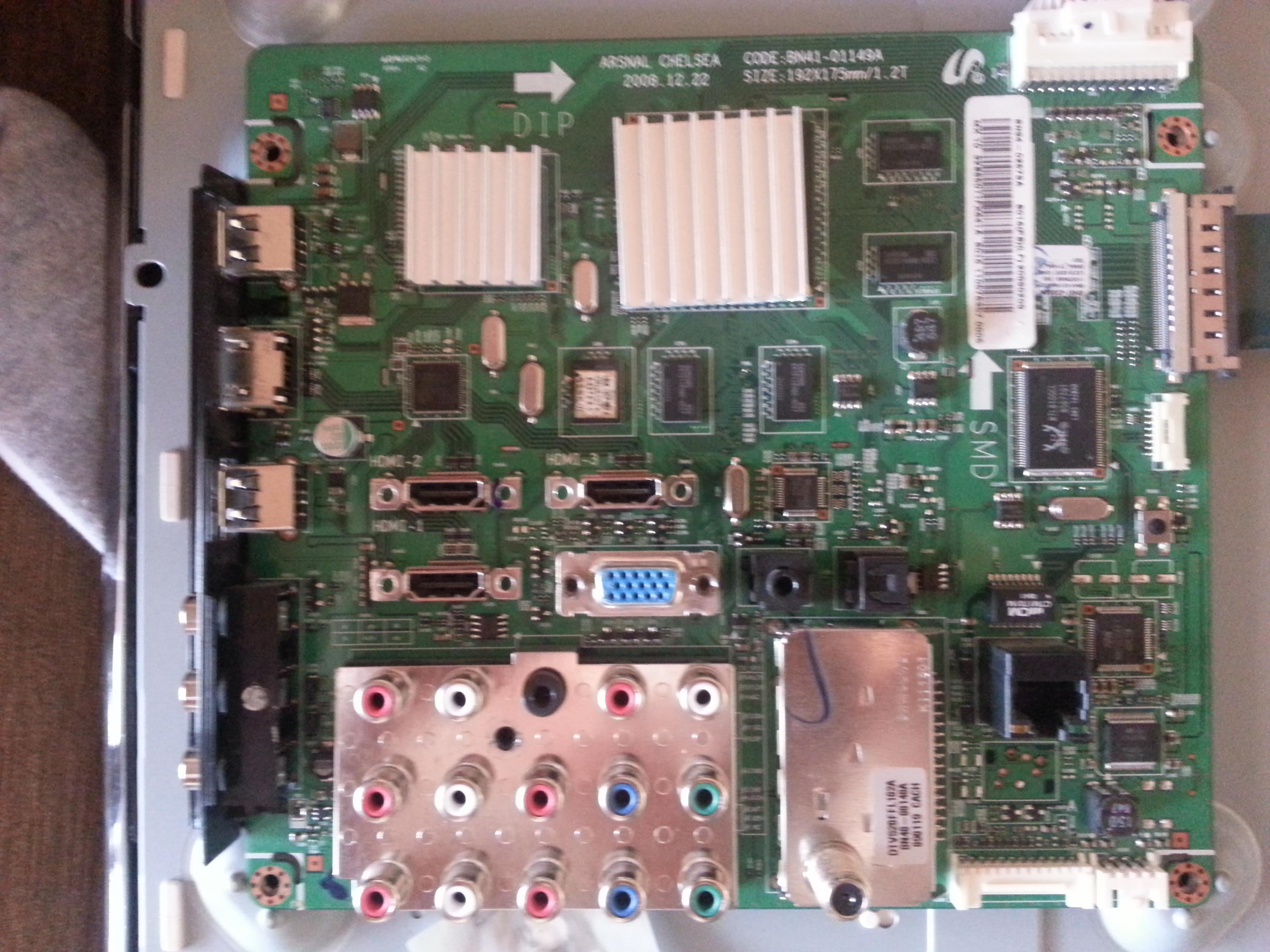

    Re: Samsung LN32B650T1FXZA does not power on
    Can you post pics of the board layout? Off hand, it sounds like a bad t-con or main board (main board seems more likely). Check your t-con fuse.
      ok here you go, I included a picture to show the inductor thats damaged. where is the fuse to the tcon board?

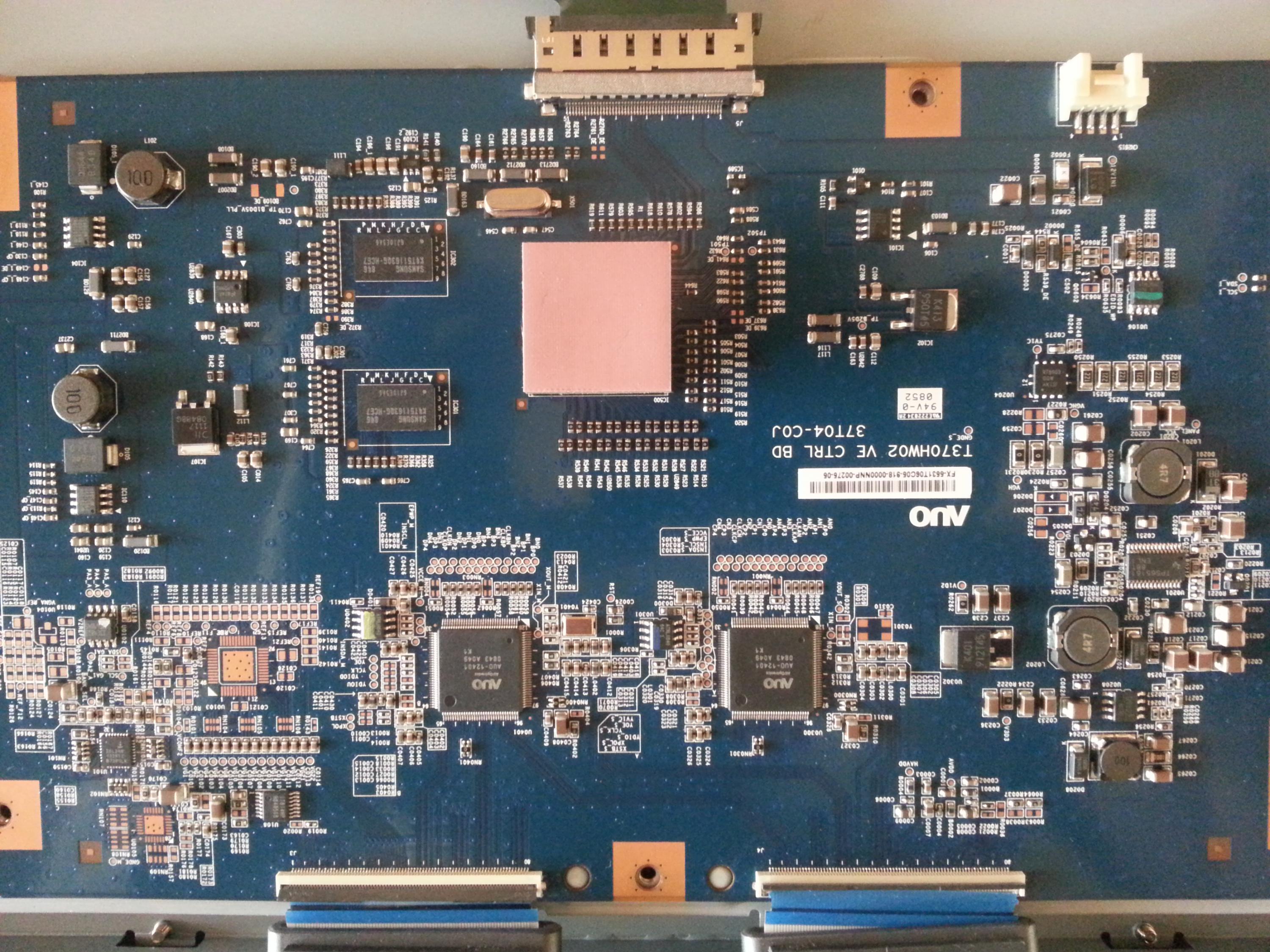

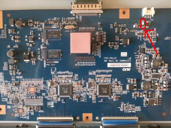

        Here's the fuse.
        That inductor doesn't look good. I may have misunderstood your problem statement and tests. Did you try connecting the main board to the power supply and disconnecting the t-con from the main board when you got the chime and a backlight?
          yes sure did..
          PS + Main Board + tcon = no picture no sound
          PS + Main Board = backlight plus startup sound
            Does your t-con fuse check out?

              • usa
              yes fuse is good, any test points that I could check? also any idea on manufacture of inductor, its 15uh but thats all that i know. i would love to get get part list and order that inductor. if anyone has a schematic that will help me alot
                  I've had shorted t-cons on these stop the TV from powering up. However, it's a good idea to isolate the panel as well, in case a short on the panel is causing the problem.
