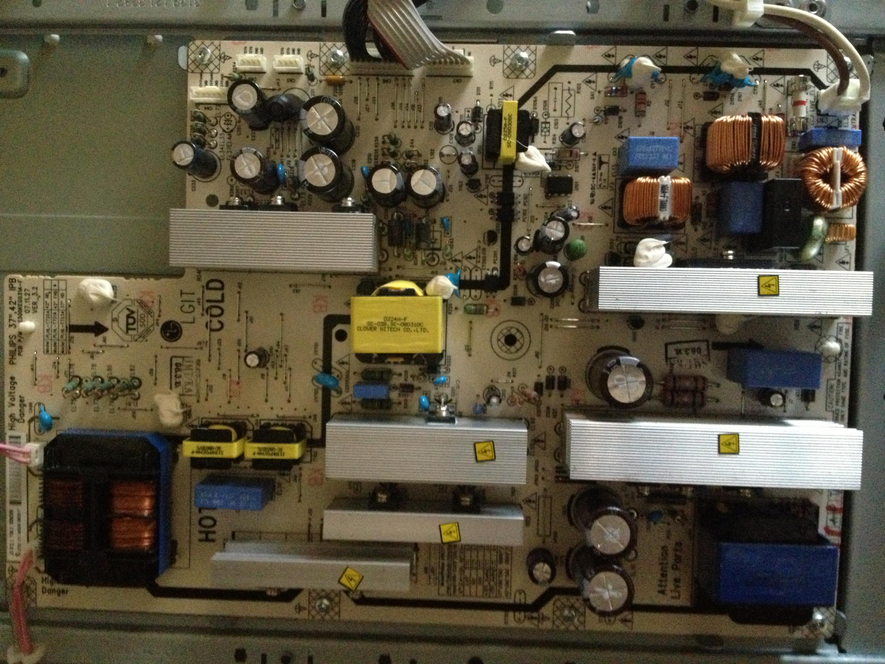

    I replaced all 22 cylinder shaped capacitors (although none showed obvious signs of failure) on the power supply board, but the problem remains. It actually seems to shut off or lose picture faster than before. When the picture disappeared but I still had sound, I was able to see the menu items when I held a flashlight up to the screen.

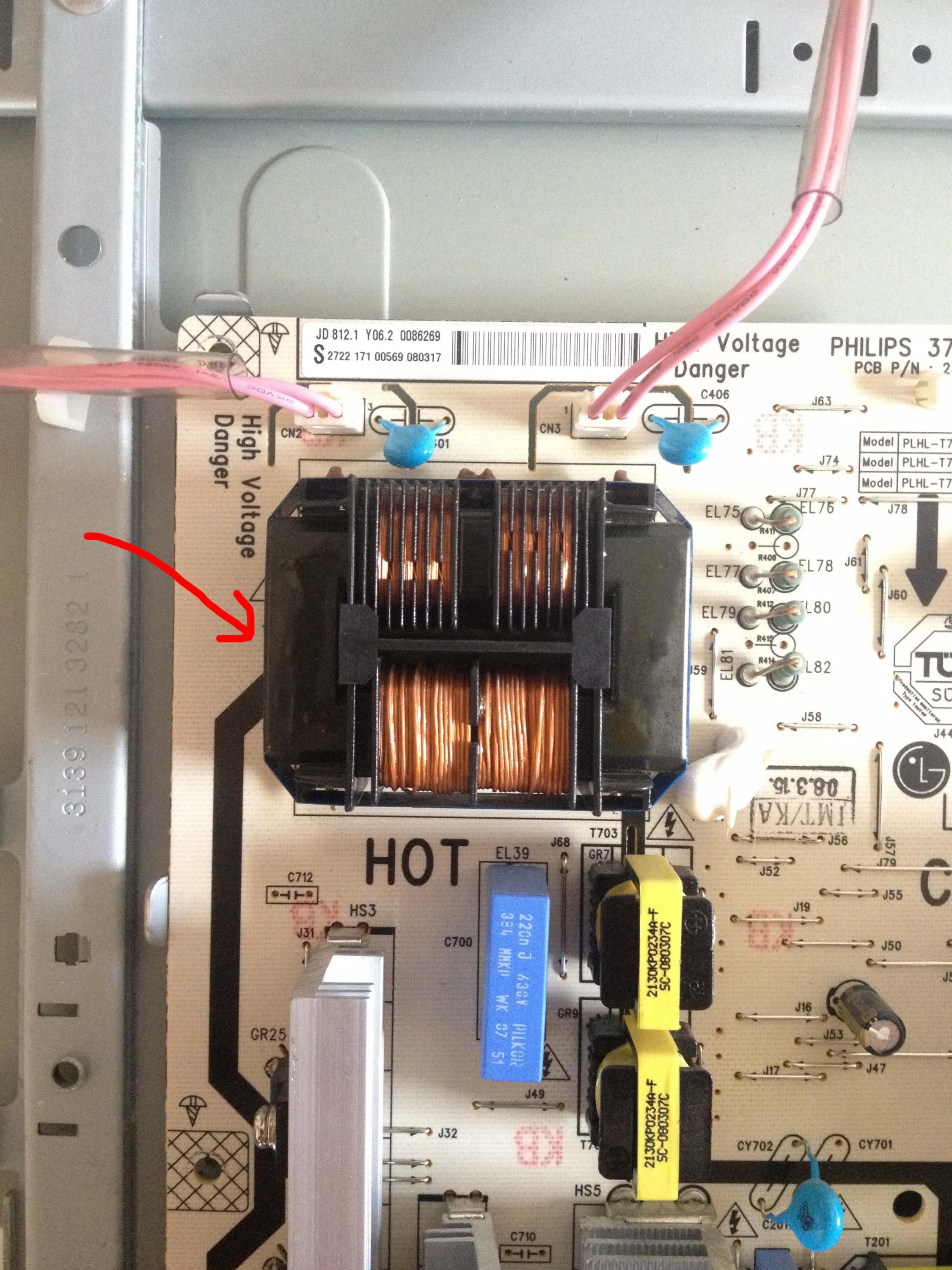

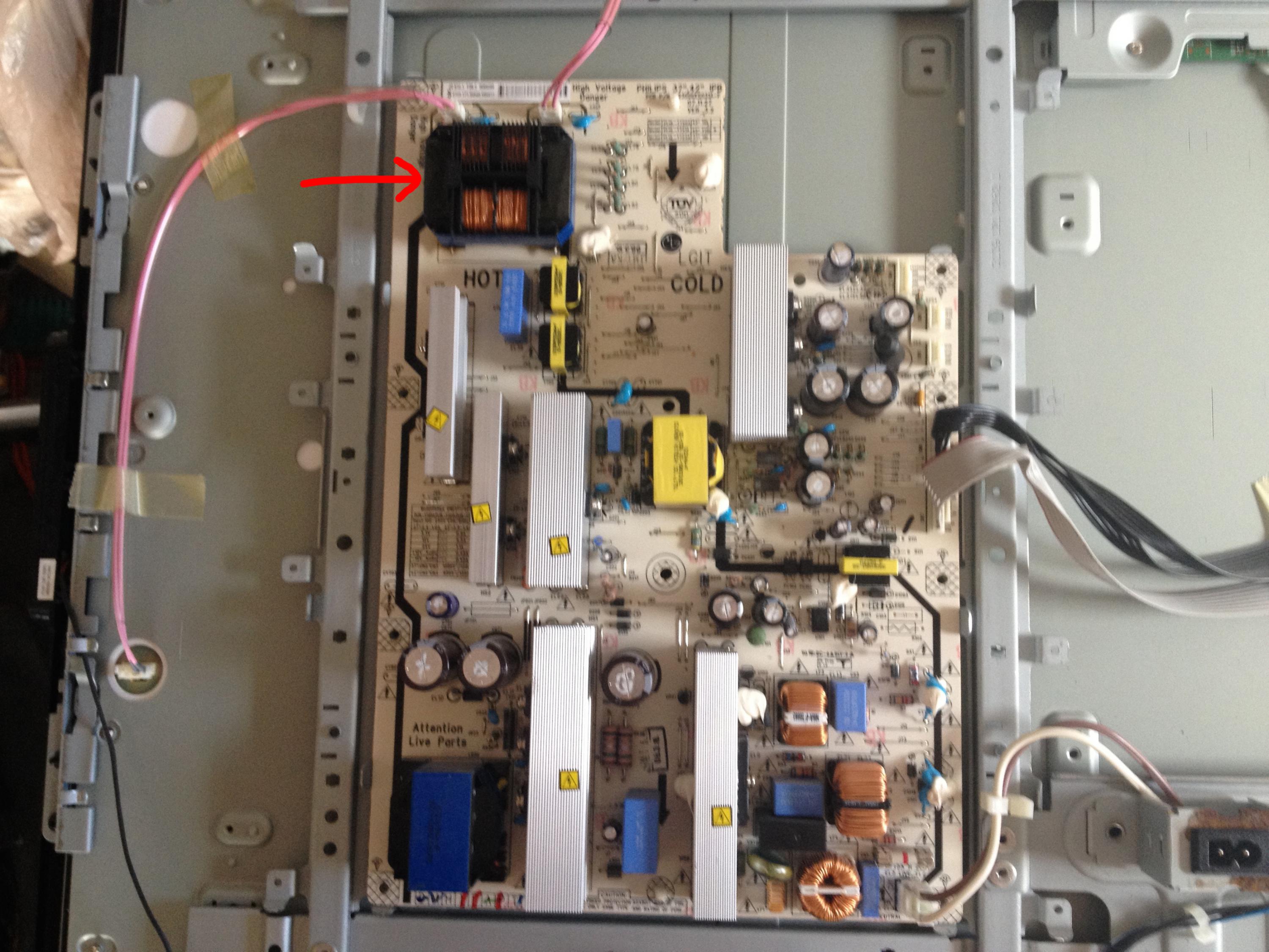

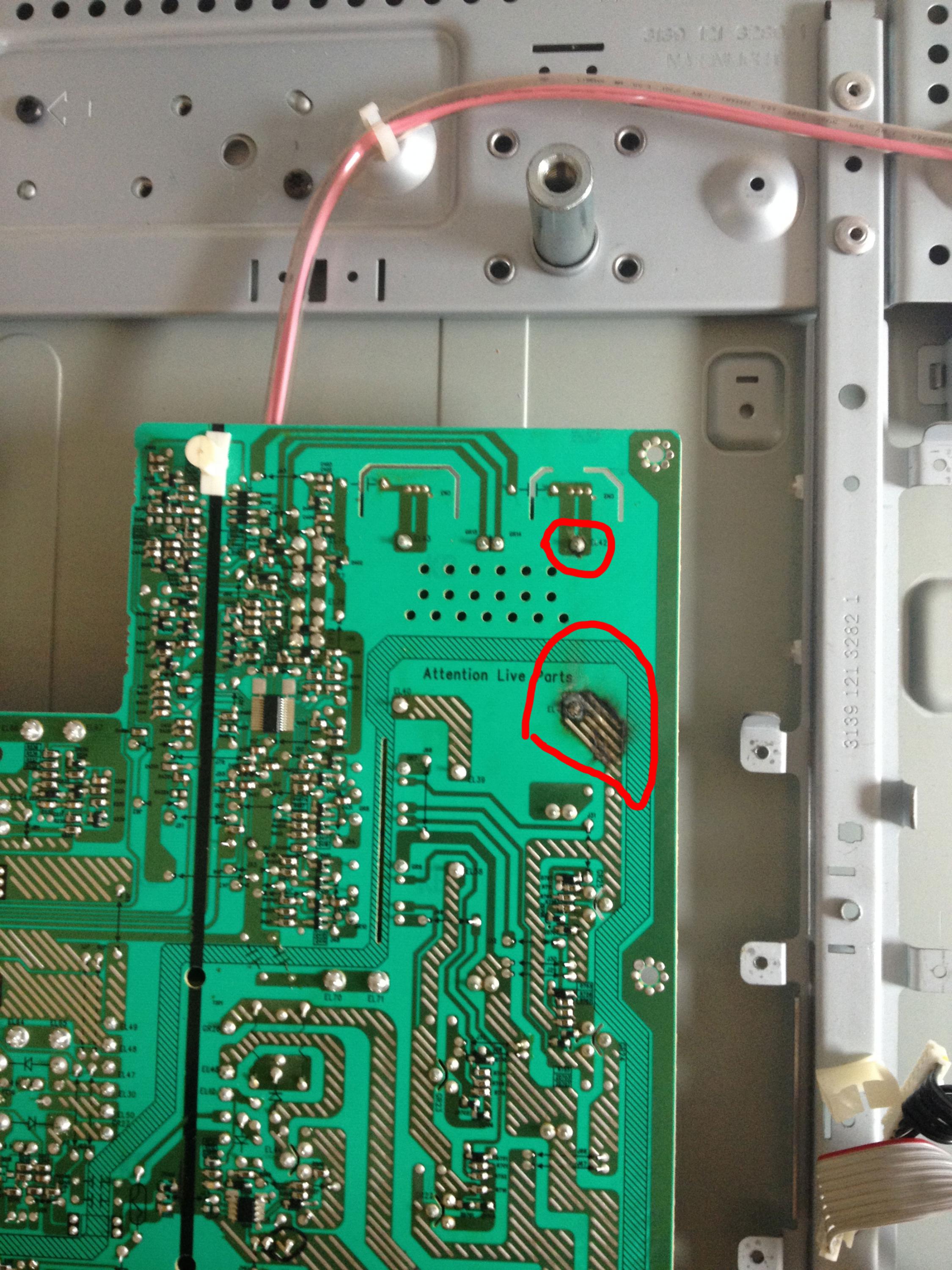

                      OK, so after nearly a year working well, this TV has developed a problem similar to the original. It doesn't power off completely, but the picture goes black while the sound stays on. This is usually accompanied by a burning smell and the back of the TV feels hot. Thinking it may be low quality capacitors used in the first repair, I pulled the back off the TV and noticed no obviously bad caps. However, the Power Supply Board has an obviously burned spot on the large component just beneath the CN2 and CN3 connectors.
                      I have no idea what this piece is. Can this be fixed, and if so, can I just simply replace this piece?

                        Re: Magnavox 42MF438B/27 - either shuts off completely or loses picture but keeps sou
                        looks to me that solder joint is really bad....Might just have to resolder that joint,but make sure you use lots of solder,I would almost take a thicker gauge wire and lay it on that trace,so you can solder that wire to that joint but also a bit away from the burned spot...

                          Thanks Martino. So you think the solder joint was loose and that's what caused it to burn? No need to replace whatever that piece is?
                            "The INV_ON/OFF should change state when the TV is toggle on and off, it sounds like the main board is the problem."
                            "The INV_on measures 3.244 as long as the power light is on. The voltage doesn't change regardless of the screen's backlights being on or off, as long as the TV is getting power. When I press the power button to turn the TV completely off, it drops to 0 V." That is normal and glad you found the problem, that is one reason it is important we we get the correct info when the TV is ON and when the TV is OFF.
                            BTW, that bad joint on the primary side of the inverter transformer had lot spark due to about 400V switching DC is applied and enough to cause black marking on the board, I would remove the old solder and clean that section real well then use good flux and solder on the joints, might as well do the same on the other pins as well, and inspect the whole board.

                              Thanks all. Followed your advice and seems to be working fine again.
