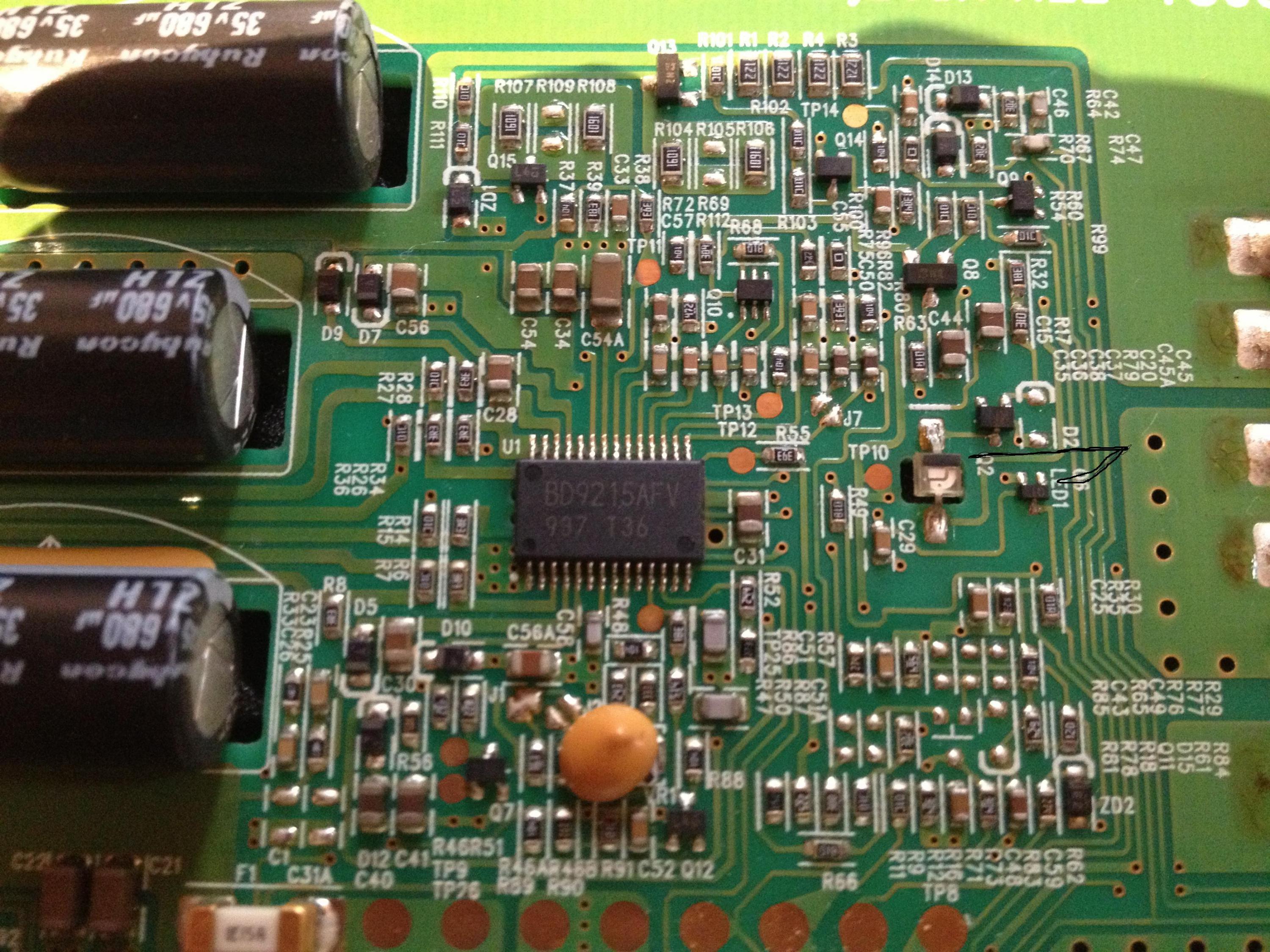

                                    Picture of the inverter board please?

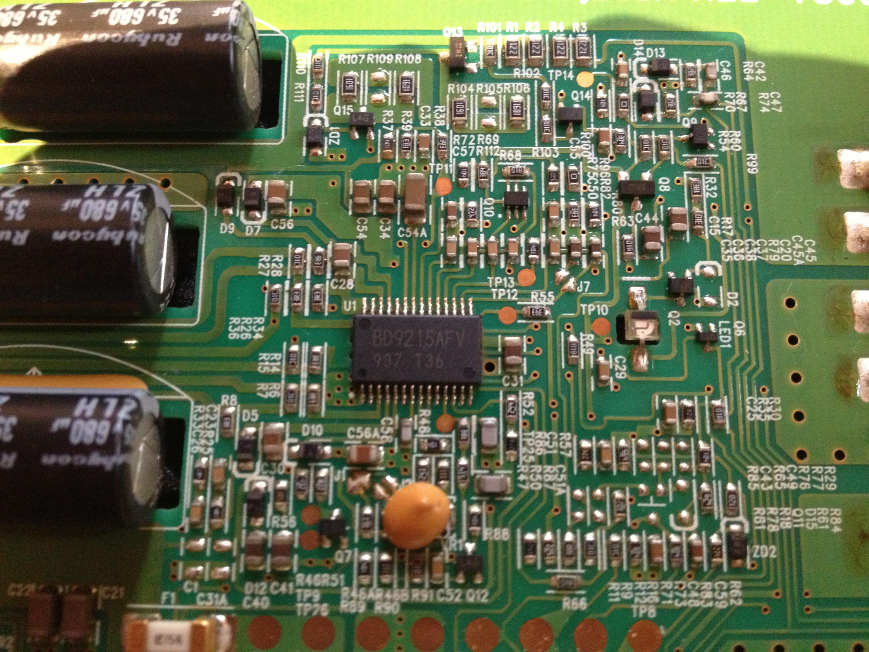

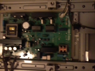

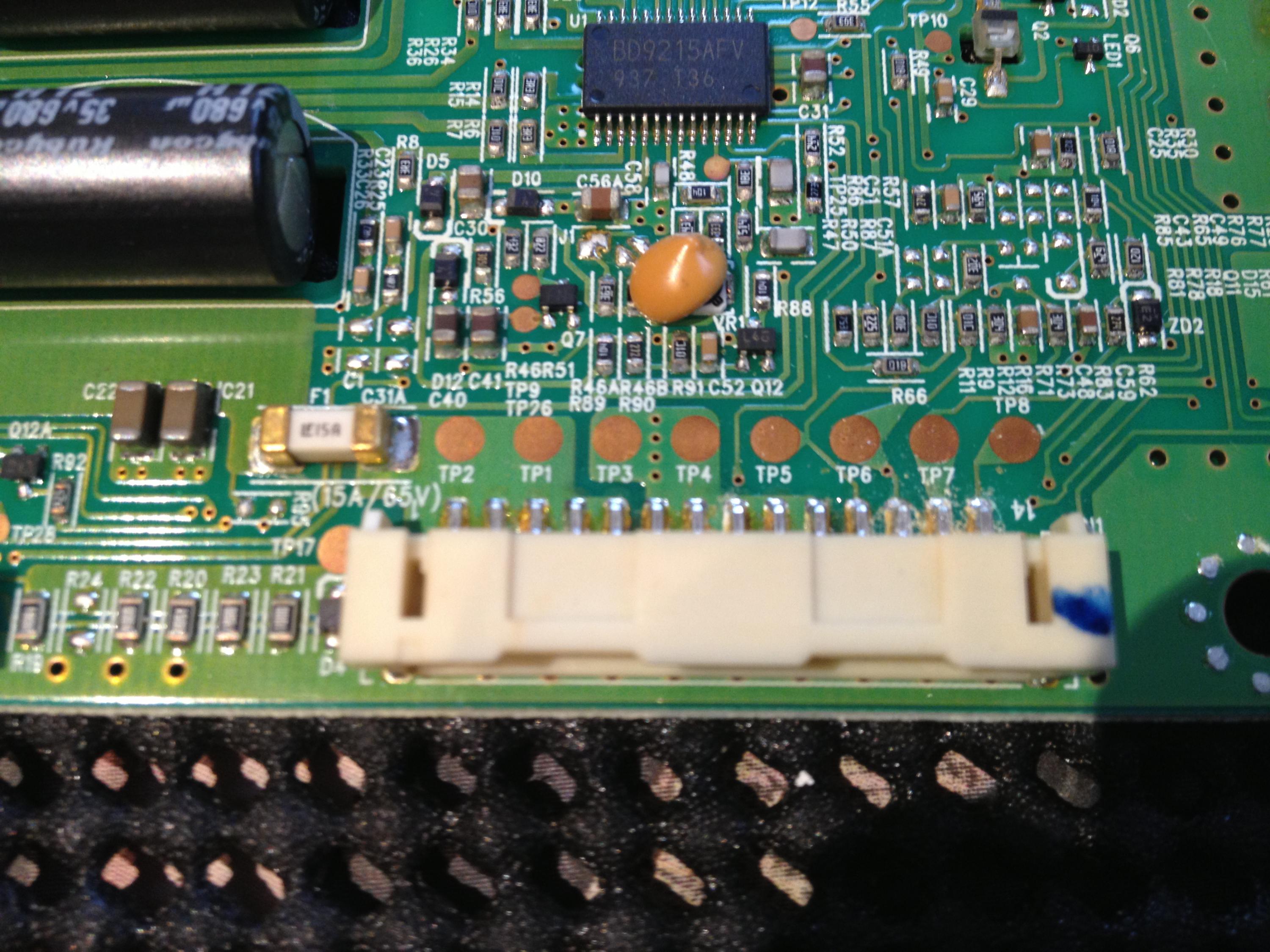

                                    • keithf2
                                      • Aug 2010
                                      • 131
                                      Re: Tosiba 37CV5050D, Sound but no Picture
                                      Find attached three pictures of the backlight inverter board. On pict2 have tried to hightlight 2 components, do you know what they are for.
                                        Can you check fuse F1 marked 15A/65V is not blown. Use the ohms range, expecting a reading under 2 ohms with a digital multimeter.
