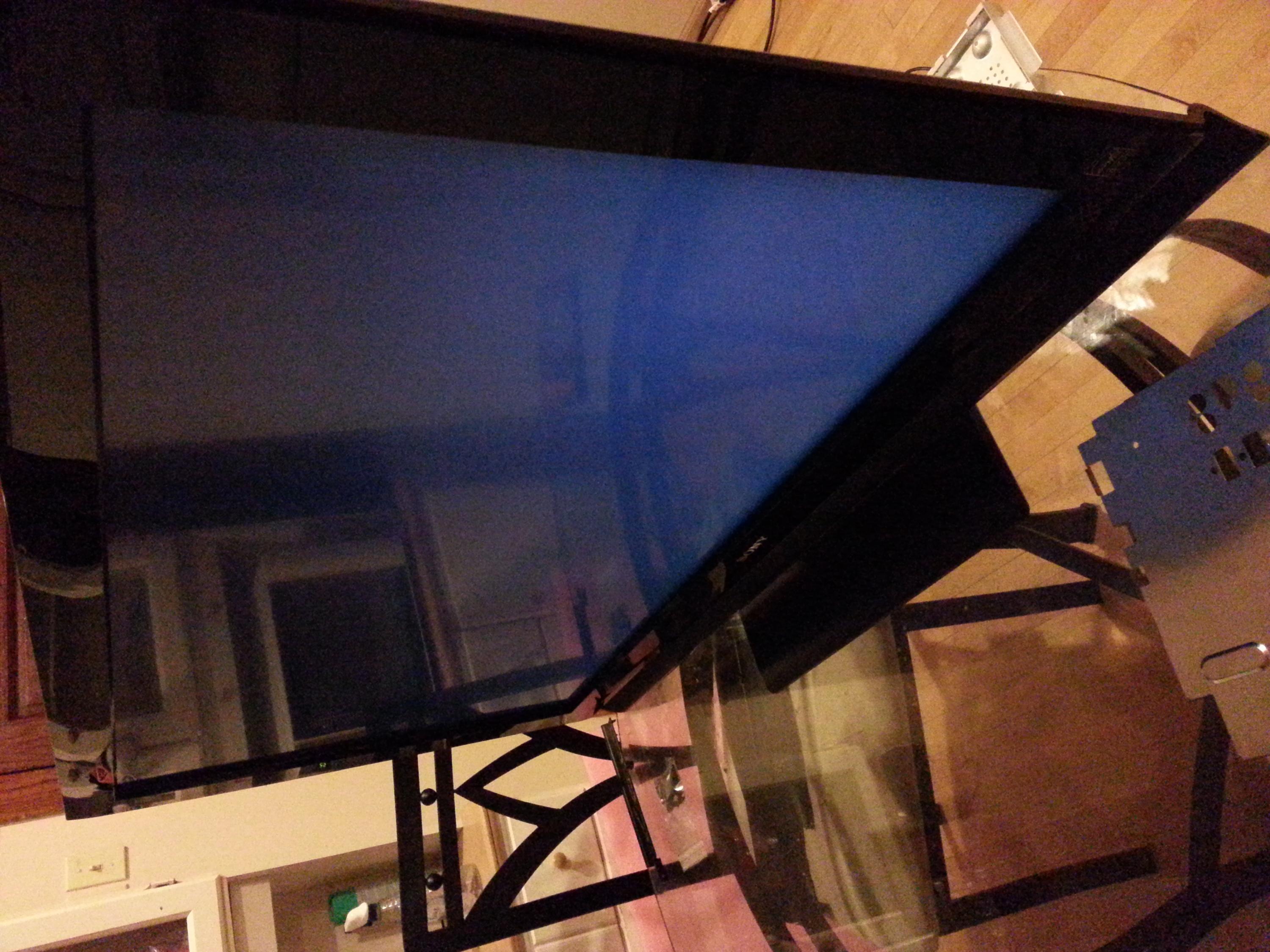

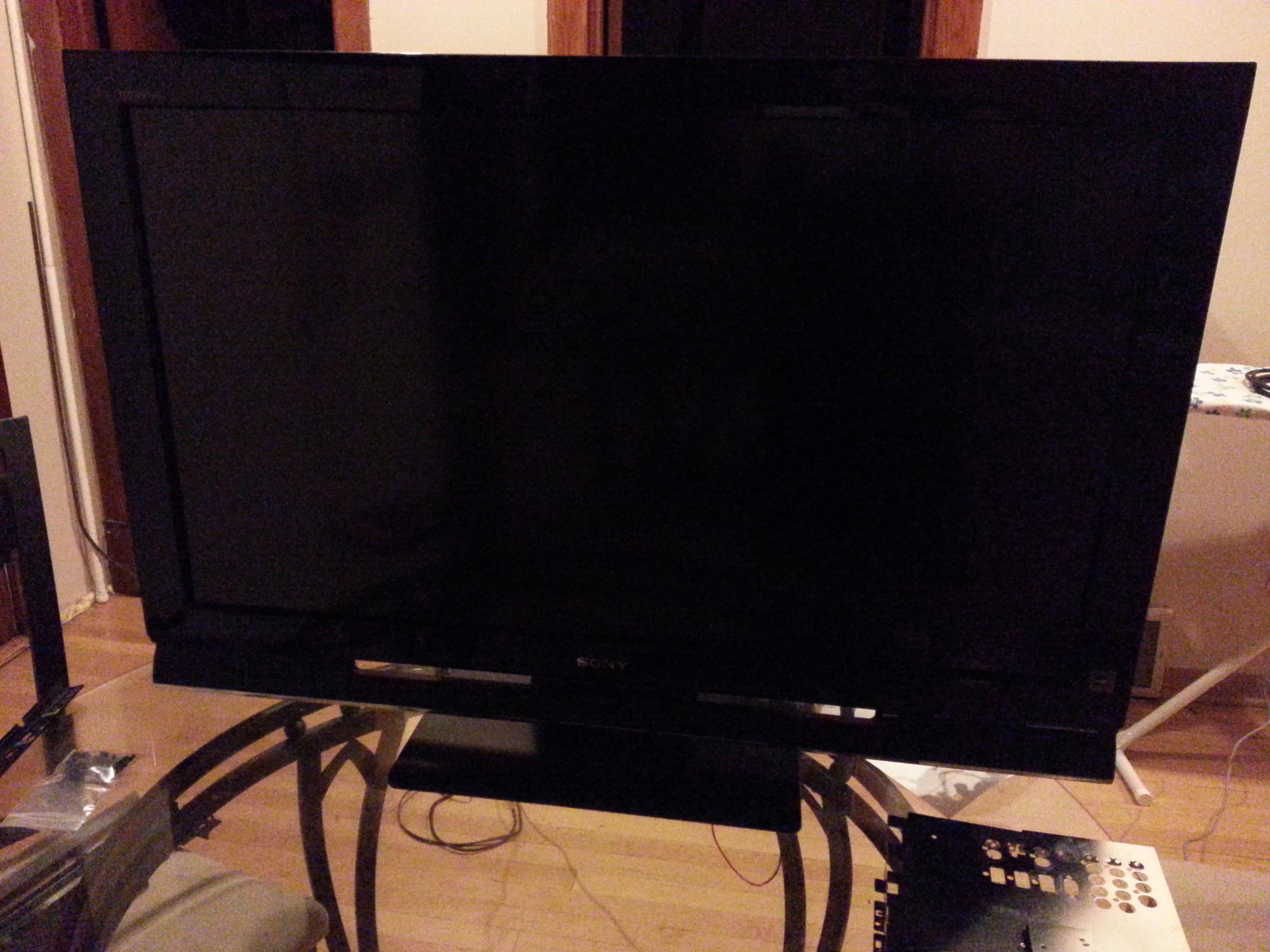

    So I picked up another tv
    When I first got it I plugged it in and you hear the relay click once and the screen is black
    And no standby leds nothing indicating power on
    I push the power button and the relay would click again still a black screen but the green power on LED turned on

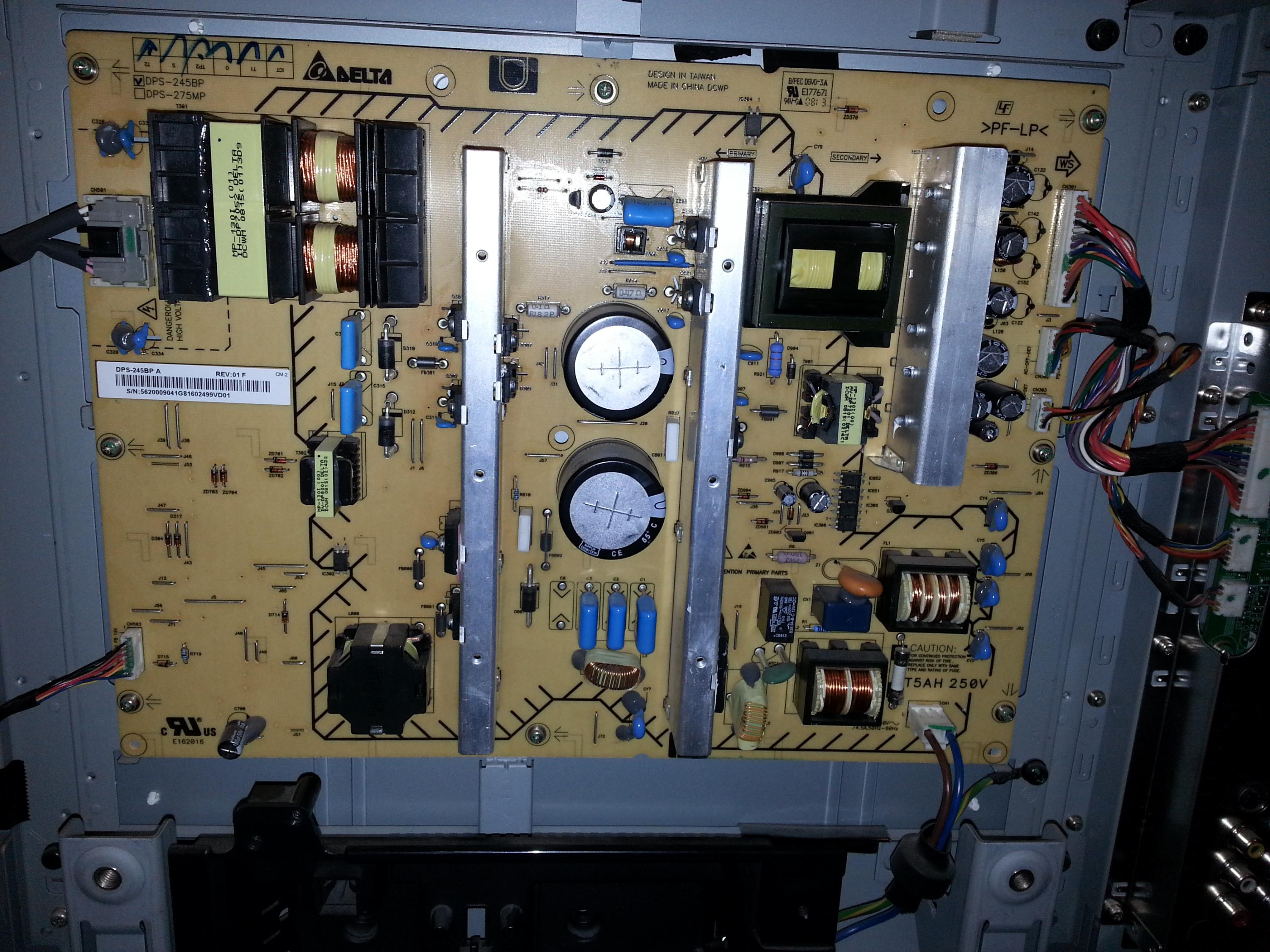

    The fuse in the psu and the tcon are good
    No bulging caps on psu or main board
    After I push the power button again to turn off tv the relay clicks green led goes off and no standby led. After 30 seconds or so with tv unplugged from power source relay clicks again

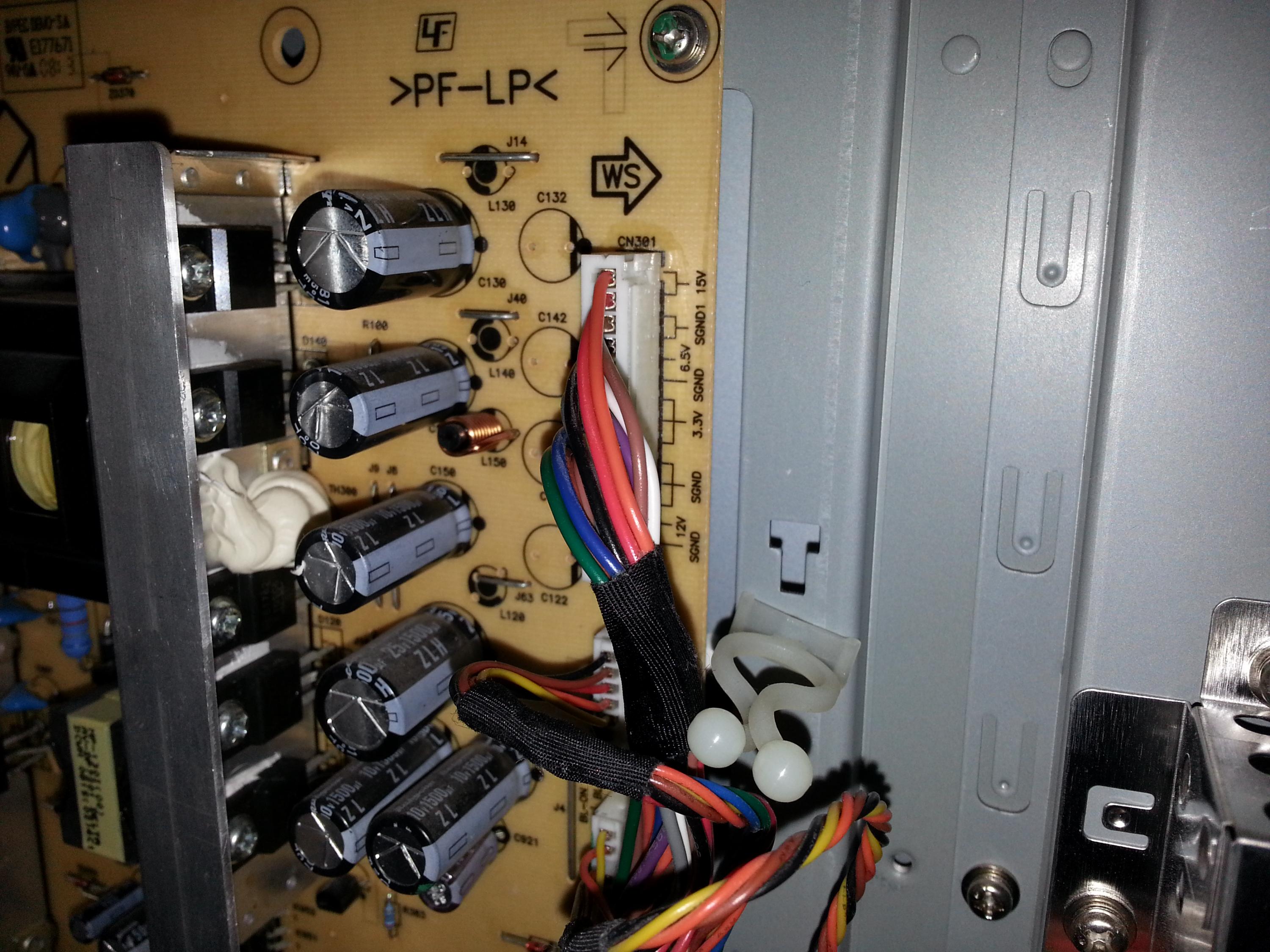

    Here are the voltage readings I got with power on green led on
    CN301
    15.66v
    7.15v
    3.4v
    11.54
    CN302
    3.2v
    CN503
    11.54v
    Not sure if I was supposed to test ps on, fb, ld

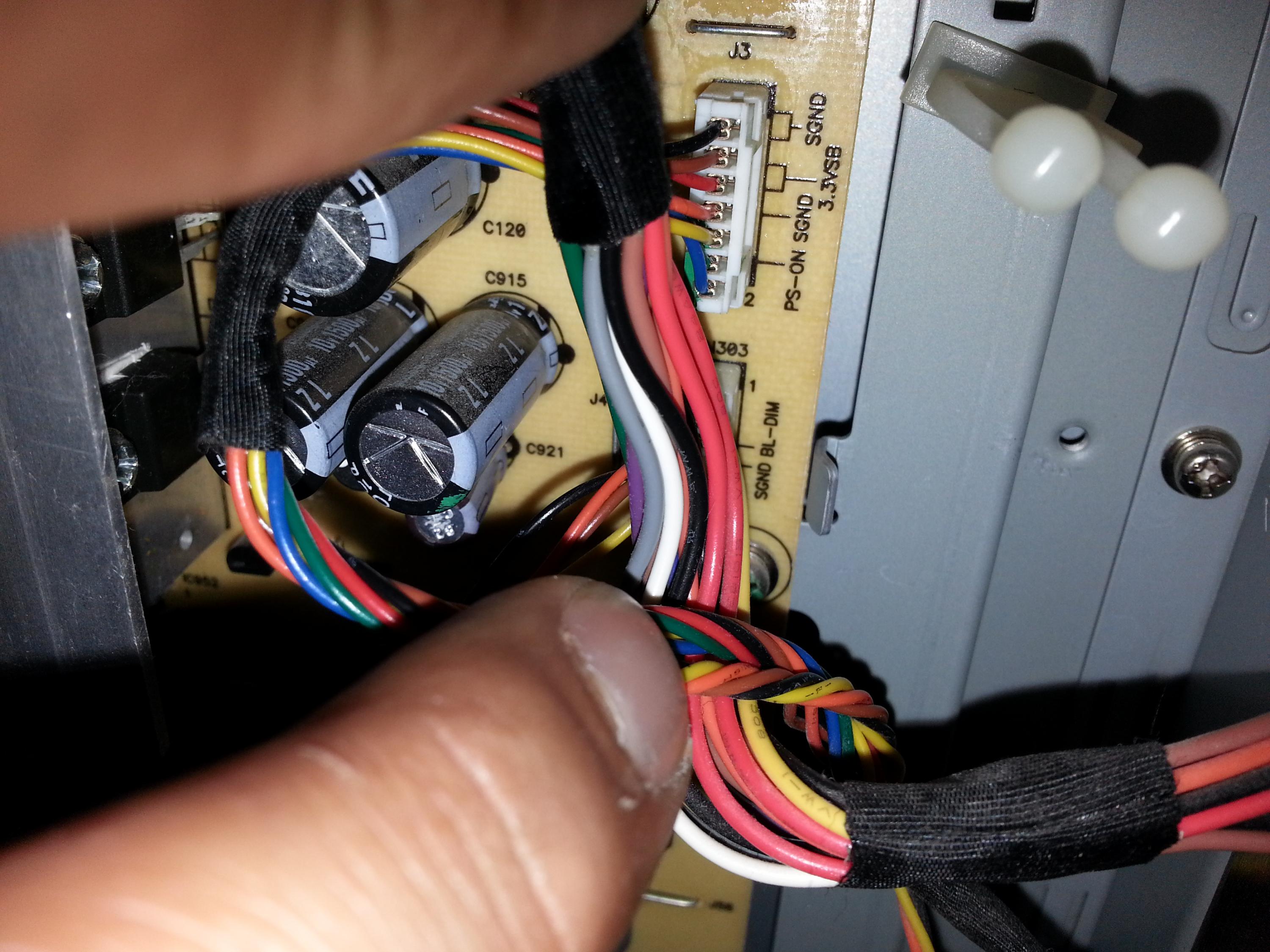

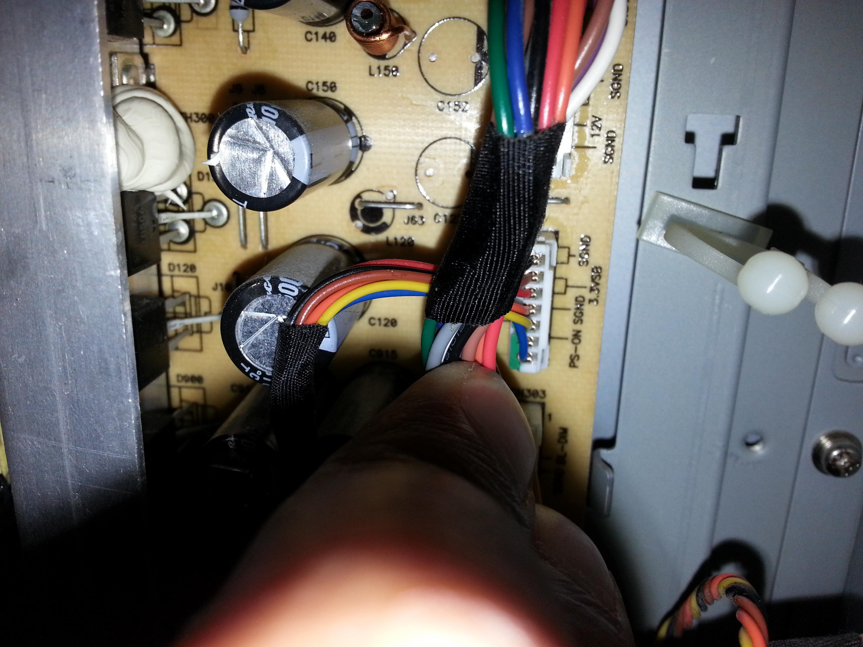

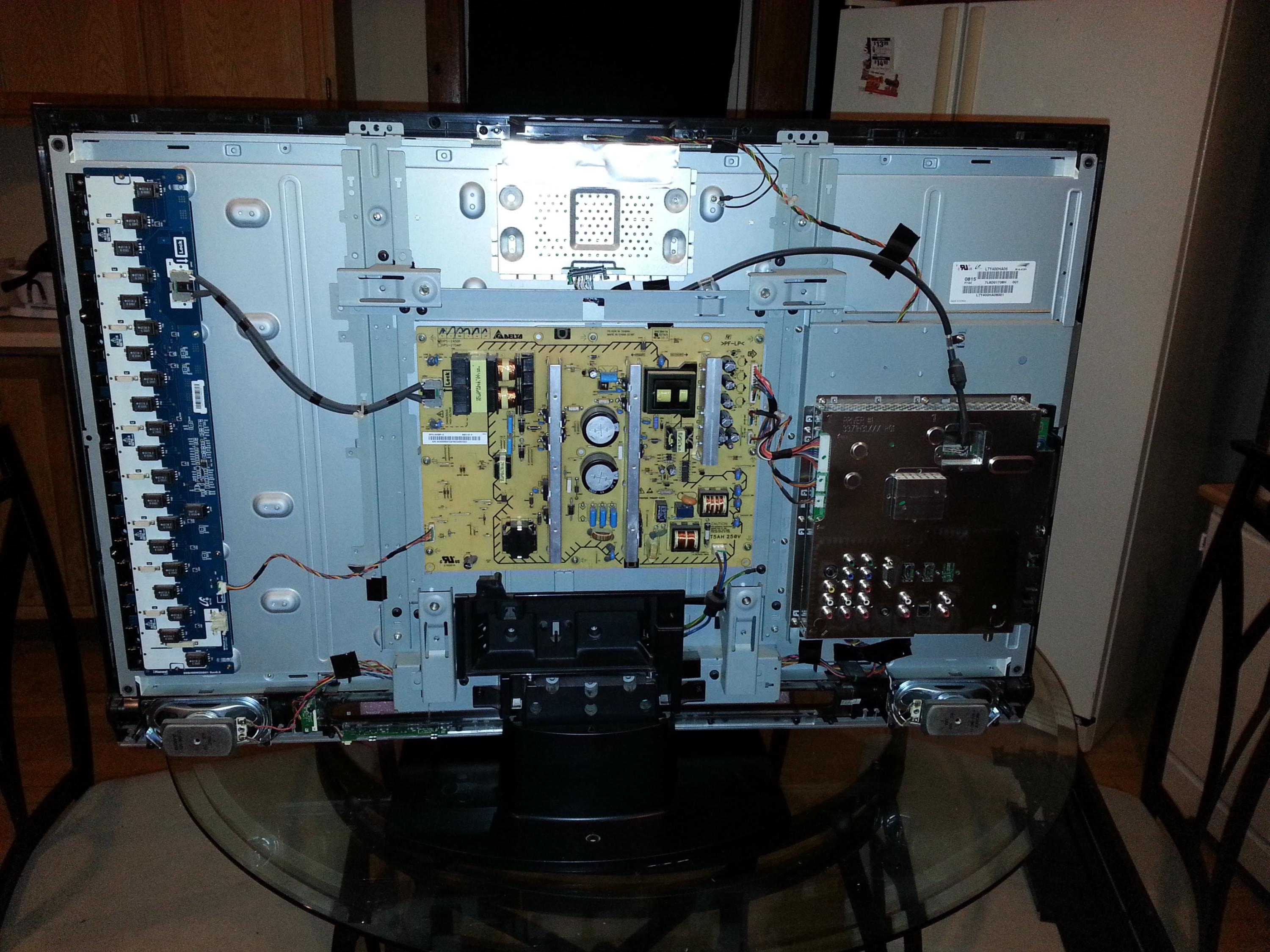

    So I decided to see what would happen if I didconnected the connectors from the psu to the main board
    I disconnected CN303
    I pkugged in the cord rekay clicked once I pushed the power button green led came on and so did the backlight which seems to be flickering quickly
    I took some readings again
    CN301
    15.4v
    7.15v
    3.42v
    11.54v
    CN301
    3.28v
    Im guessing there is a problem at the main board?
    What else should I test?

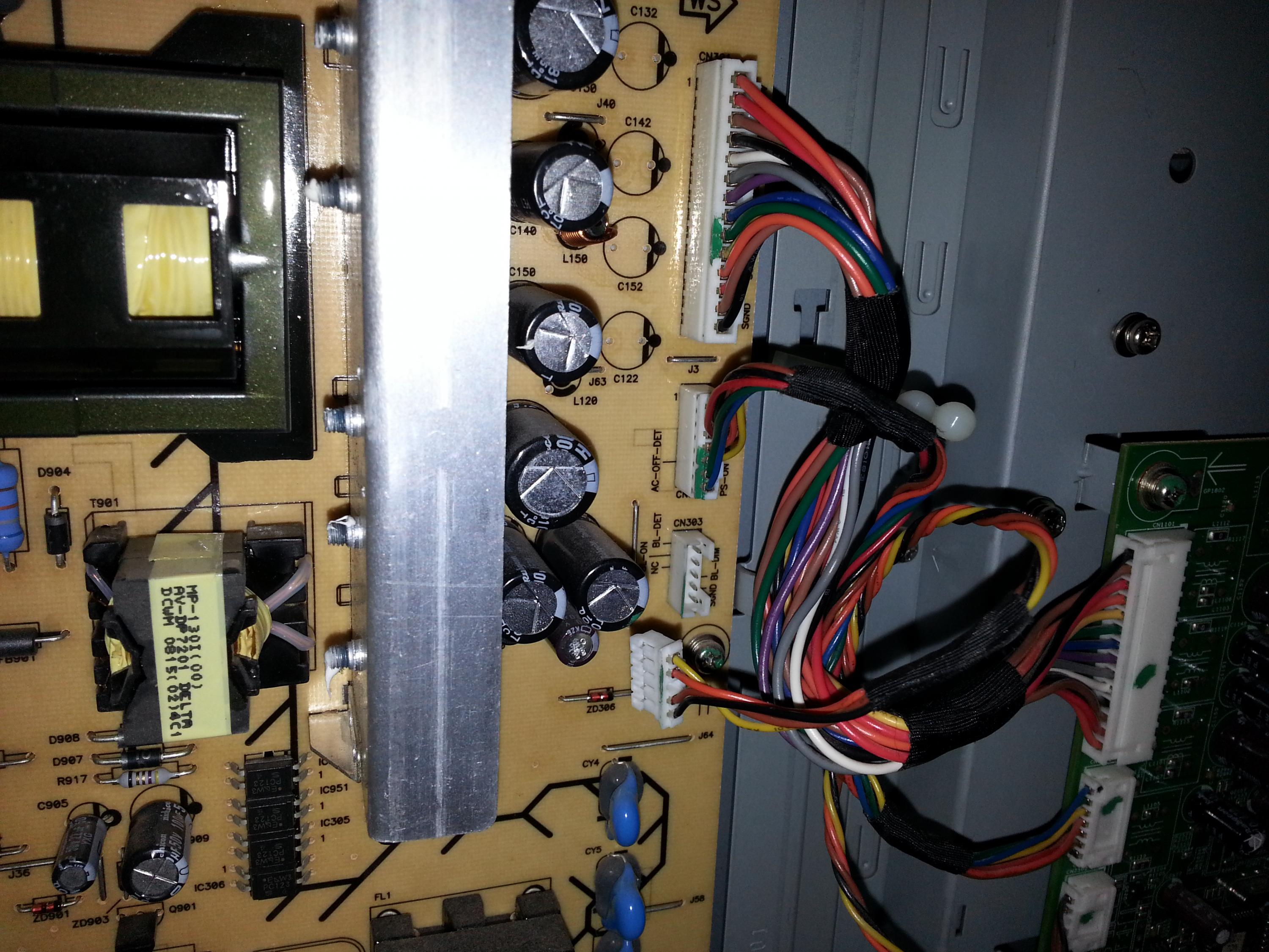

      Re: sony bravia KDL-40S4100 relay clicking
      LD should be close to 11~12vdc, FB less than a volt.
      Service manual:
      Training manual:
      http://elektrotanya.com/?q=showresul...oria=&kat2=all
      • jose6326
        • May 2013
        • 707
        Should I reconnect connector on CN303 or it doesn't matter?
        I did both
        Disconnected
        FB 0.000
        LD 10.40v
        Connected
        Same readings as above
        Is it ok that I use chasis ground to get reading?

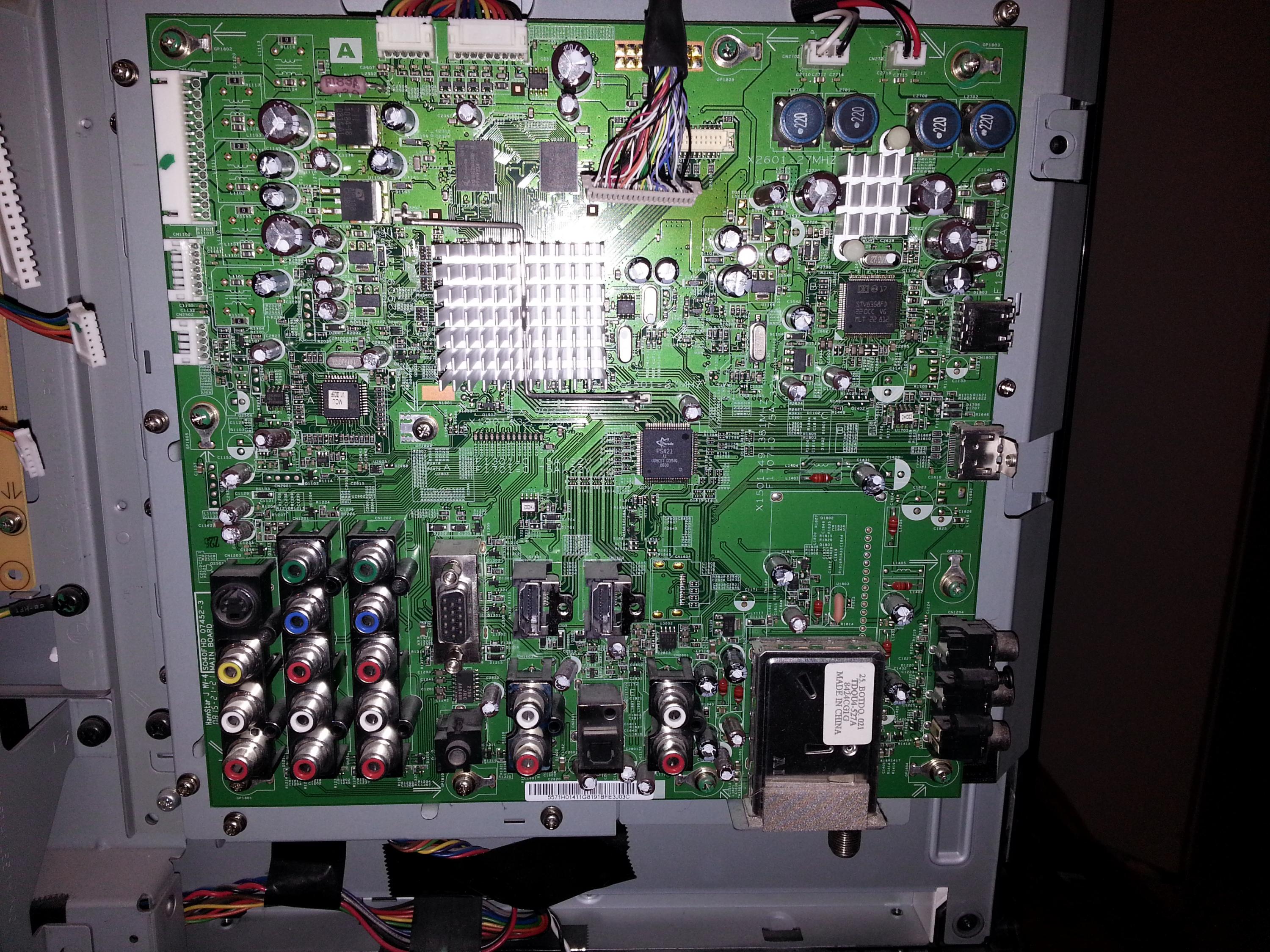

          after looking at the flow chart it seems that that issue is pointing to a defective main board
          on page 22 it shows test points on the main board but not sure what type of readins or how to test certain components
          is it possible to repair the main board instead of ordering one?

            This is a common problem. I worked on a 46S4100 with a similar main board issue. I never attempted a repair, as I suspected one of the BGAs might be faulty or have a bad connection. I got a replacement board from Tristate Module. You'll probably need to match up serial numbers to find a substitute if your original isn't available. Shopjimmy has good info. There was a guy on eBay who was offering a repair service, but it was relatively expensive (about $150).

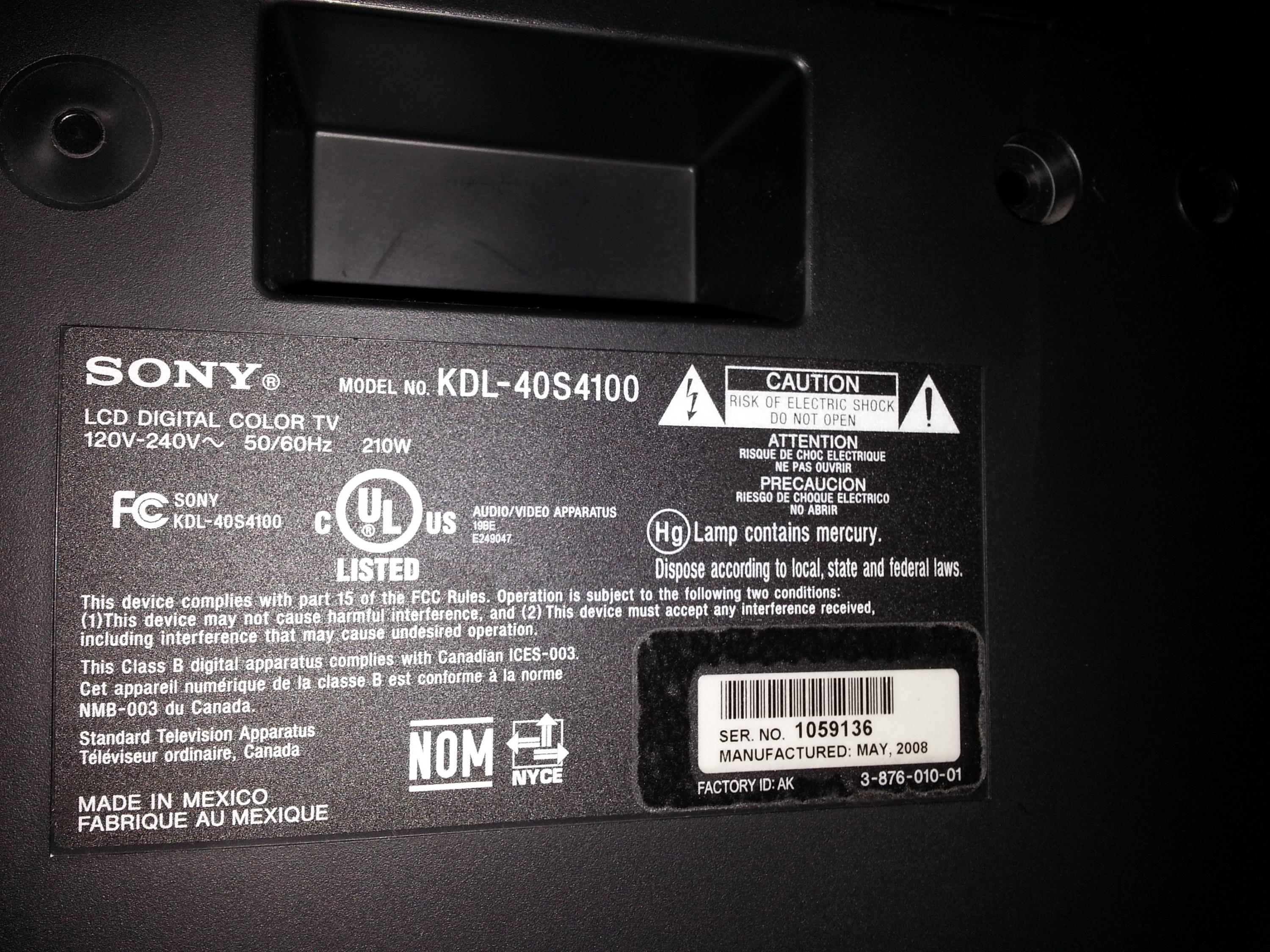

                    What is your TV's serial num?
                    LG Plasma Mal-Discharge Correction Service
                    • jose6326
                      • May 2013
                      • 707
                      Originally posted by capkid
                      Yes, the serial num is normally important to find a suitable substitute for the original if the original part isn't available. Do a search on shopjimmy by your tv model number, and they will provide guidelines when you select the main board.

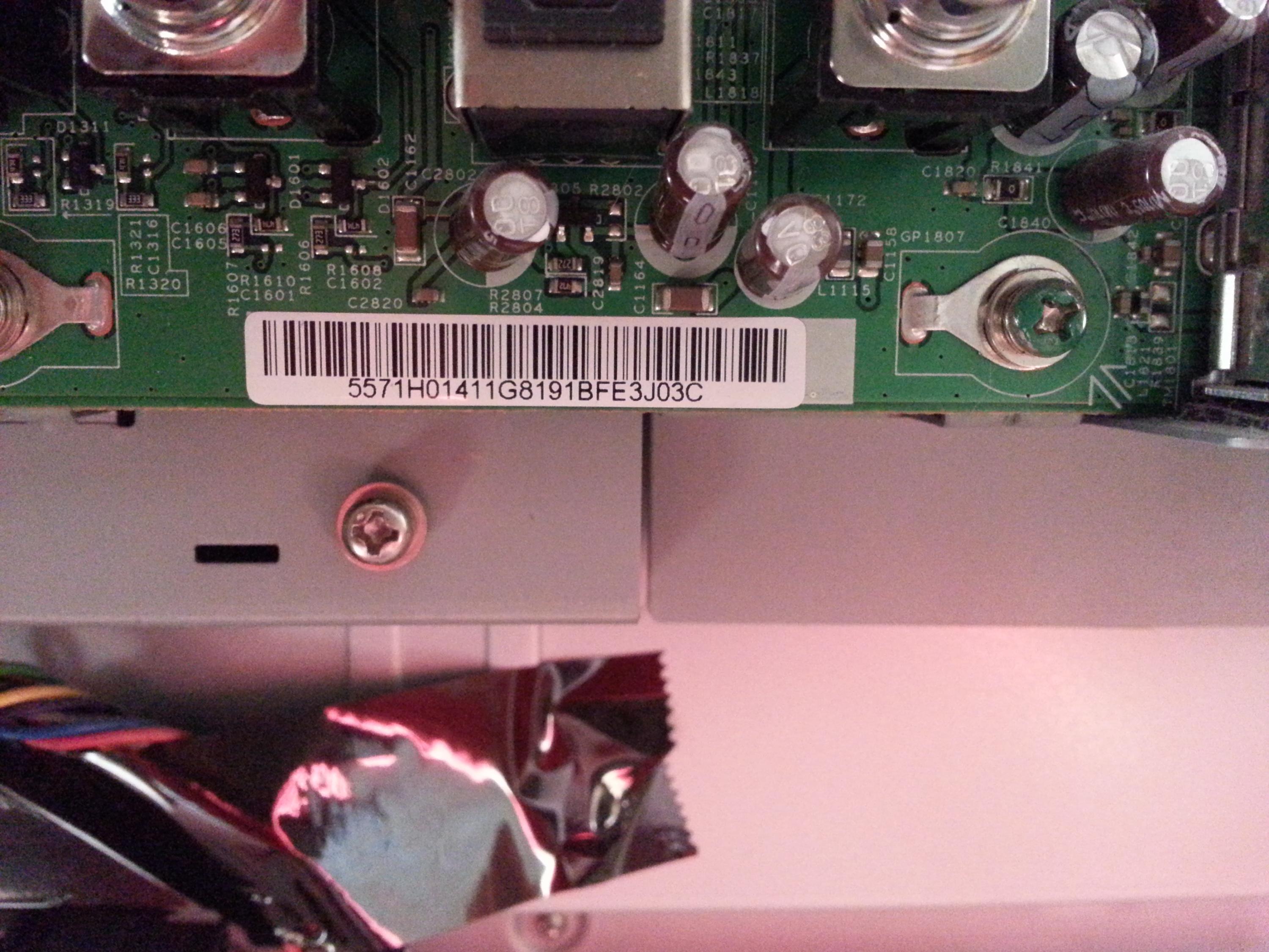

                      Is the serial number located under the part number?
                      Or is it the bar code number?
                      • capkid
                        • Oct 2010
                        • 1339
                        It should be on the back cover of the TV - something like 1350001.
                          The numbers on that barcode are for the PCB assembly (PCBA), they are the number you should match with the repalcement PCBA.
                          http://www.shopjimmy.com/catalogsear.../?q=5571h01411

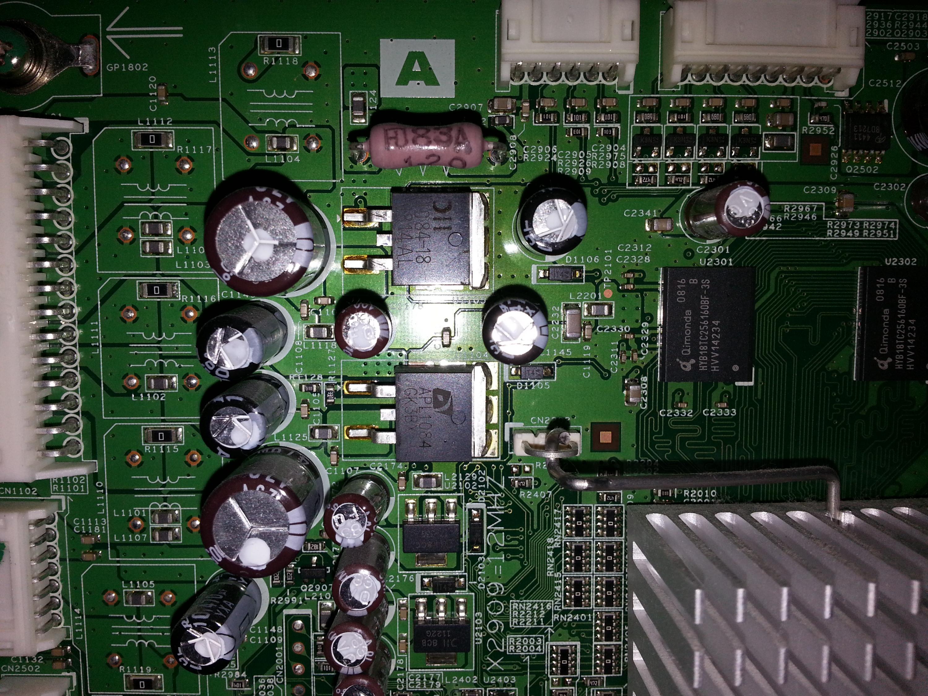

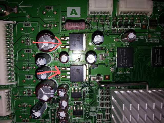

                            So I tested the main board components following the training manual
                            For each component I labeled L1, L2, and L3 to identify each leg of the individual components. The voltages in the parenthesis is what is in the training manual
                            Here is what I got
                            U1105 (1.8v)
                            L1: 0.000v
                            L2: 3.36v
                            U1104 (5v)
                            L1: 3.86v
                            L2: 7.13v
                            U1106 ( 1.2v)
                            L1: 0.000
                            L2: 1.2v
                            L3: 2.97v
                            U1103 (8v)
                            L1: 6.87
                            L2: 8.13v
                            L3: 11.49v
                            U1108 (1.8v)
                            L1: 0.000
                            L2: 1.78v
                            L3: 3.33v
                            U1109 (5v)
                            L1: 3.97v
                            L2: 5.22v
                            L3: 7.10v
                            Im guessing 104 and 105 are bad?
                            Here is the serial number of the tv
                            1059136
                              What are the L3 for those two ICs?
                              Are there P/N printed on those two ICs?

                                • jose6326
                                  • May 2013
                                  • 707
                                  I didnt test them because they are not being used
                                  But I can test them
                                  The are good
                                  The leg that isnt being used read good
                                  U1105
                                  1.8v
                                  U1104
                                  5.17v
                                  I was hoping it was one of those that were defective
                                    OK, that center pin is connected internally to the big tab. So they do look bad, I can see one of them has 18 printed on the body, so it should have 1.8V output.
                                    • jose6326
                                      • May 2013
                                      • 707
                                      So they are or are not defective?
                                      Because U1105 center pin has 1.8v when I tested it
                                      Here are the numbers printed on the body
                                      U1105
                                      1084-18
                                      0814AK
                                      U1104
                                      APL1084
                                      GK3BX

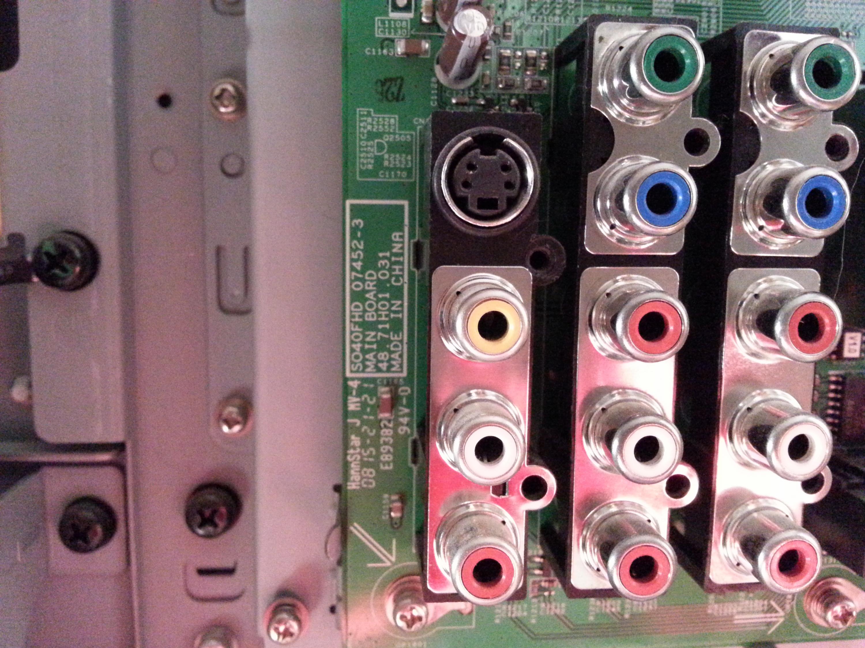

                                        It looks the panel model info is also needed for the KDL-40S4100 when identifying replacement main boards. It wasn't necessary for the KDL-46S4100.
